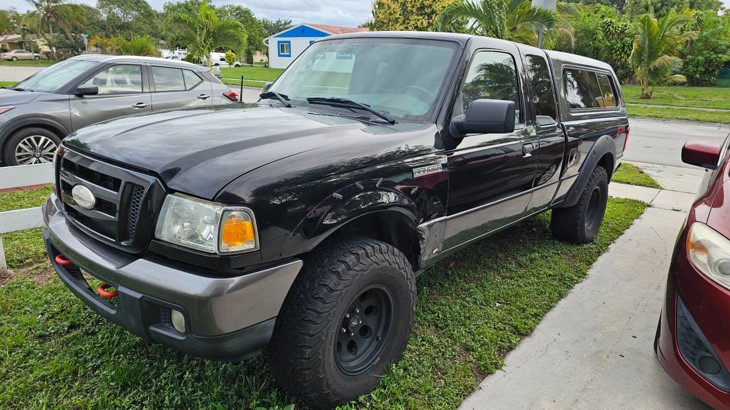

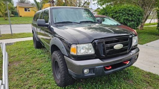

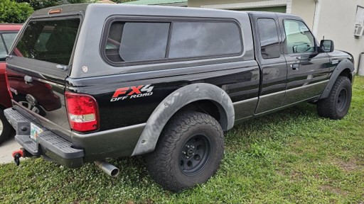

Here are some pictures of when i picked it up!
2006 FX4 Daily / Offroad Build

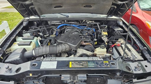

One thing you should consider with the 4.0L SOHC... certainly if you don't know the history. Invest in a set of new timing chain tensioners. You can do a little searching and find install info. But the early SOHC engine got a bad rap for the timing chains letting go. There are revised parts out but if one let's go... it will totally ruin your day.
If you hear any kind of rattle... especially on a cold start... do it soon.
I know @DILLARD000 has a good write up for some of the weak areas on the SOHC... maybe he can chime in with his list.
When I found out about the truck and the its specs, I did look into it and the timing chain was one of the things I found I need to be careful of prior to buying it. From the test drive and since driving I haven’t heard any rattle luckily. But if I can be proactive rather than reactive I would want to. My question is since it’s a 06 and from what I read a lot of issues were resolved by that year. So is it still an issue for an 06 or did the revised parts go in my engine from the factory?
However, if there are other weak areas to be looked at I’d like to know for sure!
By 06 all the revised components were in place.
I did mine at 85k... I plan to log some road trip miles in the next couple three years with this truck... with roughly 135k now... I'm gonna change them again. Colyes parts and after long sit times (7 to 10 days) I get a rattle out of the right side on the first start. I found Ford replacements and bought a pair. I'm gonna do the passenger side. Then I'll do the driver side one when I change out the thermostat housing. Which is another weak link in the SOHC.
I'm proactive with them. It too expensive if they fail.
Keep the oil clean. I use motorcraft synthetic blend and always a motorcraft filter. They are anti drain back.
Then just respect it and drive like ya wanna get several more years out of it.
Oh damn you are the definition of proactive in regards to that haha. When you are doing your replacement from the videos I watched you are taking out the whole engine and chains for the tensioners? Or is there a way to replace them easier? I'd be interested in doing them at 150K.
Even though its at 147K and the previous owner said it was changed at 145K I am getting it changed anyway to be on the cautious side.
I heard about the thermostat housing also, are you going with OEM plastic or switching to an aluminum?
To replace chains and guides... engine removal.
Chain tensioners are spring loaded hydraulic cylinders that apply tension to the guide to keep pressure on the chains. They can be done engine in place. Passenger is pretty easy through the wheel well. Driver side requires removal of a couple components to get to.

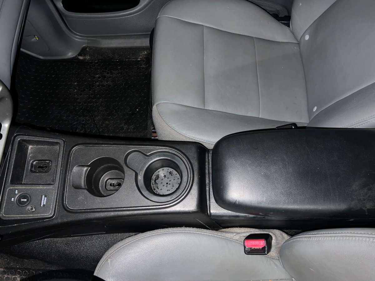

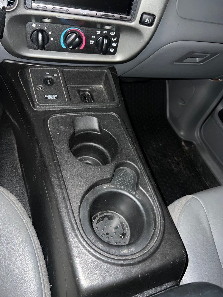

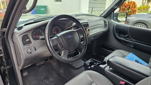

Was finally able to start on the truck with some the upgrades.

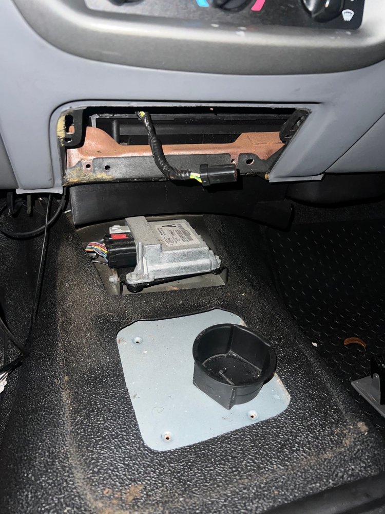

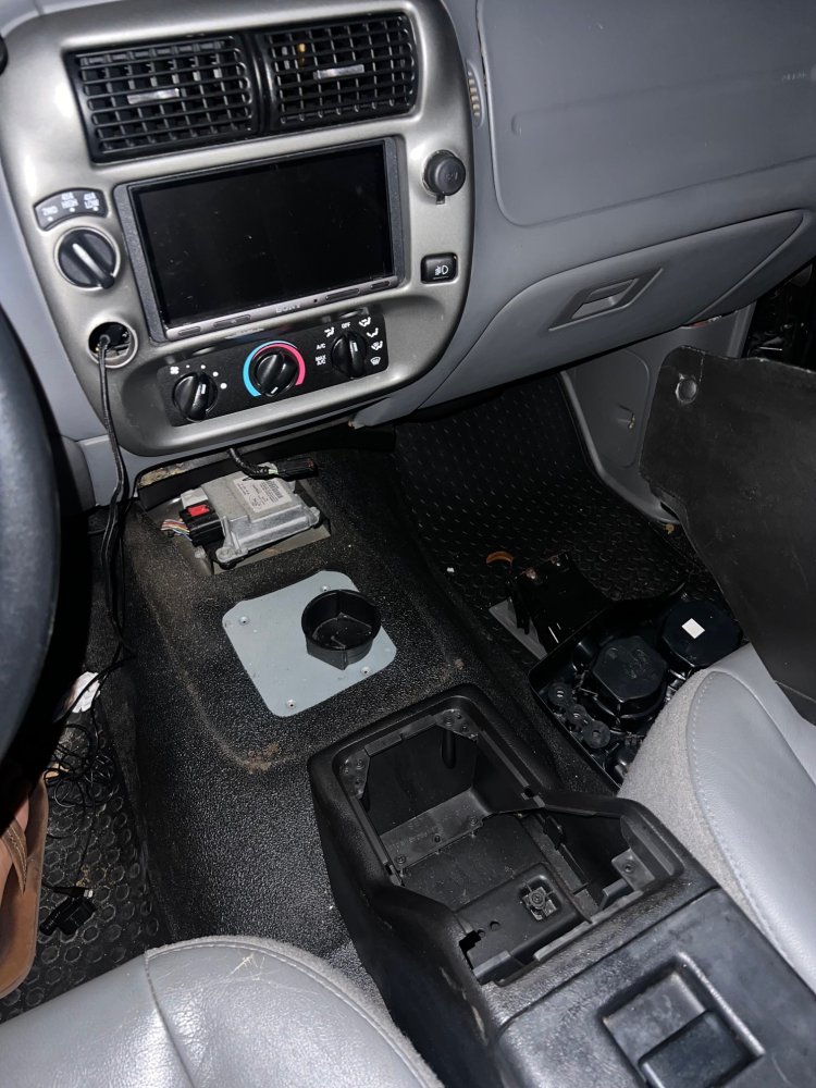

Got the full length console about a month ago and started on the install. Got it mocked up and partial installed and usable. I am working on the airbag relocation to the glove box and also messing around with some ideas to modify the console.

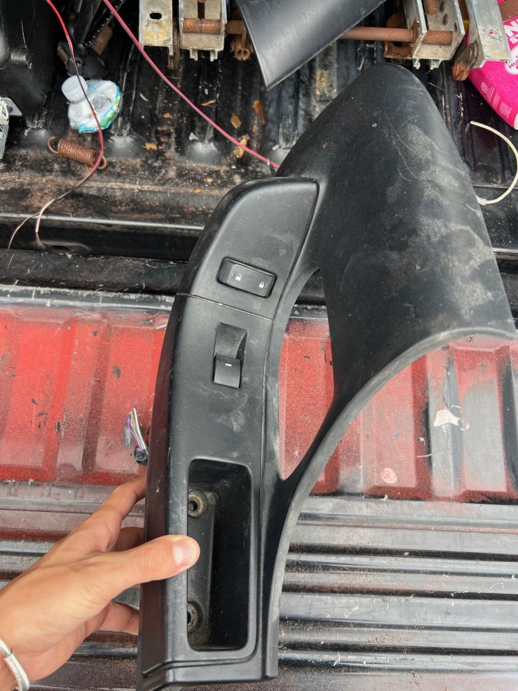

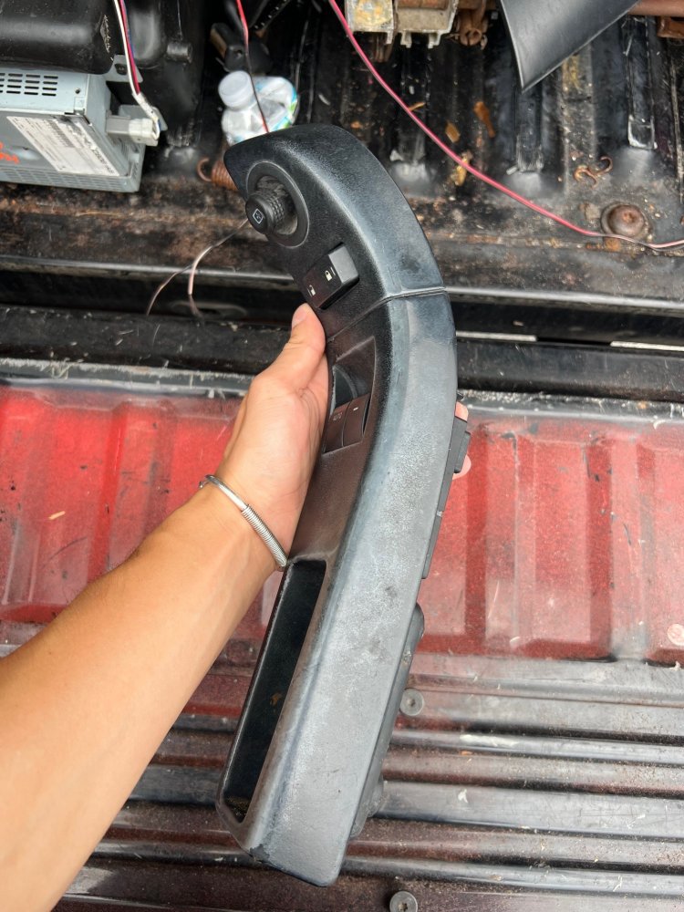

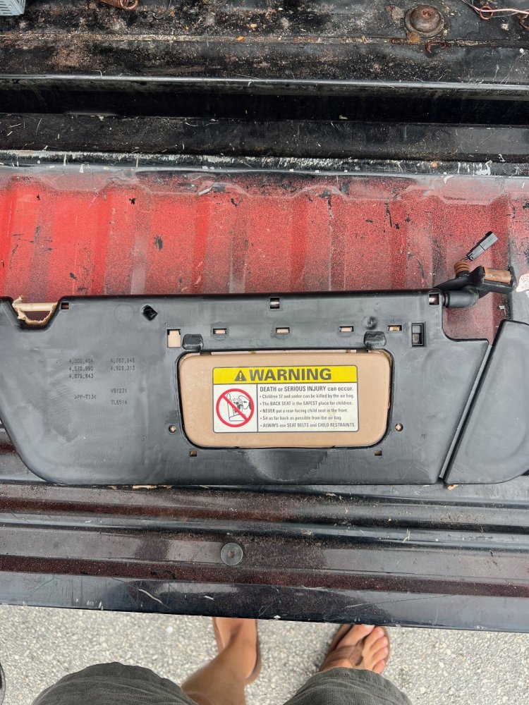

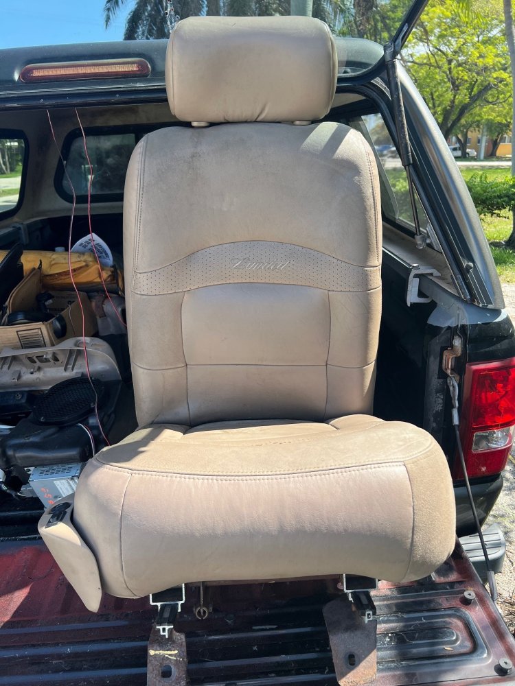

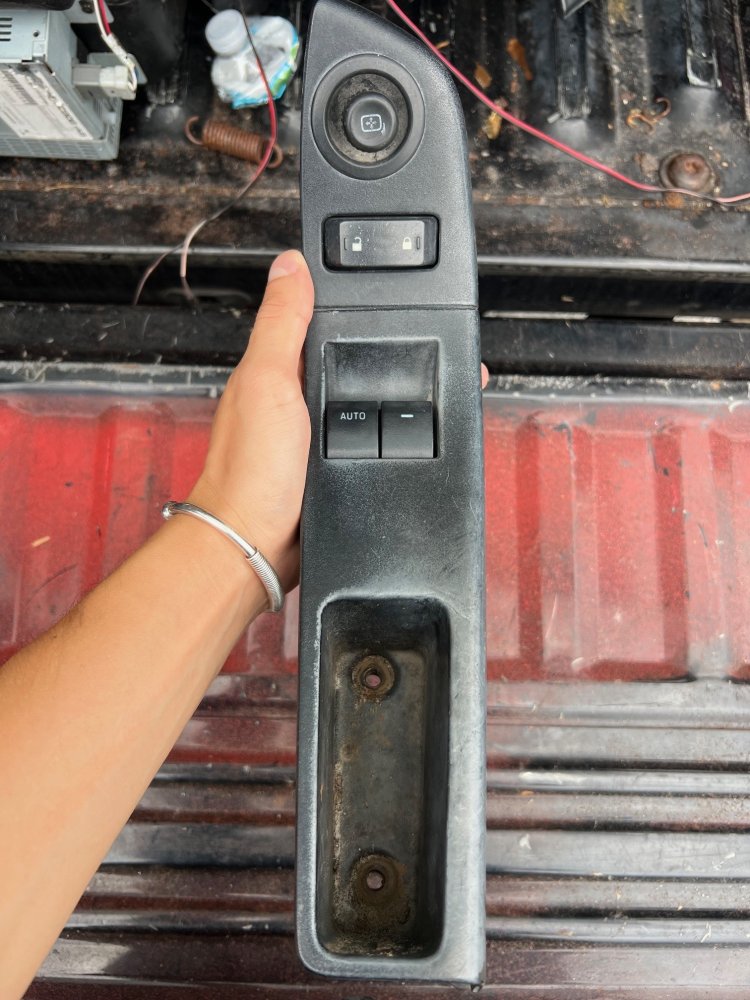

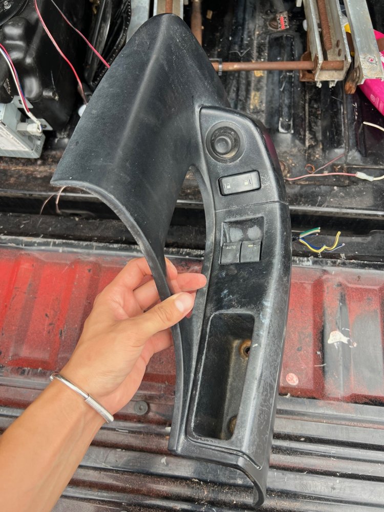

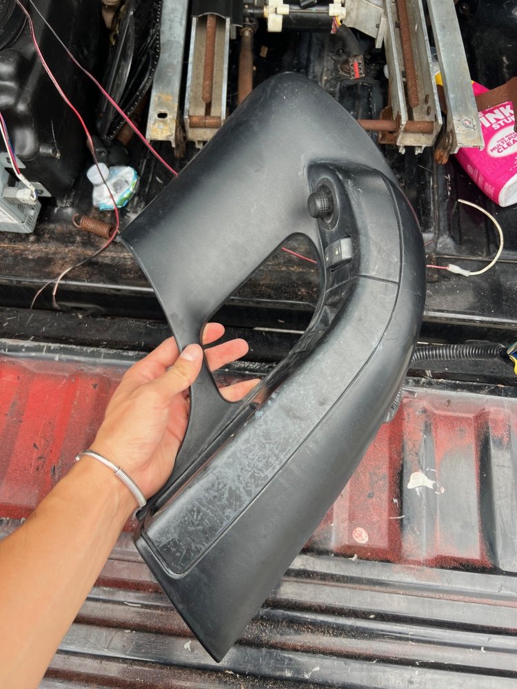

Haven't been to a junkyard in over 10 years and got really lucky last weekend on a 2000 Limited Explorer and couple 08 Rangers in the yard. Was able to grab a bunch off of them even though they had been in the yard for over 3 weeks.
Was able to get front seats and wiring (all power and heated so i was super pumped with that cause I wanted them but didn't think i would find or get them anytime soon), seat memory, visors (expect the driver wire connector was broken), overhead console wiring, glove box light, auto dimming mirror (need to ask you guys on if i can still make it work), 08 door pull, window and lock switches for driver and passenger.

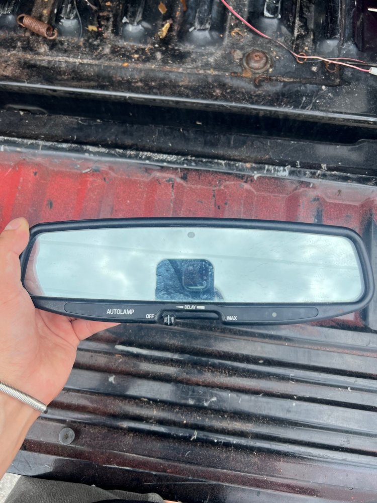

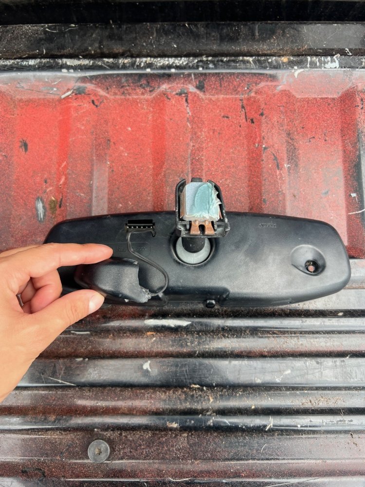

Realized I didn't put any pictures of all the junkyard finds.
Anyone that can provide some input on the dimming mirror and if the one I got can be used since the sensor plastic is broke or if that part can be replaced and not the whole mirror
