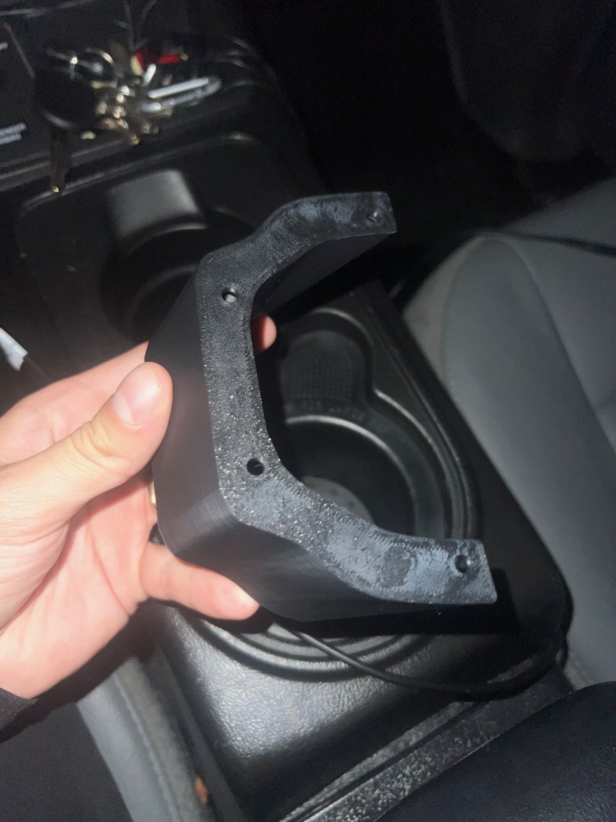

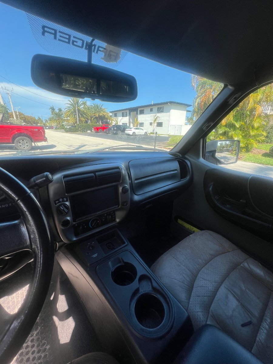

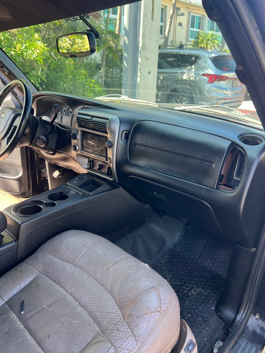

Here is the most recent items done since the interior swap.

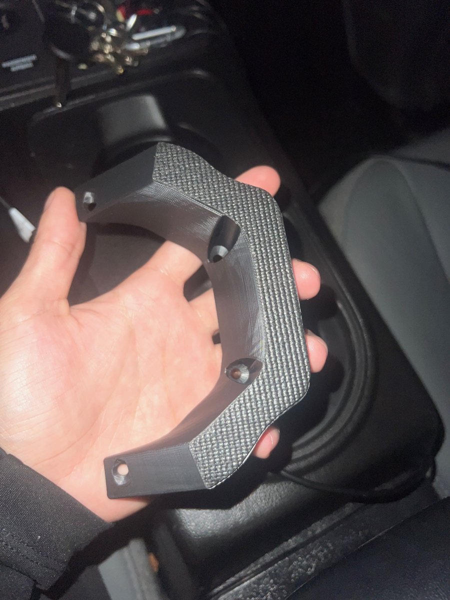

Started on the headliner replacement, added a armrest support, pulled a part the explorer visors, dyed and started painting any grey parts to black.

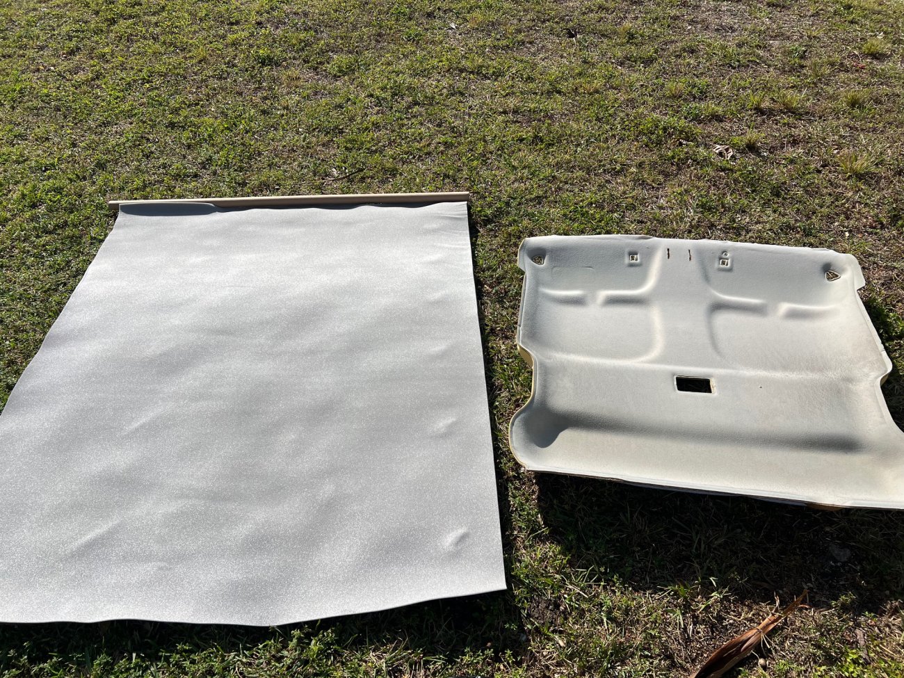

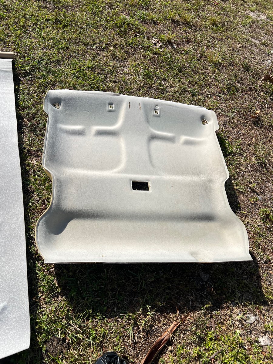

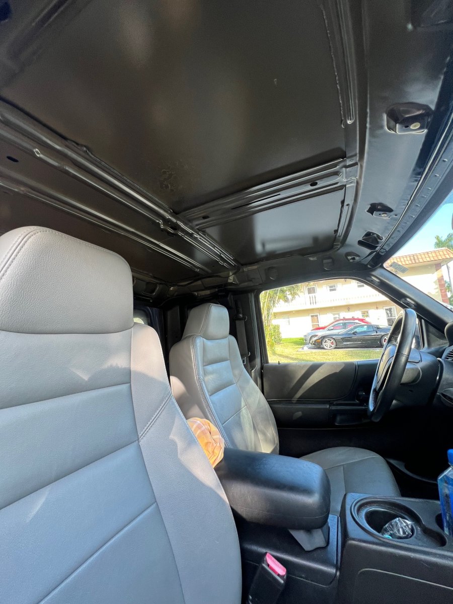

Well attempted to change the headliner and sprayed the glue over the whole headliner and fabric and messed it all up! :pissedoff: It started to get stretched out so much all the give was gone and it was getting wrinkles and foam started to tear away, so to say the least I got humbled haha but ordered a new one and its on its way for round two
Beyond that I also ordered sound deadening and insulation for the truck about 70 sqft all together which I don't expect to cover the whole truck but its a start especially since i don't have the replacement carpet yet.

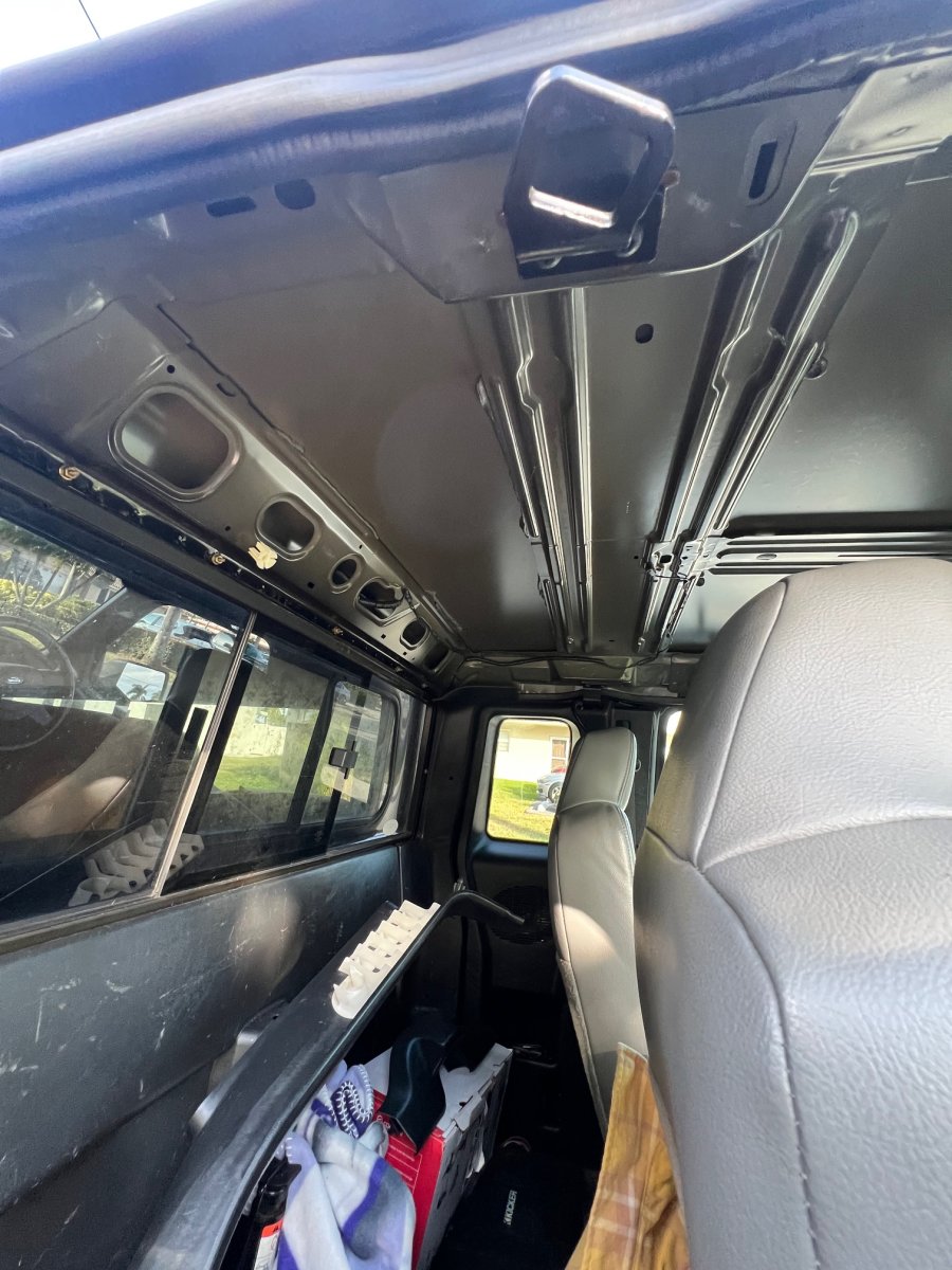

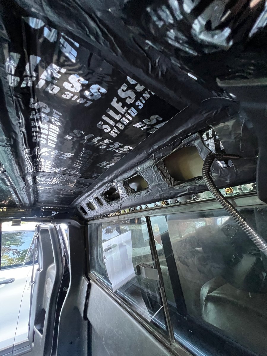

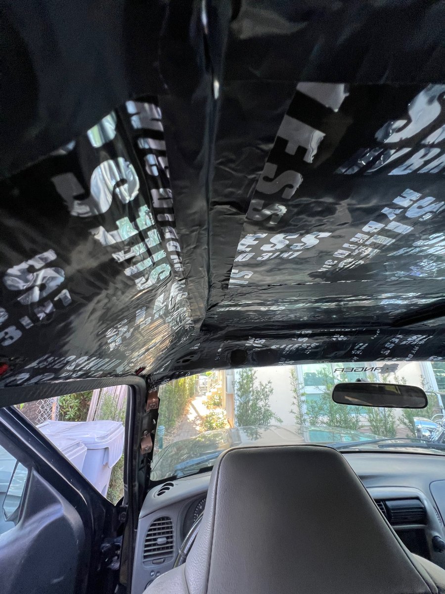

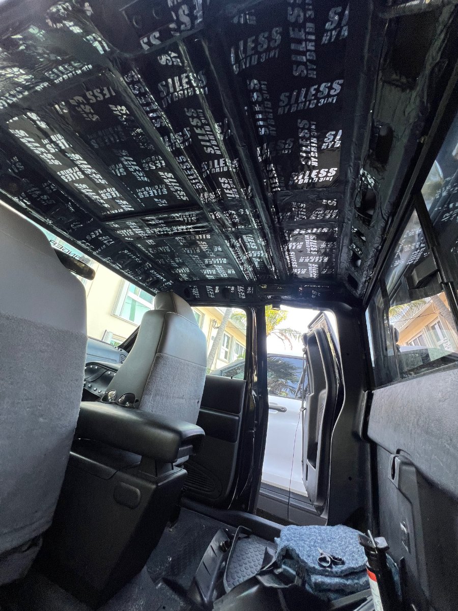

Here is following work from the last post when the headliner needed to be redone and other related work.

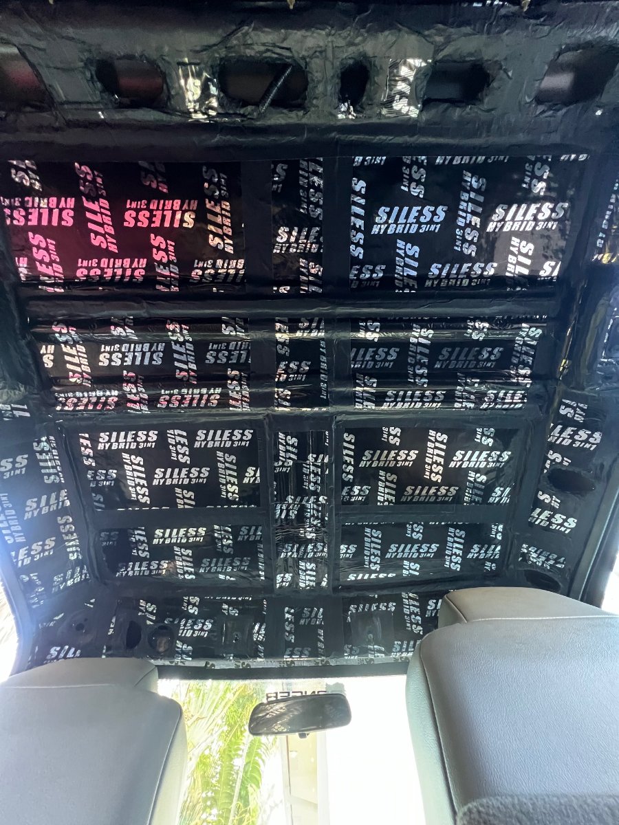

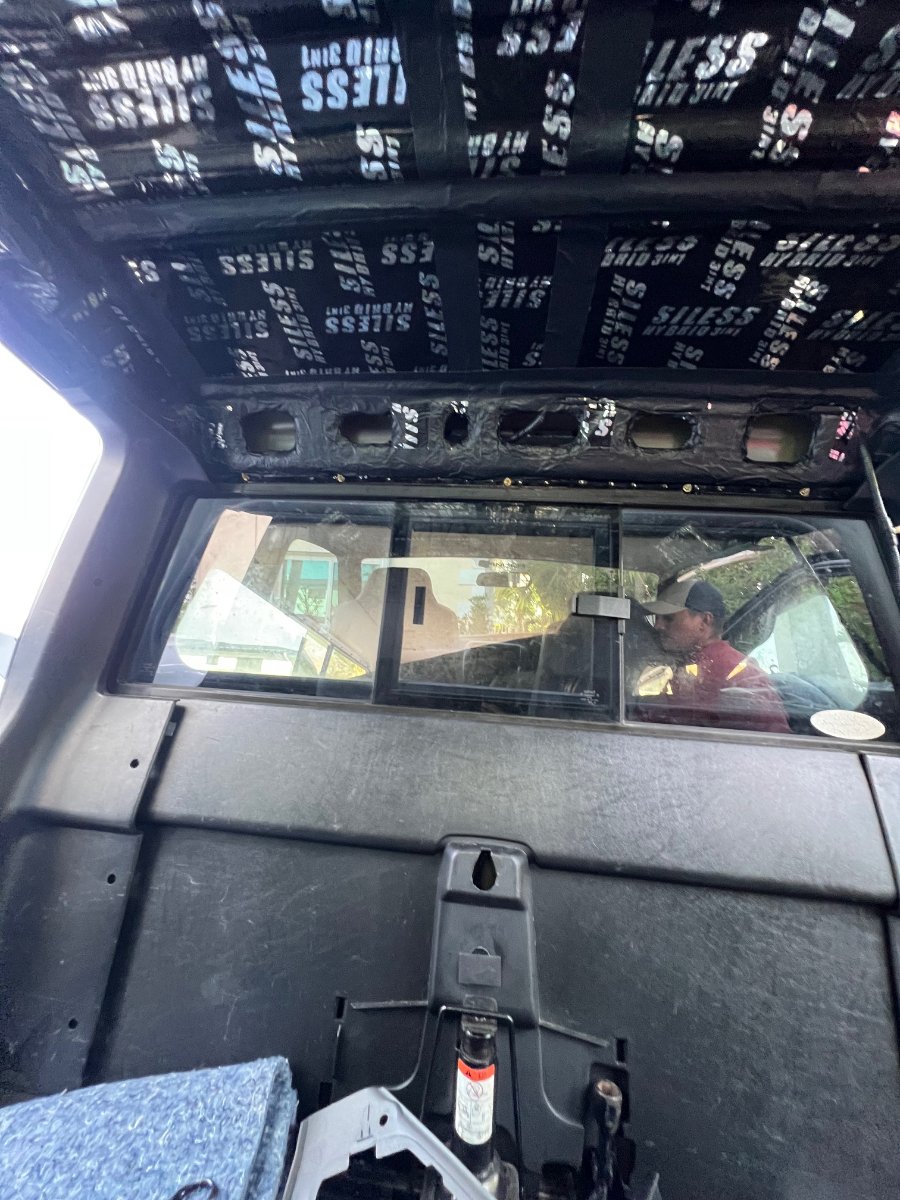

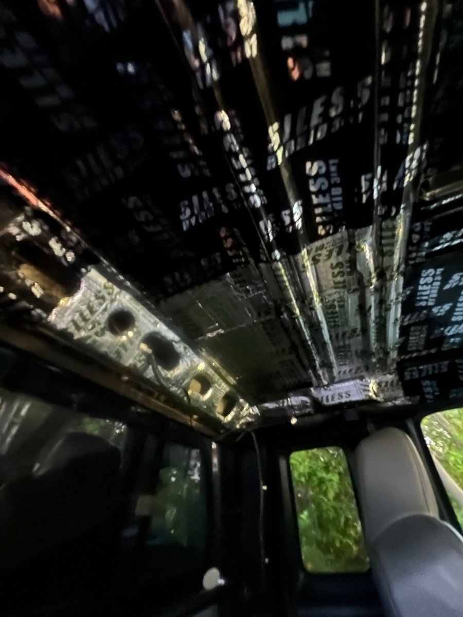

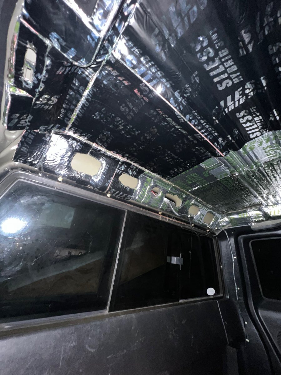

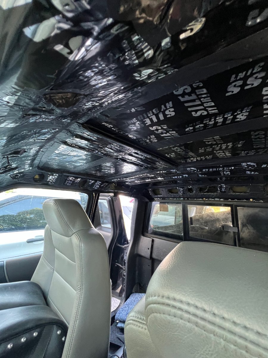

First was the two layers of sound deadening. First layer was Siless Max 120mil and second layer Siless Hybrid 200 mil. Followed by black foil tape on all seams, borders and openings. Still have a lot to do, need floor, doors and dash

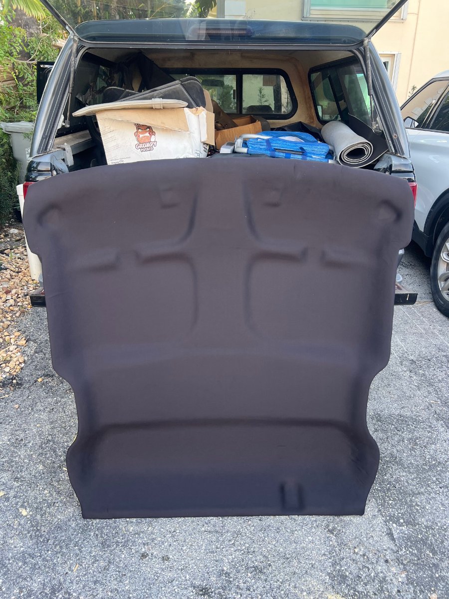

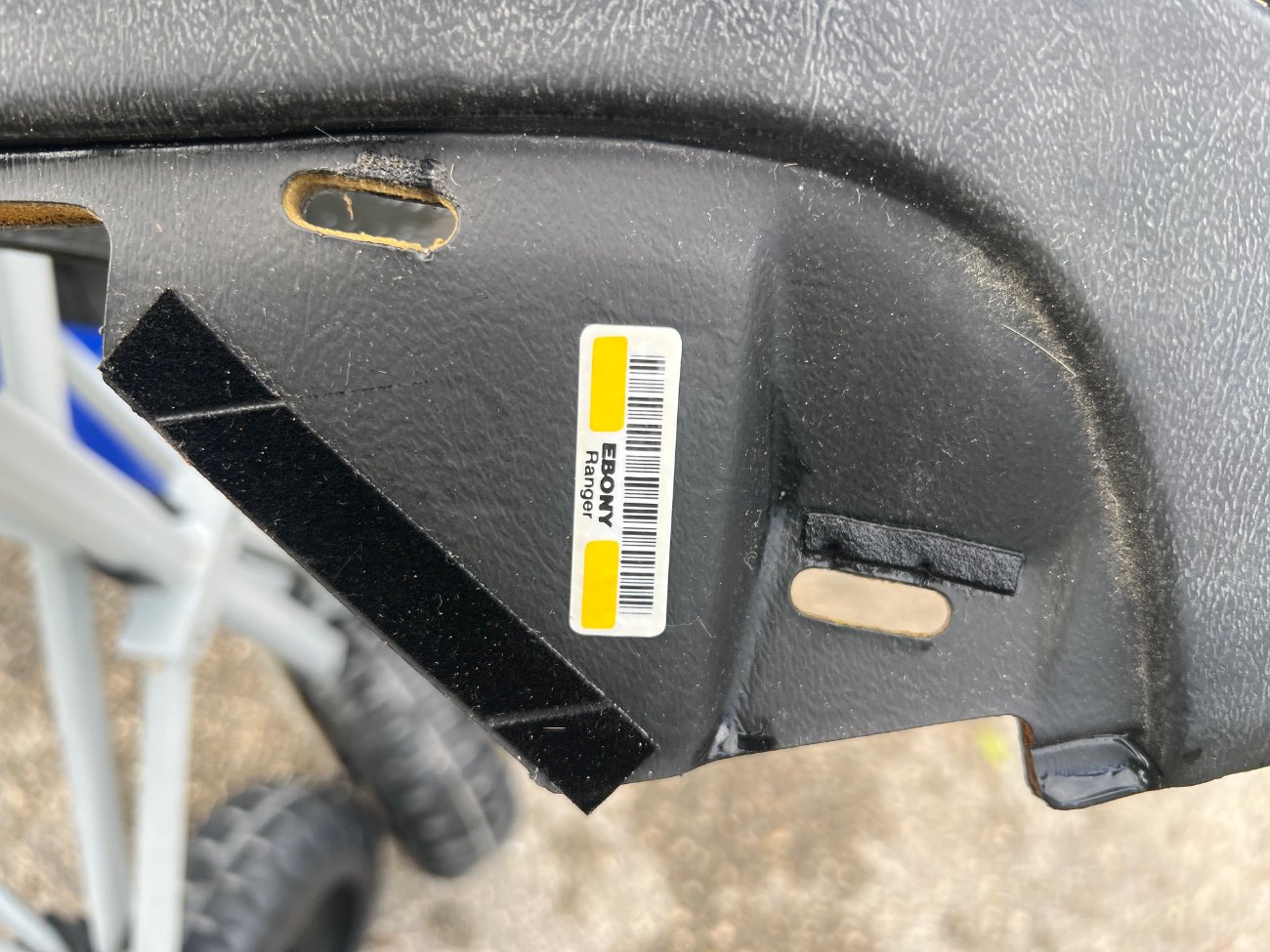

Headliner redone in Ebony Knit. Went with Ebony to match the interior swap because it FX4 Level II came in "Ebony". Got it from Fabric Empire on Amazon and really happy with it. Gives a lot more updated look and feel because of the foam backing and knit. Still not a 100% happy with the install but a lot better then the first attempt.
The other issue was because I added two layers of sound deadening the ridge foam backing of the physical headliner had to be shaved down. Isn't an exact science on the amount needed to be removed just install, uninstall, remove foam and repeat.
Started on the visors but need to paint all the mirror casing, trim and random parts that were tan. Need to figure out how to paint/dye rubber for the Homelink buttons 🤔.

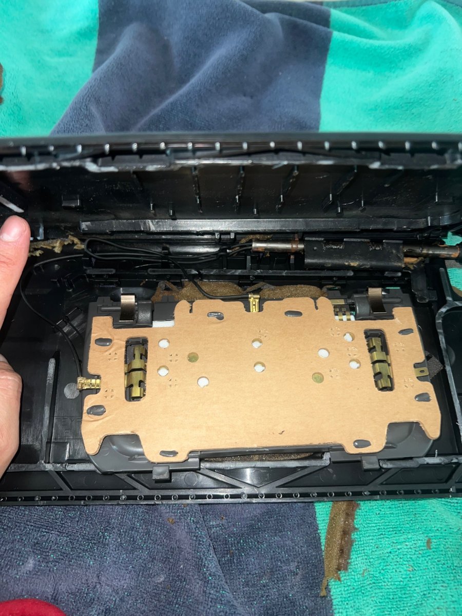

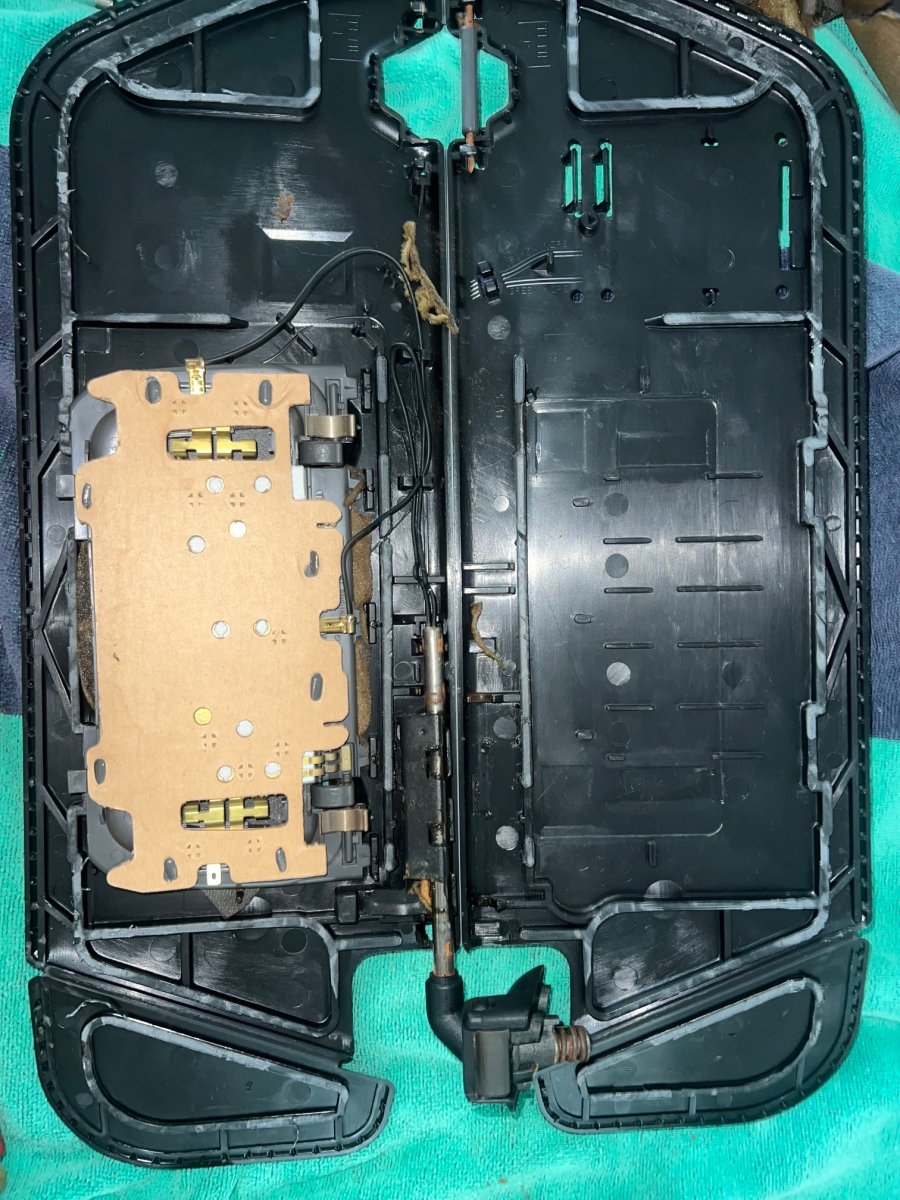

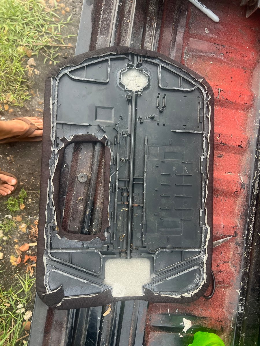

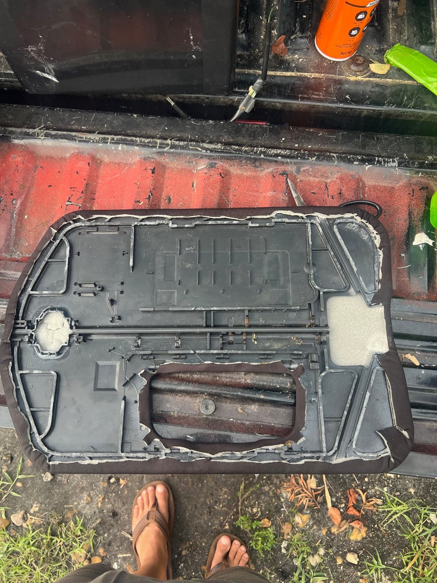

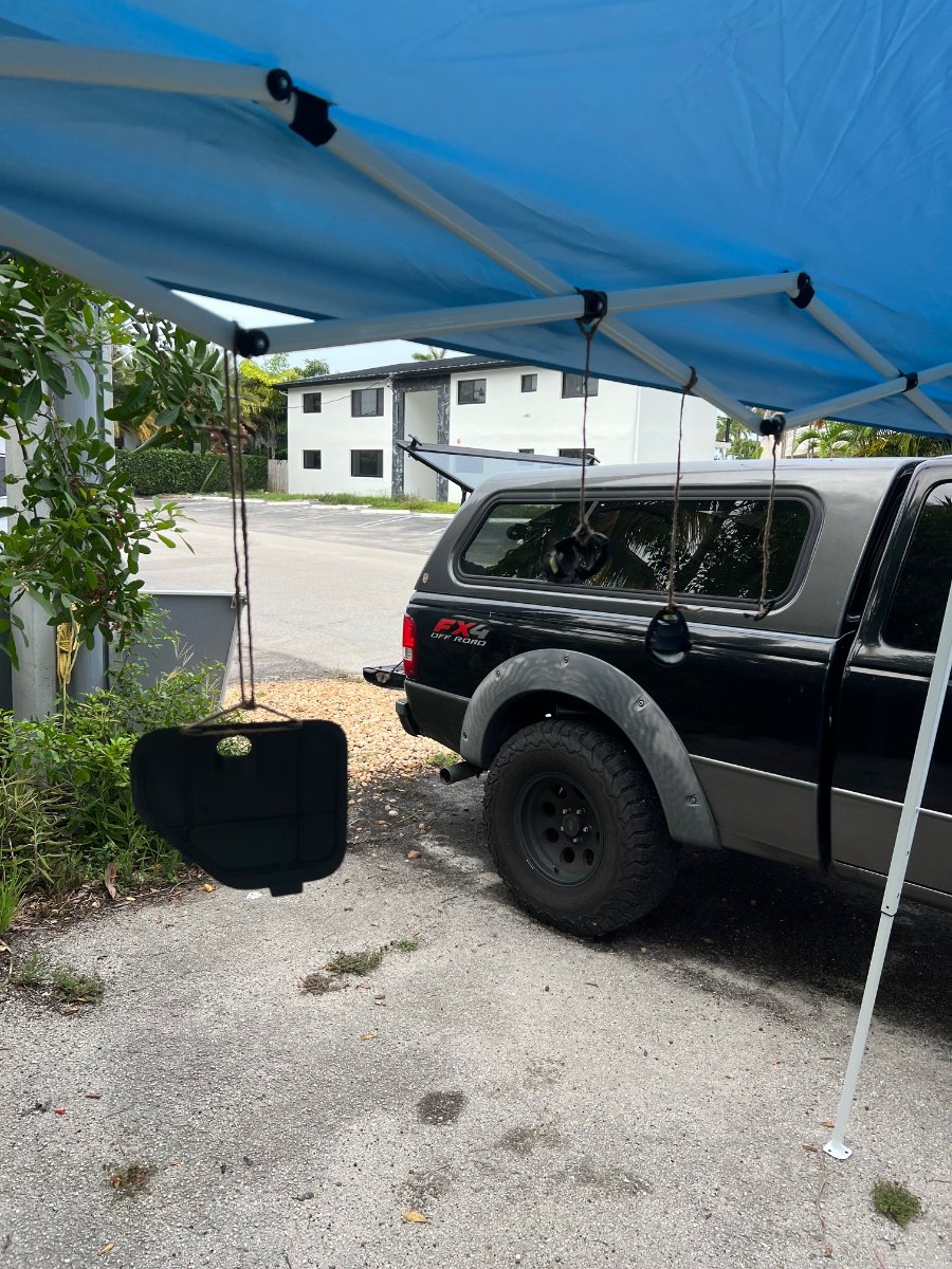

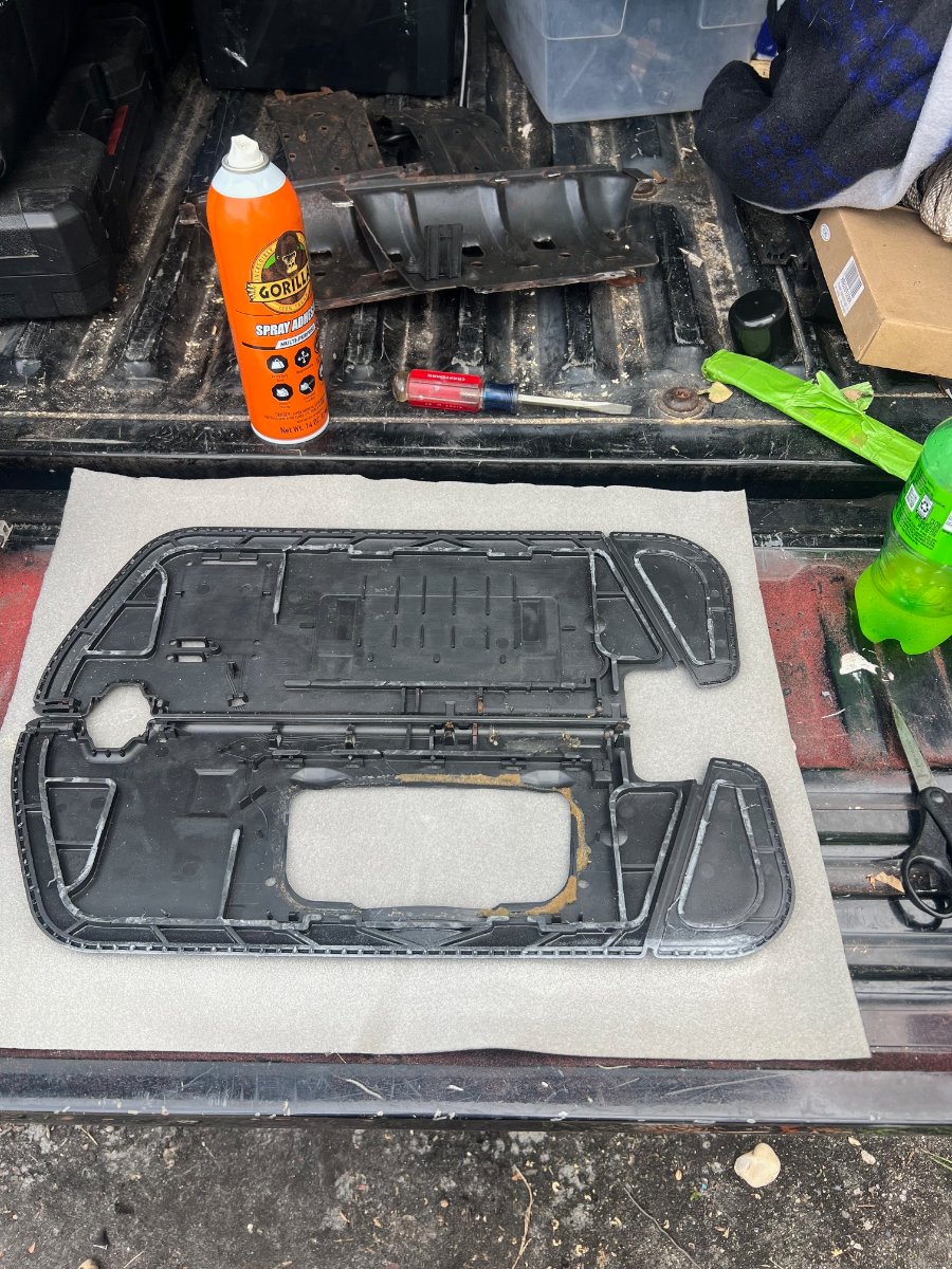

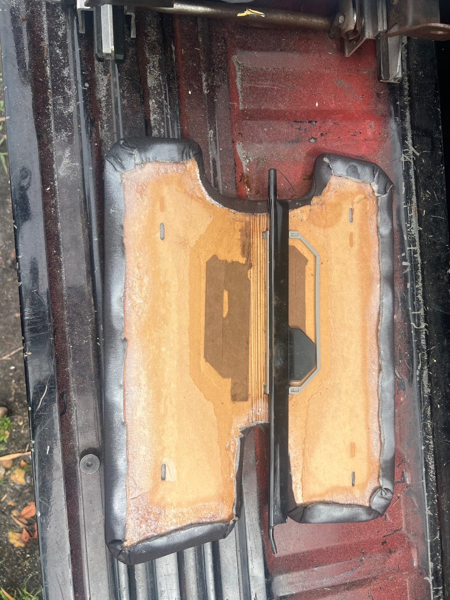

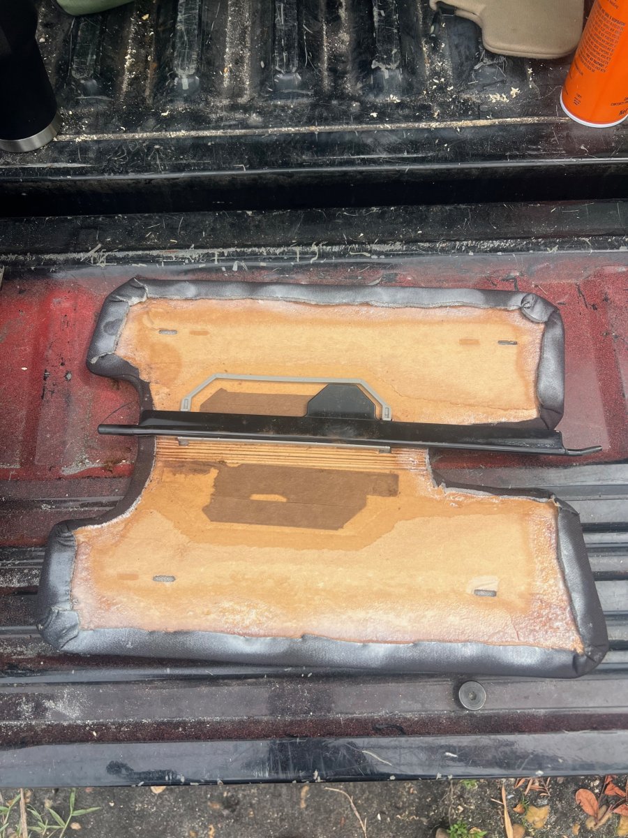

After the headliner, started working on the visors. As mentioned before the visor needed to be pulled apart in order to replace the fabric, more on that here. This has been very slow moving on the visors with the mirrors, lights and homelink. I want to look as OEM as possible and that is making it harder on myself. Which has had me go through three sets of visors currently.
The smaller cardboard is no issue and is ready to be glued back together.
I have had issues with removing the sticker on the mirror, deciding how to get all the trim to be black and the matching the new fabric to the old to allow all the trim and hardware to be reinstalled. Have experimented with dye and different paints. While I am still working on getting the sticker removed, I did decide the best option is to paint it. I will be using SEM Color Coat in Landau Black. From what I have researched it is the best match to factory ebony/black and is a highly recommended product for changing color on interior pieces.

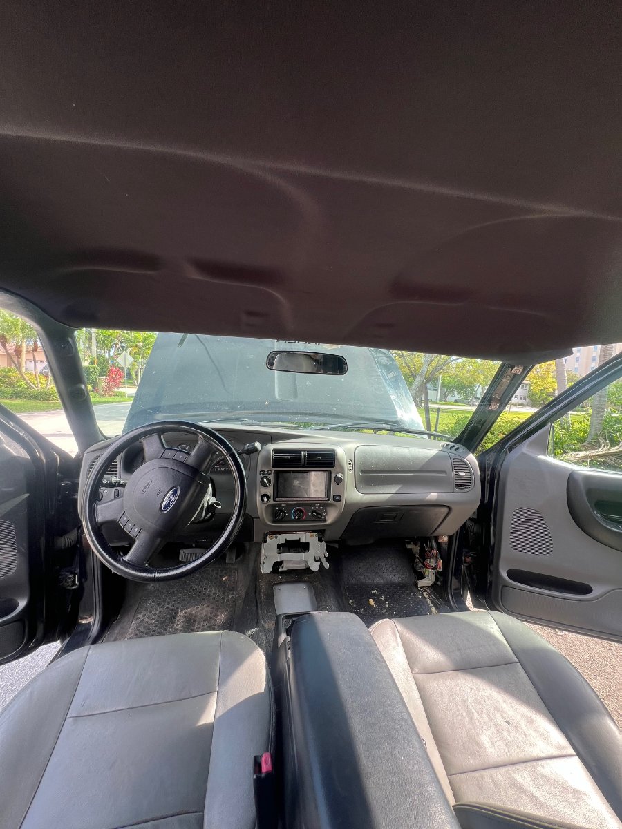

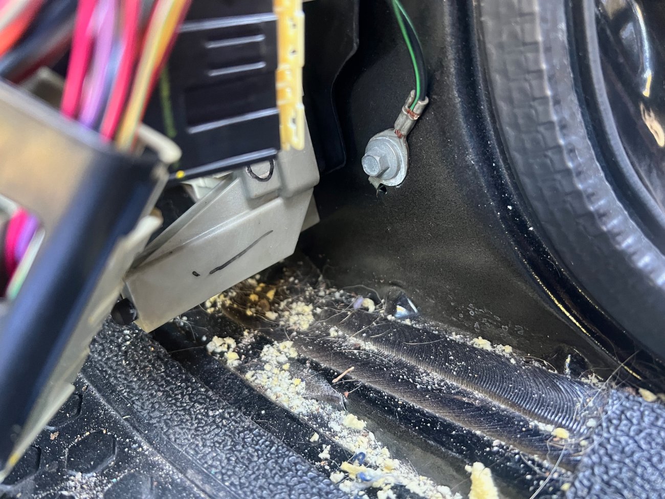

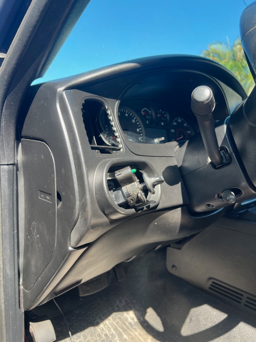

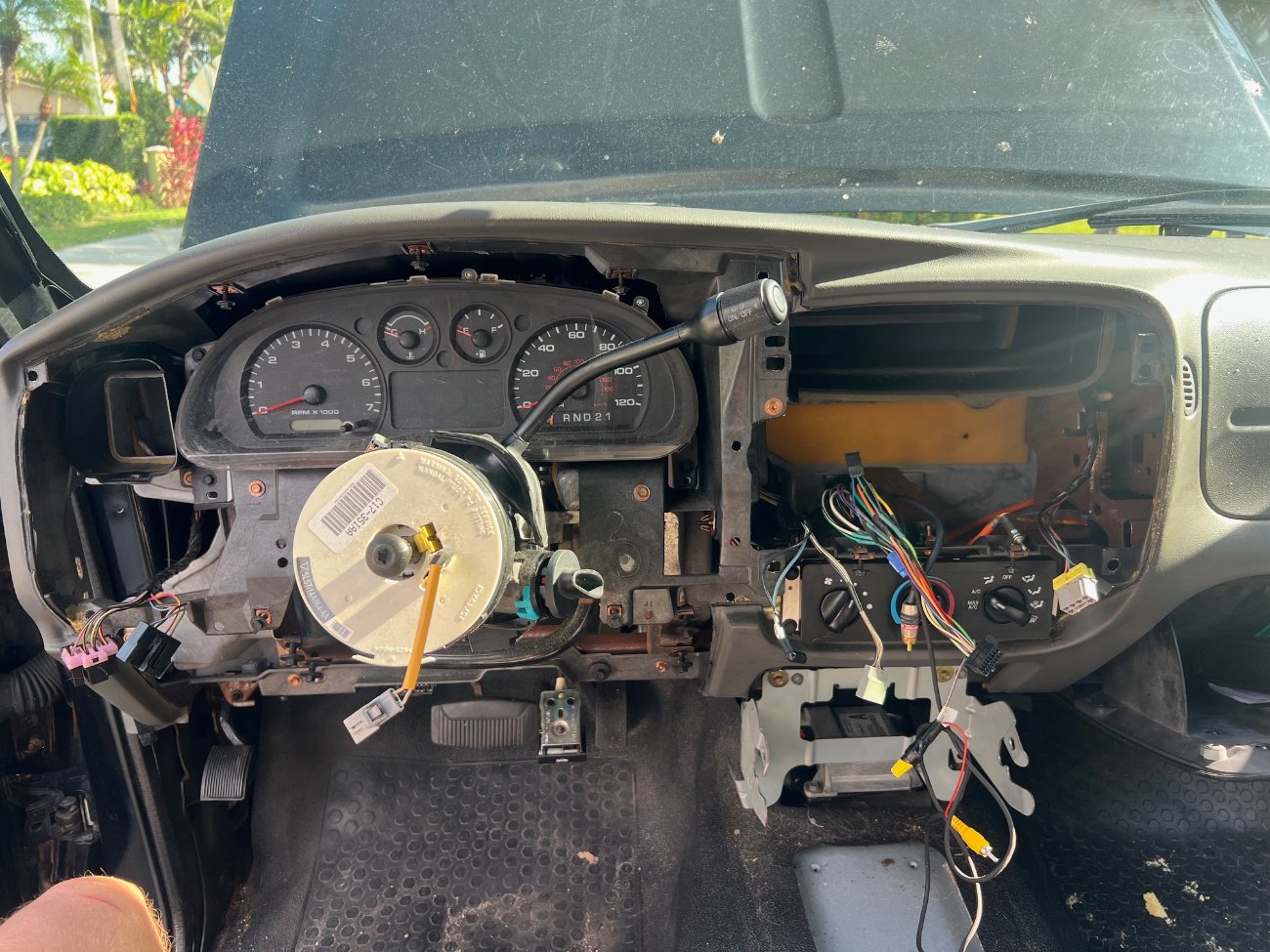

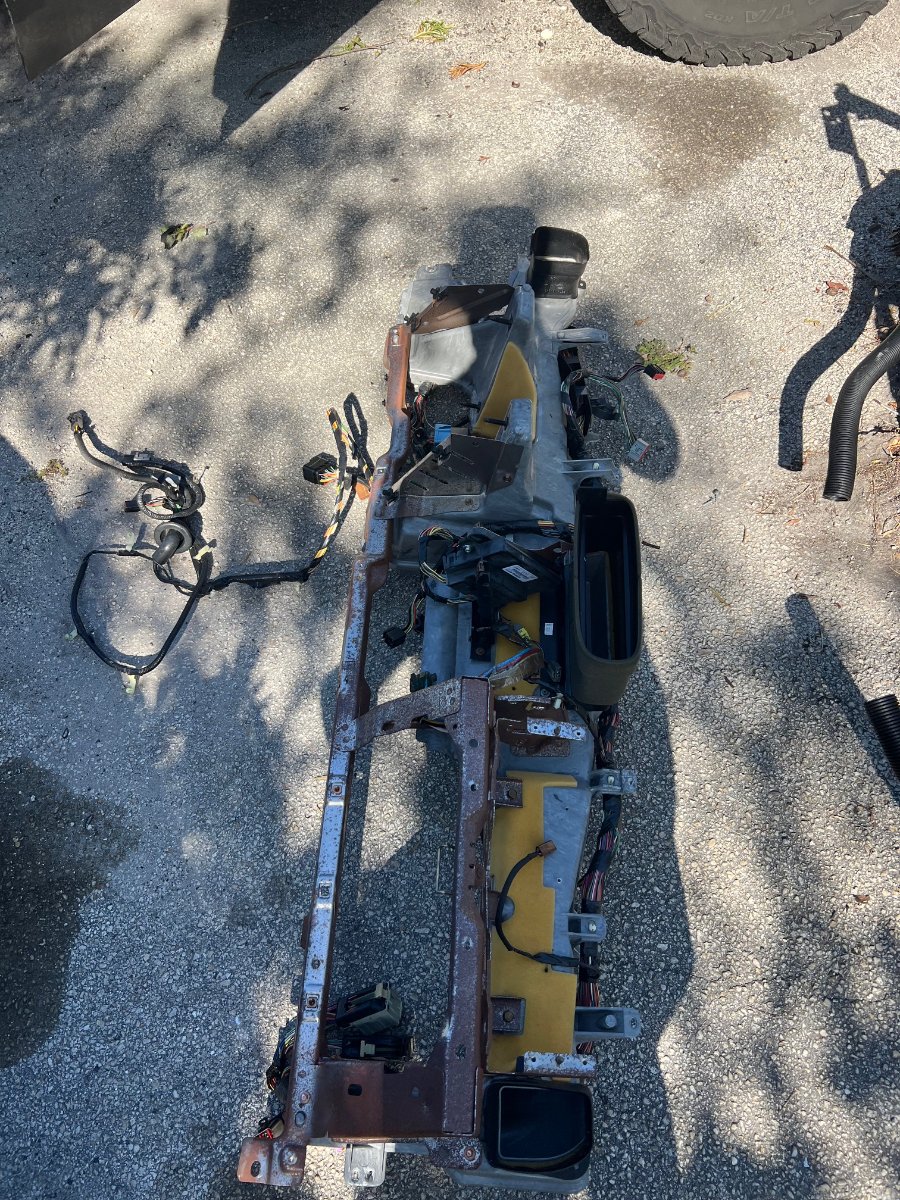

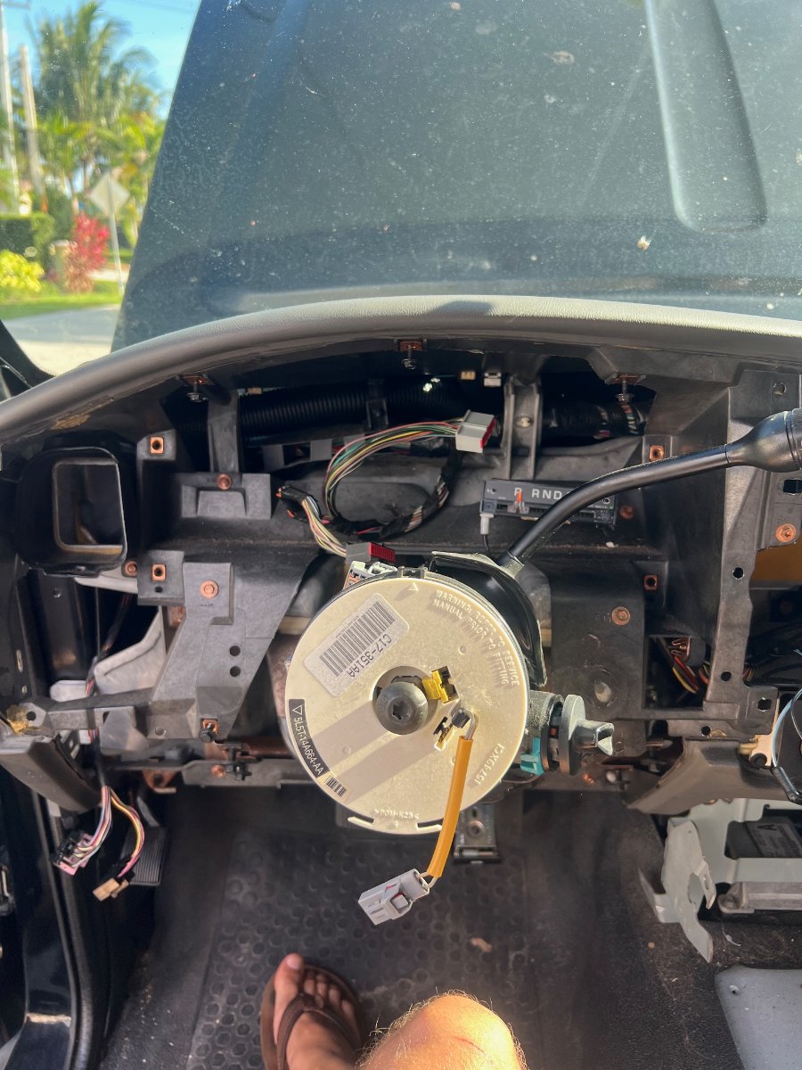

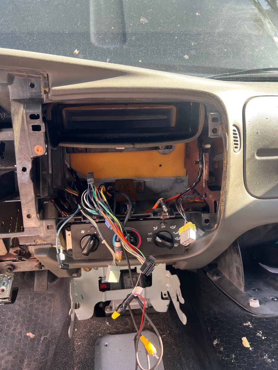

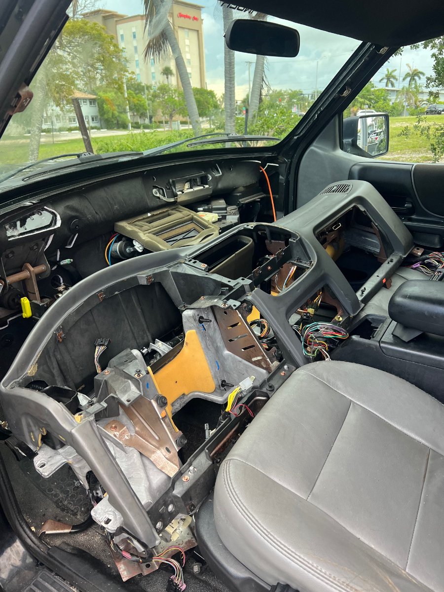

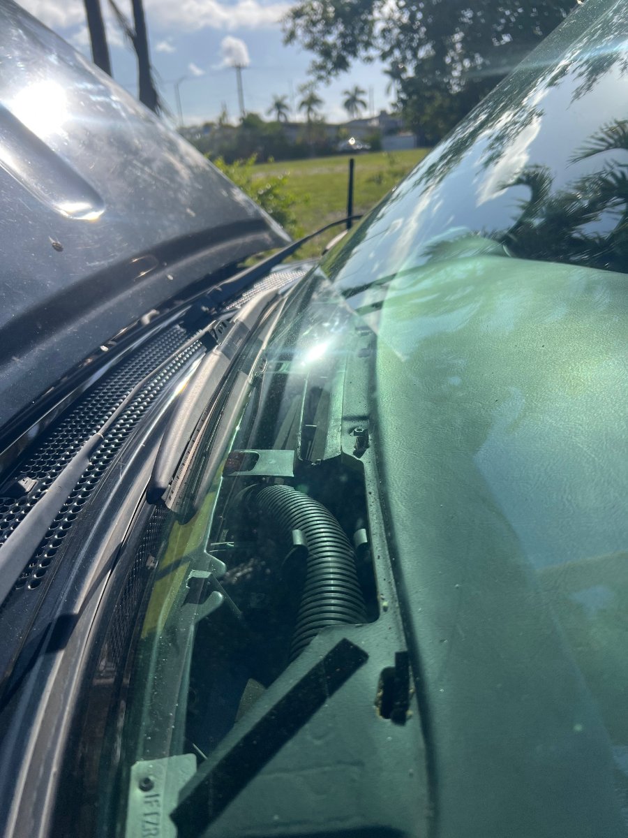

As I worked on the visors I started the interior swap from the standard grey to the black Level II. The biggest to overcome is the dash. When I pulled the black from the junkyard I learned a bunch and also that the skin of the dash could be removed and swapped to my dash. This helped a lot because it made it so i didn't have to worry about any wiring issues or difference of truck years.
Since there isn't a how to remove the dash, I do want to write one up but here is a quick overview of what to do and how I did it with a few pictures
  • Remove negative battery cable
  • Depending what center console you have remove it if attaches to the dash
  • Remove and unplug radio and ac controls
  • Remove glove box
  • Remove airbag
    • Two bolts on the bottom
    • Not needed it to be removed but didn't want to worry about any airbag issues
  • Unplug all connectors at the kick panel
  • Remove grounds by passenger kick panel
  • Remove OBD, hood release and parking break release
  • Remove dash knee plastic trim and metal
  • Remove steering wheel and column
    • Isn't required but highly recommended if by yourself because of the weight
    • Remove airbag two screws, one on each side of the steering wheel
    • Unplug the airbag
    • Remove the steering wheel with a torx bit
      • I was able to get it off with just pulling on it multiple times
    • Look under steering column and start unplugging any connector attached to the column
    • Unbolt the steering shaft
      • It is a single bolt about 6 inches from the firewall
    • Unbolt the 4 bolts holding the column to the dash
    • Remove the entire column
  • Remove and unplug headlight and dimmer
  • Remove instrument cluster trim
  • Remove black trim piece along the windshield
  • Remove two bolts on the driver side
  • Remove one bolt on the passenger side
  • Remove four bolts along the windshield
    • Will need a 12" extension
    • Leave one bolt in so it doesn't fall
  • Remove the dash

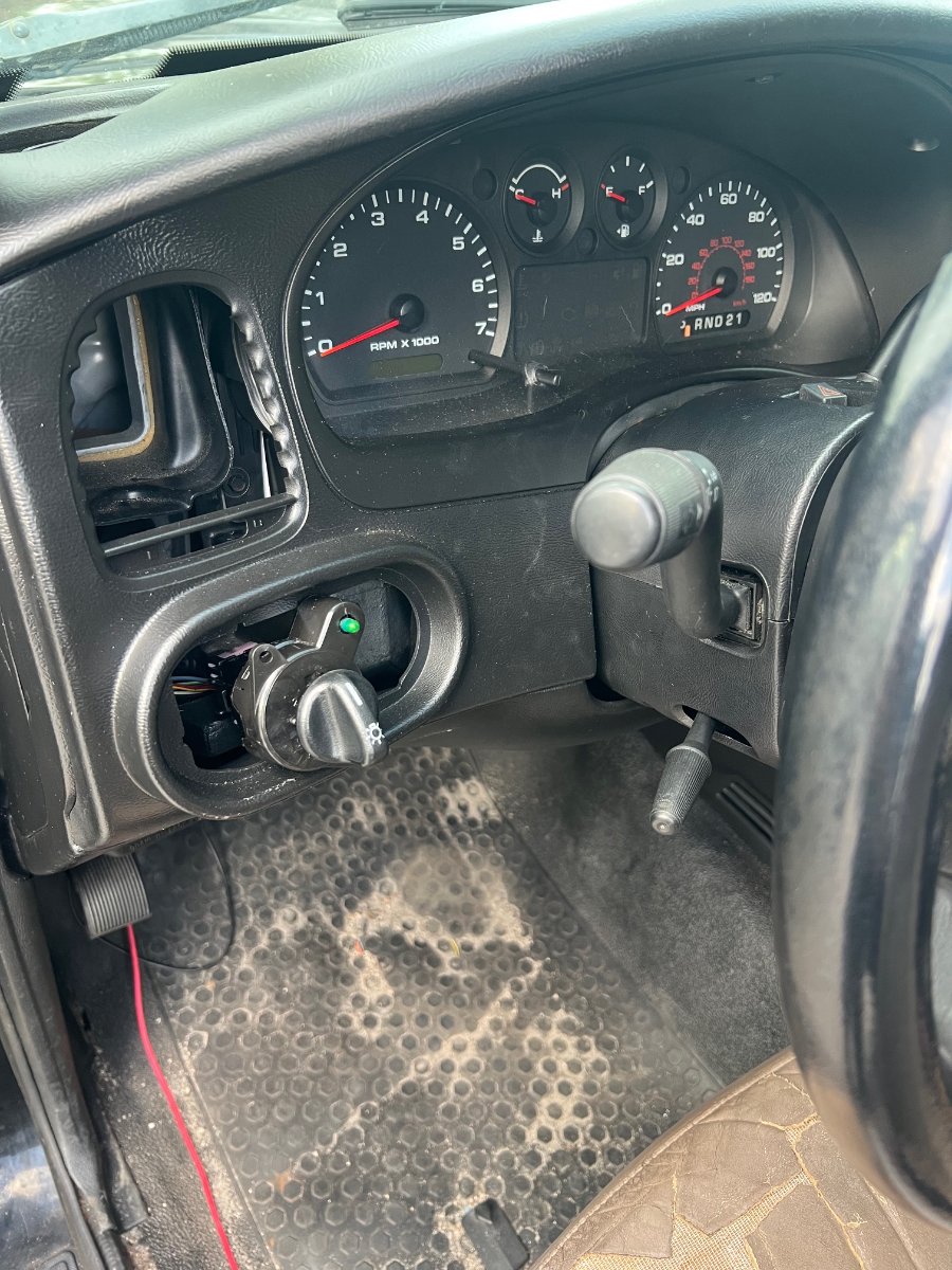

Next was painting and swapping the black dash skin!

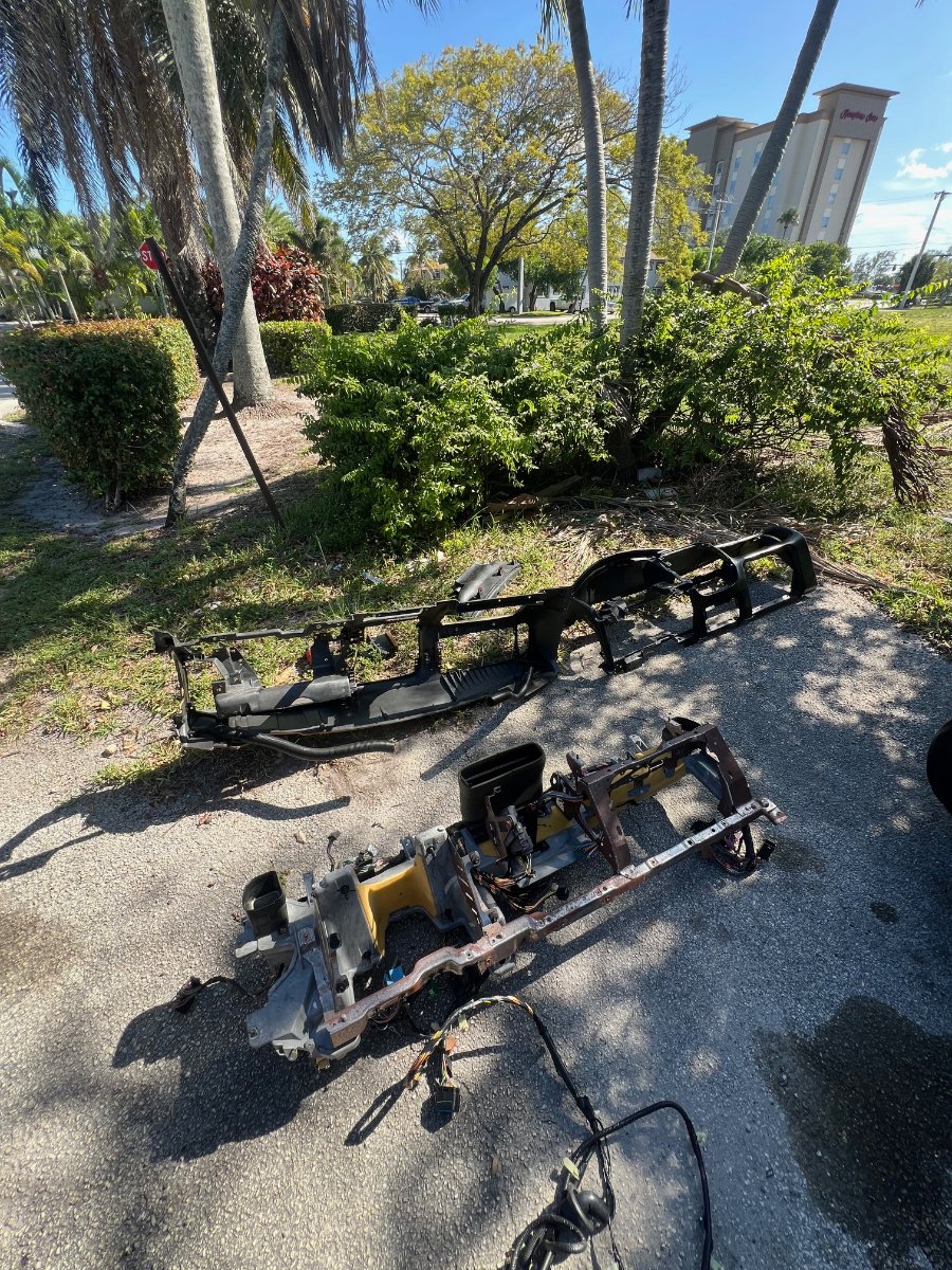

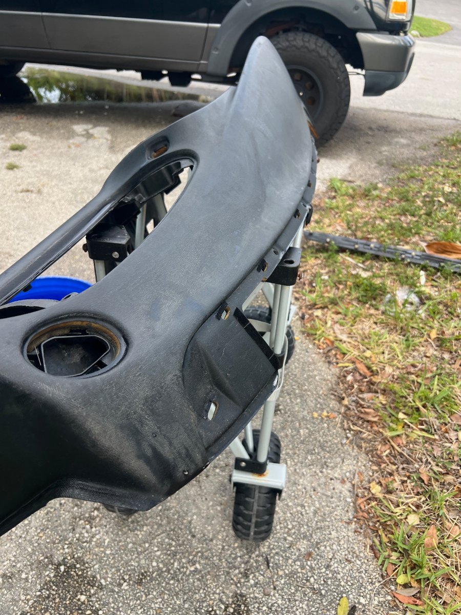

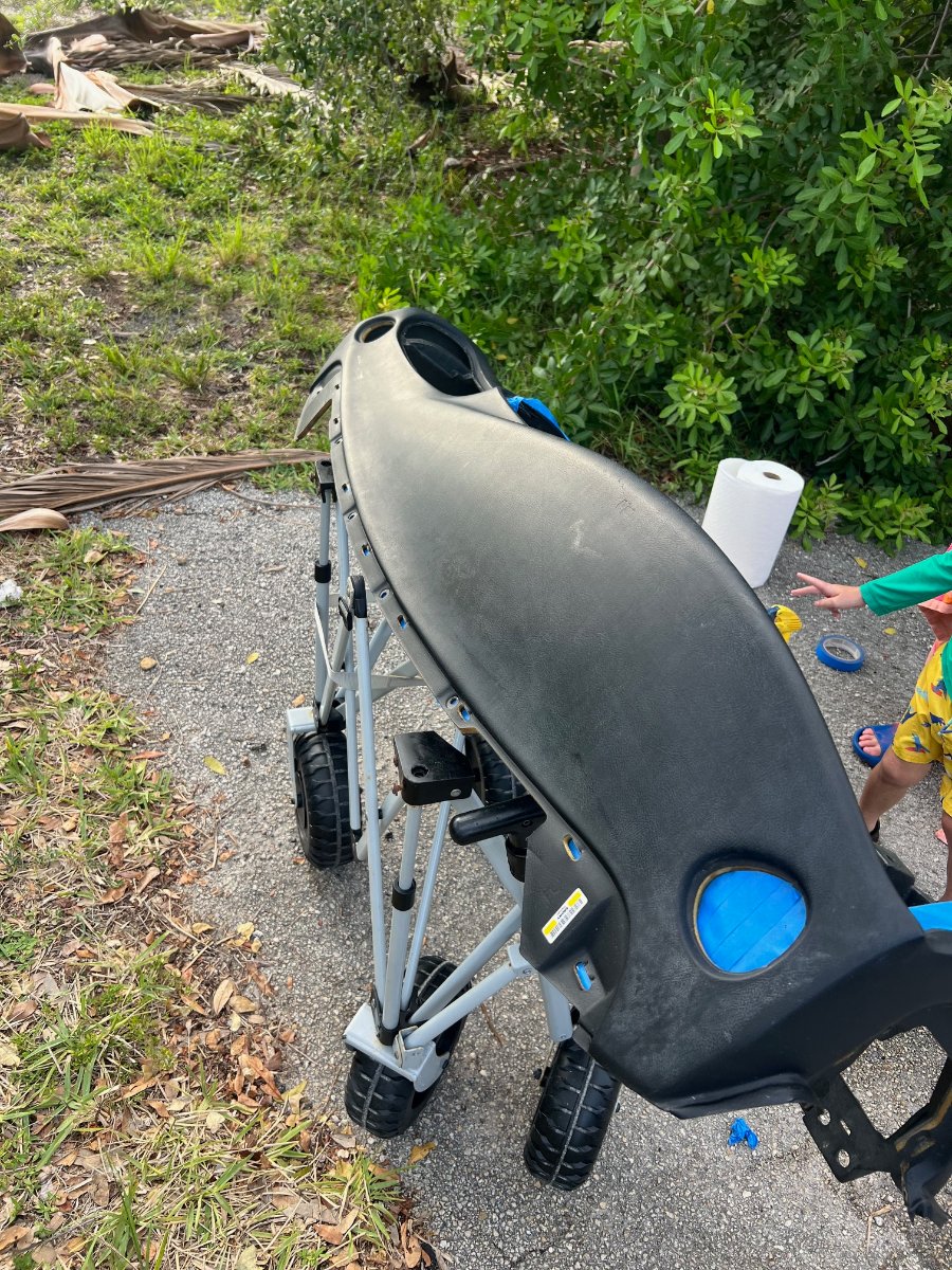

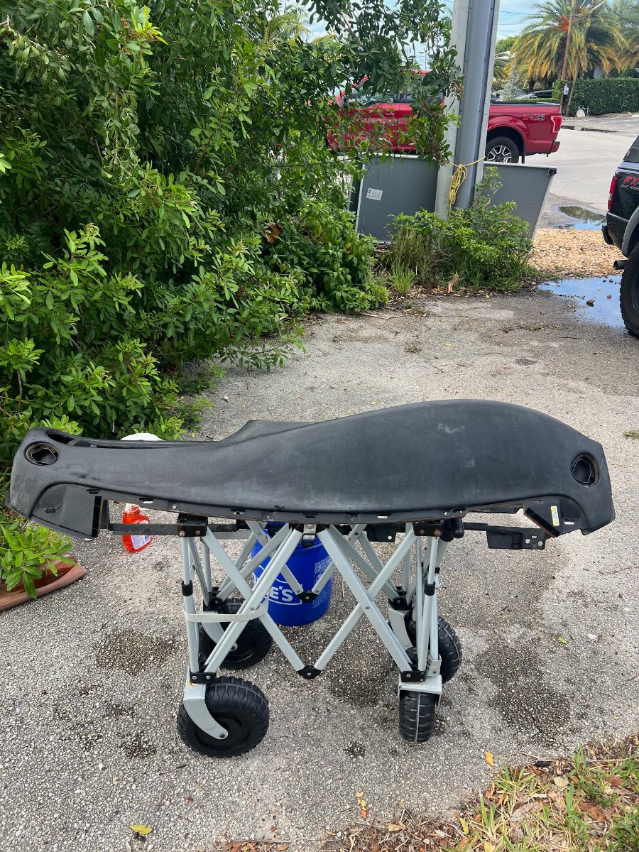

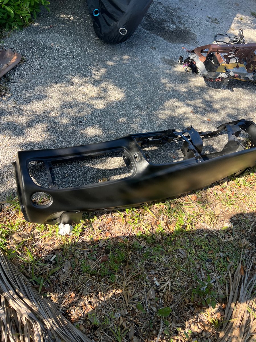

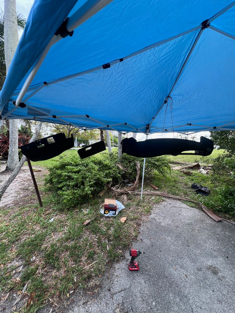

After getting the dash out I started working on separating the dash skin and support/frame. It isn't difficult because it is just about 15 or so screws on the back side and some wiring and ducting needed to be removed. But it is possible and makes it so I don't have to worry about any wiring changes from whatever year the Level II was in the junkyard to my 06.
Even though the Level II dash was black from the factory it did have a lot of color fading and needed to be painted. I did the research for prep and materials needed to use the SEM Color Coat I would be using on the plastic trim, luckily the SEM Color Coat works on vinyl!

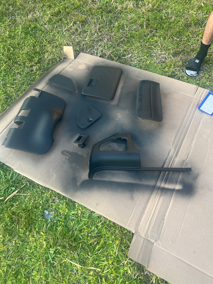

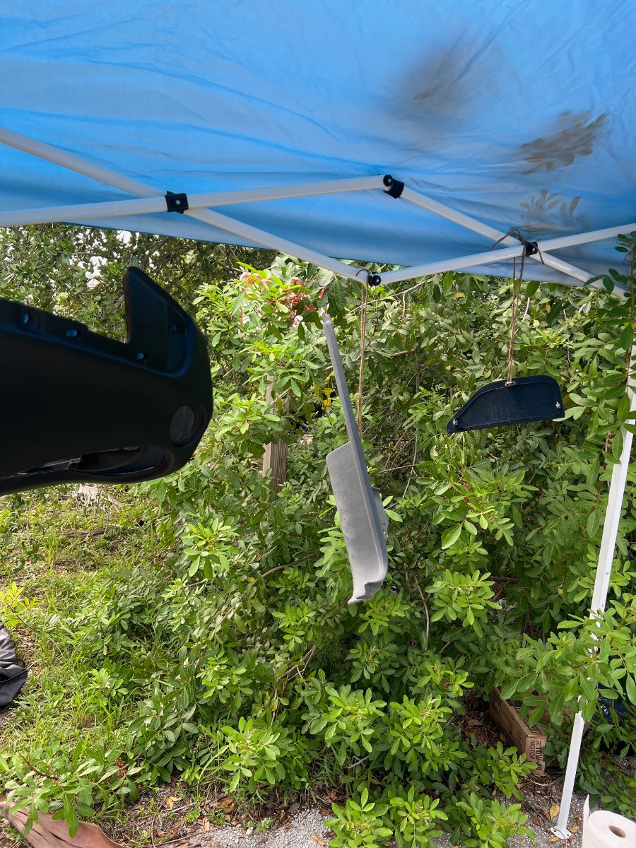

Along with the dash I will painted all the other dash plastic piece at the same time. This was the kick panels, vents, glove box, airbag, fuse covers and knee pieces.

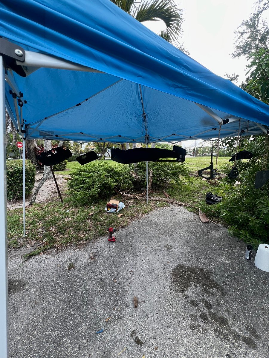

Prep included scotch pad, SEM soap, Vinyl or Plastic & Leather Prep, and sand free adhesion promotor or XXX adhesion promotor.
Nothing better then a make shift paint area out of canopy! 🤣🤣

Overall the paint when well! The paint is really impressive is the color match to the existing Ford black is almost if not perfect. I did learn it does need to sit for days or even a week before it is reinstalled. I installed a couple pieces after about 24 hours and then did scratch. After this I talked to customer service and they said the longer the better before installation. So I waited on the rest of the pieces and now I have zero issues.
A couple of the vents will need to be stripped and redone because I didn't like the end result because they were painted with too much humidity.
I do need to touch of the pieces but that is for another time because the dash looks so good the rest of the Level II interior pieces don't match and you can see all the wear, tear and fading. But that isn't on my top priority.

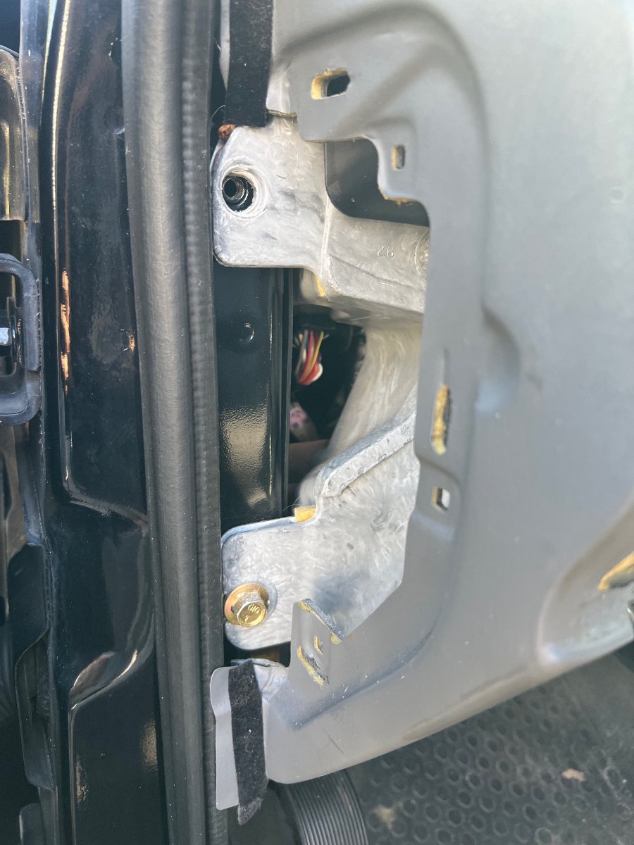

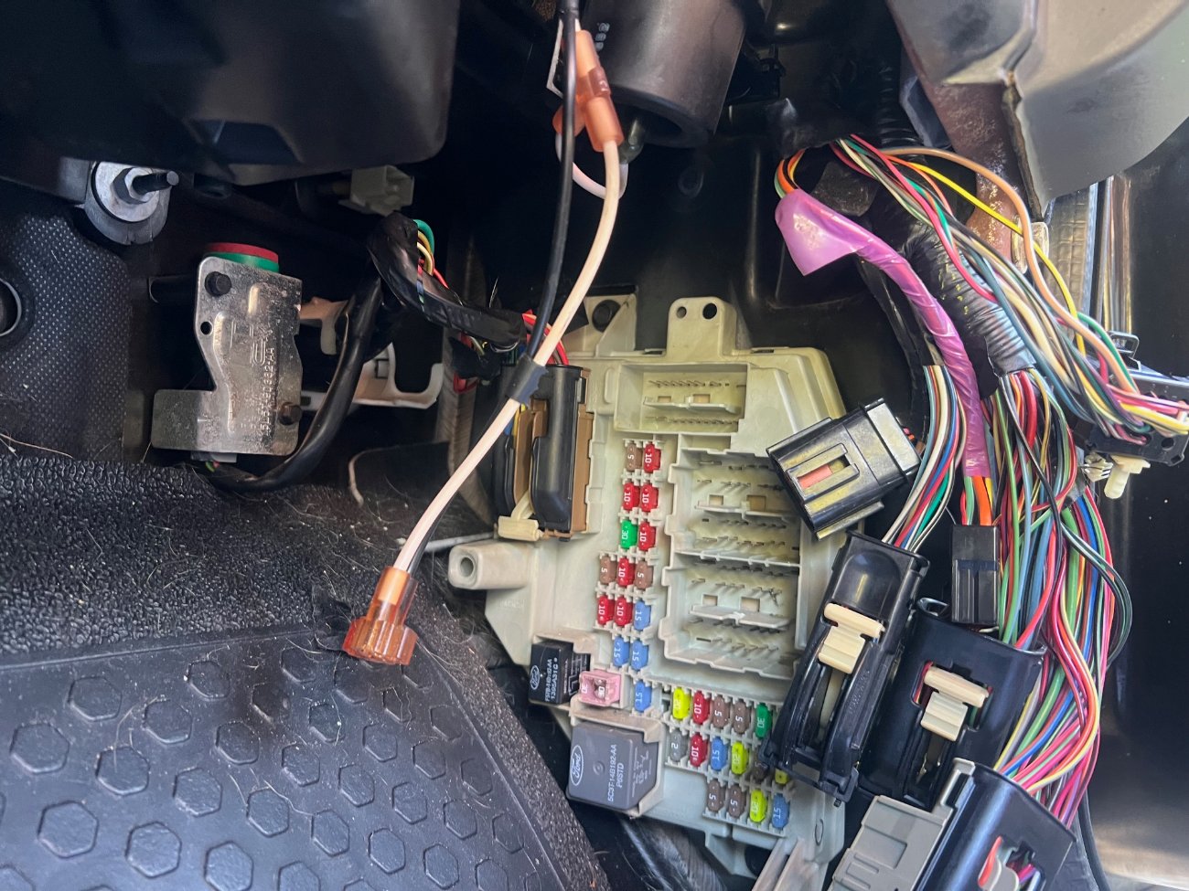

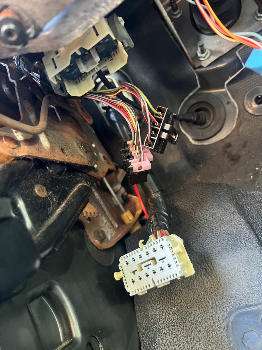

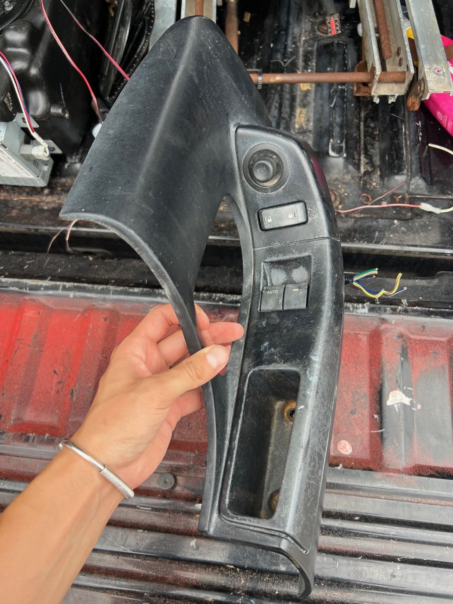

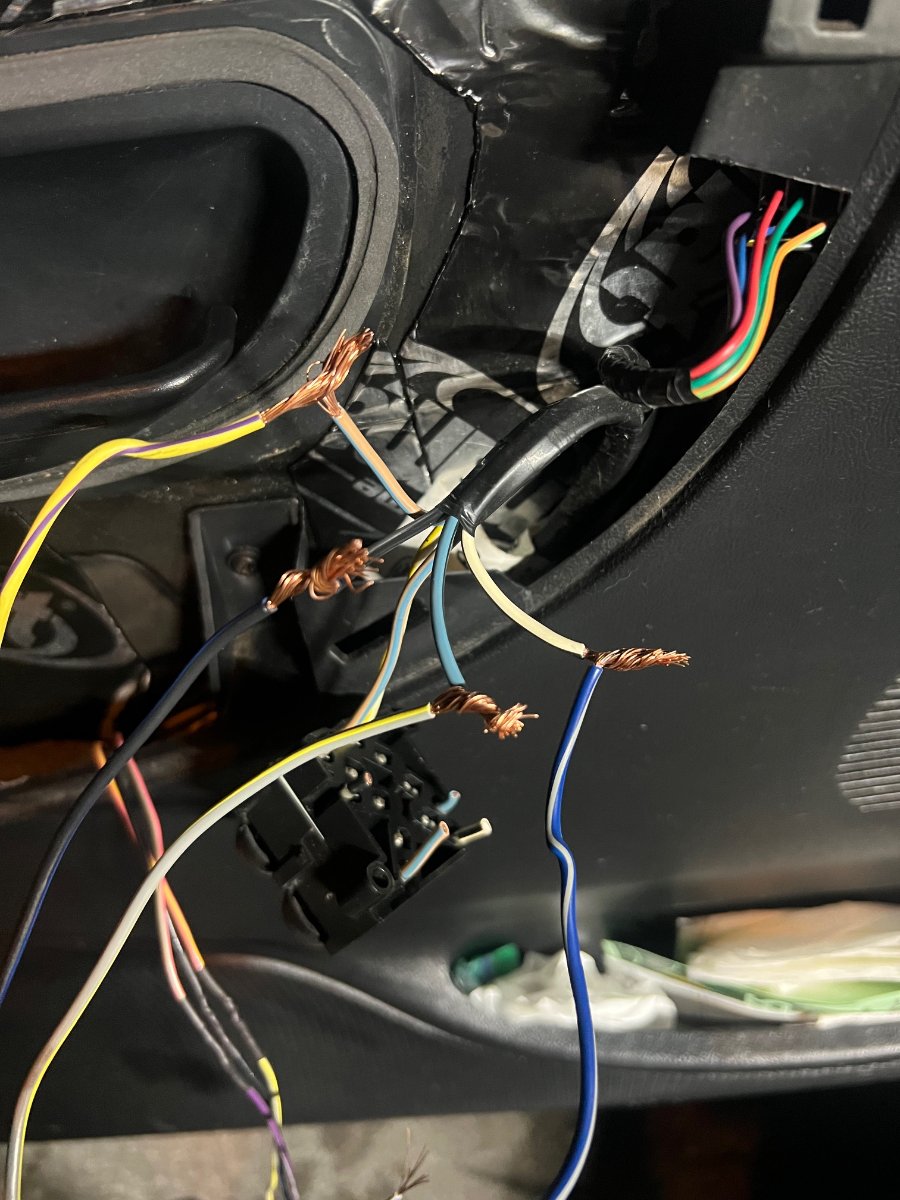

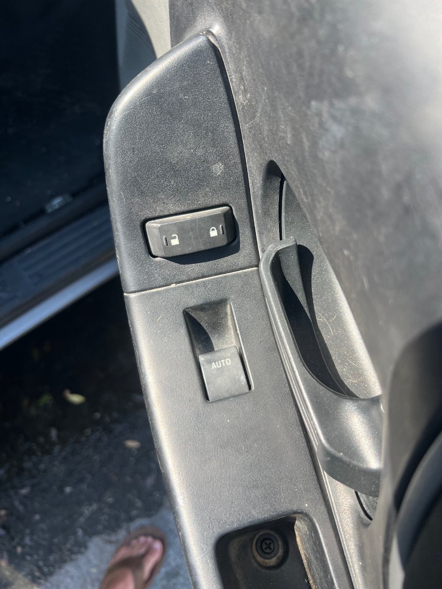

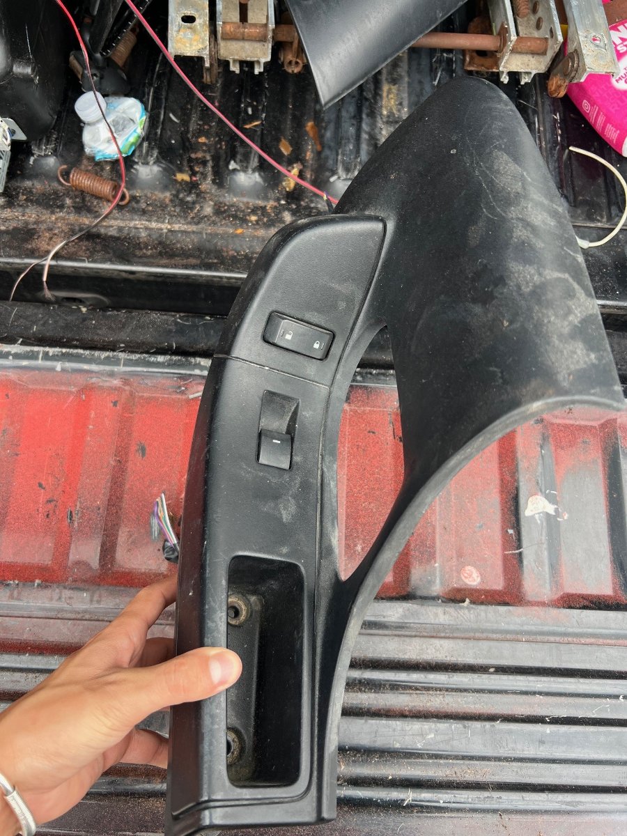

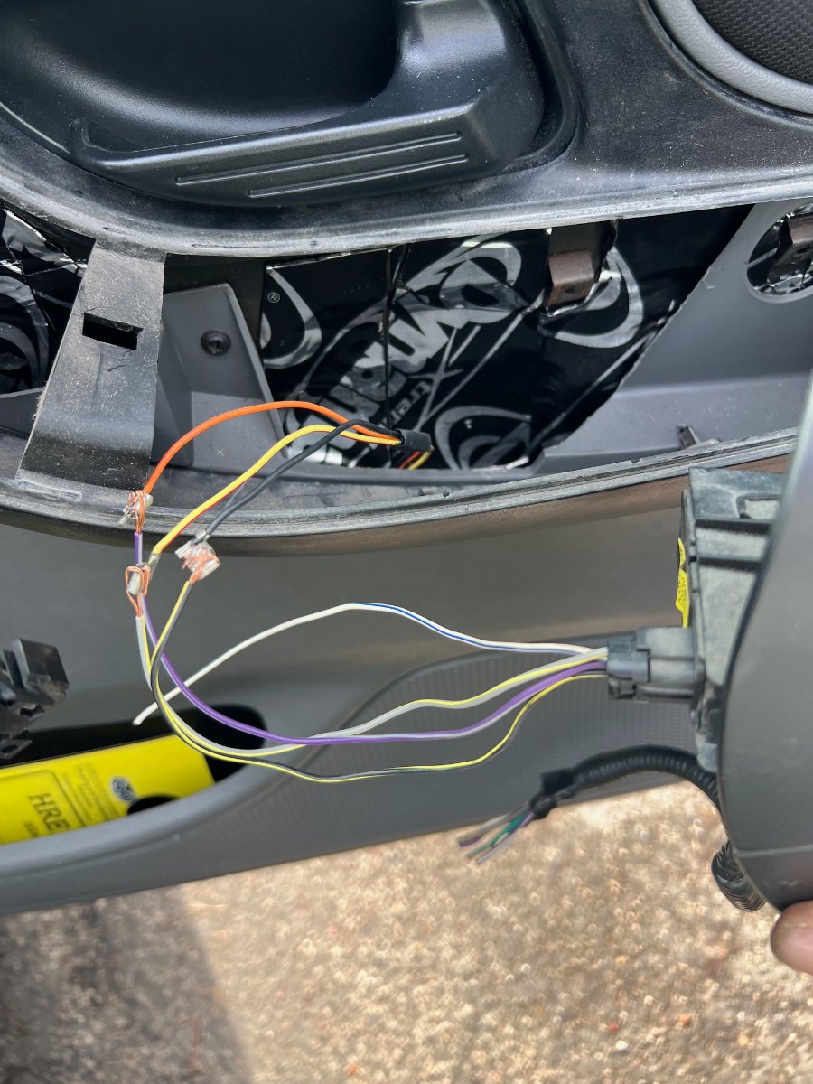

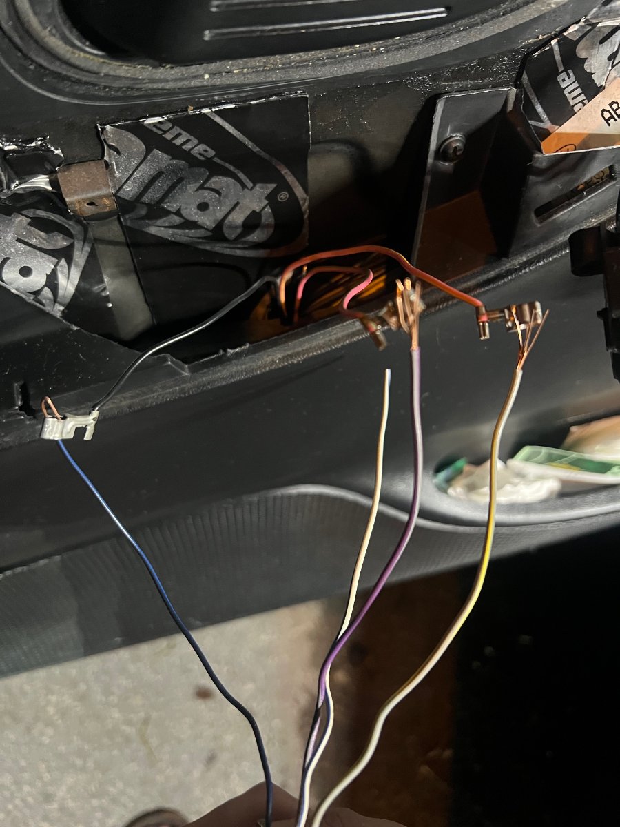

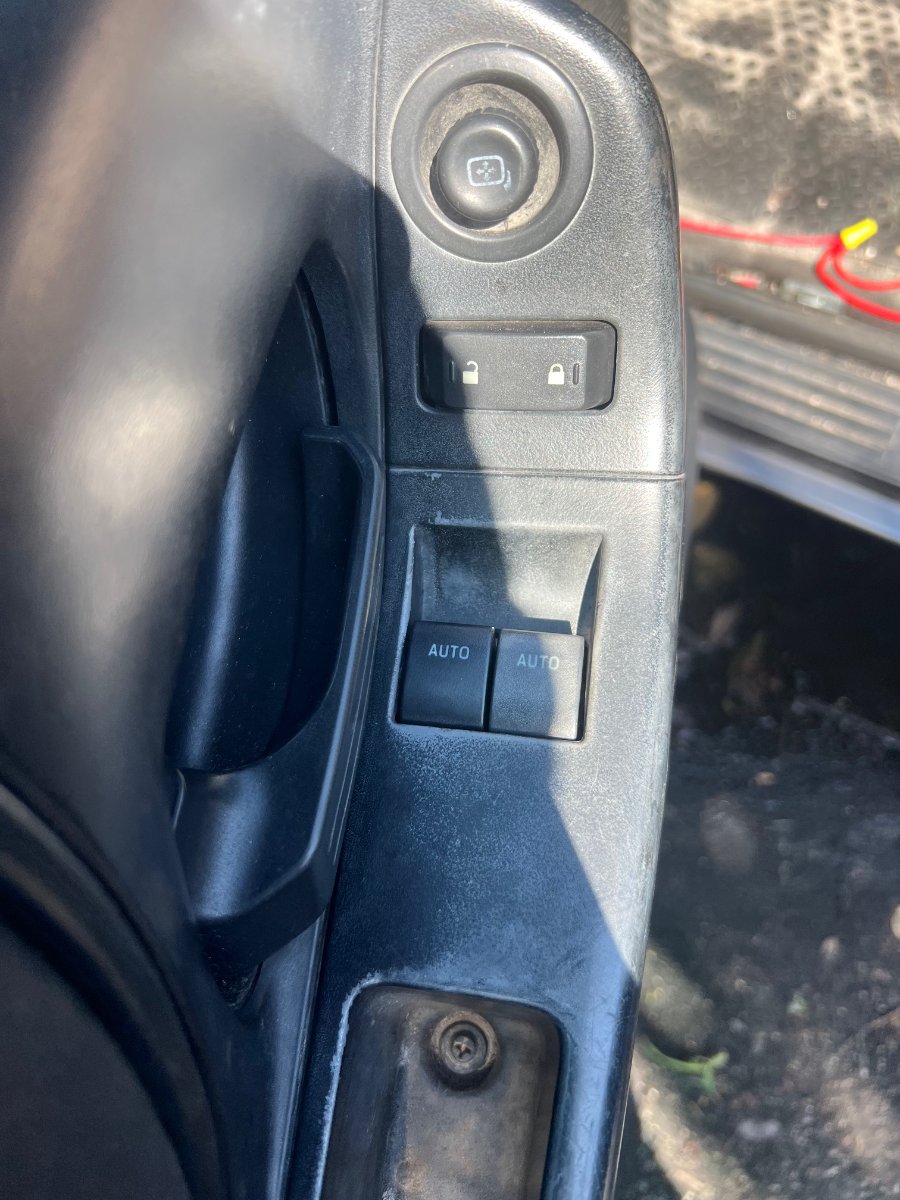

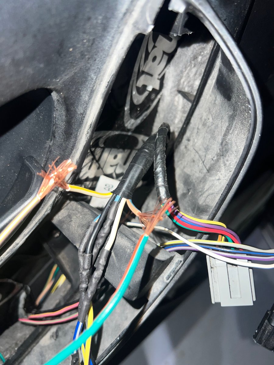

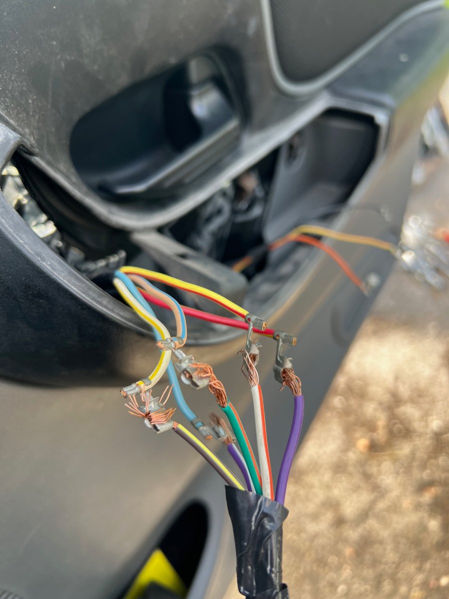

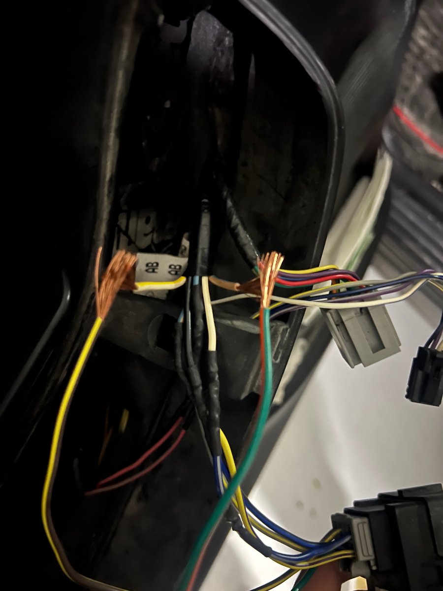

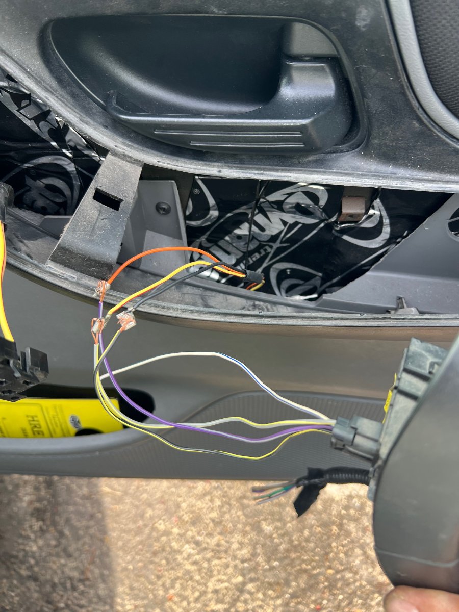

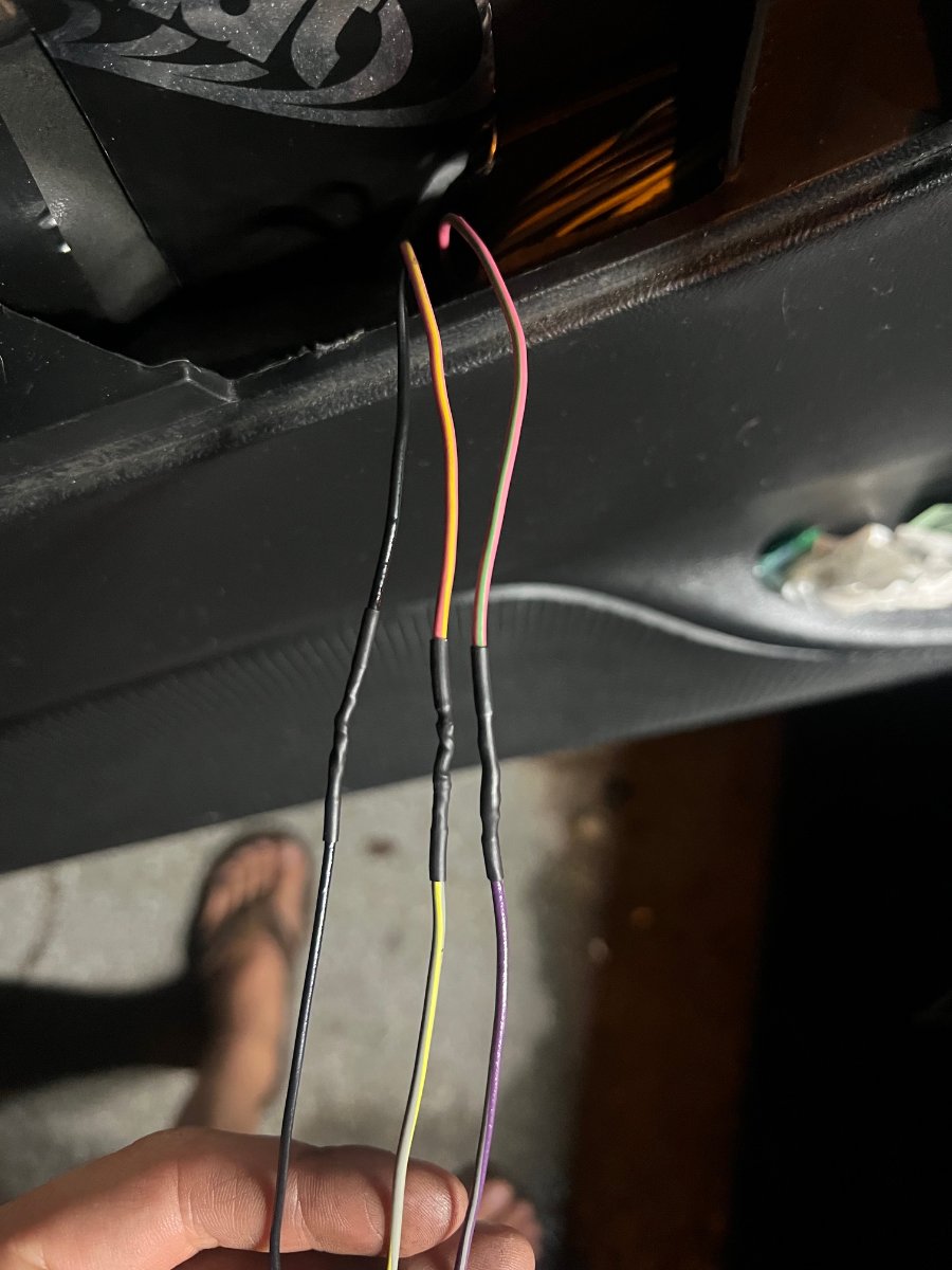

Next item I worked on was swapping the lock, window and mirror switches and trim pieces from 07+. These are when they redesigned the switches to a more modern look and I think it was also when a lot of other vehicles got these switches because I have seen the style in Super Duty's and F150's at the junk yard.
Overall the swap wasn't to difficult because I did find some information of the wiring on 07+ but still was some trial and error. Only thing that I have to figure out or will just leave how it is but the driver side mirror motor works correctly for all direction but the passenger mirror motor the left and right are swapped. Basically when I want to go right I have to push the button to the left and vice versa. Not the end of the world or used often but still want to get it right at some point.
I will do another post with wiring information later on in case someone wants to do it.
I did an extra step and took apart multiple window switches from other Ranger's at the junkyard and I took the switch cover that says "AUTO" and put it on the passenger switch and then the passenger switch on the driver side. So now all the window switches say "AUTO". Technically they aren't auto windows but they will when I complete the auto up and down mod!
