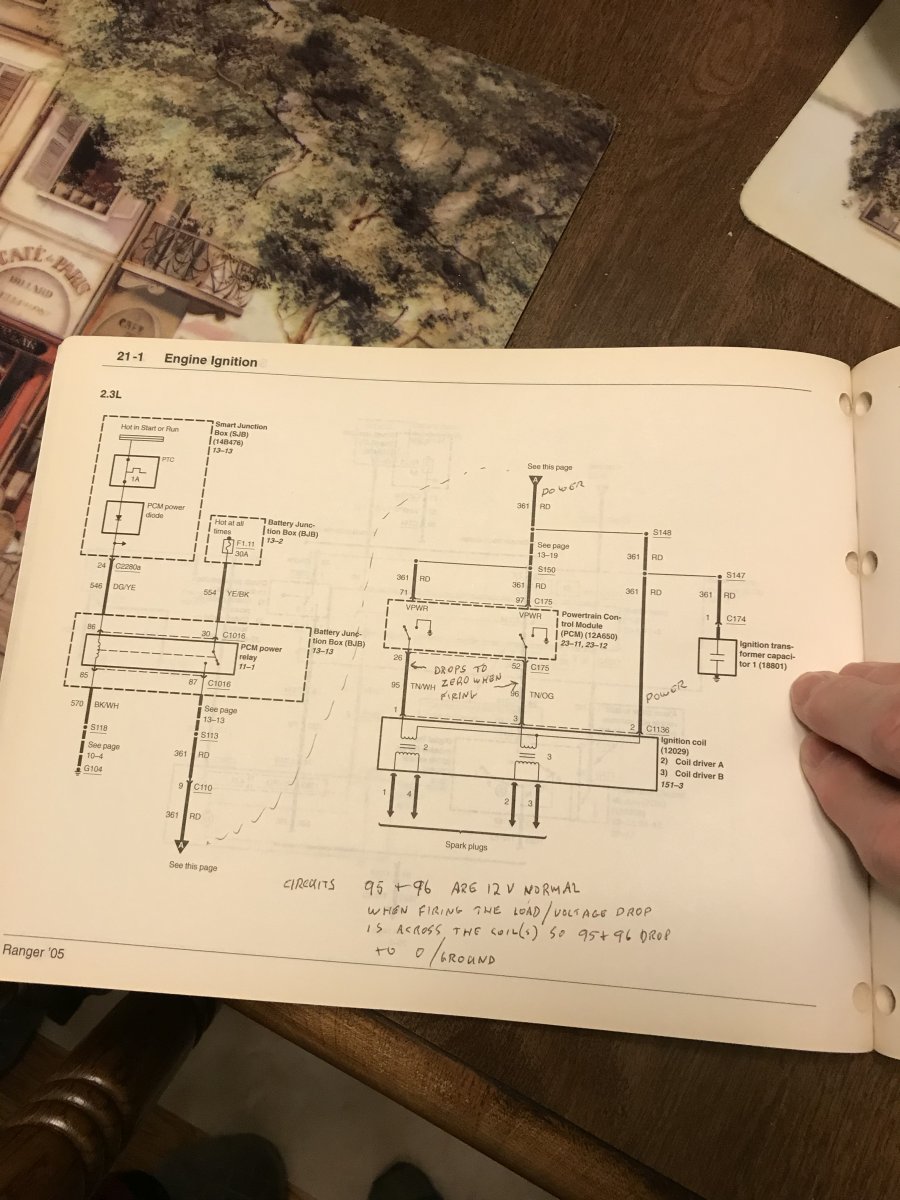

hook a test light backwards on the coil trigger circuits. monitor between power and the coil outputs.
it is easier to see something flash on rather than off.

Good advice.^
It seriously sounds like the PCM grounding on that coil isn't working to me.
