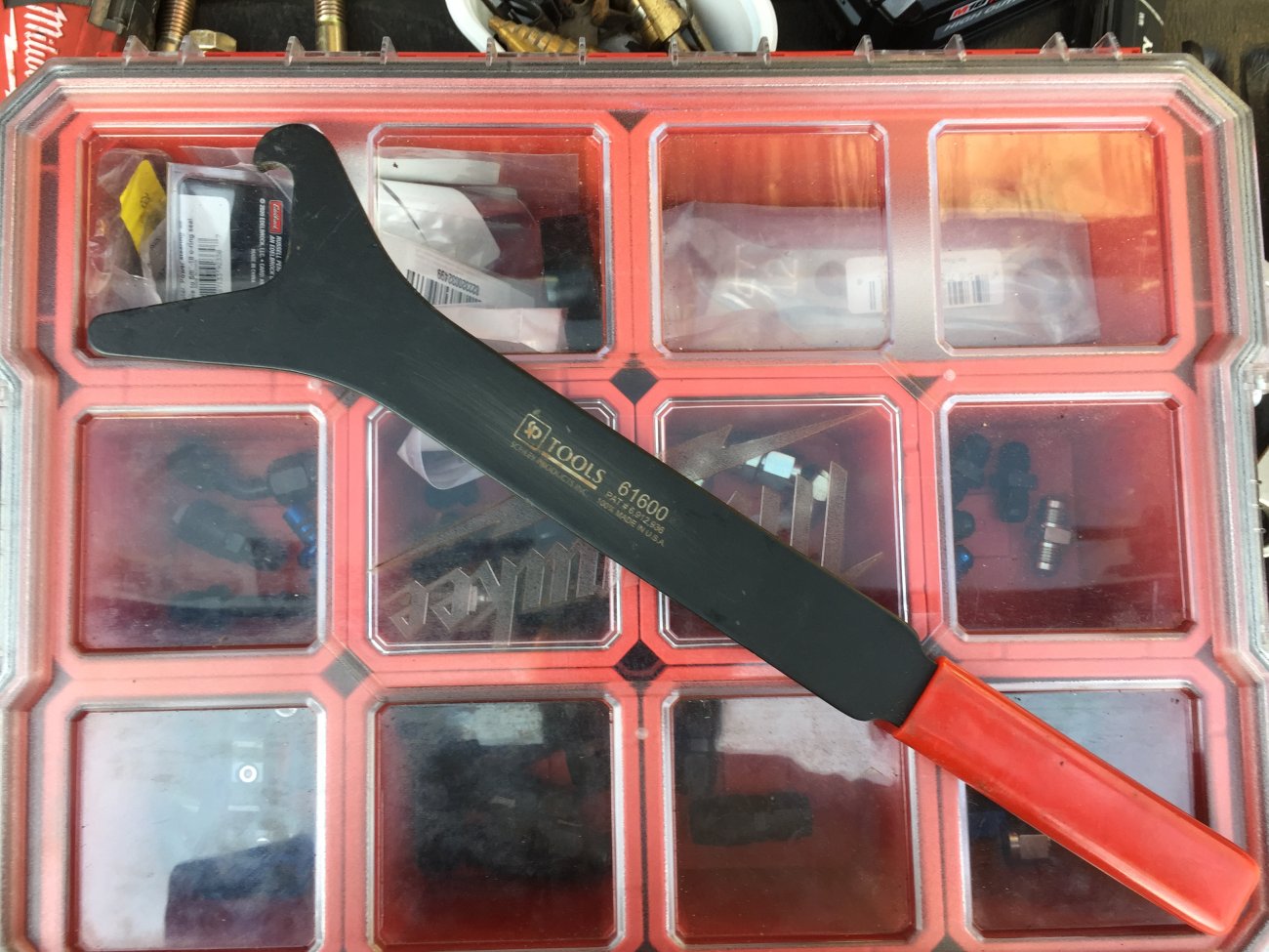

This works really well for removing fan clutches… hook it on the pulley bolts and it holds things steady.
No need to hold the engine steady....
The bolts on the 3.0 are inset behind the pulley lip, that tool would be worthless...

Yes, the 4.0 fanclutch tool had an attachment to grab the wp pulley bolts.
But as a tech we just smack the tools with a hammer....
You use the 2 tools to treat them like 2 wrenches & dont pound on them.
Majority of the time, im taking fan clutches off with just a blunt tip on my air chisel....
I used to do it that way until I had one that wouldn’t come free. Neighbor loaned me a Snap-On tool but even that didn’t work well. Came across that wrench, tried it, and love it. At most I give the wrench for the nut a love tap with a deadblow if using them like wrenches isn’t cutting it.
