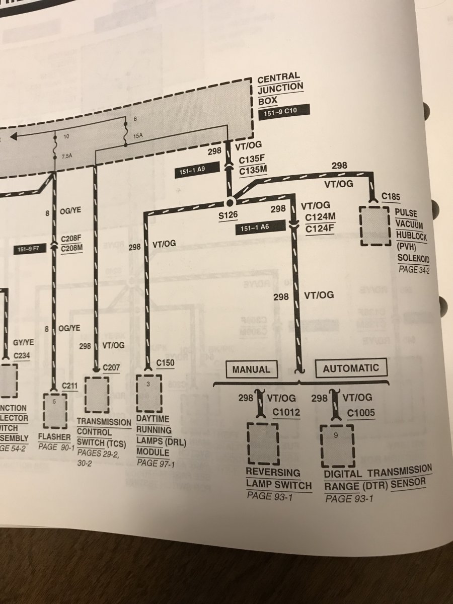

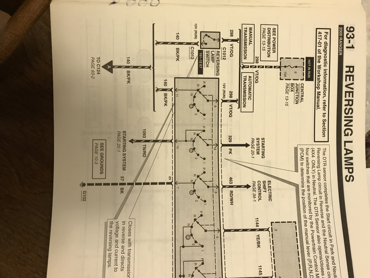

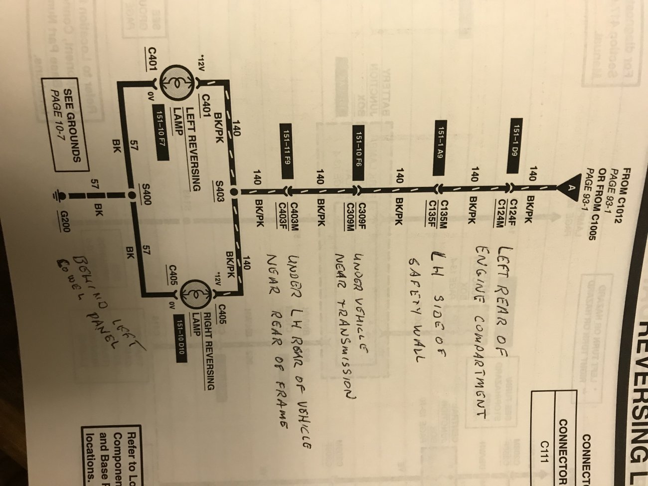

note the circuit goes thru 124 & 135 twice, going to & from the switch.
C124 and C135
those are connectors
298 and 140 are circuit numbers, so is 57.
VT/OG is a violet colored wire with an orange stripe.
G200 is a grounding screw.
S126 is a splice, check that too.
EDIT: or do you mean you can't the connectors in the truck?
they're in the harness that goes over the bell housing then near the top of the tranny.
C124 and C135
