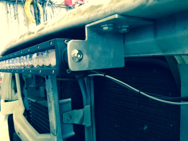

20" 100w led light bar in stock 2006 grill
IBJAMMIN
Sep 17, 2016
6
Acton Ca
2006
I found a 20" 100w single row led light bar that fit the top slot in the grill on amazon made up some simple brackets out of some angle aluminum and mounted them to the top of the radiator support the light bar fits perfect no cutting or trimming needed on the grill.... I also added some rigid 60w led lights in the lower grill area no change in temps even under load in the socal 100+ deg days!
