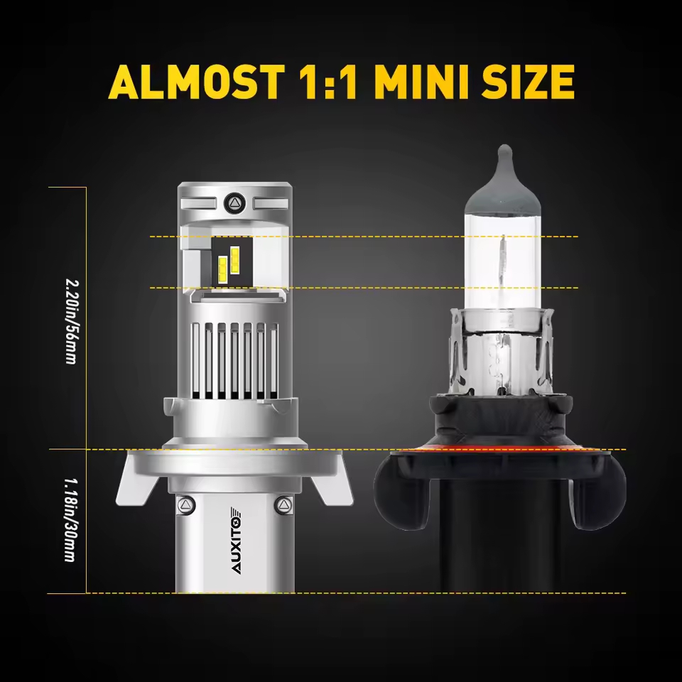

First issue is that many styles halogen bulbs have the filament positioned differently. If the emitter depth of the LED isn't positioned correctly to match the bulb its replacing, then it is not going to work properly in that housing. So you end up with much more light output scattered everywhere that it doesn't need to be. (Same problem as HIDs in a halogen housing.)
I will agree, I have seen this flaw in my research and many commonly available bulbs. But, I will throw out that some manufacturers (chinese included) have figured out the poor filament depth = terrible performance, and started not only putting the emitter in the right spot but also including that in their advertising:
1991 Ranger LED swap
They claim it anyway. Whether it's true or not is a different story. Taking a look at that second one, you can see that even in the provided images they are not set at the same depth. The LED emitters would actually need to be moved out (away from the base) to position them at the same depth.
Not knocking your info, you are absolute correct in that they claim that. Only saying that those claims are just as questionable as everything else that they claim.
