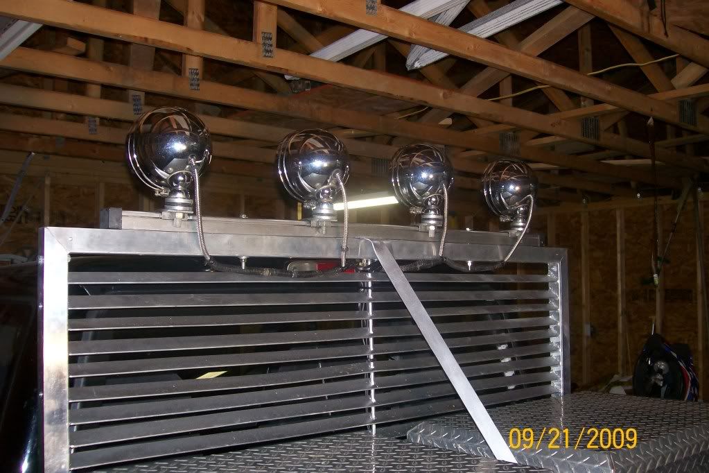

I got them wired up I had my buddy do it he's the one I got them off of in the first place. We wired them up 2 to a switch, 2 fuses there is only one 30 at the moment and the other is a 15 but I'll have a 30 in a little bit haven't had tome to run to the hardware store. There wired direct to the battery ran the wires throught the steering shaft rubber boot in the fire wall and mounted the switches in the cd player valance since I have a aftermarket one I have plenty of room to mount switches. I just put in some crappy old ones until I get some new nice looking ones. I'll post pics tonight.

I'll try to get some tonight I still have to get the little rubber grommets that go in the back of the lights and keep out water. the old ones are junk or missing and then I'll silicon them for extra water protection. I was going to get a 135a alternator sometime.
I tried to get some pics but my camera aparently doesn't have a night setting, and on the regular setting you can't tell there on. They're really bright though:D
