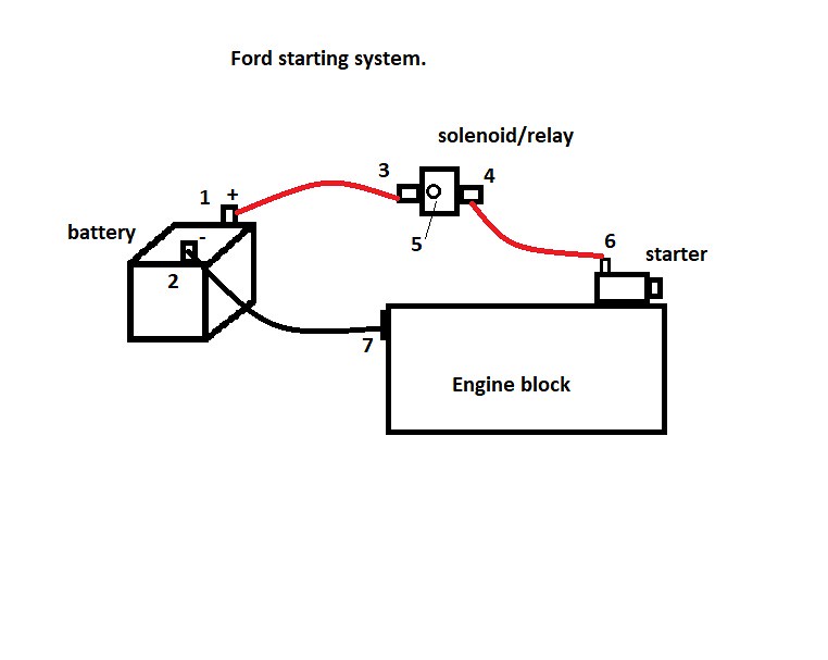

You should have a large fat ground wire going directly from the battery to the engine block somewhere.
Checking the voltage at the same time you are trying to start it is excellent troubleshooting, I am impressed.
Do this same voltage check at the large solenoid connection going to the starter, point #4 in the picture below. Try to start it and see what voltage you get. If you get something low below 12v, that means you have a connection problem upstream. So move upstream to point #3 and try again. If at #3 you get 12v, then the solenoid is bad. If you get something below 12v at #3, then that short cable or your battery clamp is bad.
If you got 12v at #4 when trying to crank it over, then move your negative meter lead from #2 to a place on the engine block that is clean bare metal. Try to start it again while watching the meter. If it's below 12v, your ground is bad, either at the battery, at the engine block or the cable itself.
If you have 12v when trying to start it at #4 and the negative on the engine block, then you have a starter problem. Either a connection at the starter, the starter might have dirt between it and the transmission interrupting the ground to the starter, or the starter itself is bad.
You can pull the starter, get some jumper cables, hook the ground to the body of the starter and to the neg of the battery, and touch the + to the starter and the battery + and see if it will run laying on the ground.
ford starting system by D Franklin, on Flickr

Yeah, I did all the stuff you said already. I test the voltage from #1 to #4 12. I also tested the voltage when cranking and the dash lights died. Nothing, zilch. I got a battery charger and new term clamps since the ground clam has seen better days. Its got a hole in it and idk how. Im thinking its starter related. Maybe dirty around the starter causing a bad ground.
The last time I tested the voltage. It would drop to idk what. I also tested turning the headlights on. Once I pulled the headlights switch. Everything went off. Im gonna charge the battery tomorrow and call into work as well so I can focus on getting my truck running.

The headlight test is a good one.
All you have to do is turn the headlights on so everything dies, and then go out with your meter and touch the battery right at the posts. If you do not have 12v, the battery is dead or bad.
If you have 12v ON THE BATTERY POSTS move your + meter lead to the cable clamp at #1. If you lose 12v, that battery connection/clamp is bad. If you have 12v, then move the negative meter lead from the neg post to the clamp at #2. If you lose 12v that battery clamp is bad.
Keep moving around till you have 12v, and then you don't. The point where you lose 12v is the bad spot. Just keep the headlights on at all times so the system is dead, then you can test it like that.

Thanks for the great battery testing info! I did get everything work as in the starter worked and the power issue went away. I'm thinking it might have to do with my engine ground. I also think It might have had something to do with the way I had the positive cable on the solenoid. Im thinking something wasn't making 100% contact for some reason. After cranking on her and the bowl filled up I tried to fire her up and she sputtered a little bit. Then after some more cranking, I heard the starter grind. Meaning it moved away from the flywheel. I've been thinking of some sort of bracket that cradles the starter to make it holds it close to the flywheel using the 2 mounting bolts. I just don't really have the material or tools to weld or whatever. So ill have to think of something. That's all it needs for it to not moving. Something to just hold it close and dear to its little flywheel.
