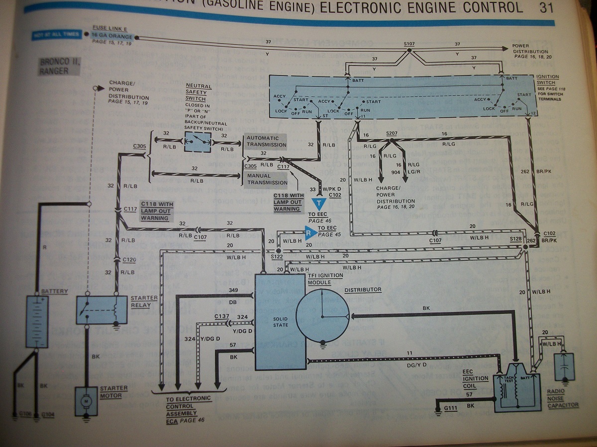

So I need to splice into the white wire to get ON and crank hot?
Do I even need the red wire that gets hot during cranking?
Sorry about that. Limited gear to mount the camera/phone.
The factory White (with Light Blue dashes) should be hot (have +12v) in RUN and START. So, yes, you can use this one wire for your "ignition power".
Look at the schematic; the round black connector is C107.

Yes, as long as you have power during crank and run you are good. I guess it depends on how you cut the harness up. I was looking at the diagram that Robbie posted, I guess if the red/lightgreen wire and the brown/pink are both still under the same pin on c102. during cranking voltage will run down the brown/pink, backwards up the red/lightgreen back to the ignition switch, and then down the white/blue wire, giving you power during cranking on the white/blue.

Cool! When I splice into it. Should I have it still giving power to s207? There is a wire that only gets hot when cracking? Should I just cut it or cap it off somehow? Im assuming its useless as when I went to look at my stock photo of that wiring setup. It went off to the passenger's side wiring.

I wouldn't even mess with splice S207. Did you mean splice S128 instead?
The pictures in your post #168 (page 12) look to show splice S128, where the Brown / Pink START wire joins the White / Light Blue dashed RUN wire, between C102 and C107. If you're using the Brown / Pink wire for your ignition power, and it tests as +12v (hot) in key positions RUN and START, then you shouldn't have to reconnect the two wires at S128. But, it won't hurt anything if you do reconnect these wires. Actually, restoring this connection (splice S128) puts your wiring back closer to the stock configuration, and will probably make it easier to clean up (loom) the harness once you do have it running.
Were yall talking about tapping into this wire? Im also assuming you are saying I don't need to hook up this connector? If so, The hot end plugs up into another hot end. (The same white wires on the male and female are hot)
The wire
The wire that you have circled (Brown / Pink) should be all that you need for ignition power. It's up to you if you want to keep both sides of the black round C107 connector in the truck- you can go either way.

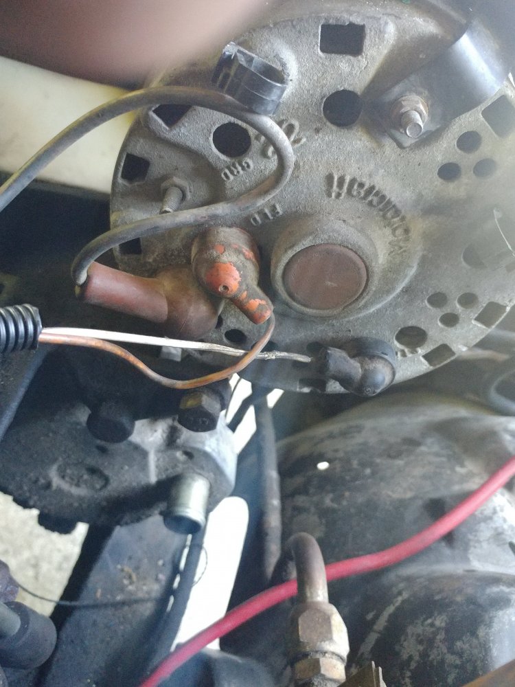

I need help with the wiring for the alternator. (I can't find anywhere on the web of where the plugs go. (the colored plugs are dirty and faded.) Tell me where to plug them in if Ive plugged them in wrong. I think I've got it right but just need to be checked. Since I don't wanna damage anything.
Just gotta reseat the starter, maybe charge the battery (Its been sitting...), and Pray, bump the starter/engage the starter and pray for the best.
