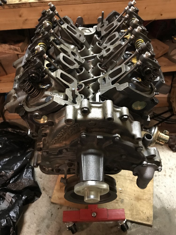

Got it. Get the ignition system working before seeing if you need a rebuild. You wouldn’t want to be wondering why it won’t start—engine mechanical or ignition. The threads in the aluminum intake look like they could be cleaned up with a 6mm rethreading die. If they get stripped, a helicoil would fix it.
Here’s an unsolicited picture of what environment that bolt is living in—it needs to come out. Original bolt is magnetic, btw.
