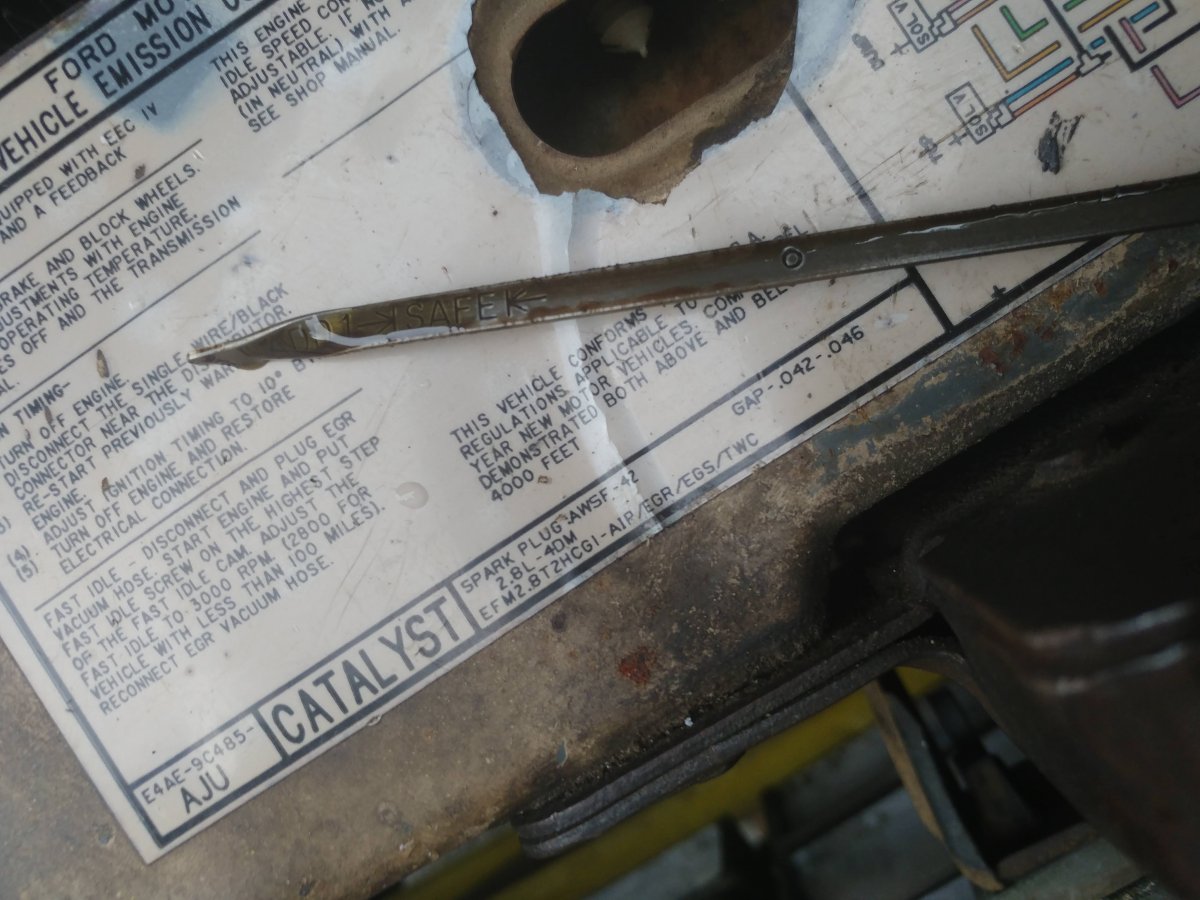

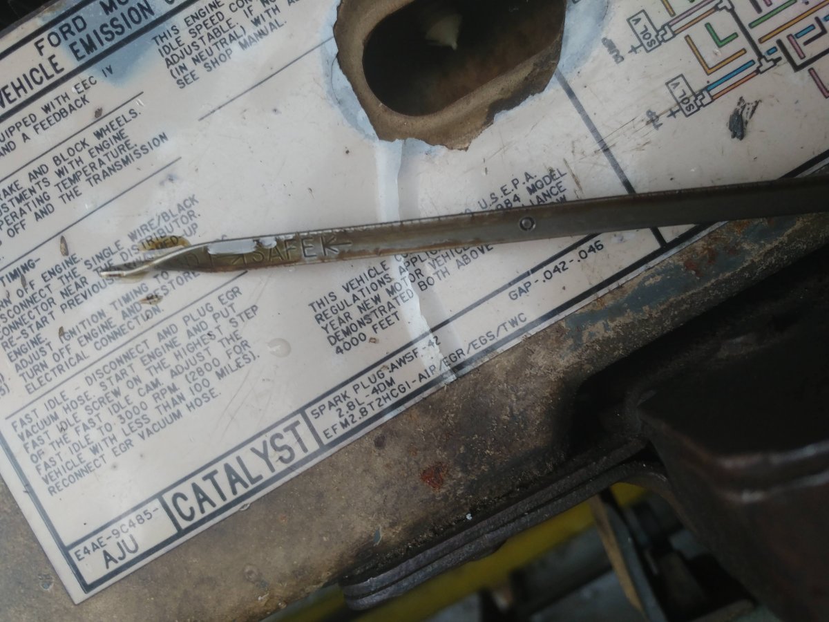

UPDATE: I went to start the truck today and It started but it didn't want to idle. It felt like the timing was off so I let it die. Then I cranked it again after fiddling with the timing and gave it some fuel it was super hard to crank. Like it would spin, stop, spin stop. As if something was getting in its way or something. IDK. I fiddled with the timing by moving it slightly back and forth didn't help.
It acted like this when it started and when it didn't. Without fuel, it cranked freely and when I add fuel it acts the way I described. I checked the oil and it was SUPER dirty. I did have to run seafoam through it when I was putting the duraspark dizzy in since it was nasty and I wanted to use something that wasn't harmful to flush it out. It was pretty damn near black. Lots of what looks like grit (Nothing shiny) but just black nasty crud. Heres some photos.
EDIT 1: I went back and looked at some comments by @franklin2 when this happened before and he said I could be timing related. I just don't understand how that could be what the issue is now because I had gotten it to run but died. The timing is on the retarded side. Plus, I had it running Friday. That was the day I installed the rebuild (New Drive gear installed. By Me) and it cranked like butter. That was also the day I was able to get her running good. When I did manage to get her to start today it didn't want to idle so I figured it was to retarded but the comment By @franklin2 said it could be caused by to advanced. Which is why idk why its doing this. It started but died and then did this.
EDIT 2: I unplugged the coil and cranked it. Fucker cranked like a new car. No issues. So idk if its spark/timing, power to the battery, or something else. Im calling into work tomorrow to work on it and I'm also gonna try and figure it out. Also, I might try and drop the oil and change that nasty ass crap. I need to replace the oil filter adapter gaskets before I change the oil. Since I'm not gonna waste brand new oil.
