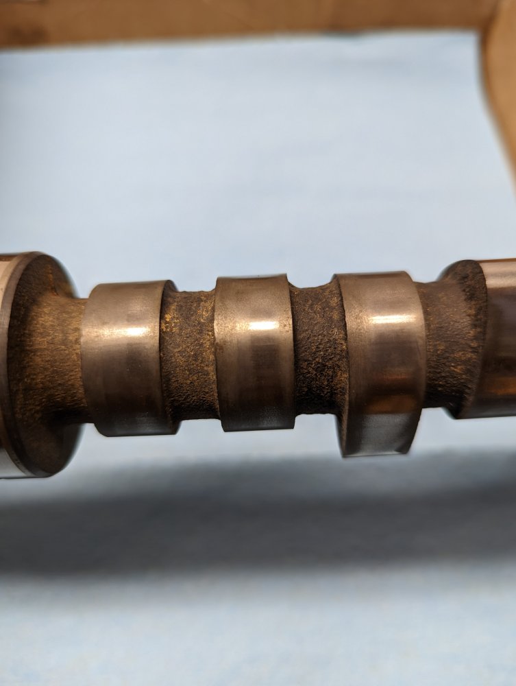

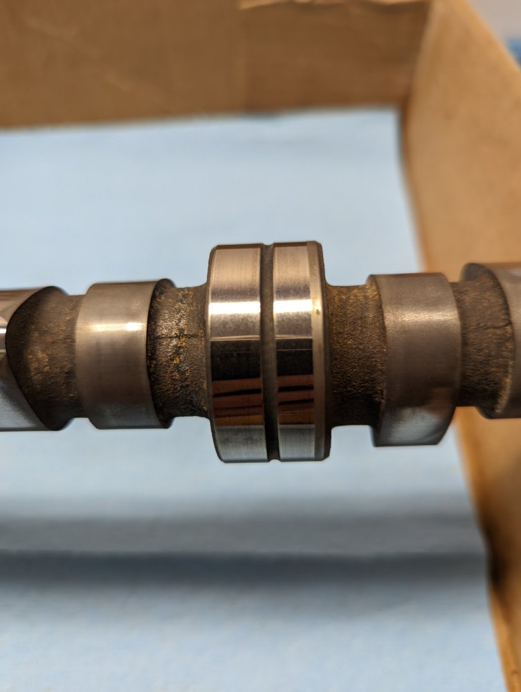

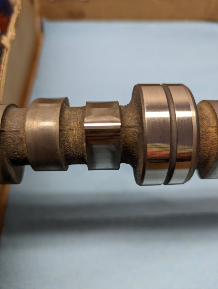

Thanks guys. I really appreciate the help. I had to give the project a rest for a couple of days. I just got the camshaft out and I am posting some more pictures. Probably hard to see but I think it might be ok.

Does this copper looking ring need to come out ? Looks fine.
That is one of your cam bearings. Yes remove if you are replacing(suggested) no if you are doing poor mans rebuild. The cam bearings on the 2.8 are extremely important to be installed correctly. There are some blind holes that must line up in the cam bearing line bore. If you aren't sure what this means and the cam bearings are removed, make sure you have a professional machine shop install the new ones. You miss the hole you kill your rebuilt engine.
Thanks. I realized after I posted that it was a cam bearing. I saw the others in the bore and I understand about the holes. I am leaning poor man's right now.

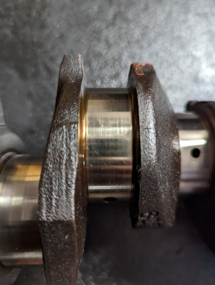

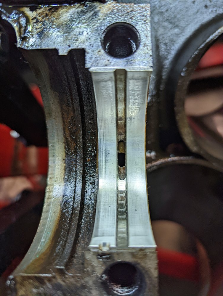

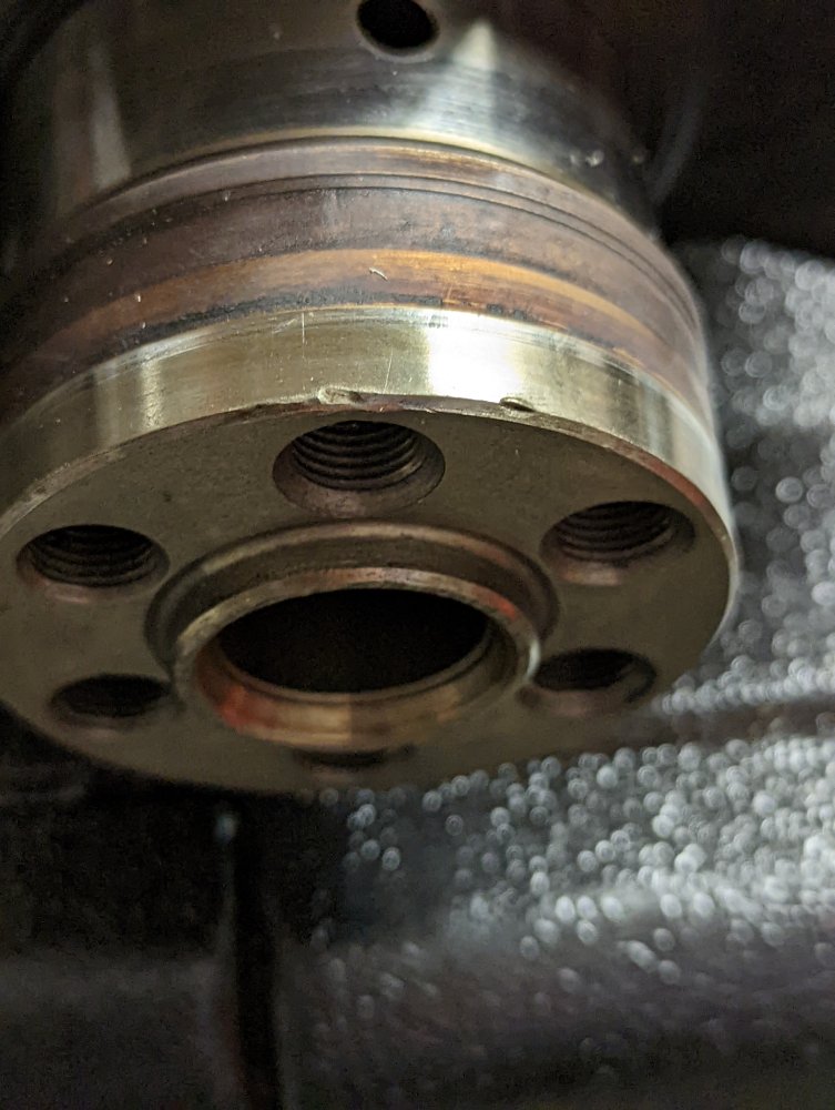

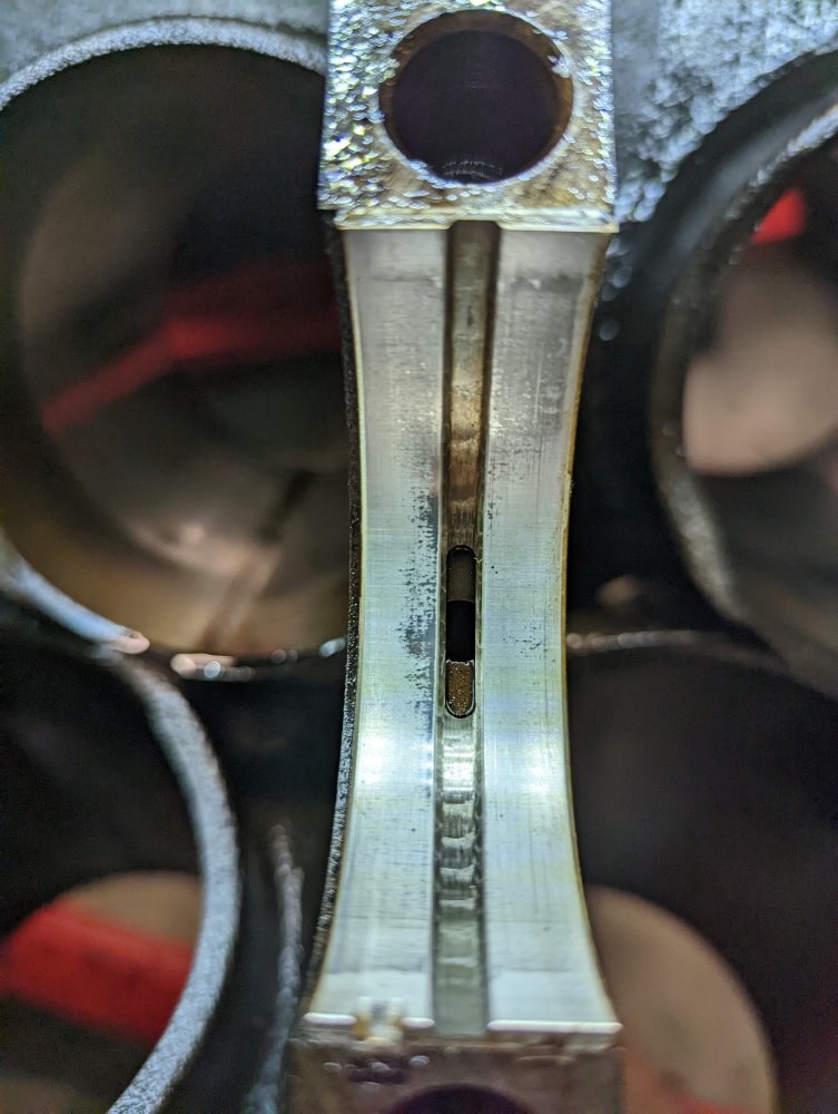

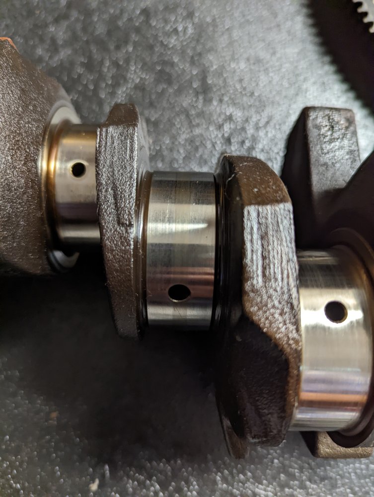

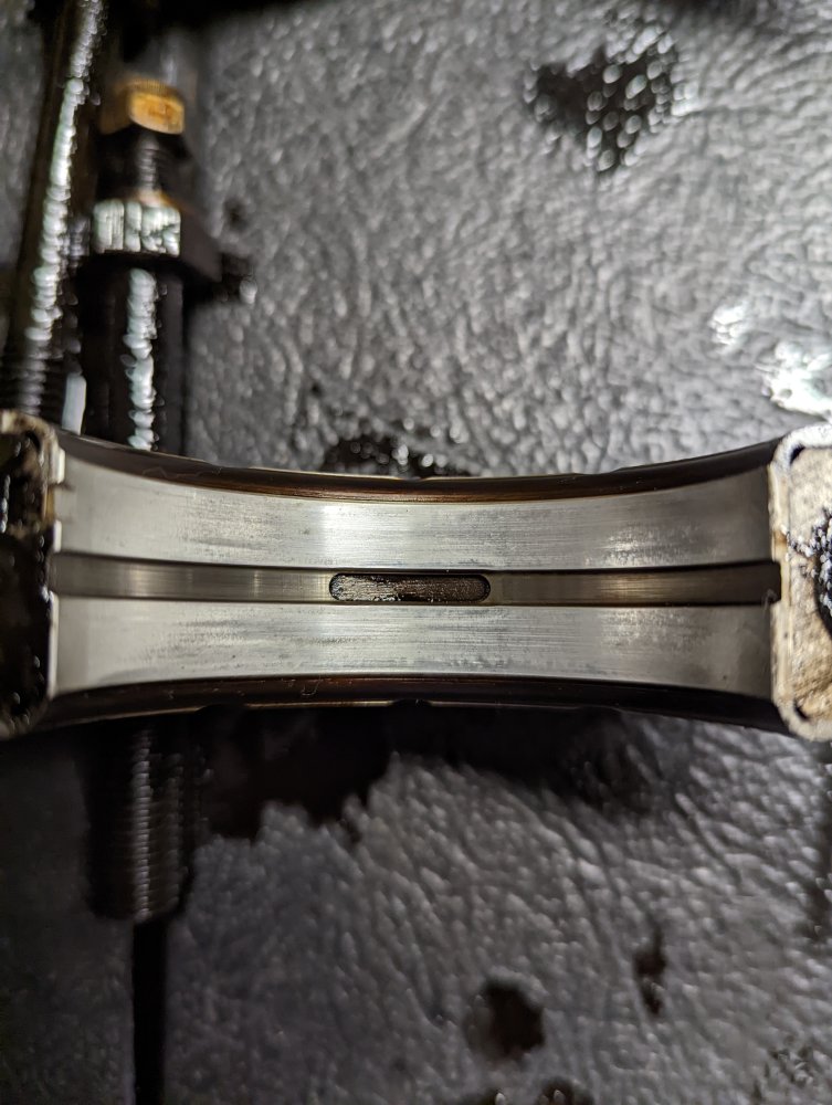

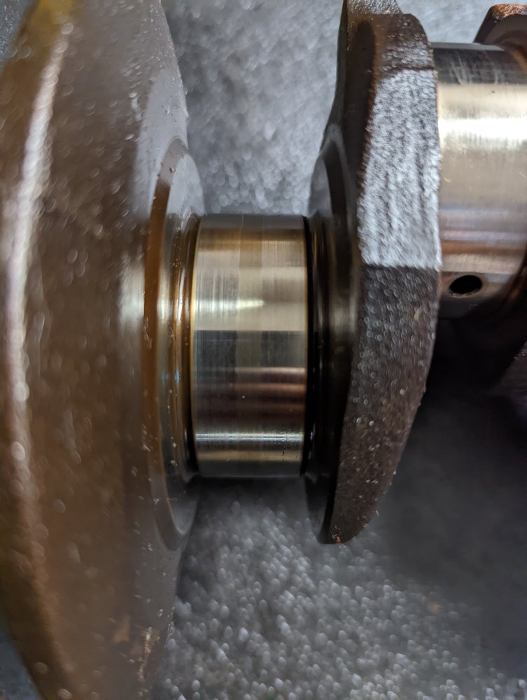

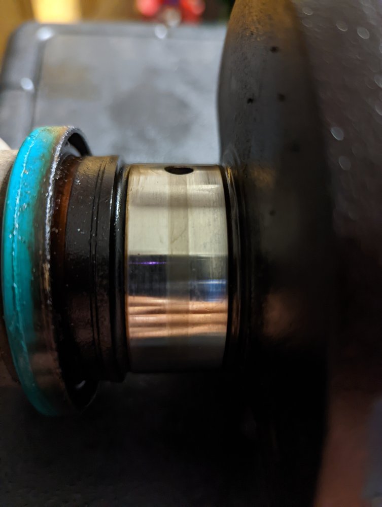

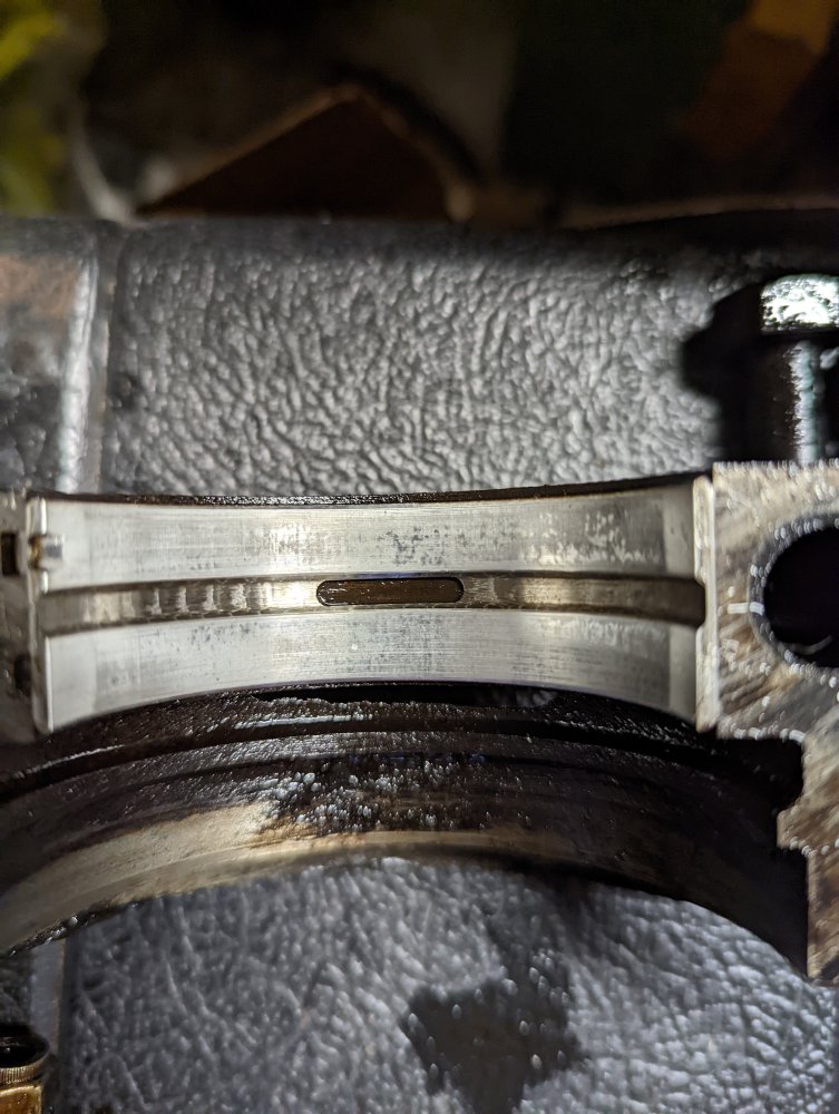

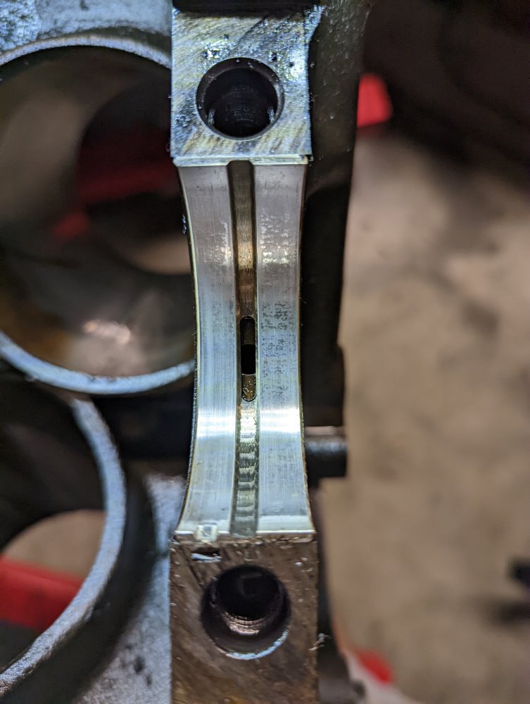

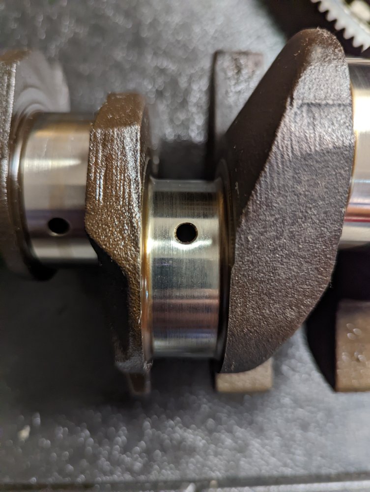

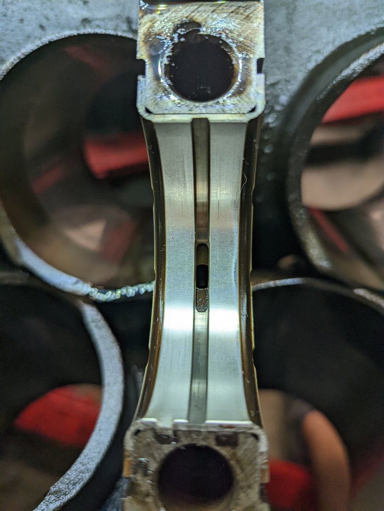

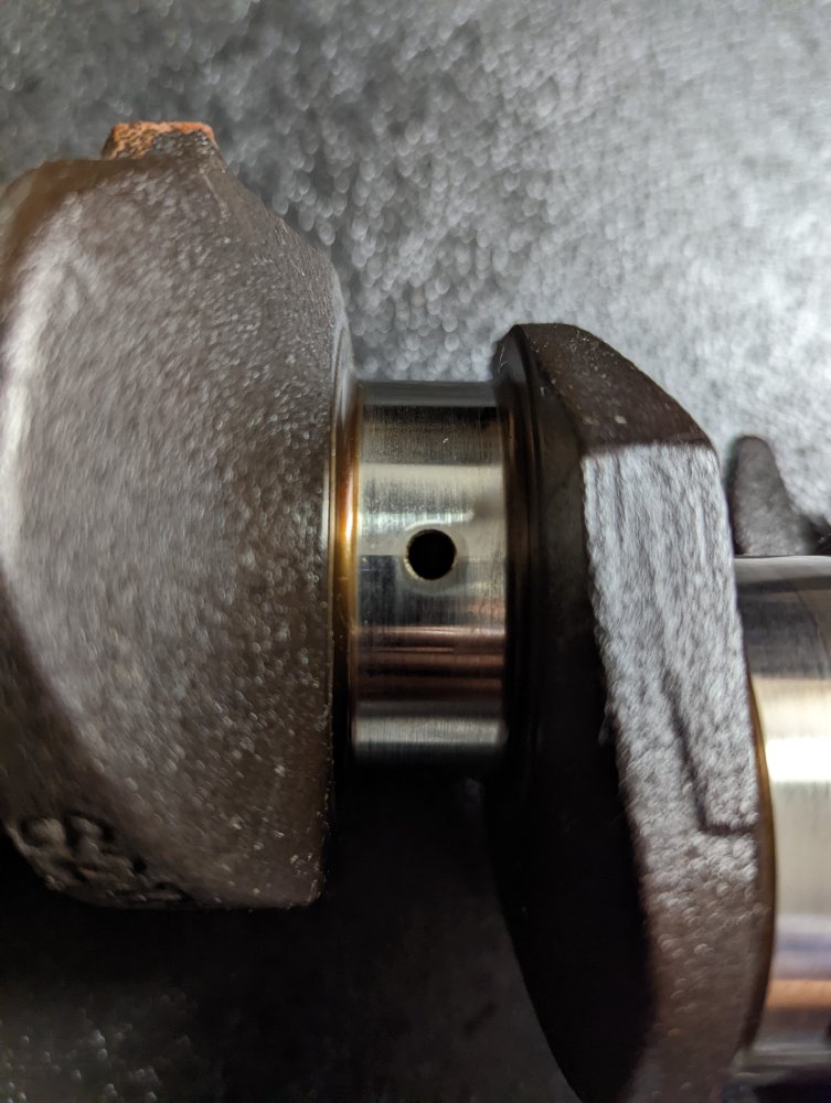

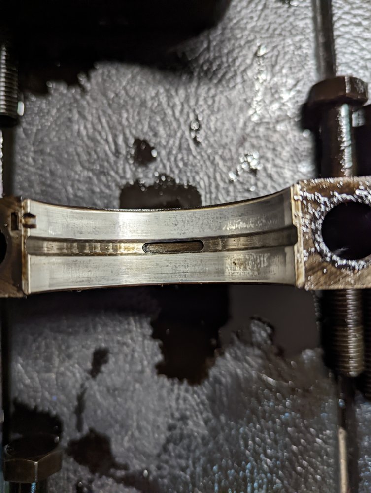

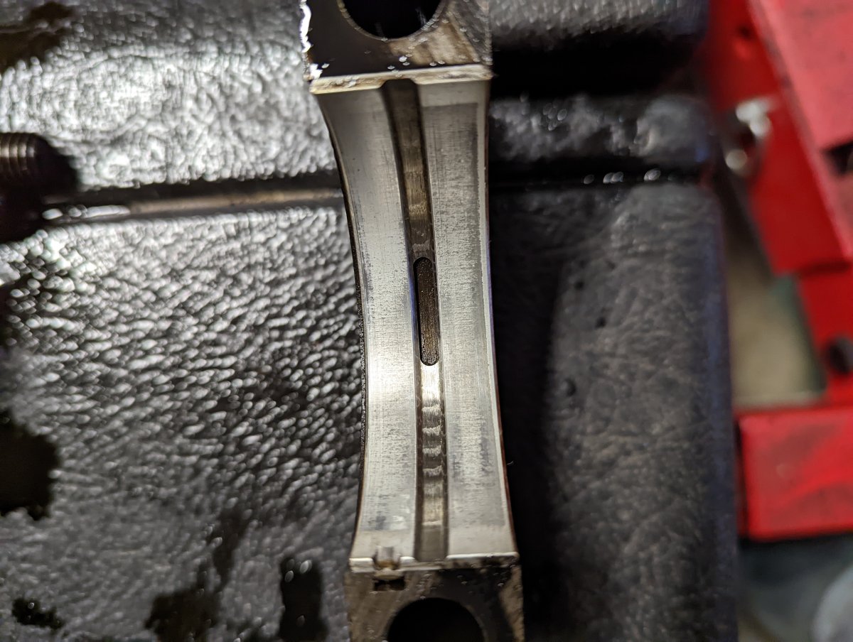

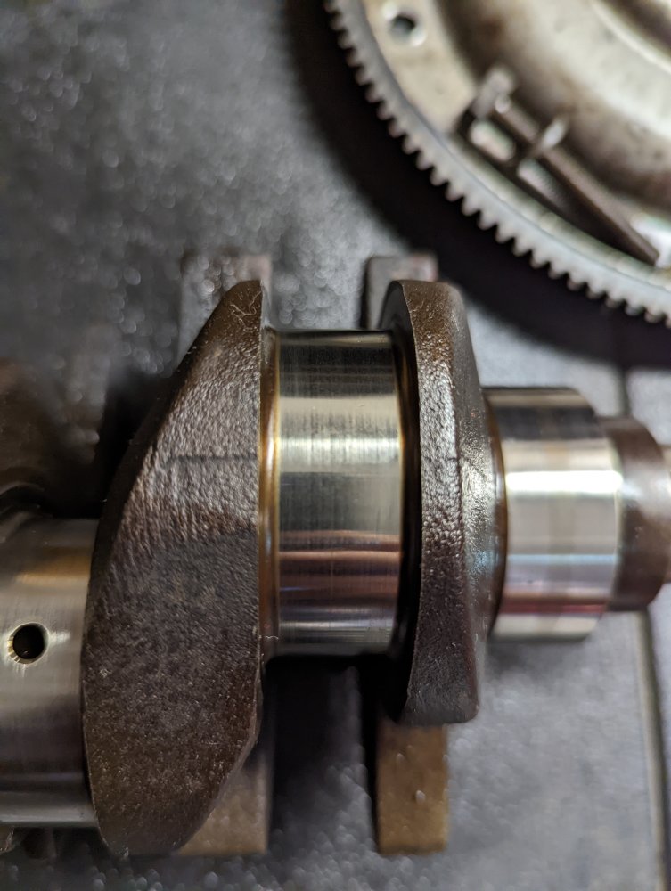

Well, I got the crankshaft out. Posting some pictures . This is the first engine I have fully disassembled. I haven't found anything obviously wrong with it. Thinking I will rebuild it cheap. This is just a learning project anyway. I can always put another one in later. Thoughts?

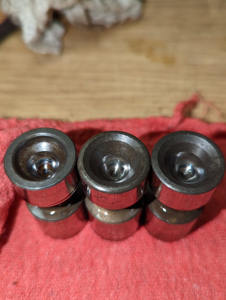

Why do these lifters look different? Shouldn't they all be the same? Did someone previously install a mixed set? Different manufacturers? Guess I will just order new. Weird.
I was going to say that if you plan to reuse that cam, I hope you marked the lifters. If you didn't keep track of which lifter came from which bore, you'll need to replace them all anyway. At that point I would probably recommend new cam and lifters from Comp, Isky or RacerWalsh.
Like another member said, even if you reuse the cam install a new all metal timing set. Although they look good, it's not worth risking the 30 year old fiber composite coming apart on you.
