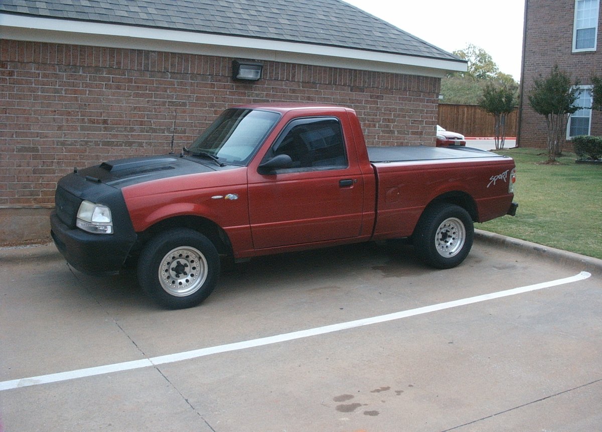

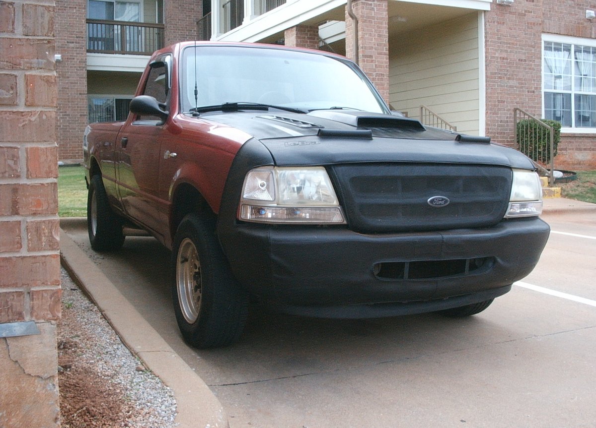

I believe my rims are 7.5. I run Cooper Cobra GT's in 255/60-15 without any problems or funky wear. Just got two new ones yesterday. The old ones lasted almost 10 years. Fronts are 205/70-15 on the same rims.
