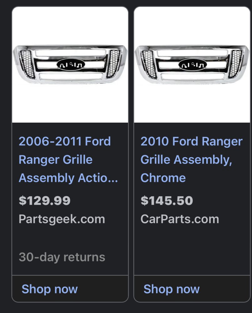

Thanks for the input.....unrelated, what year grille do you have?
I have a 2010 Ranger XLT, it came with.
  • I have made my decision, but need a little help with backspacing
I wonder if that would fit my '04.
It should. 2004 was the last facelift for the Rangers. Bumpers changed, but everything else pretty much stayed the same. 2004-2010 shared the same headlights, header panel, and hood. Header panel is the part that the grille and headlights mount to.
