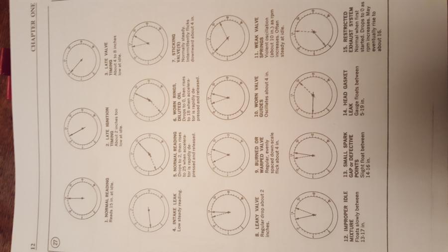

I appreciated the links you sent and it got me thinking that I really hadn't seen any info regarding diagnosing through vacuum tests although I am going to study up on it. I ran across this page in a Ford shop manual tonight, that I recently bought and thought it might be helpful to some people but I don't know where or how to put it out there for others yet. I am going to attach it below and if you think it would be helpful to others maybe you would know where to put it on the forum. It applies to 1983-1987 Rangers and B2's both gas and diesel according to the manual. Thanks again for the help from both of you guys!
83-87 Ranger, B2 vacuum test readings

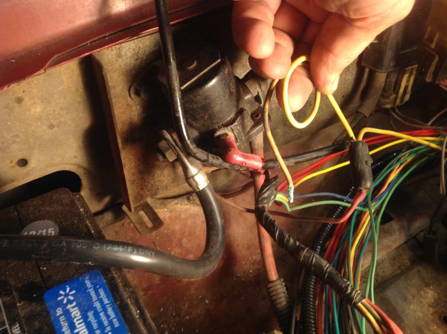

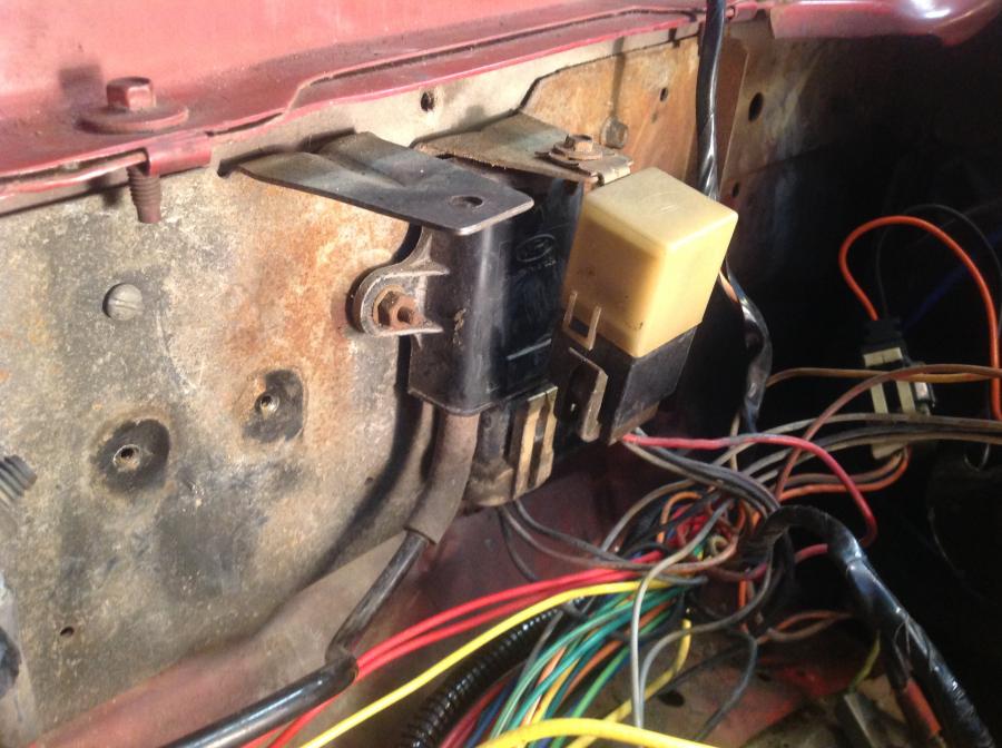

We finally got all of the parts to do the duraspark conversion except for the carb and we are attempting this tonite and over the weekend. I've read the tech article 100 times over the last couple of months to prepare but I have a couple of questions as we are removing the engine wiring now & I don't want to mess it up. I am going to attach two pictures that I hope will help in answering.
#1) I am guessing to leave the starter relay in place but, it wasn't mentioned to do so. The RED wire coming out splits into 2 YELLOW wires. I know that one must go to the starter but as I untapped the harness to separate it from the stuff we need to remove, I discovered that one of the yellow wires is not connected to anything and has corrosion on the end. Is this supposed to be connected to anything? If not, I am confused why it is there. There are no other cut lines in the harness that I can see.
2). Located on the passenger sidewall, right in the middle of the vacuum solenoid so, there is a black box and what looks like a relay? Can anyone tell me what these are and if they are to be removed when doing the duraspark conversion?

Starter relay wires
Starter relay wire disconnected from what?2.8 lurches, kicks & stalls at takeoff?
What are these and do I remove when doing the duraspark?
What are these and do I remove when doing the duraspark conversion?

Ok, so I thought the red wire that splits into 2 yellows was coming off the bottom of the relay (dumbass non-mechanic..) but, after looking closer, it is actually going to the ground side of the relay. Maybe you something aftermarket? Also after looking around more, I noticed a yellow wire coming off of the regulator that is not connected.... Could this be where it was going to? I'll attach a pic. Sorry if these questions are elementary to you guys, I am becoming self taught & dangerous maybe, lol. Just want to pass more knowledge on to my son than I got. Thanks
