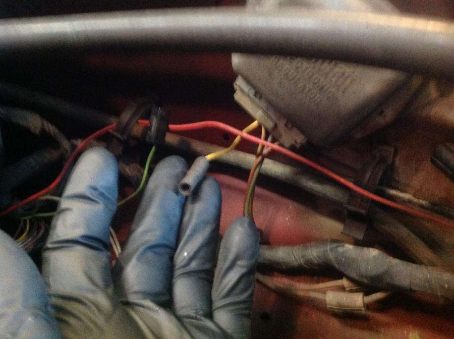

The yellow wire from regulator

Did you get all the harness from the donor motor? If so should be plug and play. Don't worry wire from regulator. Shouldn't need any relays by the starter solenoid. Here's a pic of mine.

Thanks so much for the response! A picture is worth a thousand words as they say. I was unable to find an intact harness at my local junkyards so I bought the pigtails from NAPA and will wire from those I guess. The wires are all black on the pigtails but I'll connect the correct colors to those so I can tell what's what later. Are you using the original carb or did you upgrade? Again, thanks for responding, now I'm going to head out and try to finish up
No, the original carb won't work without modifying it. I picked one up from a member here with the distributor. Neither old parts work with the duraspark setup. Let me know if you need more info or pics. Good luck.

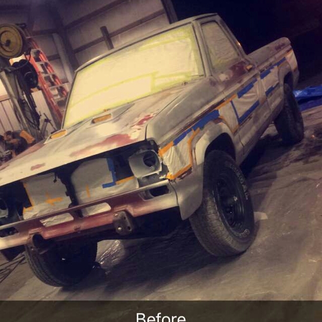

Some pics
Prep for paint
