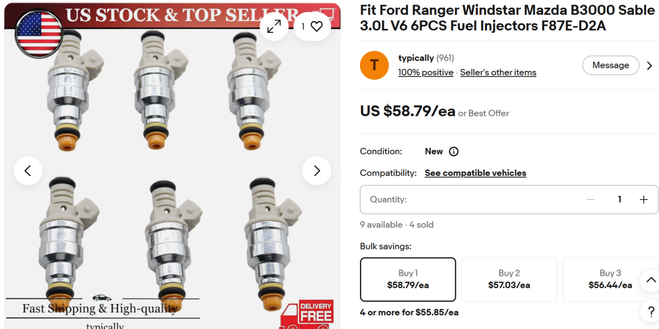

I have a 1999 3.0L Ranger with the V code in the VIN. I am thinking this is the Flex code. Among many fixes I bought injectors from FleaBay that looking back at the purchase - I am thinking they are gas injectors.
Idles rough, crap acceleration when cold, long term trims are 25, I have battery drained the PCM several times. I have Lean codes both banks. Given that you name it, I have checked it or fixed it....Do I just need to change to Flex injectors? It is not clear to me when I look at OEM sites for parts which injectors are which. I got some 'OEM PN' from RockAuto, but they do not match with the Ford OEM part sites.
Injector recommendations? I do not want to pay $60ea.

Did your fleabay injectors come from a company with an easily recognizable name that also has a reputation for making quality parts like Bosch, denso, delphi.. orrrrrr was the manufacturer name closer to MeiSoHuard or TuTuPupu?
Are you running "regular" fuel from the pump (e10/15) or are you actually running "flex fuel"?
What's your scanner say your injector duty cycle is while going WOT down the road?
Injectors aren't something to cheap out on. If "real" injectors cost 60 bucks... Well... Then that's just the cost of repair 🤷🏻‍♀️.

Any thoughts on the dif in injectors? I do assume that they are cheep, but functional.
Thanks again.

Well.. my ranger doesn't currently run lol so I couldn't say what I'm looking at for duty cycle BUT.. there's no way I'd be running 10$ a piece eBay injectors in.. well.. anything lol.
I found a set of reman'd DENSO injectors, flex fuel, from a seller called BIG DAWG DIESEL AND SURPLUS (eBay).. currently 190$ with a coupon code.. free shipping. Yeah.. way more than 60 bucks but... They're from a brand that anyone can have confidence in..

Who made the injectors that you currently have in the truck, and what's the manufacturers part #?

The injectors are the ones I showed above. Very cheap. I always drive like a grampa...am one! LOL
But, Yes I have reset the codes and the check engine light comes on quickly. The truck runs rough at idle while cold. If I battery drain the PCM, then it takes a few drives before the trims max out again.
I may invest in another cheap set, but this time Flex injectors.

I'm wondering if the fact that his injectors were only 10$ a piece has anything to do with it honestly lol. Who knows... 4 of them might be moving 15lbs but the other 2 might only be moving 4lbs for whatever reason. Or none of them are moving 15lbs..
I'd trust a crackhead to give me proper change more than I'd trust 10$ a piece injectors..

Really Thank you guys for the comments. Some more background. This is a POS reconstructed title truck that had a tremendous amount of issues. I am on a budget so in defense of my low ball parts, some have worked and some not. Vacuum booster for instance. I did better with a recking yard part than the part from fleabay - however they did take it back.
The truck had three different kinds of injectors in there when I got the truck.
I have ordered a set of six OEM looking (LOL) Flex injectors for $52.

I also agree with the others about not using mystery injectors. You'd be better off grabbing some from the salvage yard (even from a non flex) and pulsing them with a battery while shooting brake clean though both sides before installing.
