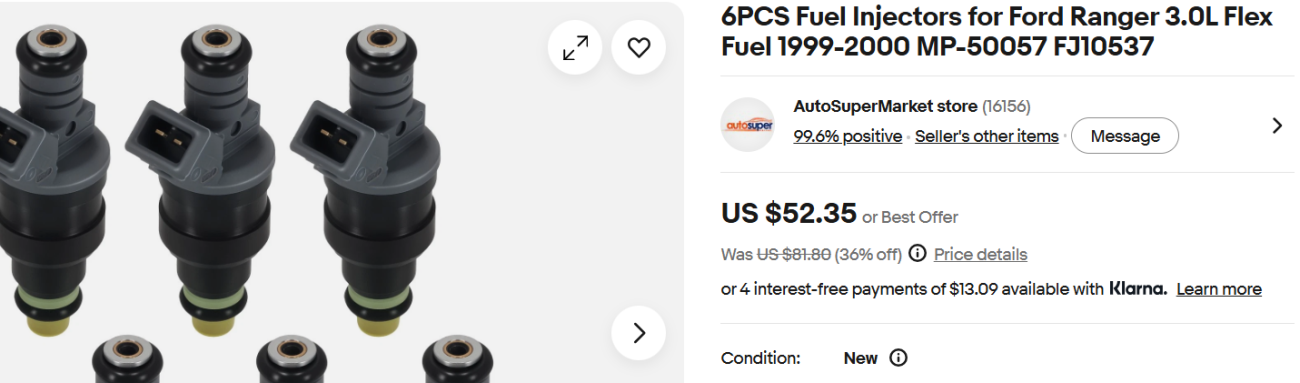

I did buy the POS a set of Flex injectors from fleabay. What I bought shown below. I learned a lot of years ago that I should trust my compas in the fog... I am thinking I should have gone by the VIN code to begin with... I just knew it was a gas truck - needed gas injectors - Nope....
So the results. Been 4-5 days of driving with these. So far no more lean codes and it runs very well.
I think if these fail or get crappy results later I may buy OEM, but for now all good. I like the idea of cleaning a salvaged set next time I go, I may just grab a set.
I did measure the duty cycle, but I could use a referance to read up on why this was a factor in how this thing runs - just not sure.
Idle was 33%
Crusiung at 55mph was 75%
Busting a nut WOT was still 100%
Seems like the MPH is better. I will calculate it over the next few tanks of e10.

Hell yeah. Glad you got it worked out.
Good stuff.
The only difference is the lbs./Hr. Flex is 21 and gas is 12. That's according to some service data I found.
