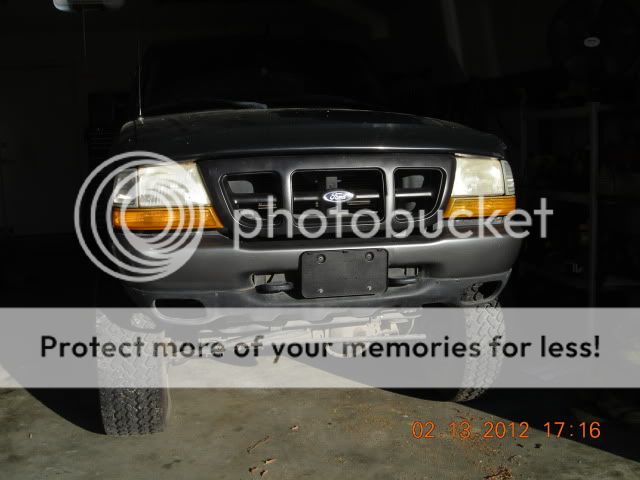

Below is the front of the ranger which has not changed since it was built with a SAS back in March of 2009.
1998 Ranger SAS Project

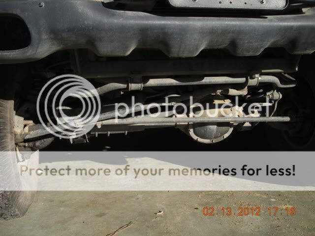

Close-up of Solid Axle and what will happen
Below is a closer up image of the solid axle....most of the factory parts (steering linkage, track bar, etc) will be replaced by performance parts....notice on left had side I have a differential fluid leak - I replace the seal...still leaked...found out the half shaft is worn out allowing the fluid through the seal....this will be replaced as well.

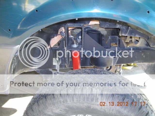

Passenger Side Close up of shocks/Coil
The upper shock mount will be cut out and moved up allowing bigger, better, tougher shocks to be installed. All four bushings in the upper and lower control arms will be replaced with performance ones...the stock $4 ones don't last but only a couple months during hard off-roading.
