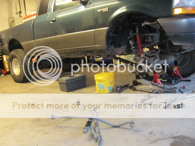

1st Phase
Here we go with jacking up the truck getting ready to unbolt everything that will be replaced.

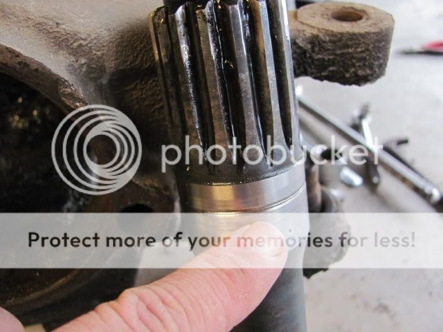

Here is the shot of the left axle shaft that is worn out and needs to be replaced.

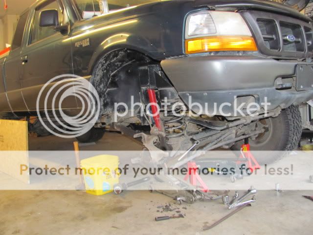

Everything out
This is everything out that will be replaced with heavy duty parts. I will be grinding and smoothing now as parts are being ordered.
