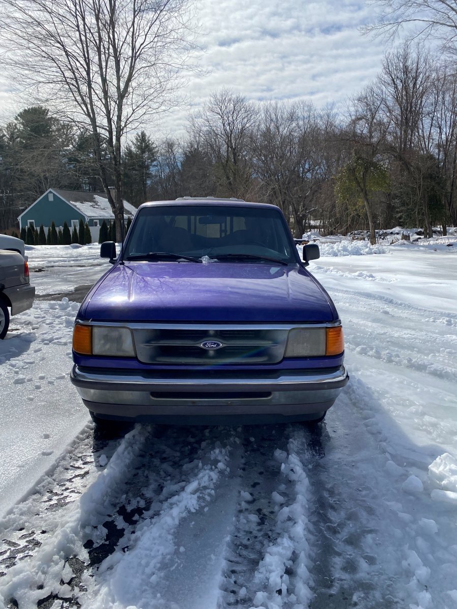

Figured id start a build thread for this truck.
Its a 1996 Sapphire Blue/silver XLT 2wd 5speed 3.0l v6. Currently has 160k on it but was told its had a motor/transmission replaced. Paints been beat up and theres dents all over it. Overall for the condition and price its not bad. Im happy with its "character"
The Interior needs a good cleaning, previous owner was a smoker. Needs a headliner which i'll look for a color to match the exterior paint, or just do grey again, not 100% sure. The rug has a hole in in so will go with vinyl because of all the dirt.
I'm excited to have a manual vehicle back in my life. I race atv motocross for fun and I'm trying to keep the miles down on my 2021 Tundra so the ranger will be my commuter truck and track practice day rig and wherever else id like to take it.

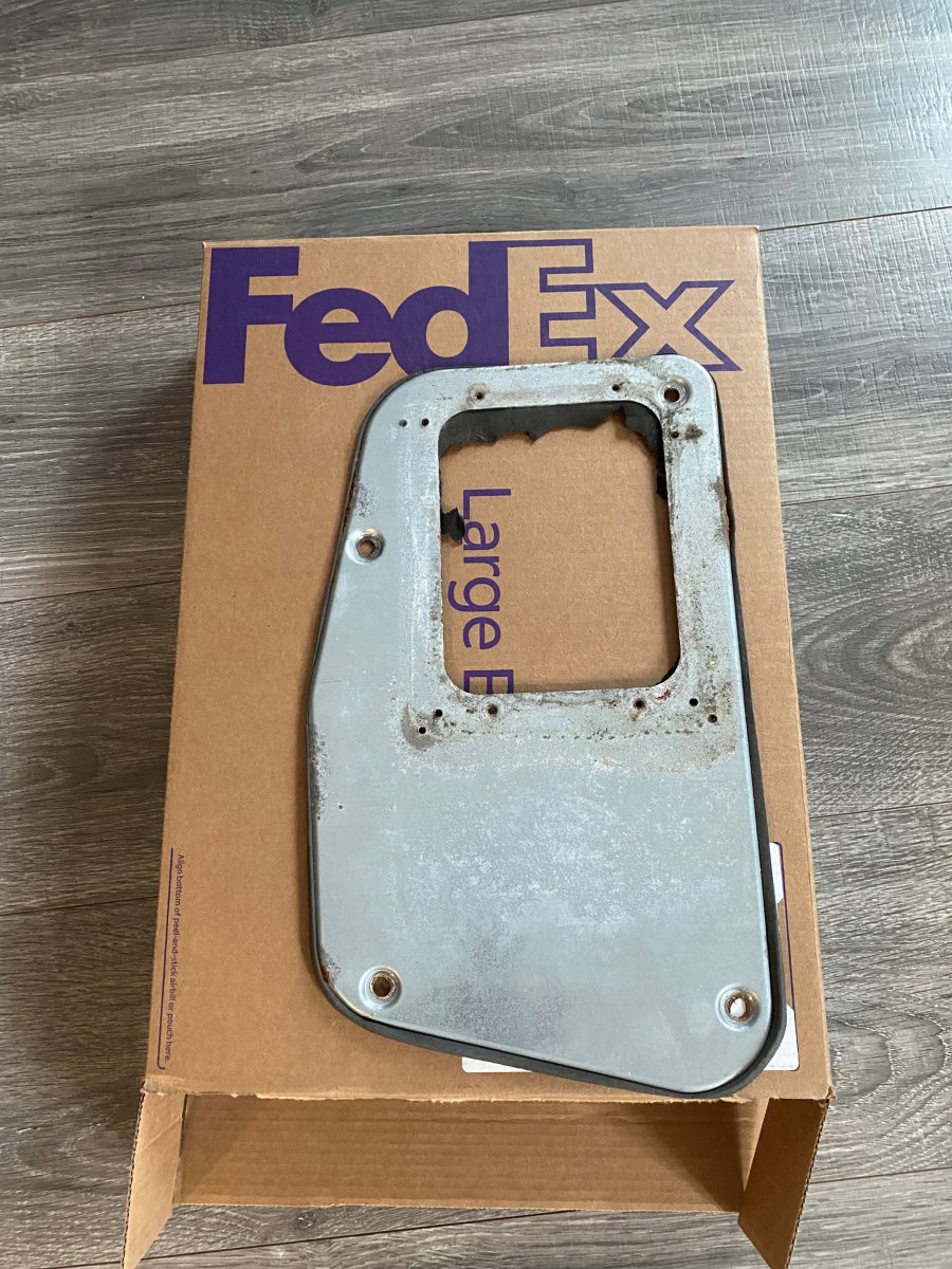

And Shoutout to @PlumCrazy for getting me a new transmission tunnel cover to replace my hacked up one.

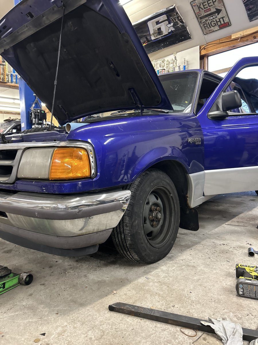

More build updates. Finished lowering it, but definitely going to order the ricks rangerz rear axle flip kit. This ebay one had to be cut up waay too much for my liking. I dont think the pinion angle is correct. Think im keeping the stock wheels, just need some OEM center caps. So if anyone has some for sale let me know. Will need some wheel spacers too.
-Burned out the old oem leaf spring bushings and replaced with new ones.
-Rear brake lines looking a little poopy so those will be getting replaced while im under there too. Found pre-bent ones online for cheap money.
-Didnt replace the upper shock mounts yet, but will get to it soon enough. Rear shocks havent been delivered yet.

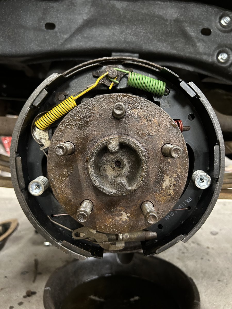

-reaplaced both axles seals, one was leaking bad:
1996 Sapphire Blue XLT build
So after new seals were installed I replaced the pads and brake hardware, new wheel cylinders, bled the brakes and adjusted the shoes.

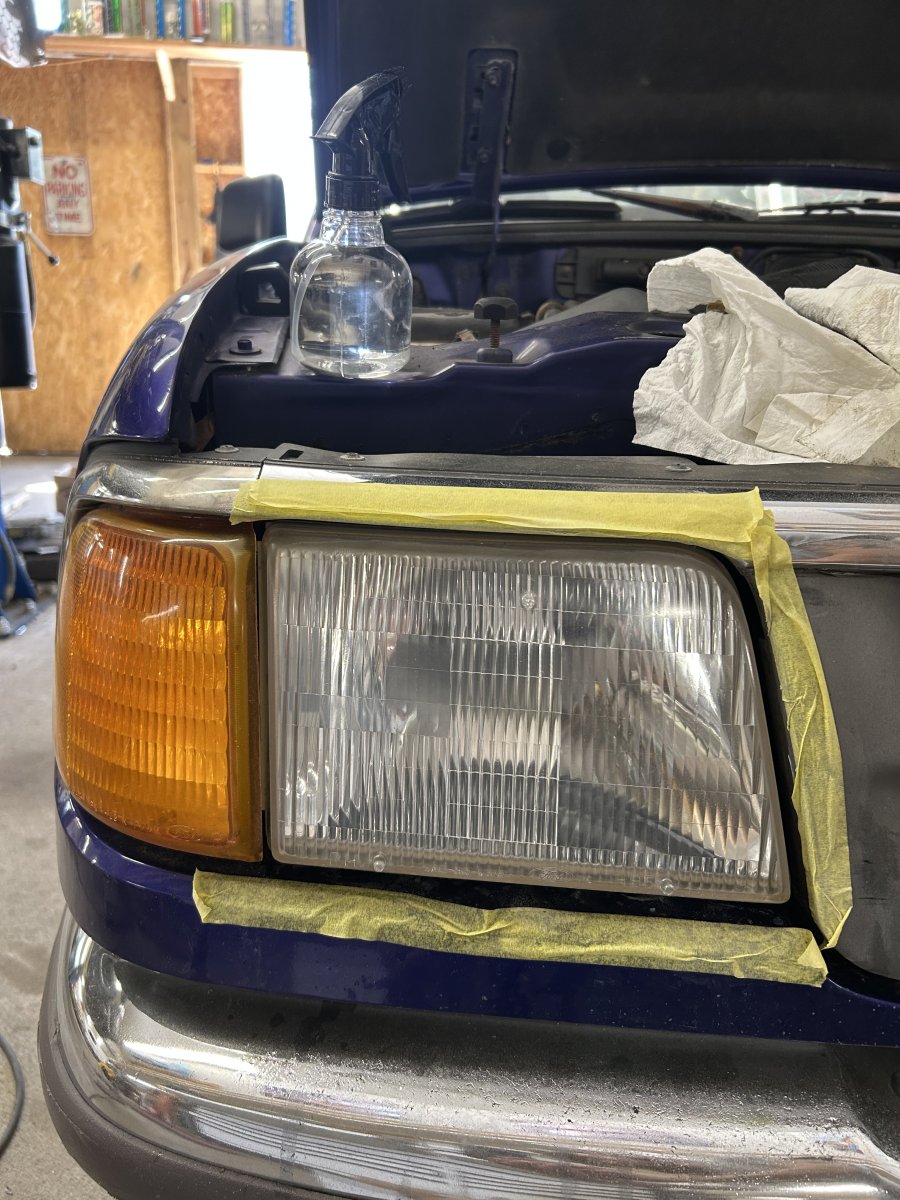

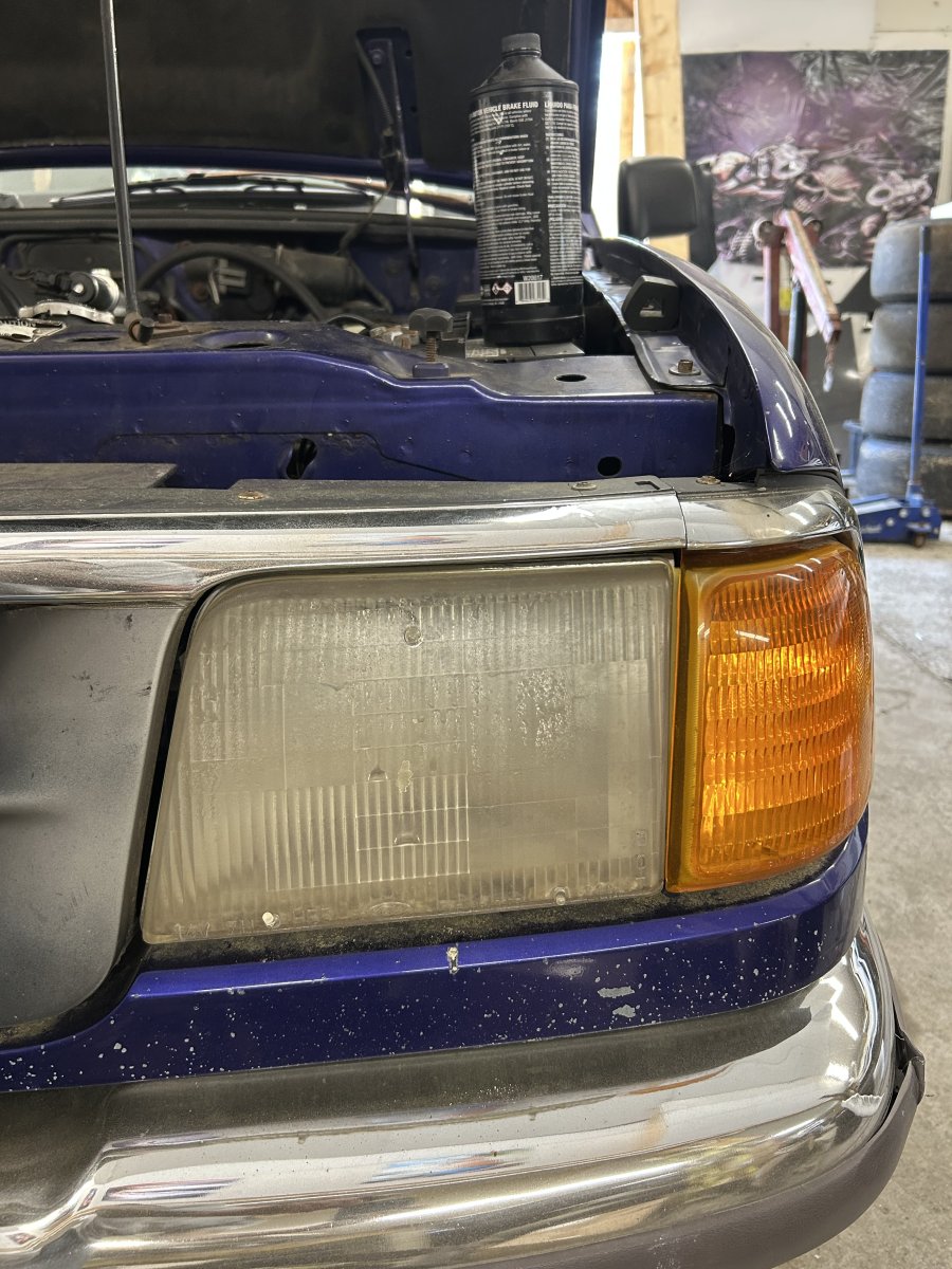

Had planned on going the one piece headlight route from ebay, but decided that those would fade too soon. So i buffed the OEM ones instead.
BEFORE:
AFTER:
Very happy with how they came out, but there's corrosion in the drivers side bucket, so im going to replace it with another OEM one.
Also got some 1" spacers to fit the mustang wheels, i like the look for now, but i have another wheel/tire set up in mind but, I'm trying to stay on somewhat of a budget. I want it reliable and on the road first.

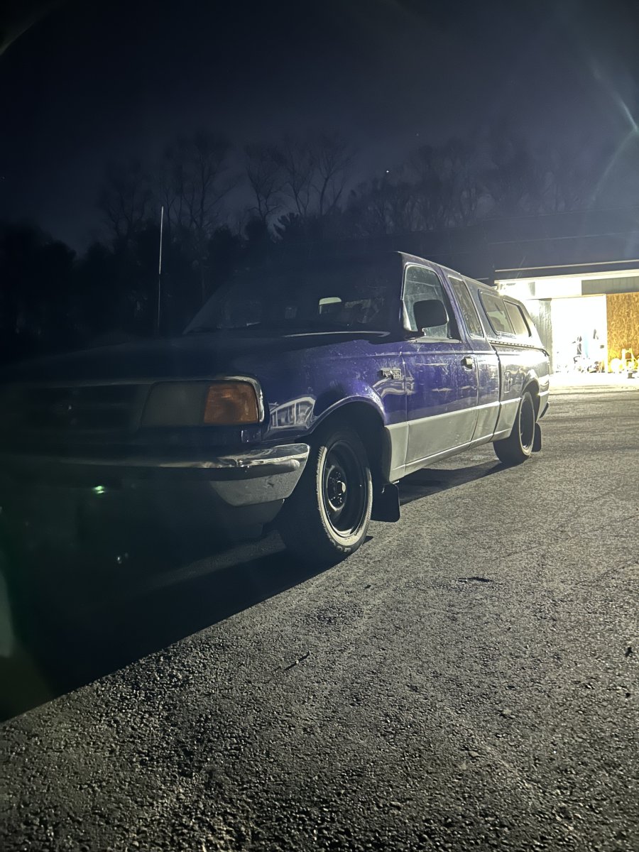

Took the shell off, got her registered and took some glamor shots.
-previously I installed the double DIN radio, new speakers, new clear corner lights.
-dropped it off at the alignment shop today
-it needs a good wash, buff and wax and pulling some dents and window tint too; along with finishing the interior. I am appy with the progress
