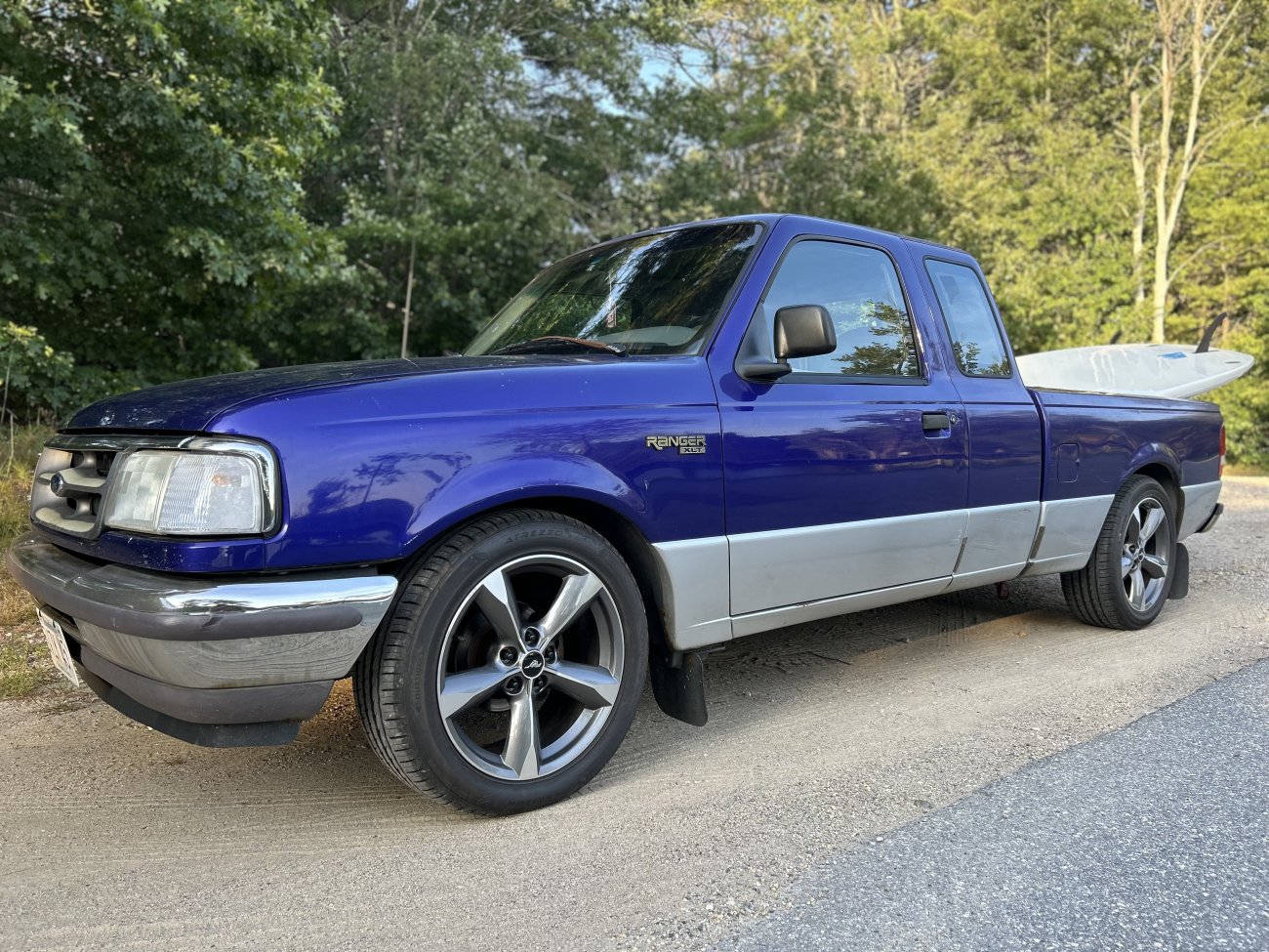

1996 Sapphire Blue XLT build
You may want to spray the headlight lenses with some UV resistant clearcoat, or they’ll oxidize quickly. Looking good though!
Thank you! I did that right after sanding and polishing them.
You got your truck looking good and coming along nicely.

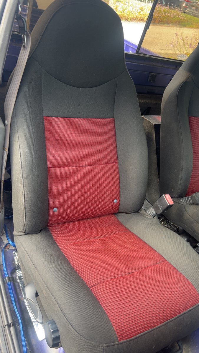

Sold the single cab seats and picked up these from what i was told was a 2004 extended cab (not sure what model). They mostly bolt up, some slight spacing differences, but theyre definitely taller than the original seats. They're an improvement over the stained/ripped/cigarette burned original seats., but not thrilled on the height increase. I have a center console, but once again, it doesnt fit correctly. Im assuming i need the mount bracket for an extended cab.
Also, found a couple pin holes in the floor so need to replace the floor pan before i install the vinyl rug.
Those are NICE. I hope I can find some that clean when I go shopping next time.
Thank you, I wish I had some 96/97 buckets but these will work for now. Any idea what model theyre from?
04 sounds about right. Not super familiar with newer stuff.
