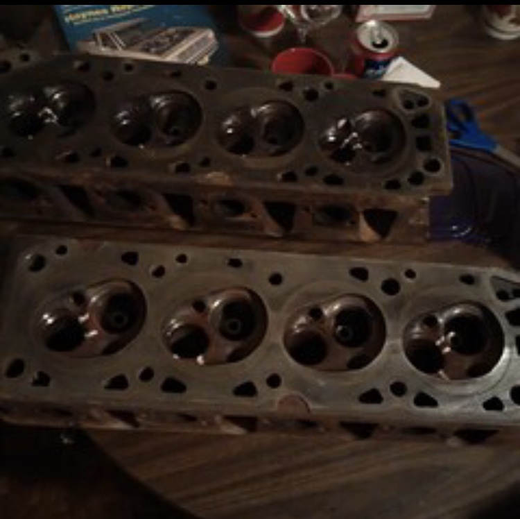

Definitely get it magnafluxed! I had cracks in every valve seat, same on a junkyard head I bought. I ended up getting a remanufactured head from autozone. As a added plus it came with new valves and cam bearings. The dual plug head I feel is prone to cracking over time due to thermal cycling, just not as much iron there as with a single-plug head. Heres a picture of my original & junkyard head. Im not sure which is which. (its been 4 years since this was done) Its kind of hard to see the white marks in the photo.I originally tore mine down due to a blown head gasket between cyls 3 & 4. It still ran but horribly. I had the head checked as was suprized at all the cracks in the valve seats. Junkyard head wasnt as bad but still-junk. I dont know what a 2.3 lima head goes for now @ autozone but I “think” I paid $200/$250. Ive not had a issue since. My ranger had about 150K on it at that time, Im at around 170K now.

IMO sticky rings would cause more problems than deeper valves but definitely have them checked for cracks for sure, use the best one that isn't cracked :)
