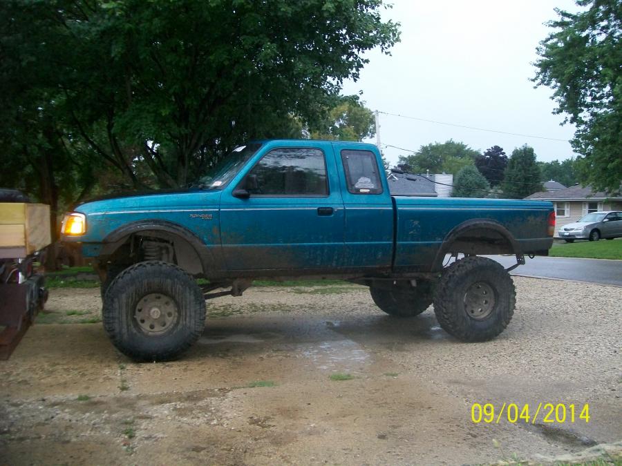

After SAS 8" lift and 33 super swampers. there is not a body lift on it the bumper is just lowered due to stupid illinois laws.

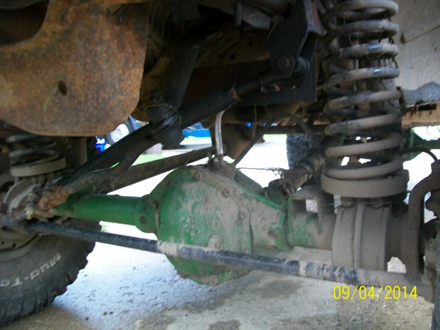

Truck looks good!! Any pic of how u did the suspension.

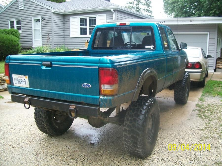

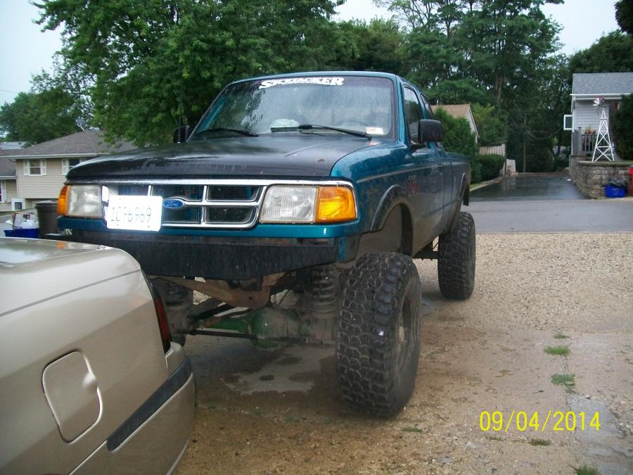

Here it is finally with 4 wheel drive working again. The rear axle is out of a 2001 explorer with a Detroit Tru-Trac and 4.56 Yukon gears, front is a 74 bronco dana 44 with disc brake conversion, Yukon Grizzly locker, and motive 4.56 gears. almost brand new 35" bfg KM2's for suspension i did skyjacker 6" leaves with stock block out back and up front bronco graveyard 5" early bronco springs, custom panhard bar mount and very custom and soon to change steering setup which I adapted some parts from a ranger and some from a bronco. I took it out yesterday(the rain washed most of the mud off already) and it is a beast. hopefully Ill get to wheel it a little bit more before I leave for basic.
