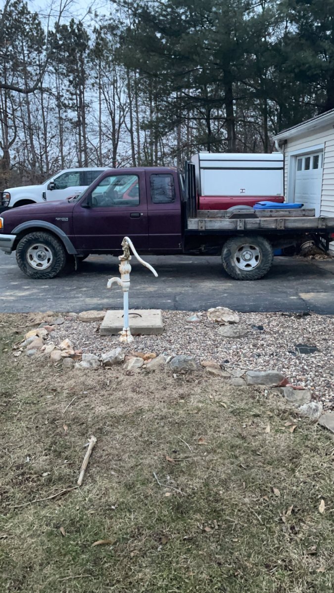

I'm still figuring out what parts I want to use and putting together a plan of attack. The overall plan is to build this truck to be able to daily drive it and also have it for use on hunting trails/ easy offroad during season. I've got new clutch components on their way to swap in a 5 speed from another truck, trying to get prices on and figure out what rear springs I want and subsequently how much the front will need to come up. Ive cut about 10" off the flatbed and have a utility shell I'll build a base to be able to mount to the flatbed during winter. Gonna rock the mud tires for a bit but might just get a new set. I'm calling it Grimace since its a wonderful purple, decided to build it over using for parts since its my age down to the month.

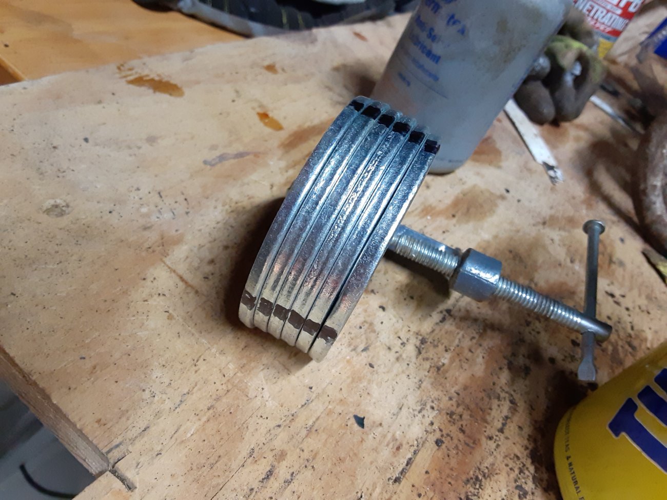

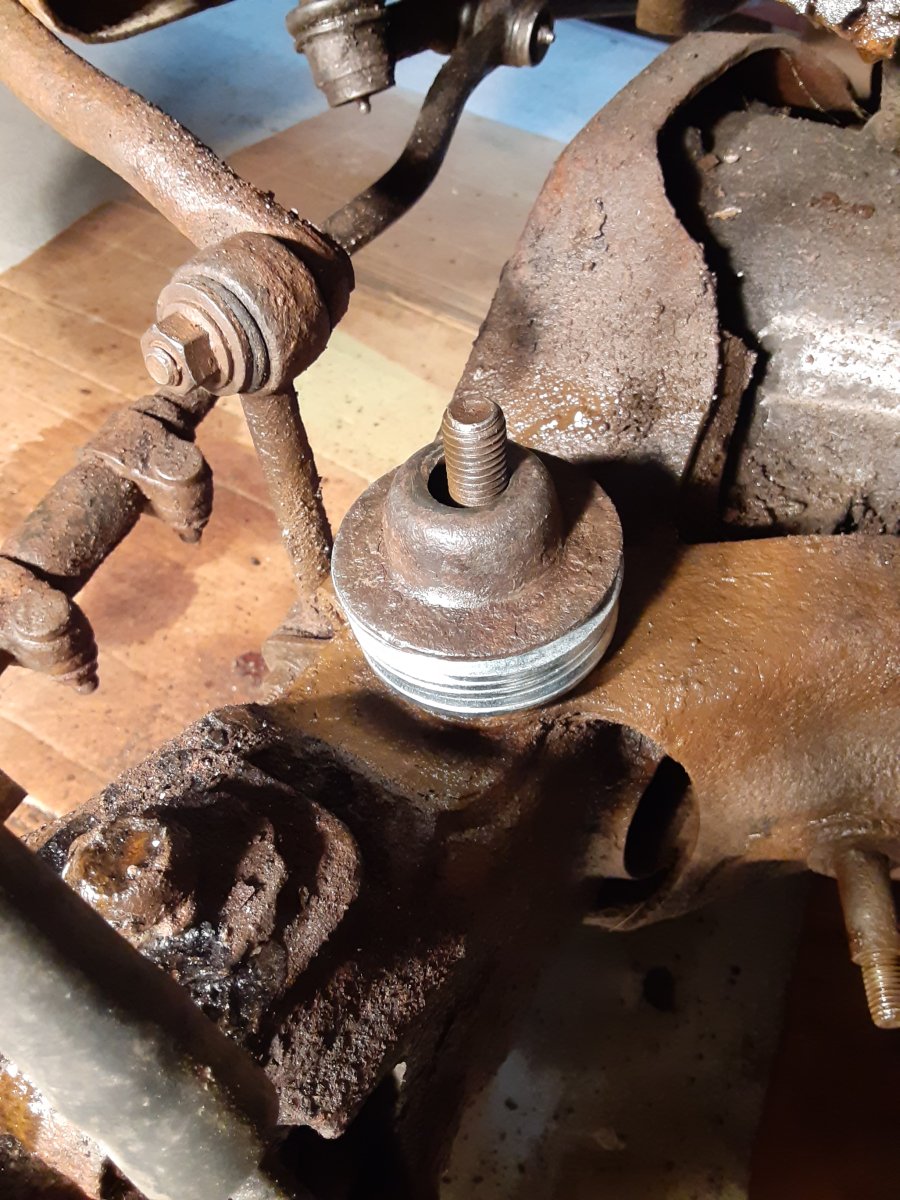

If you want to space the front up a bit either going to new springs (I think first gen Explorer coils are a bit taller but might be the same as super cab springs) or get some 1 1/4" washers to space the bottom of the coil up... I say 1 1/4" washers since they have the 1 3/8" hole you need to fit around the hex, 1 3/8" washers are exponentially more expensive and have a 1 5/8" hole... it's like lumber math, don't ask, I don't know...

Thanks for the tip on the washers. I’ve seen some of the puck type spacers and leveling coils but washers sounds a lot better so long as my springs are in decent shape.

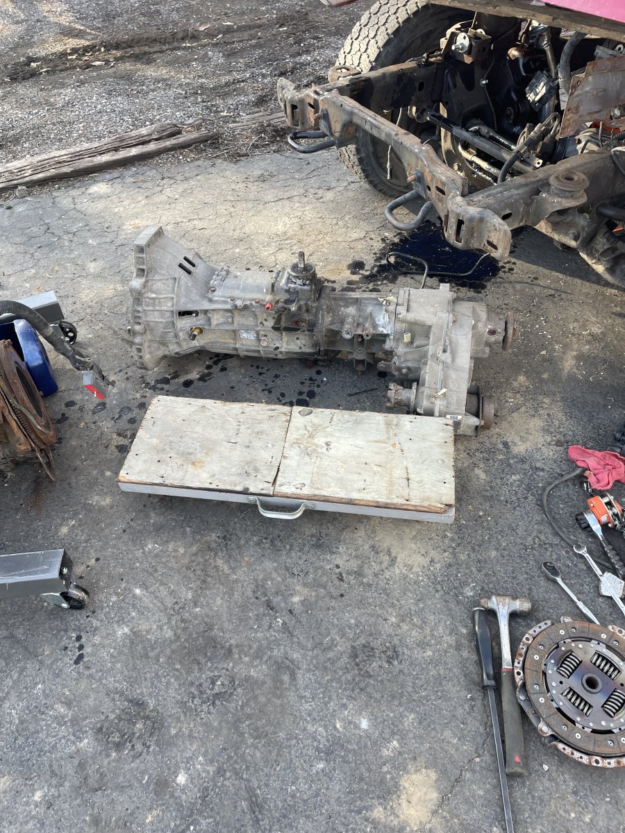

Got the donor transmission and case removed. Grimace is in the air so I can fit underneath easily, I’m too used to working on my super duty or larger. The new pup supervised the work today since it was so nice out

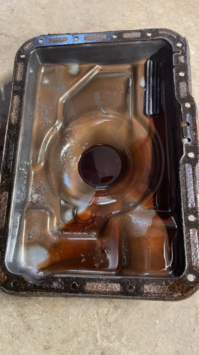

Drained the automatic transmission before pull it, should have it out this evening taking my time on it. After seeing inside the pan I’d say doing the manual swap was the smarter move for sure. With any luck I can drive it out of the garage within the next week. Then it’s off to a car wash with a bag of quarters and plenty of degreaser. Lower engine is nasty looking and the rest of the truck is covered in dried mud.
1994 ExCab 4.0 "Grimace" 1994 ExCab 4.0 "Grimace" 1994 ExCab 4.0 "Grimace"
These are the washers I used. Spot welded them on three sides (the black marker). About 1-1/2" lift for leveling only.

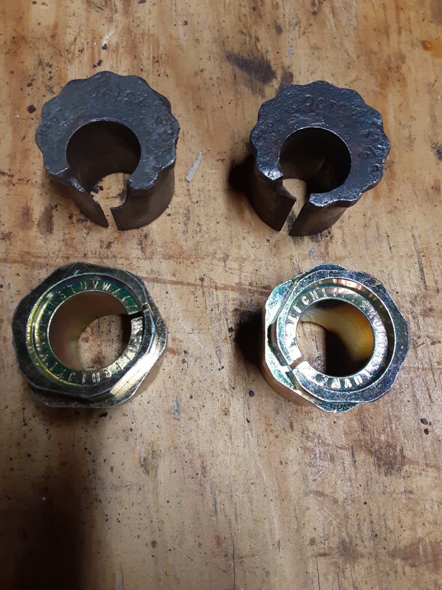

Adjustable bushing for DIY alignment from Amazon.

Ended up ordering leveling springs, if I remember correctly mine are past the measured height anyways. Still can fine tune height with washers though. I’ll have to track down some adjusters to have on hand. On e ride height is settled I’ll get it aligned before spending on some new tires. TIL then the mud terrains on it should be ok
Got the busted auto out after fighting it way too much. could have saved myself some trouble if Id undone the torque converter from the start. But now ive got it out, the flywheel and spacer plate out. I tapped in the freeze plugs on the manual trans to hopefully avoid any leakage and issues from it. Hoping to get teh new flywheel with bearing and the clutch installed tomorrow night. With any luck ill have th trans in and the truck back on its wheels by the end of the week, maybe even driving out of the garage.
Making slow forward progress, working after work in the evenings for a bit here and there. Ive got the transmission and transfer case in the truck finally.
As a bit of advice for someone doing a manual swap, yes, it's possible to remove and install a transmission with the exhaust in place but man does it suck. Also, be sure to check for the alignment dowels before the transmission is only inches from bolting up, its not fun removing some with everything there.
