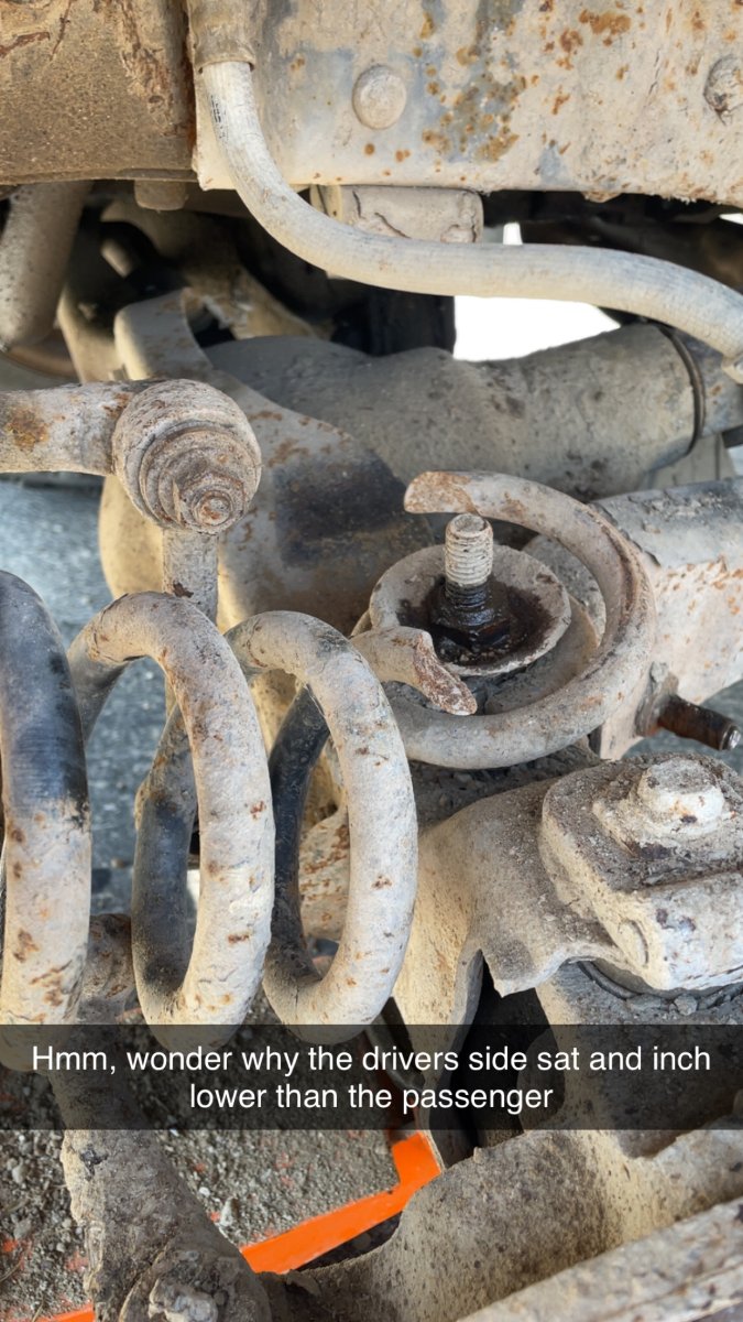

Started on the front suspension since I didn’t feel like swapping out the brake/ clutch pedal assembly. Started on it anyways since I didn’t have a socket for the suspension bolt, or so I thought. Guess it’s a good thing I’d bought a new set of coils. Hoping with the all new suspension I don’t have much of a lean, otherwise I’ll have to shim the drivers side a little to even out

Looking really good in that shot.
Both my front springs looked exacltly like yours when I pulled 'em.

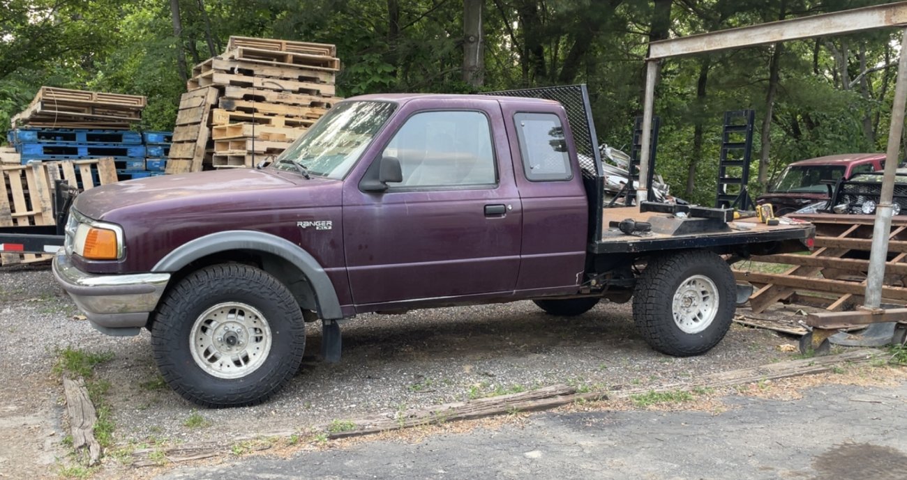

The pic of the truck is where I’m hoping it’ll sit if the new coils give me the 1.5” lift/ level they claim. It it comes close I’ll be plenty happy with it. I still might get the Chevy shackle for the rear but I’m undecided yet. I will for sure be removing the fenders on the flatbed, even if it means lowering the bump stops a little

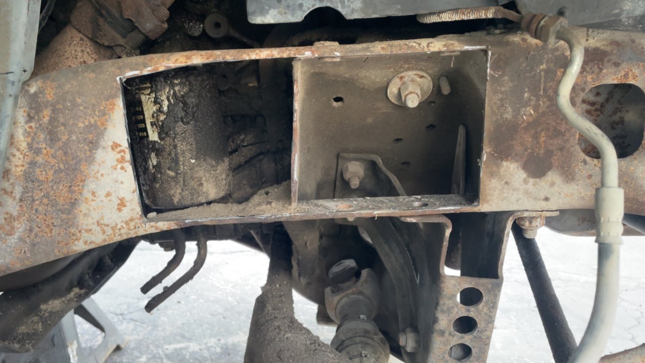

Mine was about the opposite, didn’t really take a ton of force with my 2’ ratchet but they do look like nyloc nuts. But now I’ve got more work ahead of me, the passenger coil bucket and frame behind it are rusted out and looks like the passenger radius arm hole is wallowed too. Debating pulling both coil buckets and patching/ plating the frame behind each. Then I guess a new arm mount as well
Got the passenger side bucket off and the rust cut out. Should be able to get the filler pieces welded in within the next couple evenings and get my new buckets installed when they get here. Is there any reason I couldn’t drill a hole or cut the bottom of the dish out where stuff can sit and rot the frame?

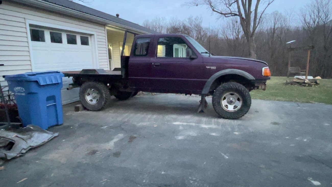

Making little progress as i get the time. Its sitting on its own again and I've been working on mounting the flatbed so its level with the body lines. Then get to weld on the taillight panel and redo all the rear wiring to clean it up. Im waiting to hear back about another ranger for parts, most importantly the passenger steering knuckle since mine doesnt hold the inner brake pad anymore. Id love to find a 95-97 to get the knuckles from but just trying to get the truck on the road right now.

Grimace goes in tomorrow for a front end alignment finally. Pretty much rebuilt the entire front end with updated brake components, all new suspension. I’m planning to finish up welding the rear hitch tonight, I moved the receiver portion so it’s tucked up and under the rear of the bed instead of hanging down.
Still plan to install an isolated deep cycle battery, aftermarket switches and plenty of lights once I decide where I want them. I’ll also be on the look out for an explorer rear end to set up with 4.10s and make sure the disk brakes are all freshened up. Then gear swap the front to match.

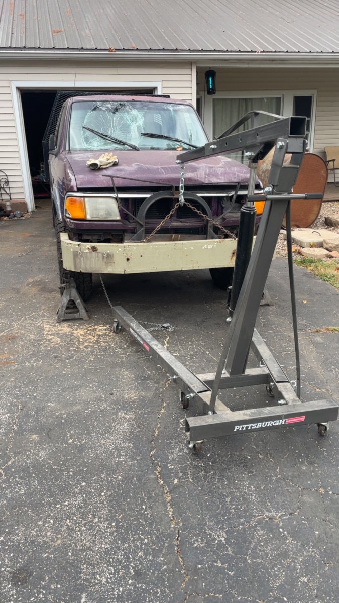

Got an update but unfortunately its not a good one. While respooling a new winch I learned the hard way that the cable retaining bolt was not even snug. Once the ranger rolled to the extent of the cable it kept on rolling down my big hill till it hit a couple trees. Destroyed the front bumper, busted headlights, the fiberglass panel, some bent sheet metal and the obvious smashed windshield.
So, I decided to build my own replacement bumper out of some 8" C channel and integrate a snowplow hoop into it so I have a useable plow for my driveway. It'll get a 2" receiver for my winch cradle, most likely some D ring mounts and attachment points for a tow bar.

Wow! Ultimately trucks can be fixed. Glad you're ok.
