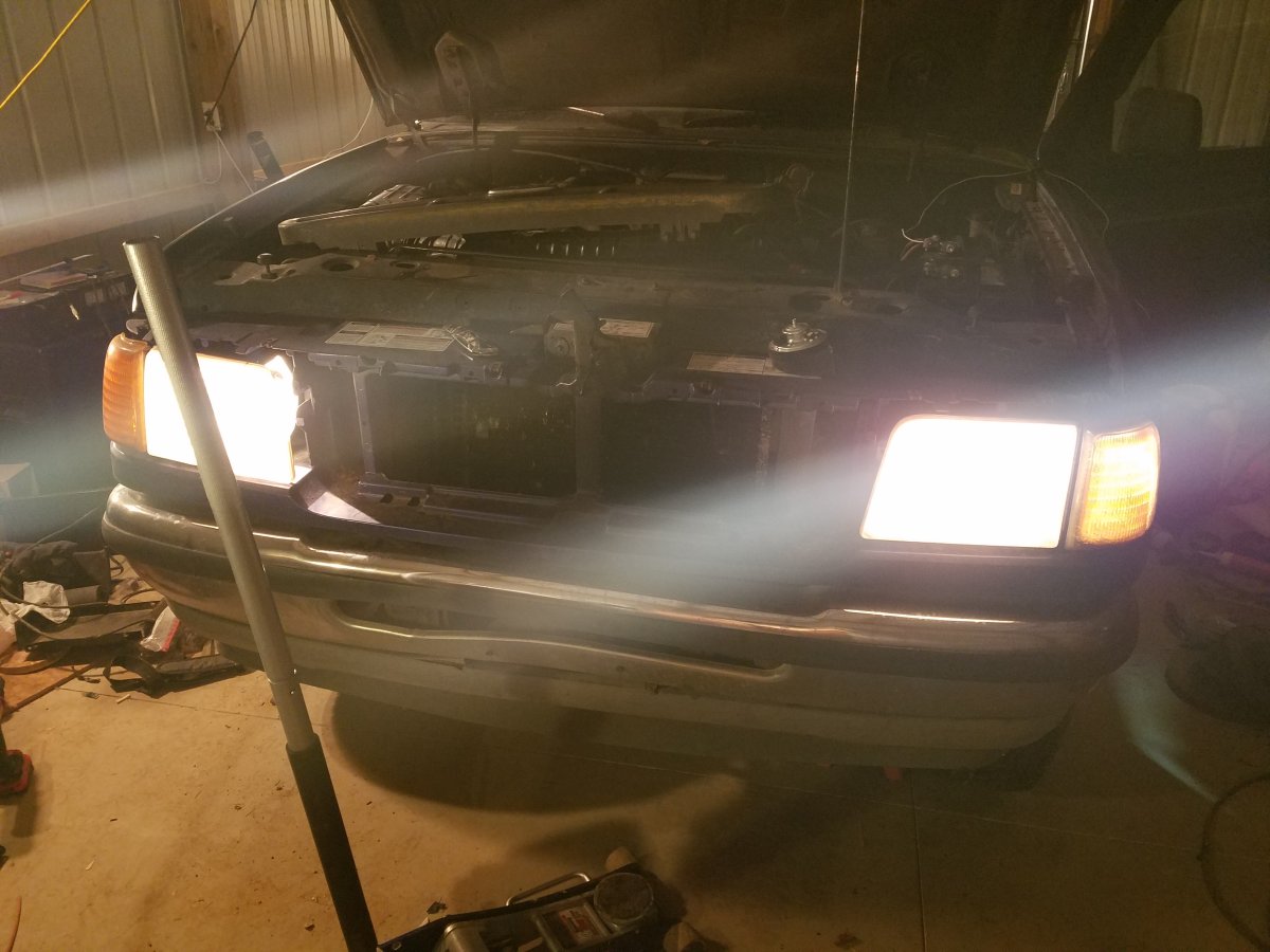

Currently getting it ready for inspection, to get it tagged in my state. I got the lights on and working. I also found out the horn is a siren. video
I replaced the header pannel today and got the old lights back on. They function, but thats about all i can say. Does anyone have any recommendations for projector headlights, or c style dlr leds? The ones that i have found all have very mixed quality reviews.

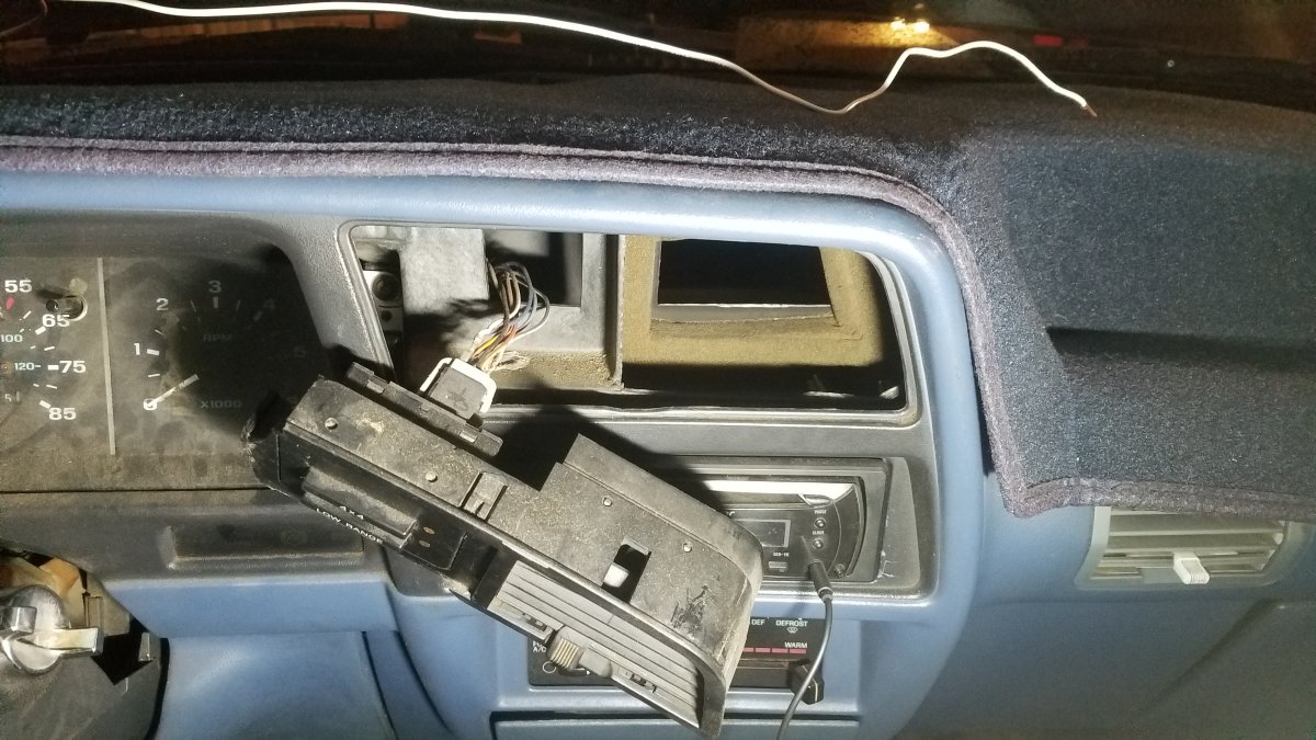

Also, the light switch/dimmer/dome light contraption was lose and i took off the cover and I'm not sure what secures it.
Well, apparently the only replacement bezel knob that fits this is on amazon for $10, unless you want to scavenge a junkyard. light switch bezel on amazon
I will get this ordered, and update with the install.

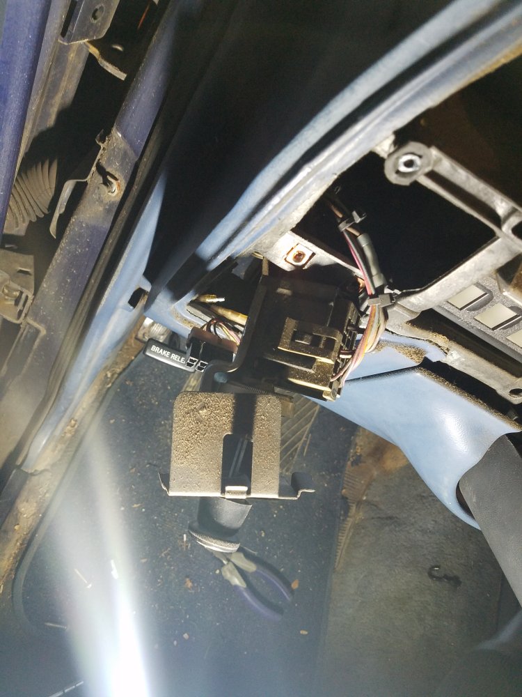

Yesterday I tested the 4x4 switch and module. They seem to be good. The clutch sensor does not seem to be working with my tests, however the truck only starts when the clutch is depressed. Not sure if theres two sensors.

However i did get the lights and signals working.

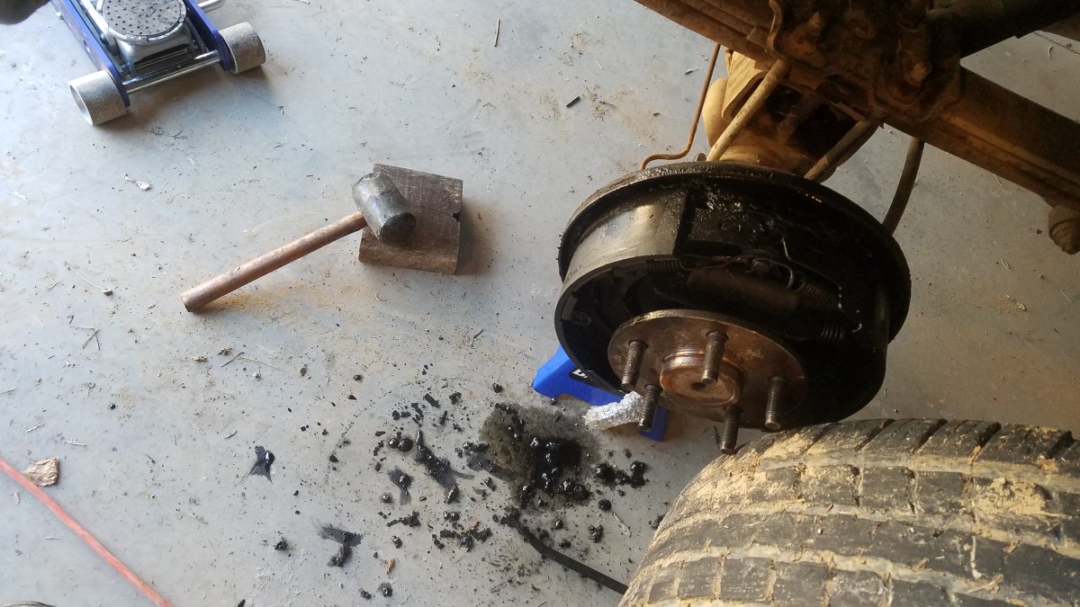

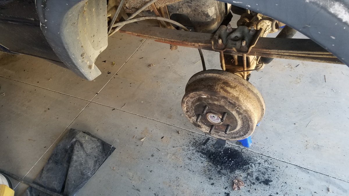

Took a look at the brakes, front lines look a little frayed. I ordered new ones. I cleaned the drums and turned them, they look good. The reservoir was about half full, so ill blead the lines once i get them installed, so i get all the old fluid out. all the pads looked okay. however the abs light was on and when I was driving down my gravel driveway and applied the brakes, the front passenger locked up.
No just the one switch on the clutch lever. These trucks use this switch to keep the engine from starting unless the clutch pedal is pressed all the way in. Its the neutral safety switch and is working as it is intended to.
I hope this takes one thing off the to-do list for you.
I gotcha thanks, its weird cause when i did a continuity test from the 4x4 module connector the clutch sensor wasn't getting a closed circuit when i depressed it. this will keep the truck from going into 4 low. Now ofc it isn't going into anything at all right now, but ill keep this in mind if i end up putting a shift motor on it and it goes into high and not low.
I'm not sure what year they started with full 4 wheel abs but for sure 93-94 were RABS only. Meaning Rear Anti-lock Braking System only. Your front tires will still lock up and 1 rear can lock up. The system only kicks in when both rear brakes lock up at the same time. Because it is rear only and only one line feeding teh rear brakes from the RABS valve both sides get the same pulsation unlike 4 wheel independent ABS. Yes it sounds useless and the system pretty much was useless but mandated by the government . IIRC any truck from '86 on needed RABS to be equipped I may be mistaken on the year it was mandated to go into effect.
I believe in the tech section there is a writeup about how to pull the codes from the RABS module but I know for sure there are youtube videos on it. Super simple, there is a RABS wire under the dash that you just jump to a ground and the ABS light spits out the codes in flashing pulses.

The 1994 4WD system didn't need the clutch pedal switch for Neutral
Speed sensor needed to show 0MPH in a manual to shift into 4Low, and with a manual that is "neutral", lol, either clutch pedal is down or trans is in neutral if engine is running at 0MPH
An automatic did have a Park/Neutral switch which needed to be grounded to shift into 4Low, and also needed 0MPH
Thanks that will help me alot! Yeah i was reading about the raps system but hadn't dove into it completely yet. I just wanted to visually inspect the brakes first.
