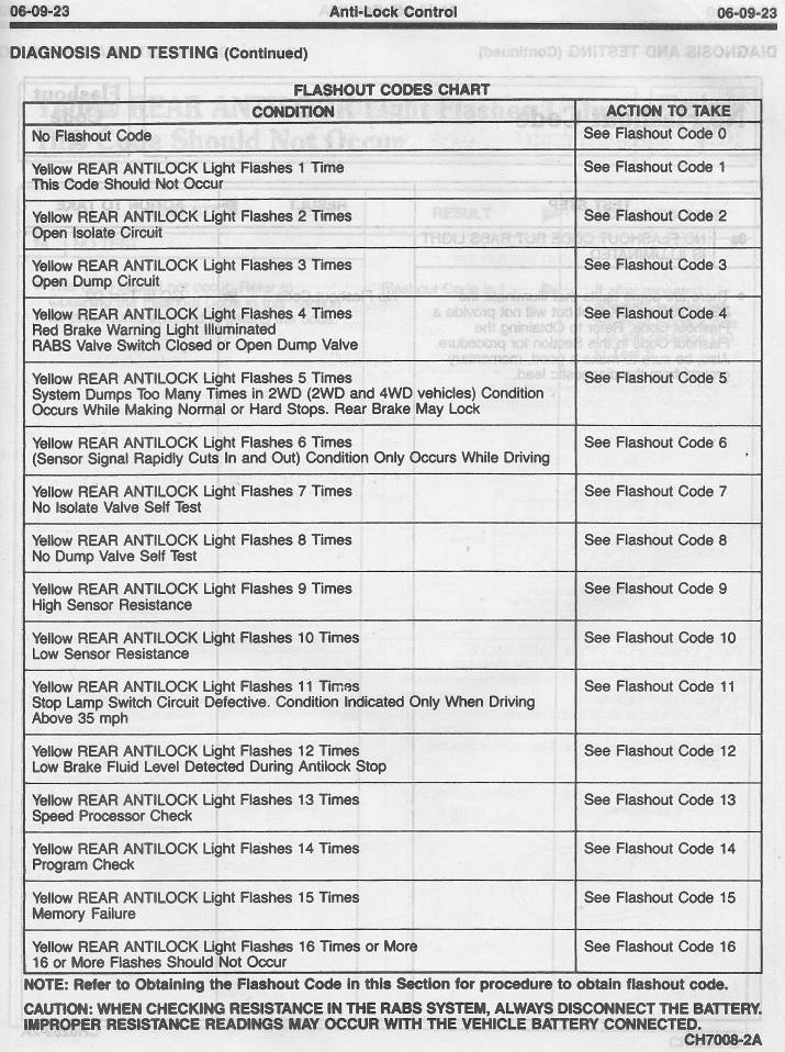

I pulled the code from the dash RABS light this morning. I came back with code 12.
1994 4x4 manual TDI swap
found this chart on another thread. Code 12 makes sense because the prev owner said that the fluid was low, and as of now the reservoir is only about half full.

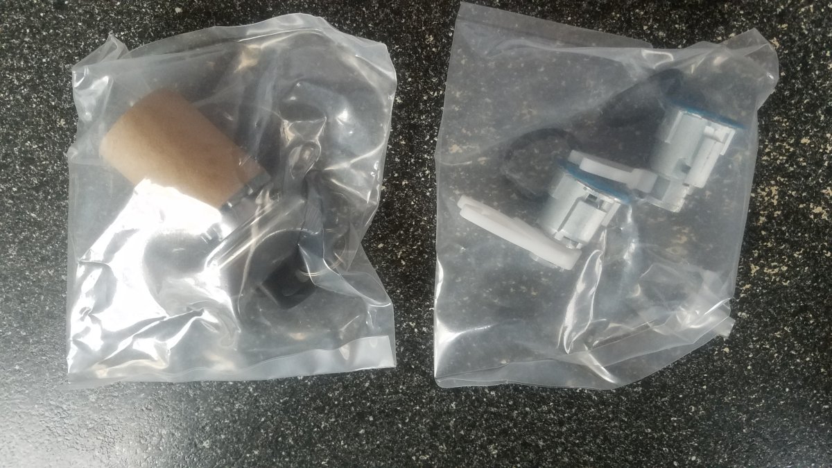

Yeah i got the connector apart, both tabs were broken so it wasn't really that bad. i did a resistance test between the yellow and orange leads on the motor which supply power and the circuit wasn't closed. I figured this was the problem so ill be ordering a new one.

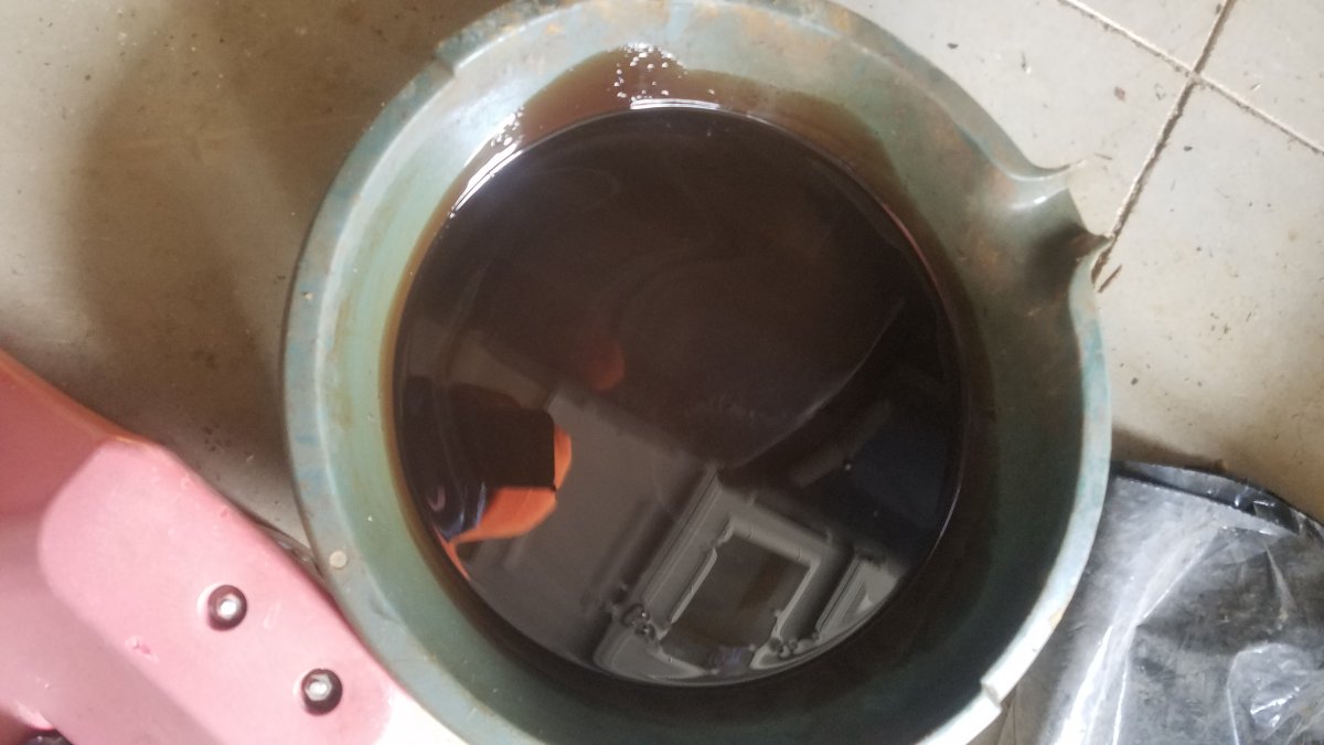

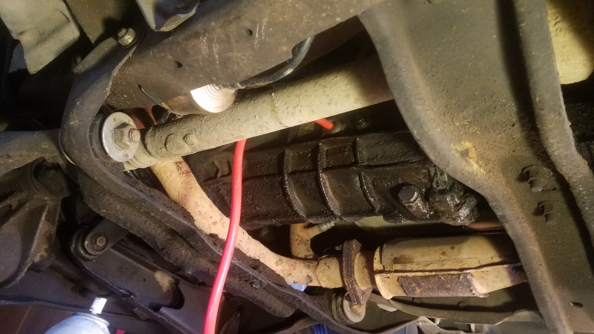

So today i crawled under the truck a managed to get the fill and drain plugs out of the transmission. The black ooze that came out was quite nasty. I let it drain for a while, and came back and reinstalled the cleaned drain plug. I pumped in some mercon atf and filled it up.
Does anyone know the torque spec for the fill and drain plugs?
I have a haynes manual, and all it gives are the trans to engine and trans to mount torque specs.

30-35ft/lb for drain fill plugs

The Black ATF was probably 20+ years old

Yeah that old gunk was probably only changed once in the trucks 30 year life.
