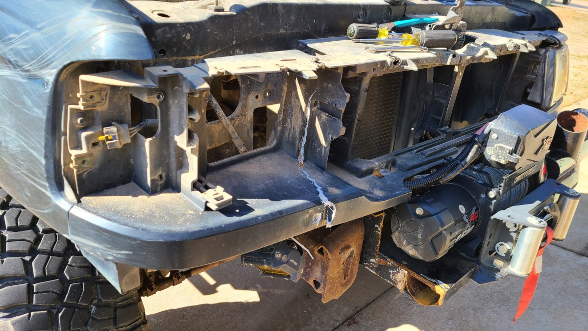

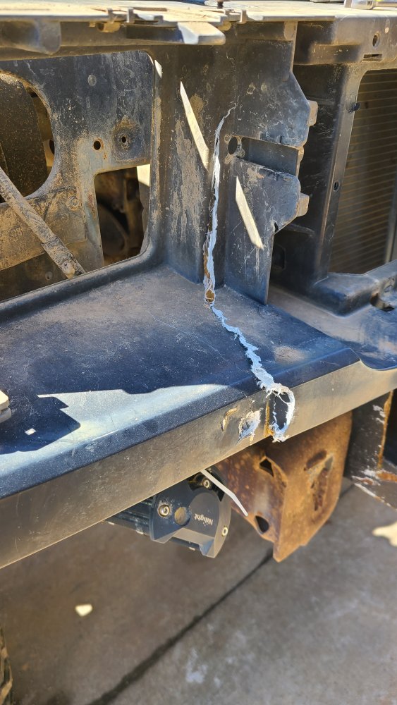

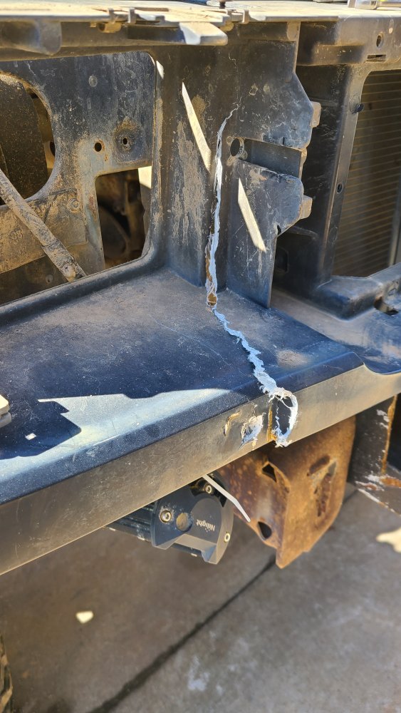

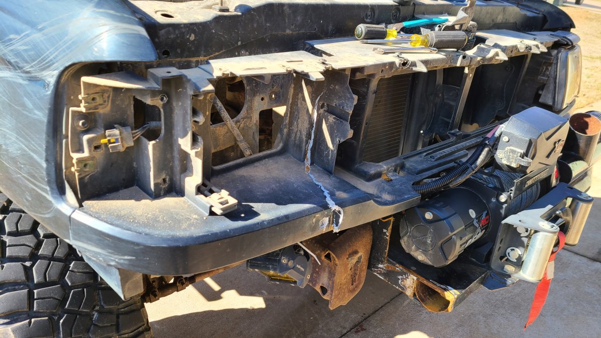

My stock headlights were replaced years ago with cheap ebay units. Never really been happy with them. Never really liked all these molded plastic headlight/turn signal things anyway. Currently, the whole fiberglass structure around the passenger side is broken. Could I repair fiberglass? Yes. But I hate that stuff.in the future, if I break one, I just order another standard 7" round headlight. None of this "does it fit my ancient truck?" bull.
Nope, nope, nope. I refuse to do this fiberglass repair.

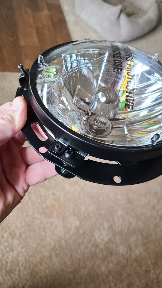

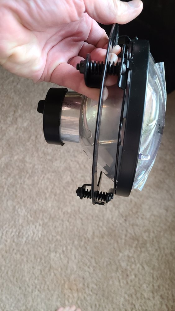

I really likebthe headlight brackets I found. These have spring-loaded adjustments for aiming. The back side is a flange with mounting holes that will be easy to bolt to whatever support structure I dream up. Marketed for use on Harley Davidsons. The KC lights fit perfectly.
