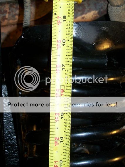

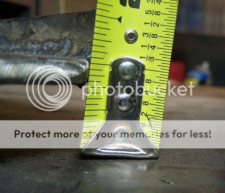

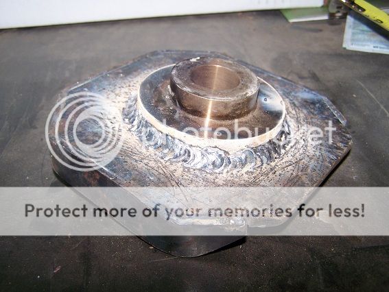

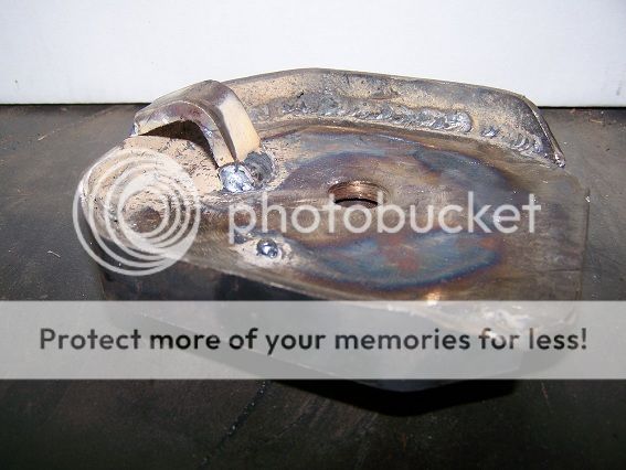

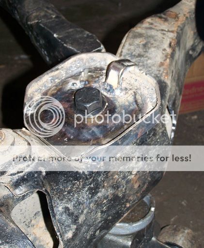

Got a little more done tonight. These coils are entirely too tall. A loaded BC Bronco 3.5" lift coil (20.5" long) is 17.5". Add the 1" tall lower coil seat, and you get a total of 18.5". A 4" TTB loaded coil is right around 16". So Im looking at right around 6.5" of lift total. I've done some thinking, and Im going to keep it that way and remove my body lift (mainly so I can get it out of the garage :D ) Anyway, on to the photos.

Lookin good :icon_thumby:

you must also take into consideration that the coils will "settle" some....
