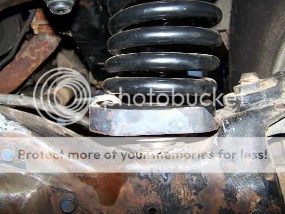

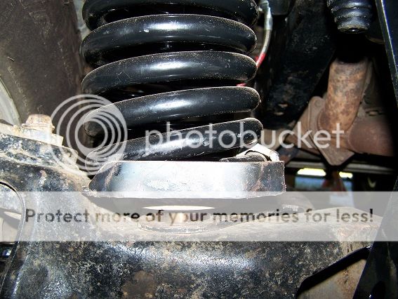

Not much of an update but I got my other lower coil bucket fabbed up tonight and one of my upper coil retainers.

Well I got the truck sitting on all 4's with new springs and front leaf spring hangers. I dont have as much lift as I thought I would. They netted me right around 5-5.5" of lift, which is perfect. I have to re-do my one lower coil bucket retainer as it's binding up on the coil and making it sit higher on that side.
