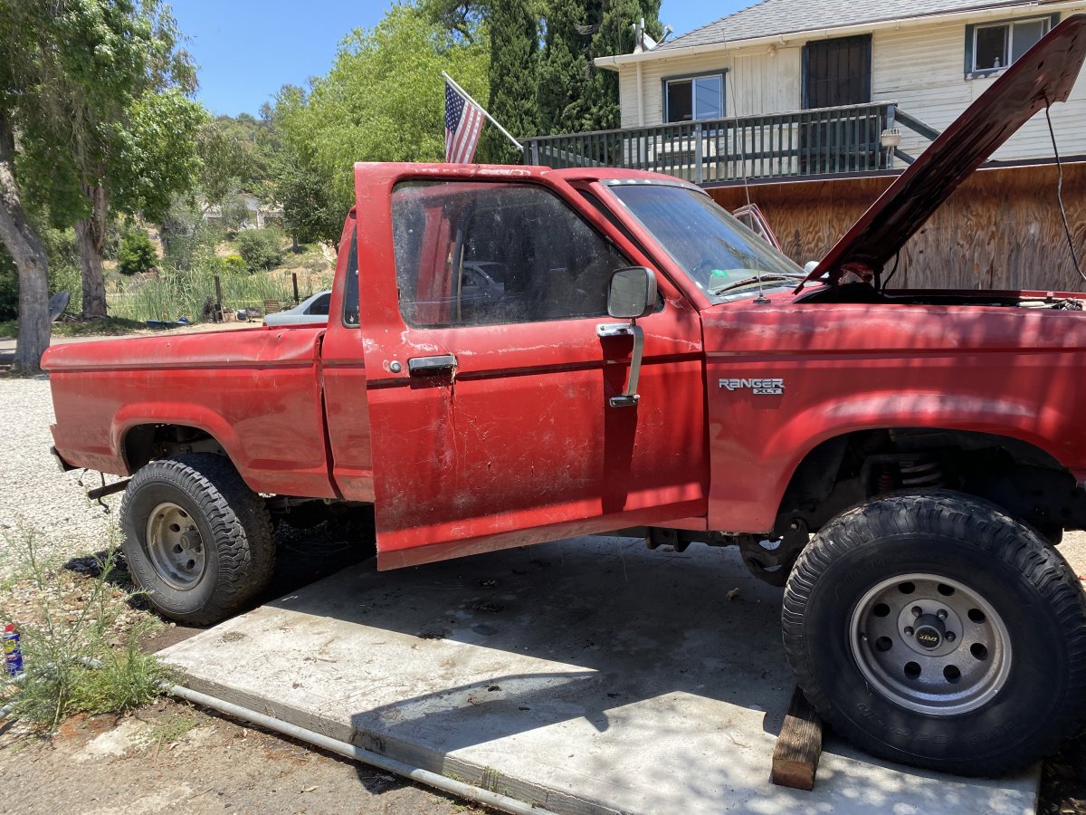

I have a 1991 4.0 v6 ranger XLT and have no power to my fuel pump. The only source of power I have is 4 volts that I figure is the fuel gauge. I have replaced the 30A fuse, the fuel relay switch, and have bypassed the inerta switch;(all 3 have proper power according to research on fourms). The truck has sat for about 6 years so I also have a brand new fuel pump. Starter fluid makes it run for a second or two, so spark air but no fuel. Any knowledge on this issue would be amazing. Thank you!!

I ended up troubleshooting it down to a bad ground. In the 91 4.0 ranger there is a 40A fuse/ECC relay that powers a lot of small components under the hood (injectors,sensors,etc). One of the wiring harnesses go back to the transmission solenoids, and I had found that the wired had melted to the exhaust manifold and caused a short on the solenoid plug in and melted the whole thing.. I am going to upload a video to YouTube in hopes that I can save someone some time and money.
