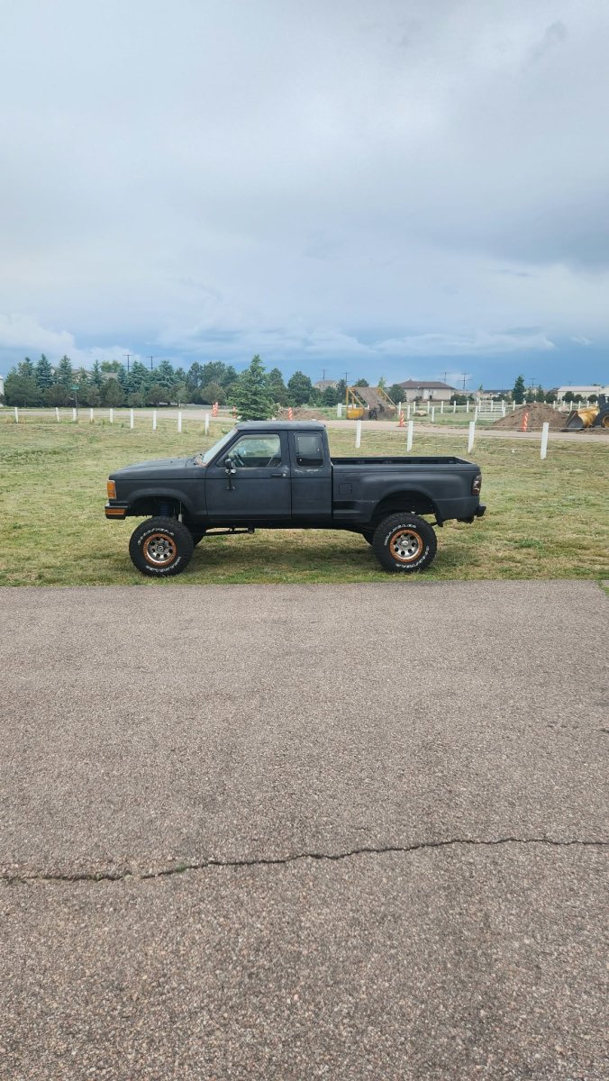

So it was covered bedliner and had a 93-97 ranger splash step side bed on it.
it sat for 5 years before I got it. In my first week of ownership the distributor broke, fixed it, later the truck caught fire on the interior due to some wiring issues, and so the journey of a constant battle of tear apart and repair started.

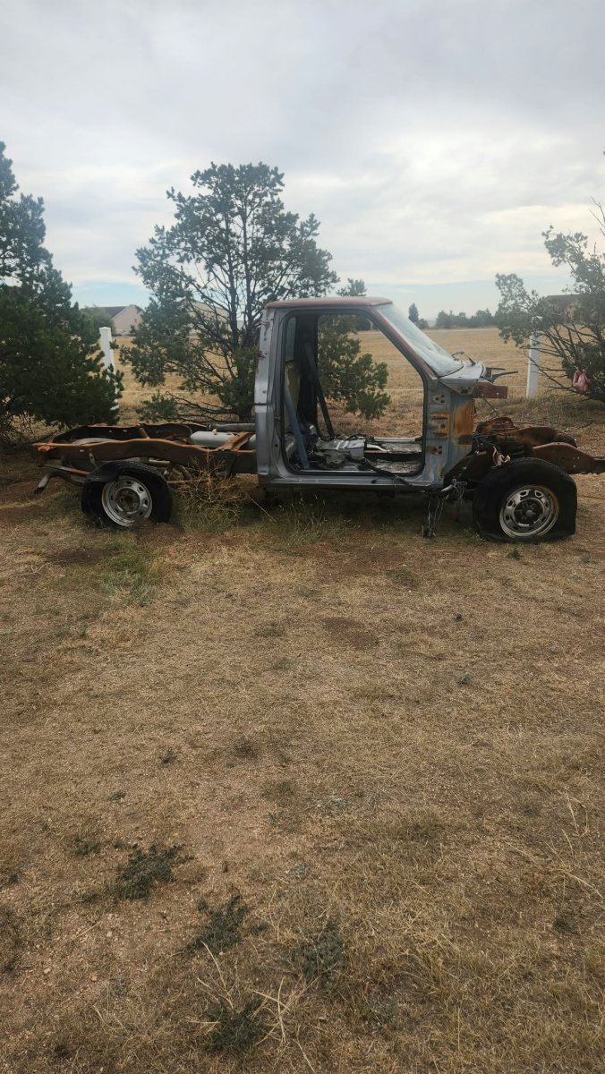

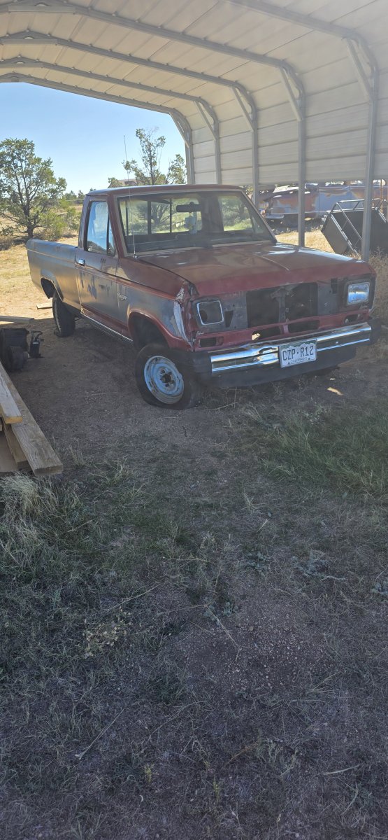

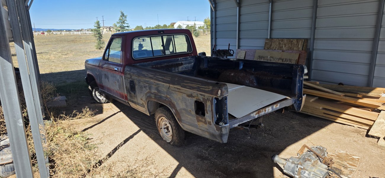

I bought a 1986 single cab for 300 bucks, this is after I stripped the truck down, the frame and cab were damaged badly on the drivers side.
It's bed got swapped onto my truck and while inspecting my truck I discovered my radiator was held up with self tappers, so I thought "oh I like the 83-88 front end it should be a easy swap." yea no.

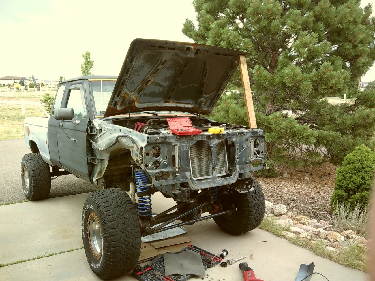

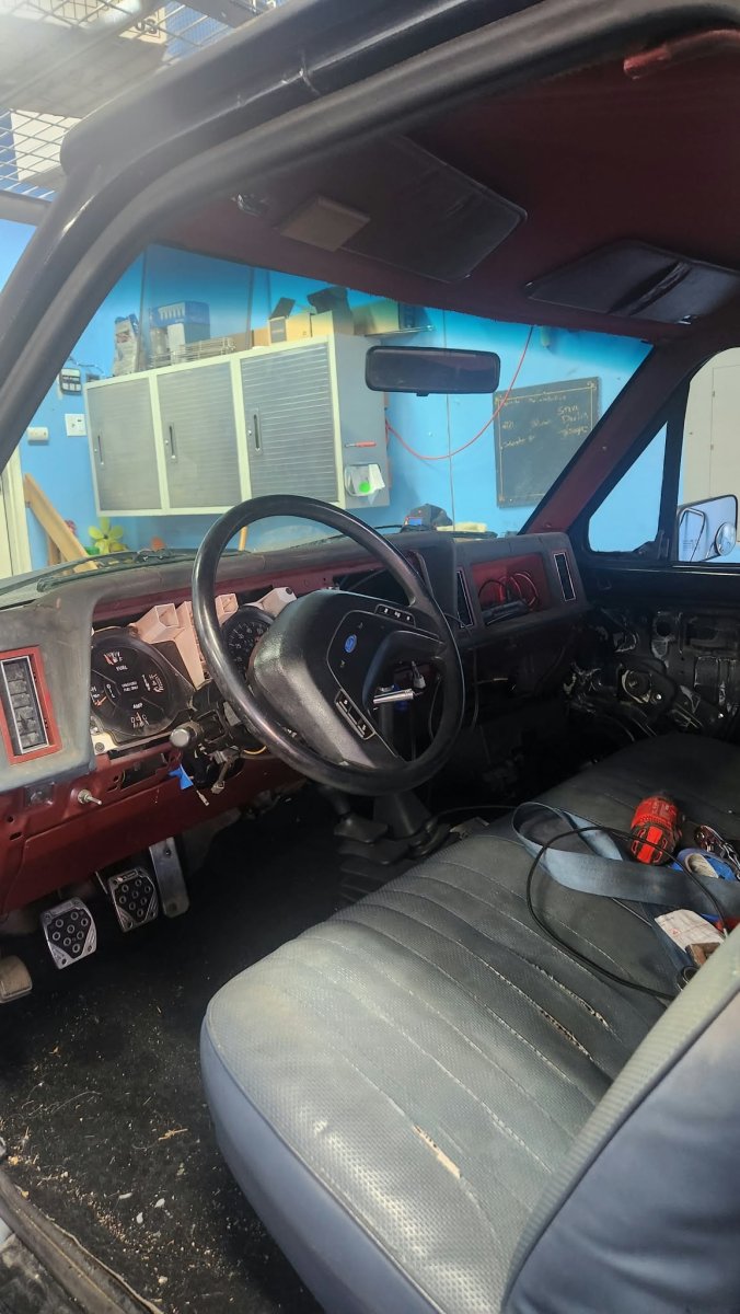

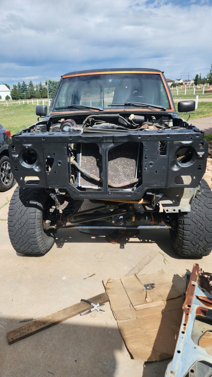

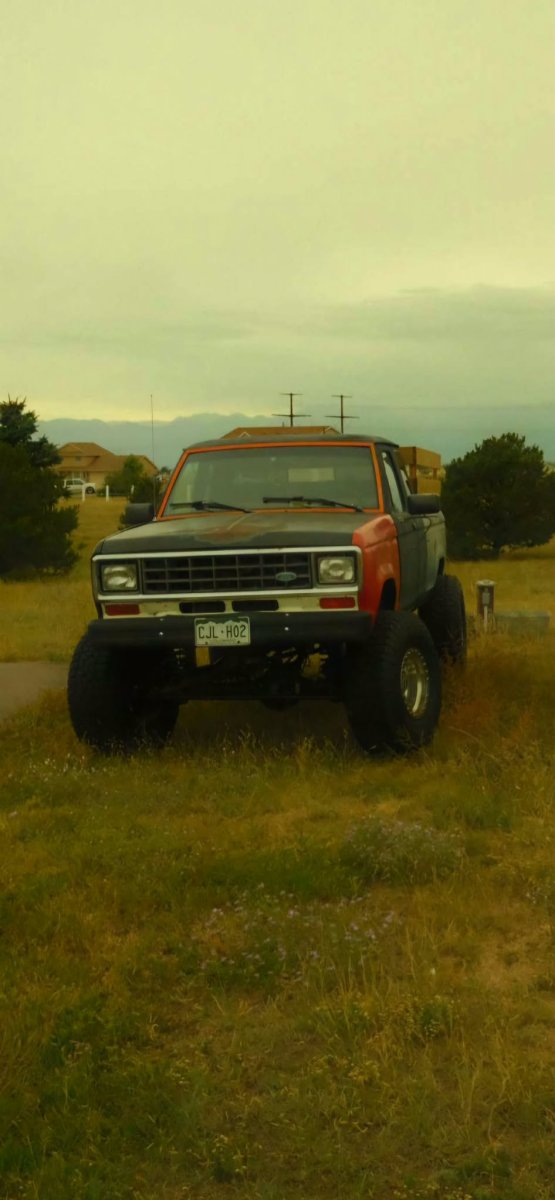

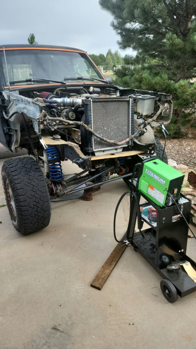

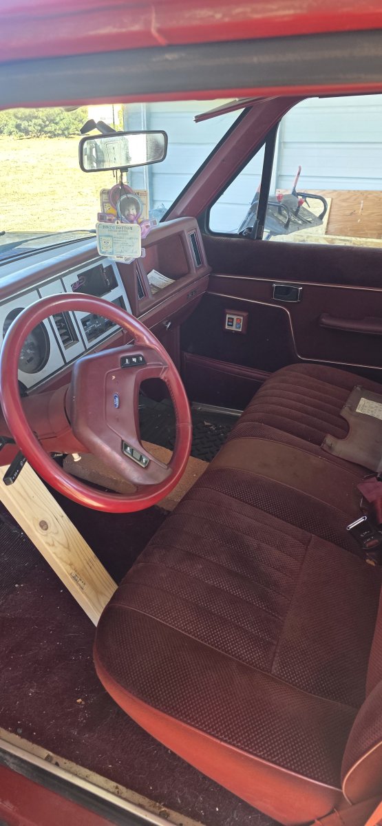

Nearly a month of work later and I had a full front clip from a 84 ranger installed along with new 35 inch falken at3ws. I shortly after swapped the entire interior to a 87 red interior.

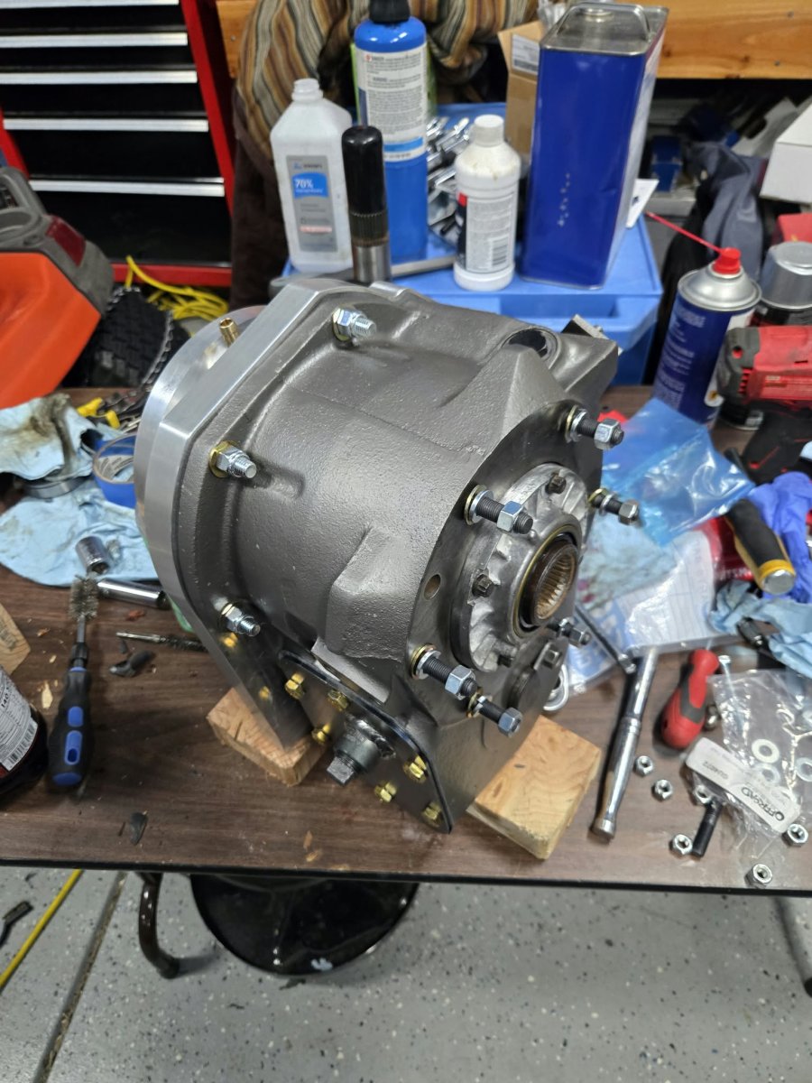

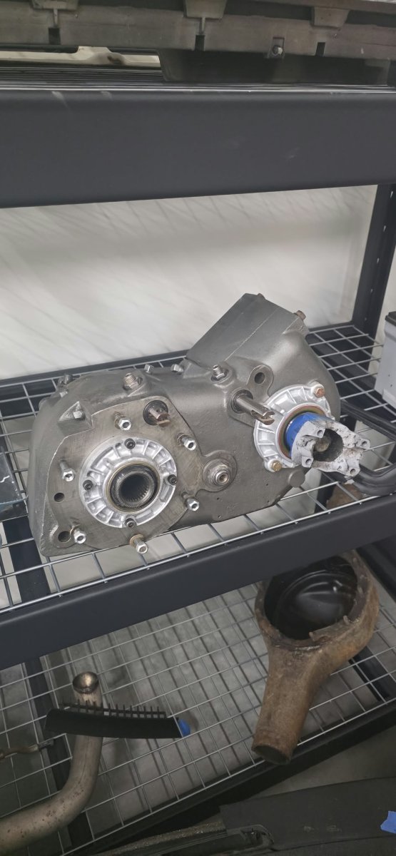

I went through I don't even know how many engine options, transmissions, transfer cases. first was f150 302, e4od, bw1356. The 302 was junk, the e4od was damaged. So I sold it all then got a np435 for cheap, and np205, and my neighbor offered me his freshly rebuilt 302.

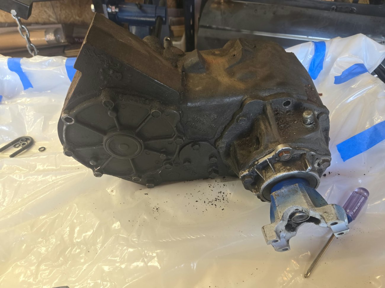

The "16,000 mile" np435 was full of water rust and lots of metal. I am still finishing the rebuild as it needed a new idler gear. The np205 is all buttoned up and pretty.

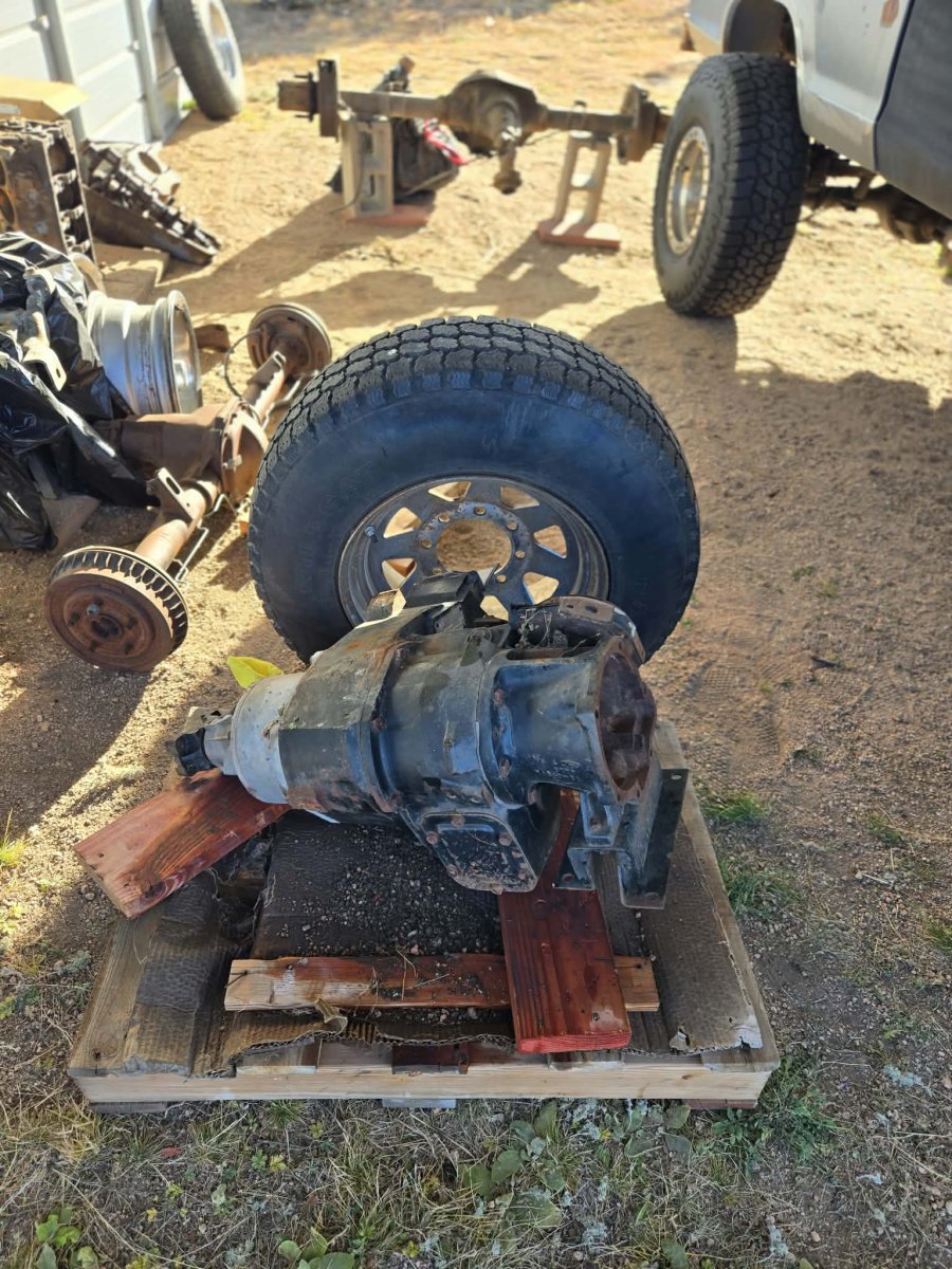

I eventually gave up on a budget build, so I picked up a np203 for 150 bucks, and bought a Offroaddesign doubler
1990 Supercab rock crawler build

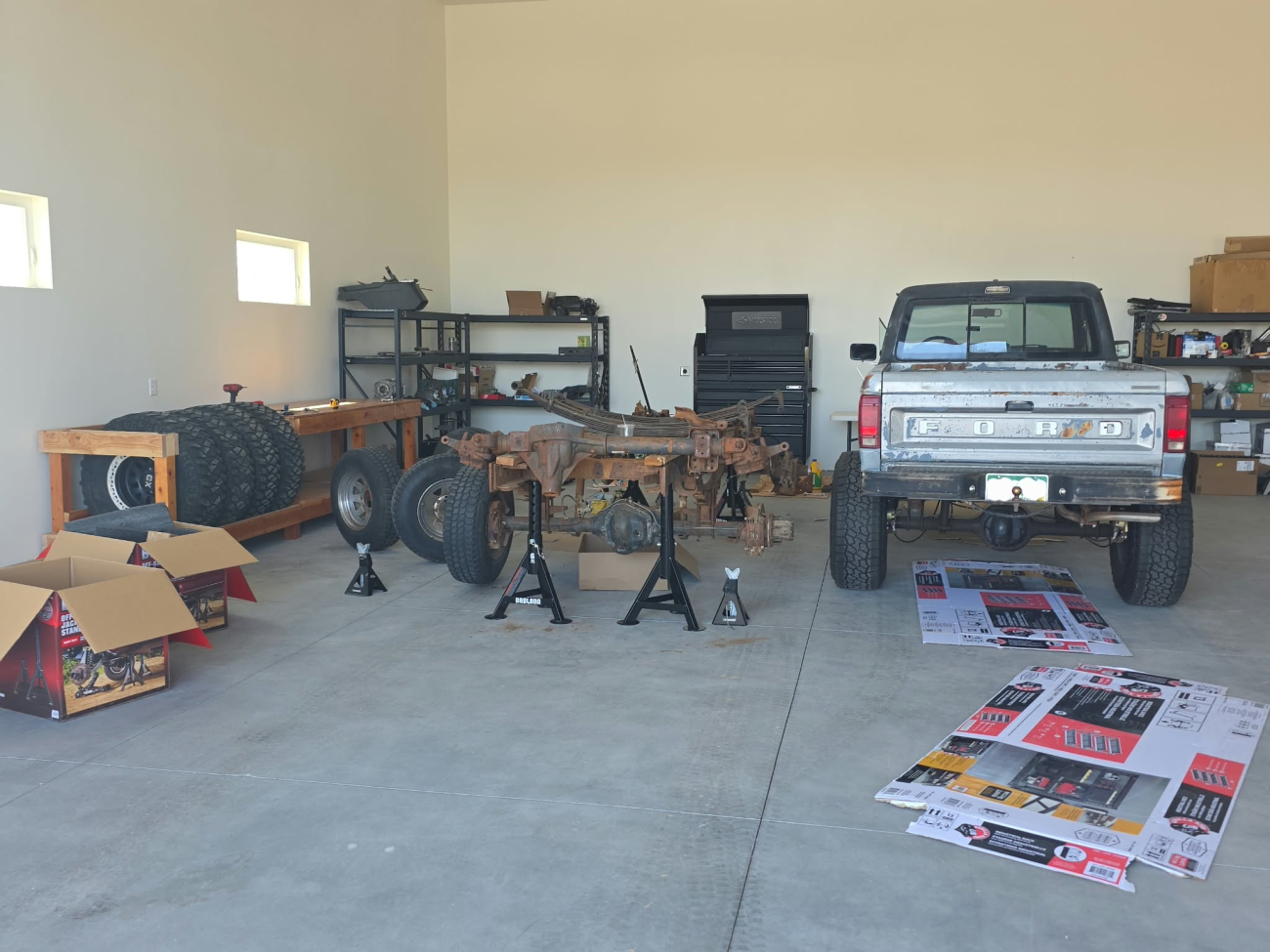

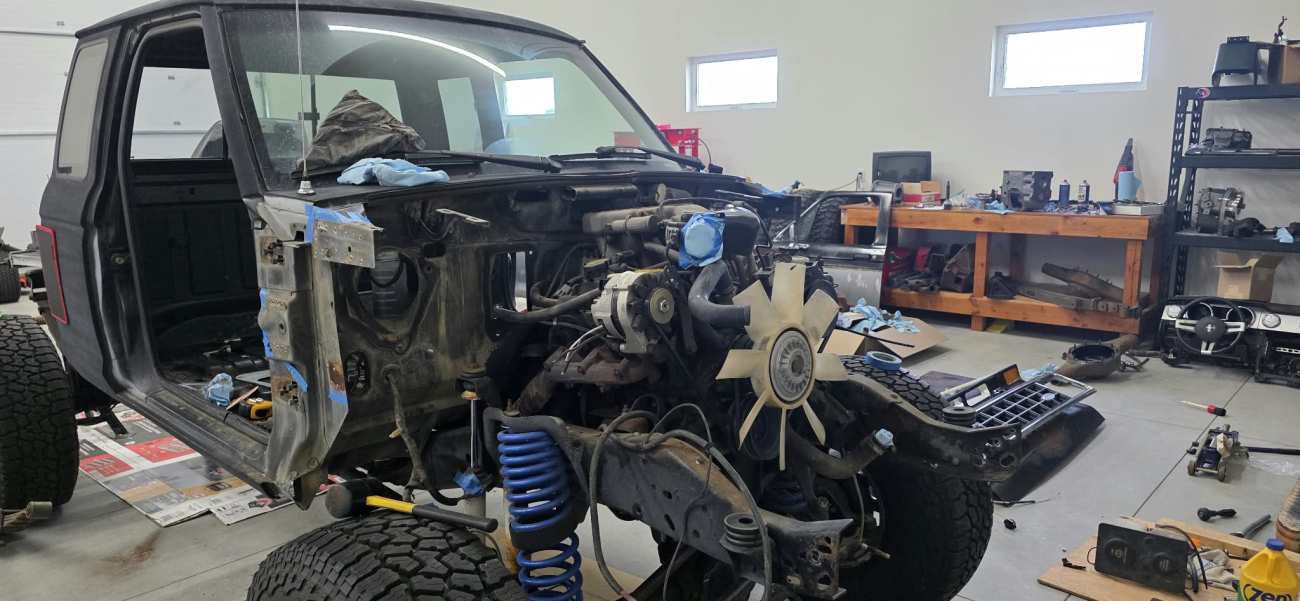

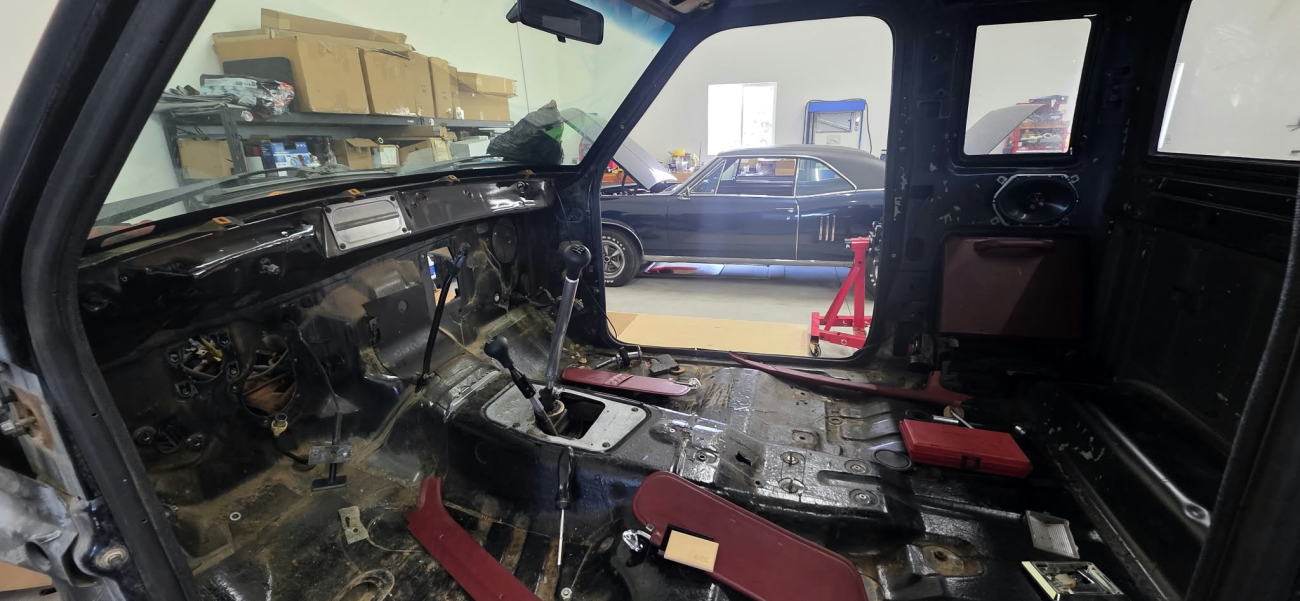

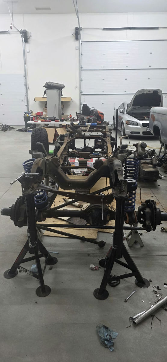

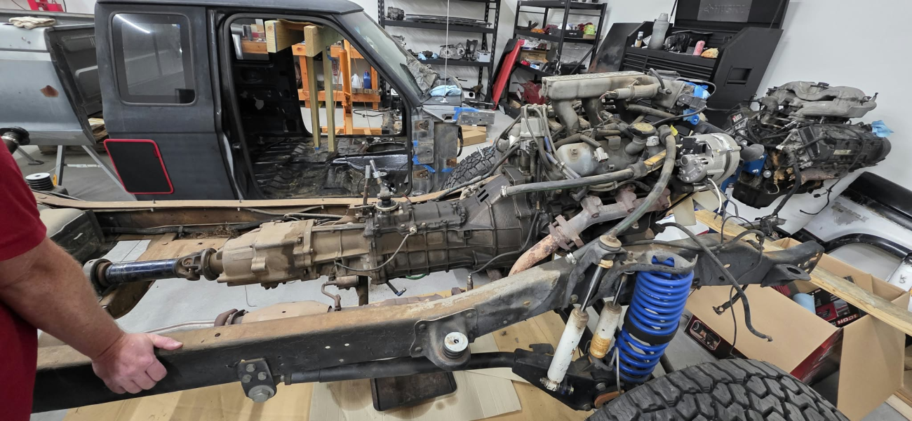

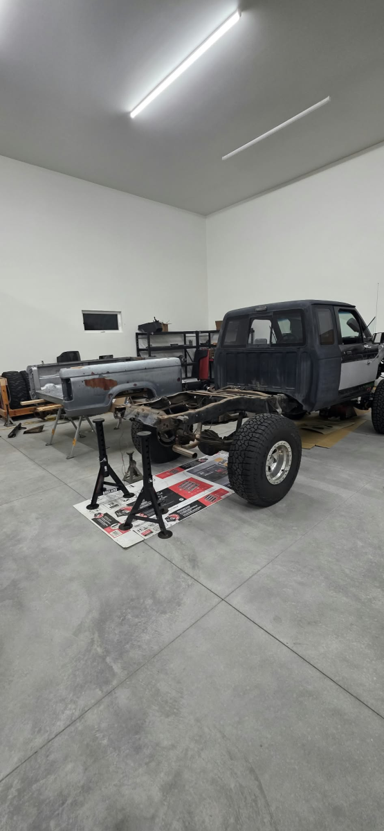

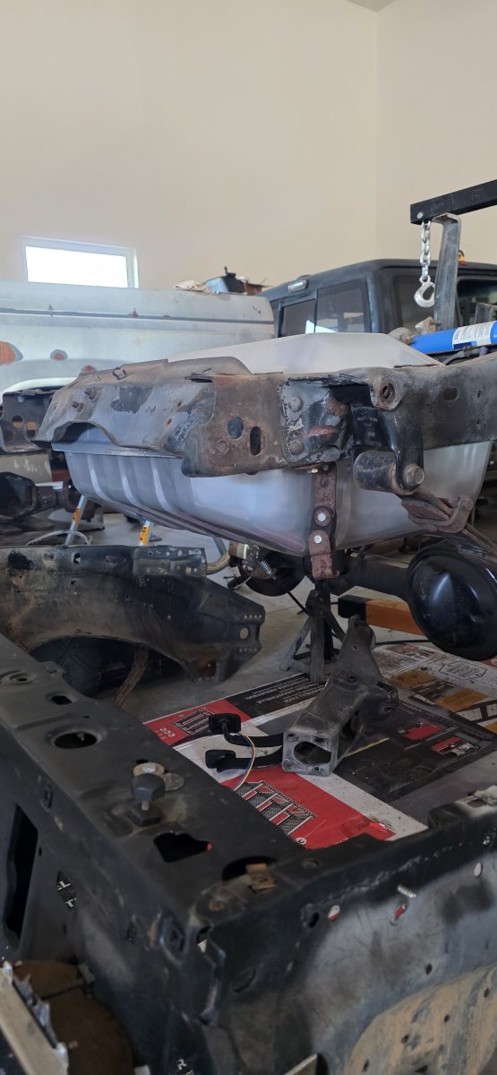

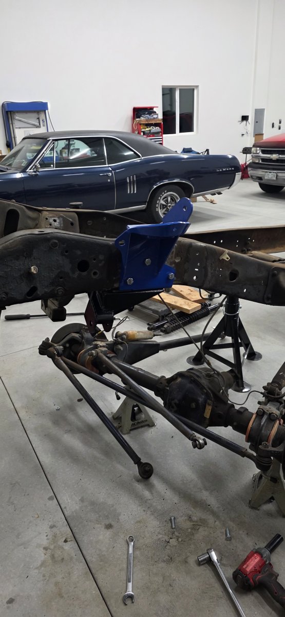

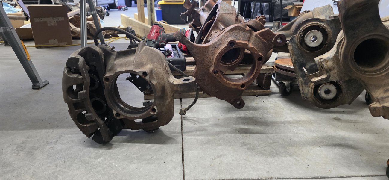

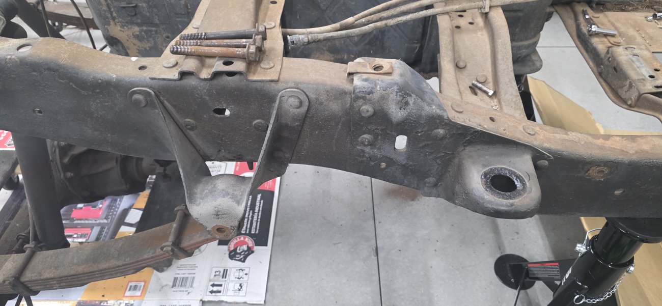

Almost caught up now, so my family finally got our shop built and I pulled the truck in and within a week I had it pulled apart. I didn't want to remove the cab but due to some funkiness from the previous owner I couldn't get the transmission unbolted without it off.
yes that is a old f250 frame, I originally wanted to frame swap but that frame was twisted.

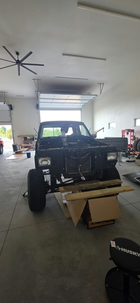

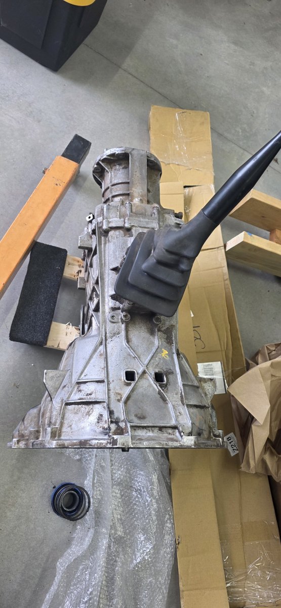

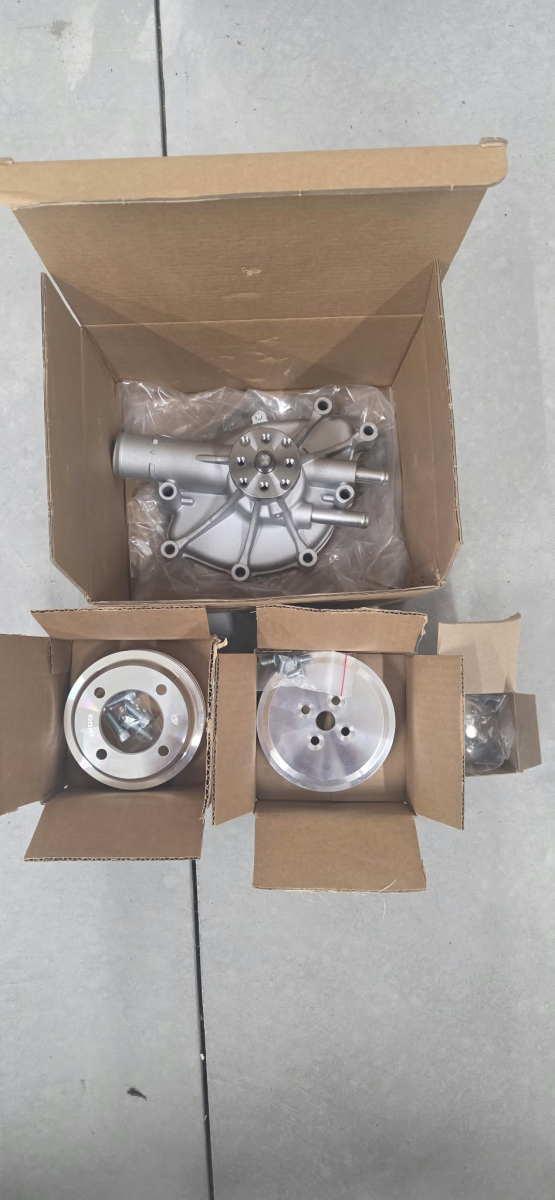

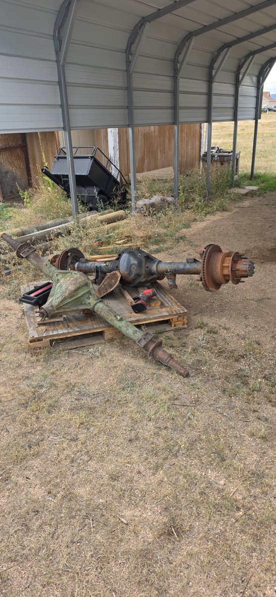

Now finally to modern day, so I sold a set of beadlocks I had and am picking up a zf5. The drivetrain plan is 302, zf5, np203, np205. I know, overkill for never having been able to actually take it to any major trails other than the field near my house. I also have a set of Chevy 64s for the rear I got for 60 bucks. I also got a shortie water pump and pulleys from CVF so I'm interested in how that will go.
I am going to work on updating this when I can amongst college classes and work, but I am hoping to have most of the swap done by Christmas.
