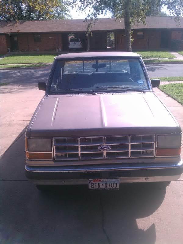

Have a 1990 2.3 brown faded ranger that I bought for $1,000 back 2 years ago. Been driving it around as a daily driver ever since. I've fixed a few things on it engine wise to keep it running and improve the gas mileage (17-21mpg) depending on how I am driving and Texas winds. Besides that it’s an ugly beauty.

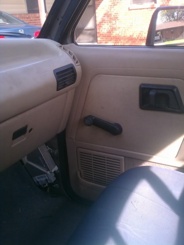

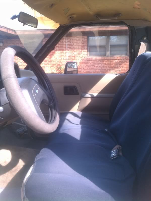

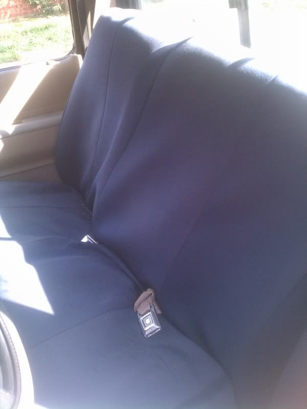

First thing to accomplish is interior work.

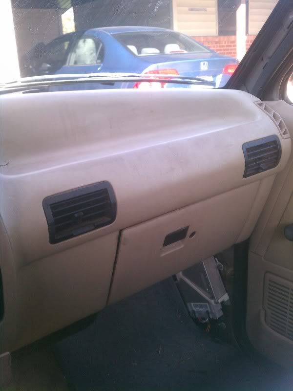

Carpet is being removed, floor is getting herculiner, all brown interior (door panels, siding, dash, etc) is being painted black gloss. The dash has a small crack in it but is acceptable for now, too expensive to replace. Stereo and speakers will be replaced as well haven’t decided on any in particular yet.

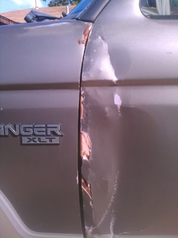

Driver’s side door is hit pretty bad, I believe it will need to be replaced but was hoping for some opinions on ways to bondo it if possible. It is bad. (picture coming soon) Drivers side fender is bent, passenger side fender has small dent, small dents and scratches located over the rest of the body. Tiny areas of rust as well. Front bumper was replaced with a junkyard special, might replace with new black or chrome bumper.

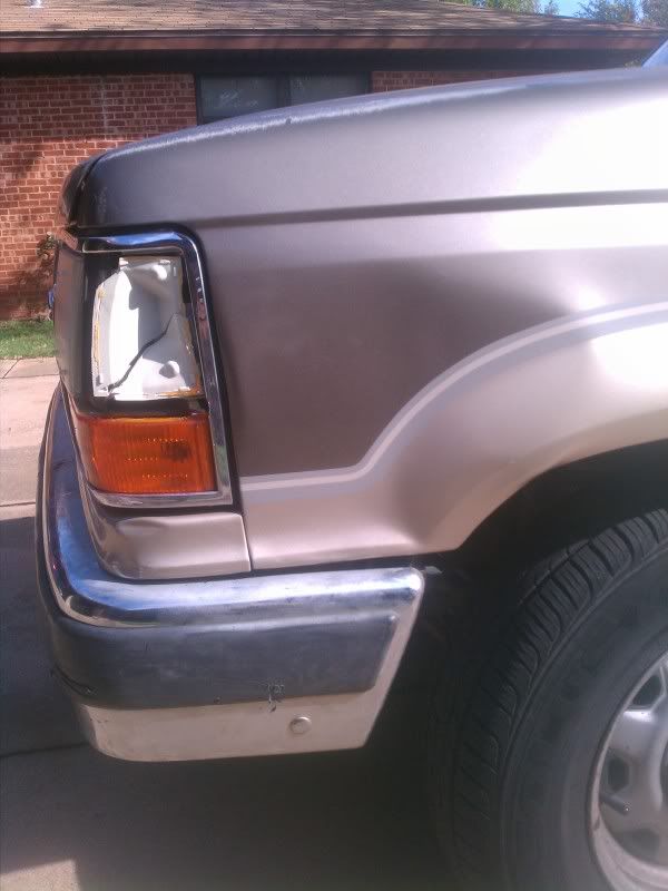

Cracked light cheap to replace, small dent
1990 Ranger Long Term

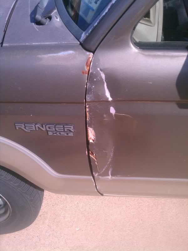

This is the drivers side door, was hoping someone could tell me if this might be fixable or just new door?
Fix or New?

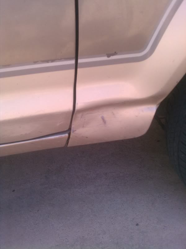

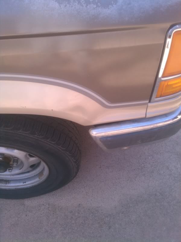

Small dent on the fender
Dent next to the passenger side door

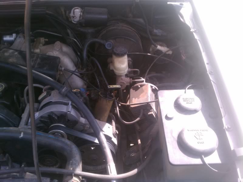

I am not a diehard brand person so if you are I am sorry. I am looking around for a Chevy 350 small block to rebuild for the truck. Have a few engine builds that I haven’t decided on what one I want. I am 95% sure it will be a chevy 350 small block.

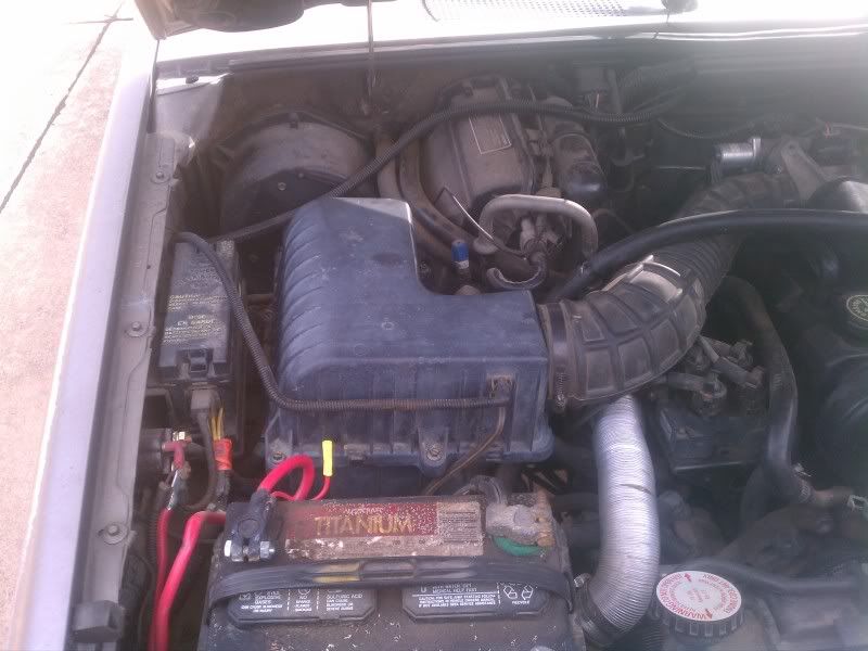

Current engine
Center view of the beast
Battery and airfilter
Mastercylinder side

Well gentlemen there are all the pictures, now to go home and study for airmen leadership school so they dont kick me out. Come Friday me and a friend who also wants to line his cab floor, are going to start on the interior.
Remove dash to clean. Remove seats, tear out carpet and toss. Clean floor. Herculine while consuming a 30 pack of my favorite beverage. While that is drying attempt to paint all the interior plastic pieces and dash.
Going to start with the back side of the pieces 1. for practice 2. just in case I do not like the look of the paint.
Regretfully a friend reminded me that a polished turd is still a turd, so instead of exterior next after interiod like i planned, i am going to go find myself a 350 block to start workinf with. Junk yard here i come
Well due to the sound/heat dampner on the floor and its unwillingness to go away the interior is taking longer then i thought. 6hrs of work and I cleared the drivers seat area and middle console. So 1/3 way done. Tomorow i am going to paint the dash pieces, and reinstall the seat. During free time this week i will finish the scrapping and maybe get to herculine the floor this weekend.

Also i would replace that door since they are cheap and that one has had a bad repair already. The fender looks like it could be straightened but it has a lot of small dents so everytime you fix one youll probably find like 6 more you never noticed, so i would replace it also with one from a jy. thats what i would do unless you abosuletly cant afford to spare the $75 for both parts(fwiw ASE certified auto body tech)

after looking at that one fender it might be a quic fix (are the light areas dents or faded paint my laptop screen isnt the best quality and dents are hard to judge in pics anyways), look it over REALLY close and she how many dents it has. then run you hand across it and see if it has a wave in it anywhere, if you put at shop towel or paper towel under you hand layed flat it helps it become more noticeable. If you even thing you feel a wave, there is one there and if you dont get it out completely it will be noticeble with new paint.
Yeah they are dents, a lot of faded paint. How do you go about removing the dents? Never done body work like that, always hear you can just pop thrm out?
if they dont have a crease and arent in body like sometime you can pop them out and its harder to do on smaller dents. but if there is any kind of a crease or fold they wont just pop out. The problem with just poping them out is that when a dent occurs the metal gets stretched, so there will still be a faint ring where the dent was, and the area will be easier to dent again. even just leaning against it could cause the dent to reappear. to fix it properly the dent needs to be pulled out and locked into place. there are several ways of doing this, my favorite one involves a torch, but you can also lock it back in with just hammers in dollies. the thing is that every dent is unique and requires a slightly different technique.
but to properly fix the dent you have pull it and reshrink the metal which mean you'll have to primer and repaint that area.
however some of your dents might be able to be popped out and look acceptable for a driver. the bottom of your fender and your door won't just pop out, but some of the smaller ones might. (just looked again and looks like all your major dents are either creased or on a body line, so its gonna take some more work)
for body work pull the dent to within 1/8inch of where its suppose to be, lock it in, bondo, sand, reapply bondo, sand (repeat until correct form and not more than 1/8inch of bond) primer, sand, primer, sand (until 100% smooth), make sure to sand out all scrathes with atleast 400grit but 600grit is better, then sealer, paint, paint, paint, (until covered), clear, clear, clear, bake/cure. buff if needed
Ill have a look at them later today, I think though a lot of them will have to simply be replaced. To many dents to tray and fix them all.

Anyone know how to remove the dash of a 2nd gen ranger? Removed the bolts on the top of the dash below the windshield yesterday, but was already too dark to have a real good look at it.
