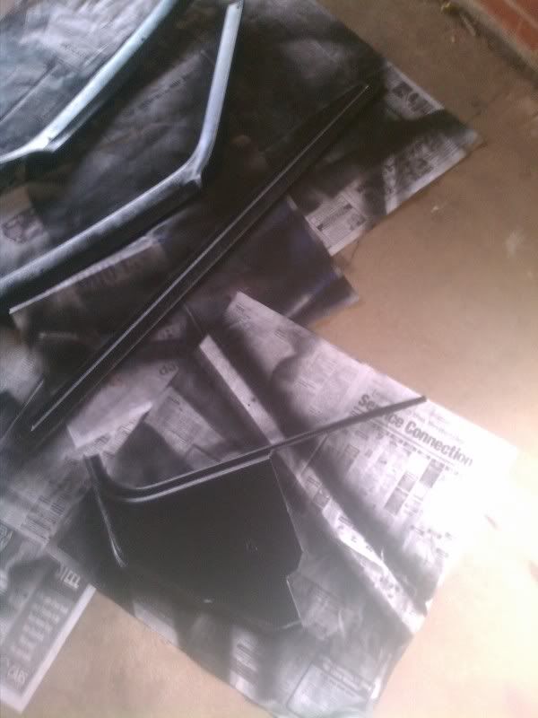

Here is what they looked like round one of painting. Regretfully I followed the rattle can instructions and not what everyone on here said. So this weekend, weather allowing I will be sanding, PRIMING, and then repainting. As i was cleaning the pieces today getting ready to reinstall them I noticed a lot of paint chipping.
i think you accidentally painted some of your truck parts while you where painting your newspaper, Dont worry if you get to it quick enough you should be able to get it all off with paint thinner.
:icon_rofl: the pieces got moved around many times while they were being painted never in the same place so the news paper might have got a little paint on it

Well best way to learn is from your mistakes. Was prepping to reinstall the interior today only to notice a decent bit of paint chipping. Never follow the rattle can instructions. Built in primer my ass. So starting tomorow Ill be sanding, priming, and then painting again. Yay... lesson learned.
