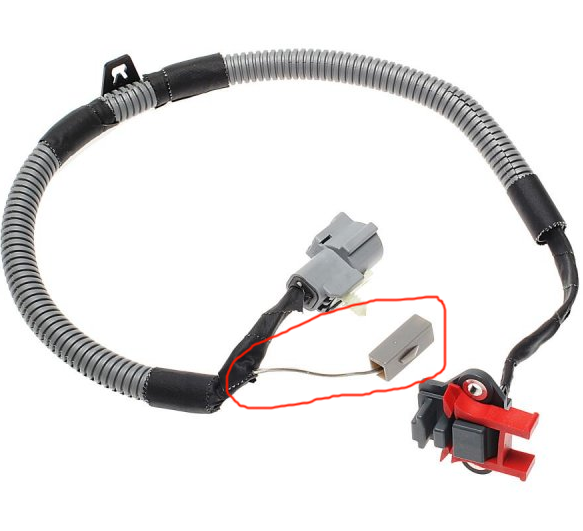

So I bought this truck over a year ago. Wiring was a mess when I got it. Looks like a rats nest. The truck started stuttering a couple months ago, and completely died the other day.
Signs point to the Crank sensor. It'll start, run like crap, and then stumble and stall.
I have a question about the wiring coming out of the sensor. There are four wires (red/black/grey/blue) and then one more wire coming out of the sensor.
What is that singled out wire go to? Mine is clearly snipped, or broken because it goes to nothing. I dont know if it wore away, and that's what killed the truck, and had it stumbling for months. I just want to learn more on what that single plug does. Can anyone help me?
I circled it in the picture below

Crank sensor uses 4 wires
Can't see connector, so if it has 4 wires then that 5th wire is a shield wire, and can be left unhooked or hooked up, wouldn't matter

Thanks for the help! The 4 wires on the CSS were already cut and re attached to the plug, and we're loose. So re connected them nicely, and re did the shield wire, because why not. Let me ask you more about the ICM.
