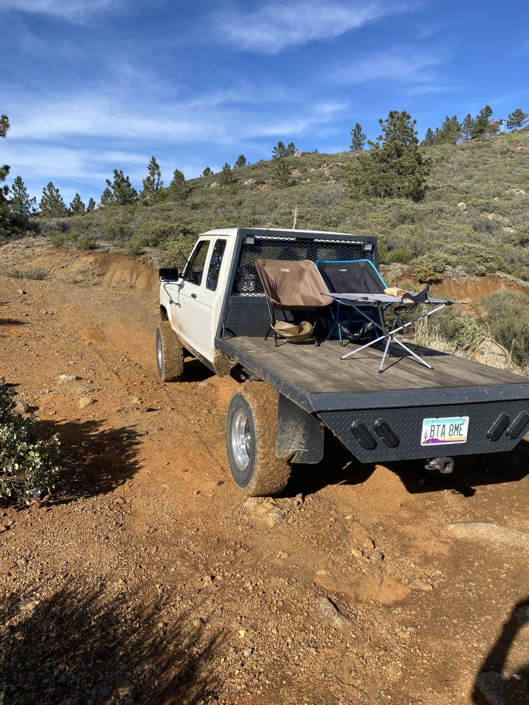

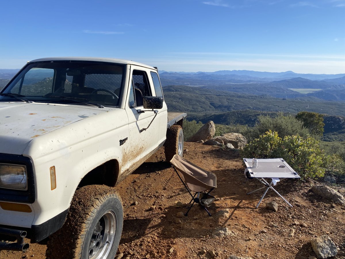

Working on getting started for my V8 swap! I got an 8.8 rear end out of a '97 explorer last week. I also ordered a fuel injected crate motor from BluePrint Engines that's going to be delivered towards the end of January. Here's the link to the one I got.
https://blueprintengines.com/collections/ford-compatible/products/bp302rctf
I'm stoked to finally get the project going but I'm turning to TRS because I'm not sure what transmission and transfer case to get. I want to keep it a 5 speed manual and have been told to look into getting a T-5 from a Mustang by someone and also been suggested to get an S5-42 from an '87-'92 F-Series by another guy. However, I've seen a lot of talk in the Forums about the M5R2. Which one is the best choice? If I go with the M5R2 does it matter what year I go with? Will they all bolt up to a 302?
The purpose I want this truck to serve is I want it to be a reliable daily driver that can handle itself off-road. I don't plan on taking it to Moab and doing any gnarly crawling or anything like that. However, I am an avid hunter and need it to be able to handle itself 4 wheeling. So basically I want to set it up with quality, reliabIe parts and am not necessarily looking to do a "budget" build. At the end of the day I'm looking for the power of a V8 while still retaining the nimble size of a small truck. (Like most who do the Ranger V8 swap I assume...). I plan on running 33's on it when it's all said and done so I'll eventually have 4.10 gears in it, and a rear locker, etc...
All that being said, do you guys also have any suggestions on front ends while maintaining the same wheel base width? Will the stock front end in the '88 Ranger hold up? Is it best to do a straight axel swap?
I'll stop there for now, thanks for your knowledge and time!
