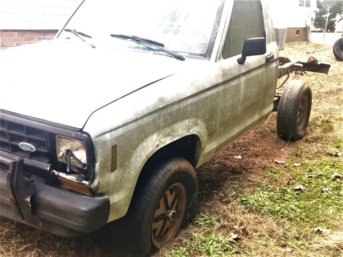

Decided to make a thread on my 87 Ford Ranger 2.9L 4x4 to keep track of what I've done to it and to get help fixing it up. Bought this truck back on Halloween of 2016 as my 1st car for high school and daily drove it until August 2017 when I replaced it with an 03 VW Passat for the better MPG. I continued to use the truck as a fun truck and around town truck. In January 2018 I had a slight fender bender in the snow (bald tires + snow = bad idea) and parked it that summer. It sat until September 2019 when I decided to put it back on the road. Fuel pump no longer worked and I was in the middle of swapping in a Kemso fuel pump when the truck was put back on the back burner until recently when I finally got back into it.
54705
54714
How it looked in 2016 when I drove it home. Had no prior experience to driving a stick and only stalled it once pulling into the driveway.

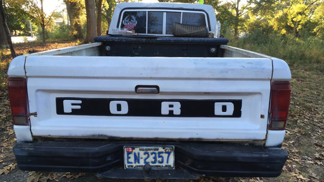

54712
The interior back in 2016

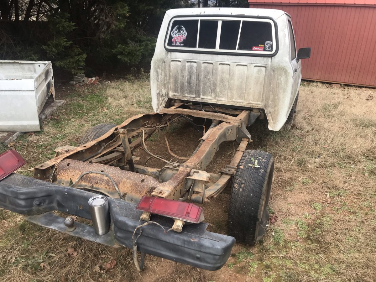

54706
54710
How it looks now (2021) Removed the bed to help get the gas tank back in.

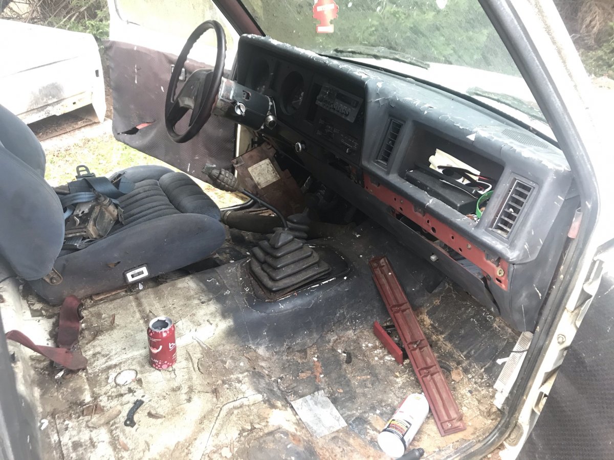

54713
The interior now. I removed the bench and test fitted a blue bucket seat.
