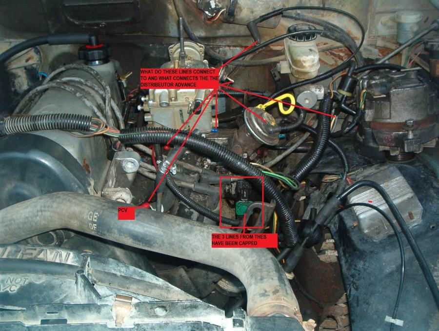

Having been ill for an ongoing length of time my truck fell into disrepair. A well intended friend offered to rebuild the carb for me and it was running seriously rich. The snow where my exhaust exited was black within minutes when it sat and idled for no more that 2 minutes. Well he said he rebuilt the carb but it was still pouring out fuel and was no different than before he rebuilt it. He instead put a different carb on it. The truck was couching, spitting, backfiring and running richer and blowing soot out as it was with the original carb. I was 2 blocks from my house when a distinct knock started from the engine and I immediately returned to the house and it has been sitting here for several months.

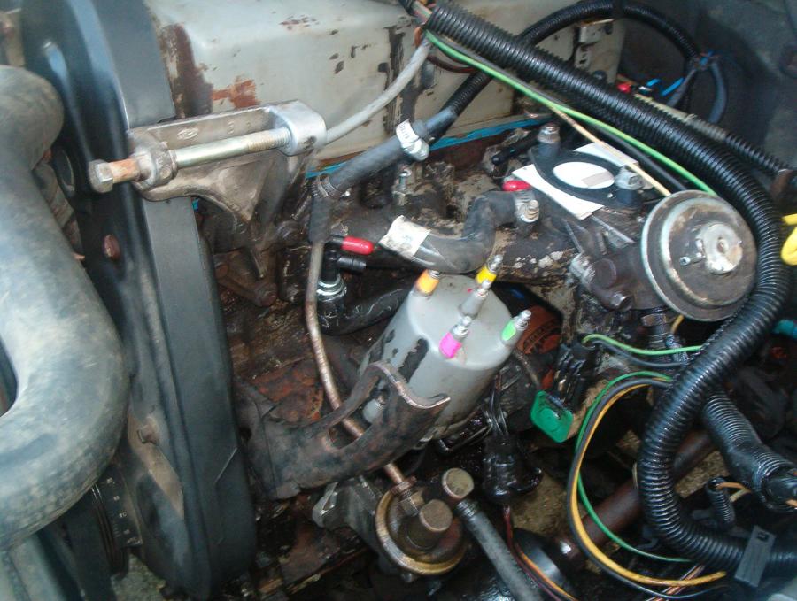

I got the original carb back and it is repaired, I need to know where the vacuum lines connect, since I did not remove it the hoses and were not tagged as I would have done. I removed and cleaned the EGR valve and ports, they were completely clogged, unrecognizable was the port with the valve.

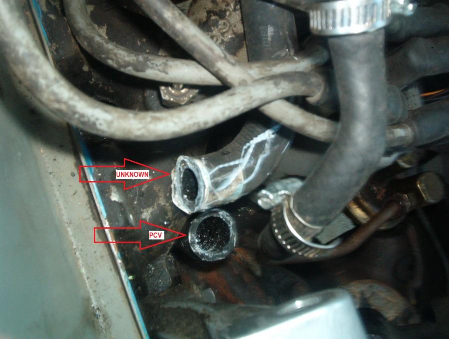

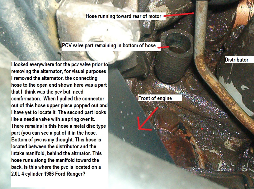

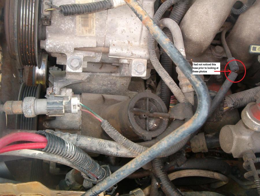

I am replacing the PCV valve and the locations described in the manual are not where I think I found mine. I think mine is behind the alternator, between the distributor and intake manifold. It fell to pieces when I removed it. The pic description includes more details. Can anyone confirm this is where the PVC valve is located?
The vacuum hoses are color coded and the emissions sticker was not on the truck when I bought it. Can anyone direct me as to what color attaches to what port as described in details of photo? I need to get this truck back on the road. Thanks

Howdy and welcome to TRS...
do you happen to have a shot showing the entire engine on the driver side?
I can tell you essentially the pcv connects to a hose that comes up from the block near the back of the engine (just below #3 intake connection) and runs either in front of or through the intake manifold near the distributor. Pretty sure it is in front of it but I haven't had mine together for a while...

Well I took several pics I will get one if I don't already have one. Your description of the pcv route sounds like what I have pointed out that I thought was where the pcv goes. So the piece of metal that is still lodged in that hose should be removed? I believe it to be the bottom of the existing one. As I mentioned the top flew somewhere, I have a pointed valve (poppet?) and the outer spring that was slipped over it. I assume the bottom is what is still lodged int the hose now.

First pic looks like a vacuum control valve. Electrically operated, sometimes used to delay vacuum to the vacuum advance on a distributor, to control the evaporative system, or control vacuum to carburetor controls.
Second pic shows lower PCV hose leading to vapor separator on side of block. Yes part of the valve is still stuck in the hose. OEM Motorcraft replacement will come with a plastic elbow in the blister pack so it can be used on other vehicles, but you won't need that. The PCV is just shoved into the upper and lower PCV hose sections.
Pic #3 seems to be of a different truck, with PS and A/C. Not a 2.0. ??

The 3rd photo is the same truck before I removed the alternator. I tried to degrease it a little that is why it is wet. I also use the library connection it is quite resourceful. Mating up the carb with the intake is why I asked my friend for the original back. The carb I am putting on is the original. Thanks for the info and replies guys. You have been very helpful and I will have some more questions soon for sure. I couldn't help but notice that the 3 of us are all Libras. Good to know

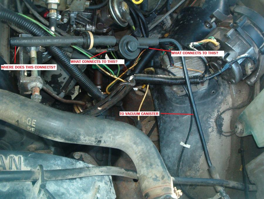

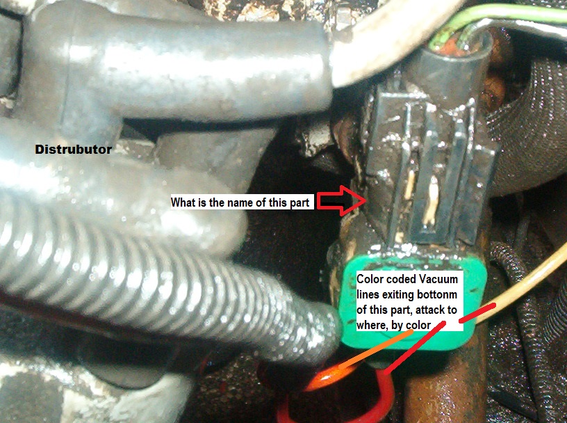

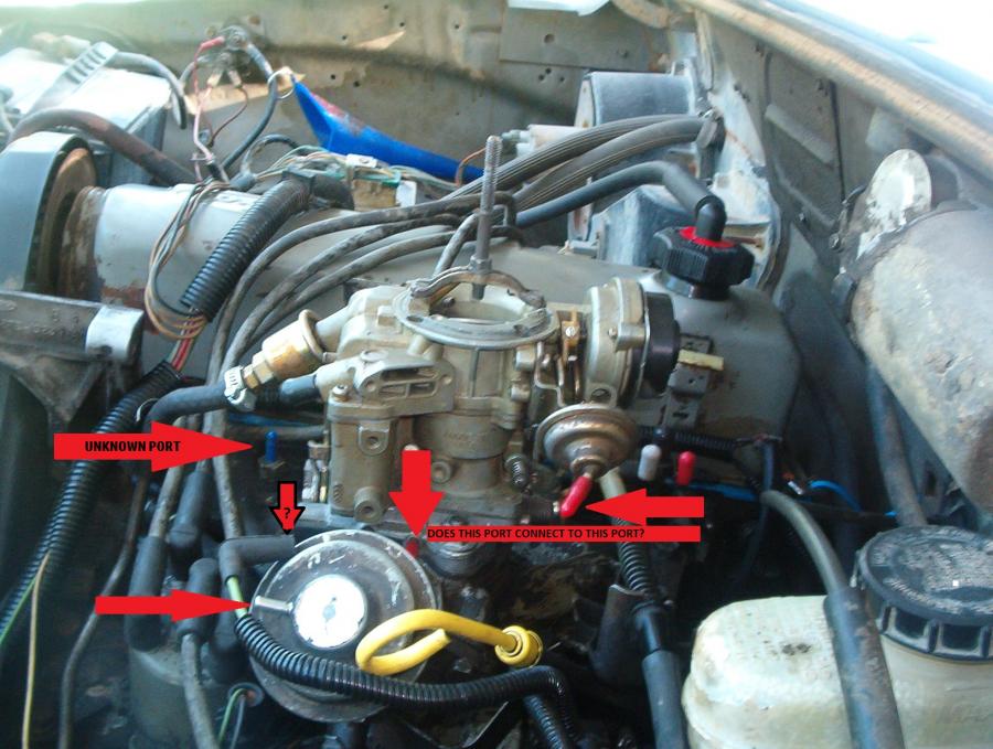

New photos indicate what, where and why in regards to connections.

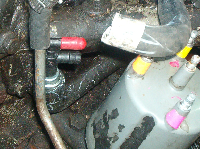

First pic looks like the PCV hose with the valve taken out. The PCV valve sits in between two largish hoses, one to the oil separator on the side of the block below the intake manifold, the other hose leading to the intake manifold.

Third pic farthest right is a 'choke pulldown', which opens the choke using manifold vacuum once the engine starts. The port on the base of the carburetor would work, I think.
Next to the left, the rubber elbow, looks like the vacuum source for the EGR diaphragm, right below it in the pic.
Last unknown port is unknown to me.
Fourth pic is the controls to the vapor control canister. It is a controlled vacuum source that opens the valve to let collected vapor from the tank get fed to the intake via the semi-stiff plastic tube. The left most end of the tube should connect to a port into the intake manifold. The circular dealey with two ports is the valve. Vacuum on one side to open.. maybe vacuum on the other to close, but you won't have vacuum with the engine off, so nix that. Vacuum may be controlled by solenoids. Could be the valve noted several posts back that was hanging in front of the intake, more or less at the backside of the alternator (green, I think)... After looking, it is enclosed with a red box in pic #2. I'd think one port had vacuum, one went to the vapor valve, and one port went to heaven. I don't know.

thanks for the advice, its raining today so will keep studying and wait for the rain to stop. You are right about everything so far! Not clear if I understand what you mean about the top (larger) hose in the pic but you are right, the pcv valve was seated in the bottom larger hose. I am going to take the carb back off so I can see the larger hoses and where the connect better. The PCV valve doesn't seem to me like it fits tight enough, think that hose needs to be replaced.
