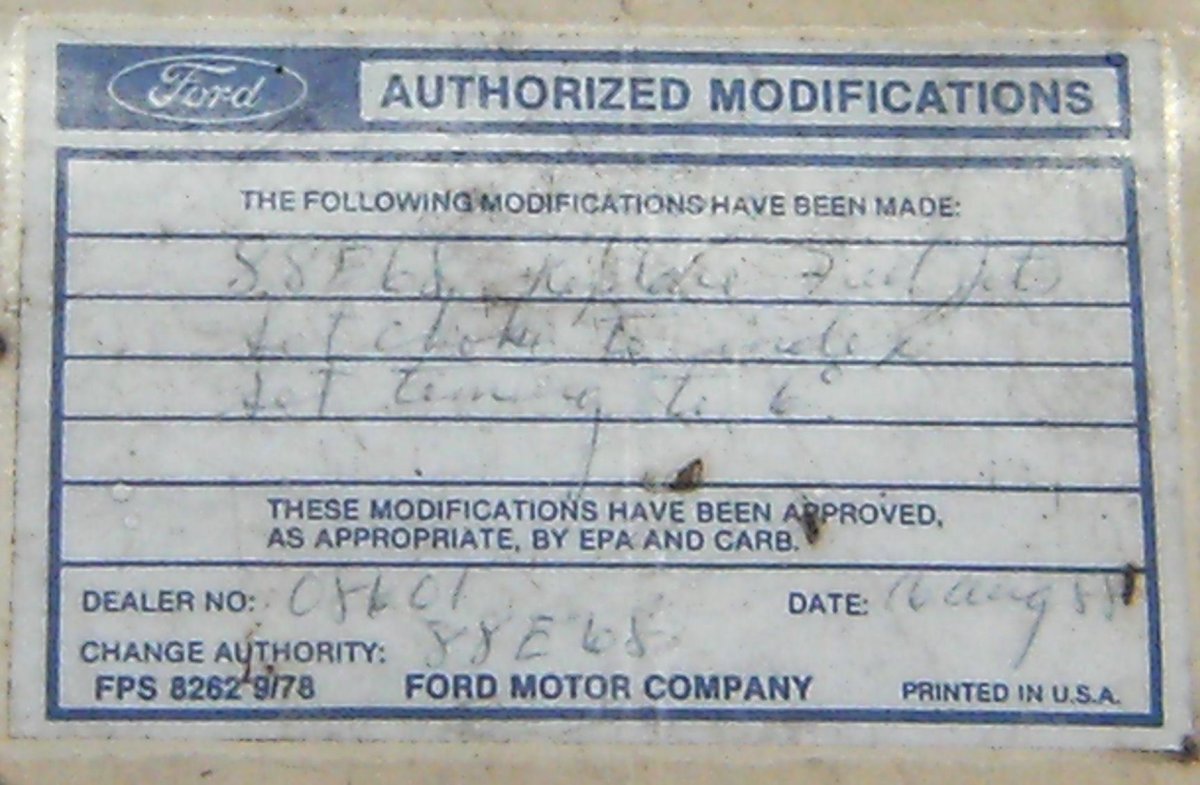

Was able to get the booster replaced today, yep made the difference. after that the idle had to be reset way down. purred not to bad. PO must have been trying to get it to run right by setting the idle higher to compensate the vacuum leak. after resetting and adjusting we have it down to a nice roar now. still clacking a bunch but one step at at time... lol .... it is at a starting point to base the rest from. cheers..... and i did look for any modification stickers. did find one but i don't think this is what you were asking about. it is just an emissions change sticker. I will guess it is a California thing... ?? posted pic anyway ... and here is the rotten booster, you can see the rot and moisture where it was leaking from.
Thank you for the picture. My 1984 (2.8/C3 auto) has the same "Authorized Modifications" sticker, but it's too faded to read. Probably not just California thing; mine's a Georgia truck, originally ordered through the Atlanta District Sales Office. And Googling "TSB 88-E-68" shows that it was an emissions recall in 1988 from Ford.

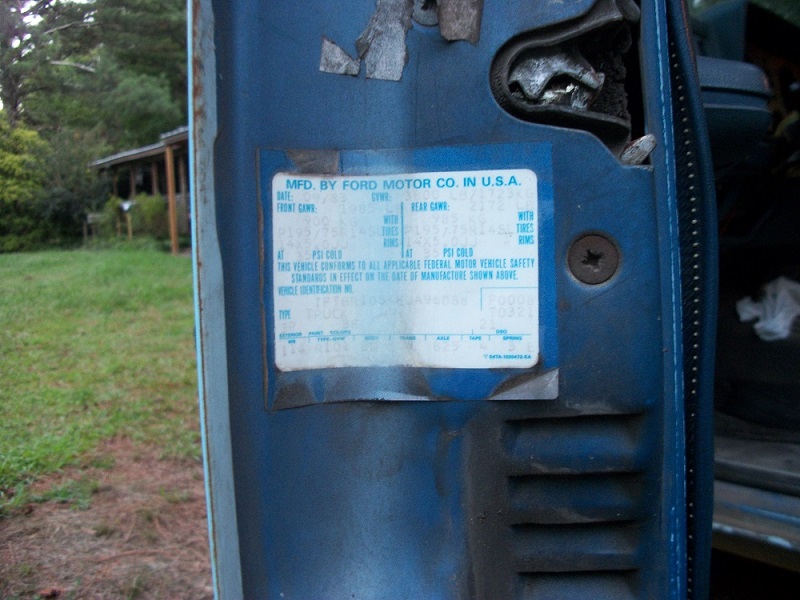

The Federal Compliance sticker should be on the rear inside edge of the driver's door. This is what it looks like on my '84:
1984 ranger roll-along
Mine is barely readable. But if yours is there and readable, it will have some information on how your truck was originally equipped. It think that your Ranger camper most likely started out as a chassis cab, and I'm curious if the Fed sticker would state something about that.
Aftermarket up-fitters, in this case "Roll Along", would usually add their own label, usually close to the Fed sticker (not sure if this was a requirement or not- but I think it was).

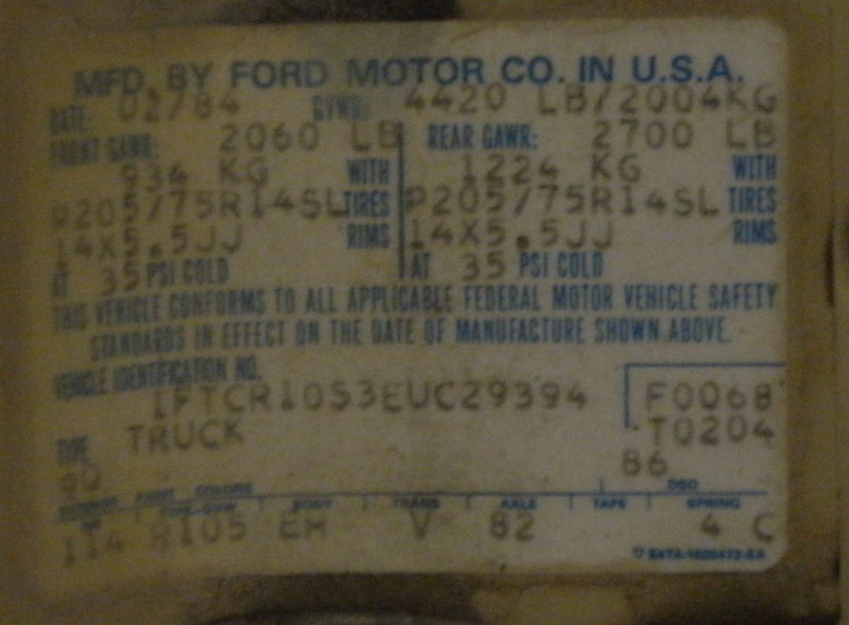

Cool! Thank you for posting the door sticker.
In case you don’t have the Ford shop manual, here’s what the label tells you about your truck, as best as I can decode it.
DATE (build date was Feb 1984. There may also be an ink stamp on the radiator core support showing the exact day/month/year.
GVWR (Gross Vehicle Weight Rating) is 4420 lbs., which does seem low. There were higher 1984 Ranger GVWRs of 4440, 4500 and 4880.
WITH TIRES RIMS Wheel size, 14x5.5JJ, was the second smallest wheel size. There was a wider 14”, and several width 15” wheels available in ’84. I’m curious what size wheels it has now, and the dually kit on the rear was almost certainly added after production, thus changing the rears. The original factory-delivered tire size was P205/75R14SL, which were the largest 14" tires in '84.
The VIN breaks down:
1FT Ford Motor Company, USA, Truck (Complete Vehicle)
C brake system and GVWR class, Class C, 4001-5000 pounds
R10 Ranger Standard 4x2 Truck (note: R12 would be chassis cab)
S 2.8L gas engine
3 check digit
E year model 1984
U assembly plant- Louisville
C29394 production sequence number- 229,394 (I don’t have 1984 Ranger production numbers, but in 1985 I have 247,042 as being sold)
TYPE Truck (which jives with third VIN digit “T”)
EXTERIOR is paint color; it looks like “90” or “9Q”, but neither of these codes are in the shop manual that I have (Sep 1983 dated). “9D” is white, but the truck looks tan in the photos (“Light Desert Tan” is “9H”). Maybe the truck was painted when the camper shell was added???
TYPE-GVW R105 is Ranger 4x2, 4420 lbs.
BODY EH E is vinyl bench, H is Tan interior.
TRANS V is the C3 auto
AXLE 82 regular (open diff), 2700 lb capacity, 3.08 ratio
TAPE -none- there were no tape stripes
SPRINGS “4” is the front, non-heavy duty, part # E2TA-5310-TA; “C” is the rear, non-heavy duty, part # E37A-5560-TA. Heavy duty springs would be optional usage, and would have added another character or digit each on the sticker.
DSO (District Sales Office) “86” is “Recreation Vehicle” This is usually the regional office through which a dealership places their vehicle order to Ford for production scheduling (example, my ’84 is “21” for “Atlanta”). This one is really cool having an “86 / Recreational Vehicle” code on it!
The remaining numbers, above the DSO, are supposed to the Front Axle Accessory Reserve Capacity in Pounds, “F0068”; and Total Accessory Reserve Capacity in Pounds, “T0204”. Now, 204 pounds total added accessory weight sounds way too light for the camper conversion. I don’t know, but it seems the conversion company would have to do more to the rear end besides just throwing a dually kit on it.
My guess, unless I’m way off on the sticker decode, is that the truck was built as a base truck with a bed (not a chassis cab), and that it would have also had some rear end and suspension changes as part of the conversion.
Sorry for the lengthy post, but I hope that the information is useful. Please do keep us updated, as you can. These are cool rigs, and not much is really known about them.
