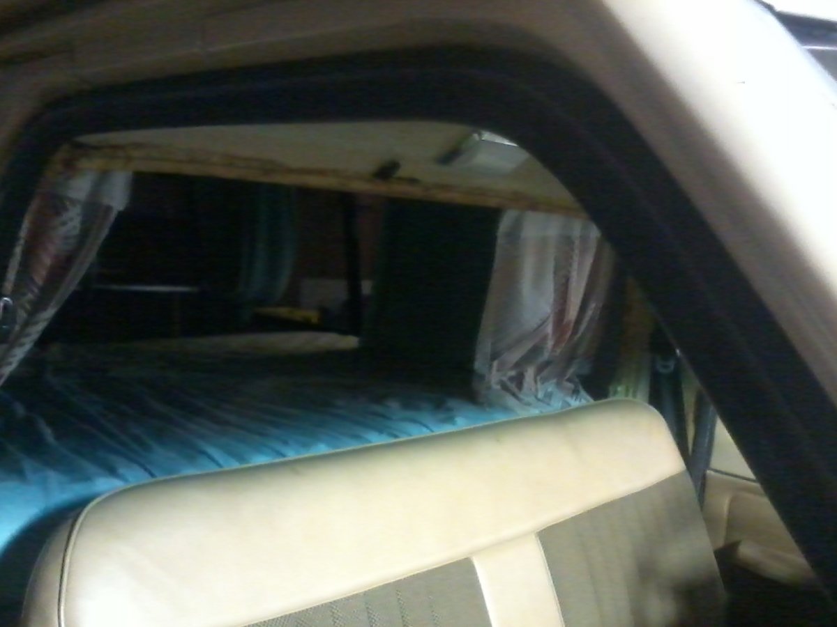

I will take a couple pictures today of the inside to show more the layout of this rig. I understand what you are saying, however i don't think it will make much of a difference by accessing the back that way with it folded. I may stand to be corrected, but not sure the gains will out-way the losses.
the cab is basically a regular cab that has the back window missing and cut down leaving the frame intact around a missing hole for access. "smaller" access to boot.

wow i stand corrected... the hole is actually way larger than was first thought ... I am more concentrating on the running of the machine and not the creature comforts at the moment... here are a couple inside pics and yes there is a ton of play in here... and here is the passenger seat. complete with a second set of controls as you were saying. this might get more interesting than i first thought...

On one those rigs, I think that anything you do to make access from the cab to the rear area will make it a lot more handier.

That setup is a little weird, though I can understand why they made someone crawl over the bench seat. The platform is at that height anyway, so you have to make the leap or walk around to the back. Buckets may make it easier. You could fabricate a small 'ladder' to help with the leap :)
