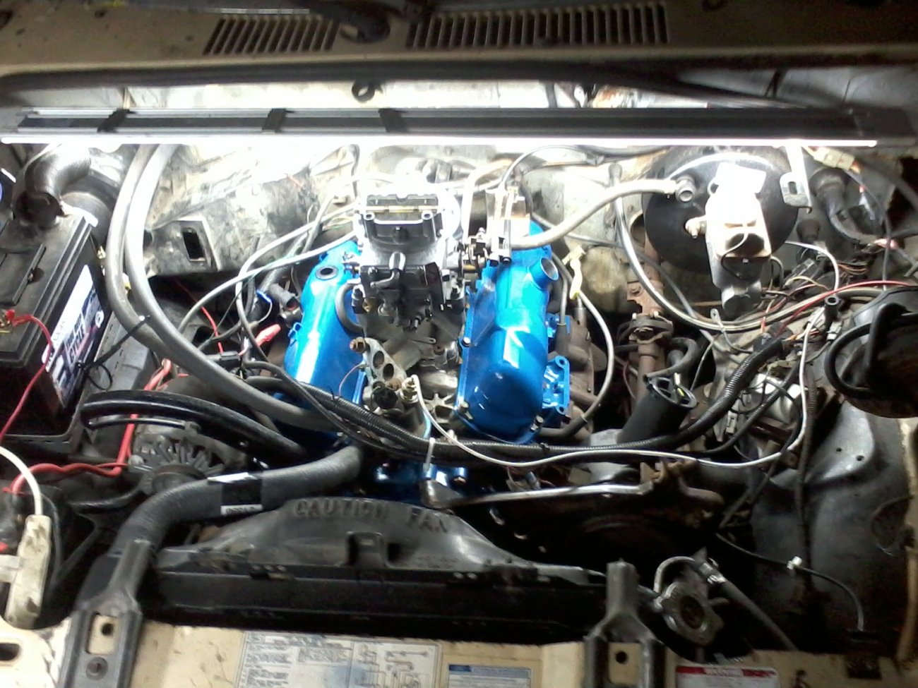

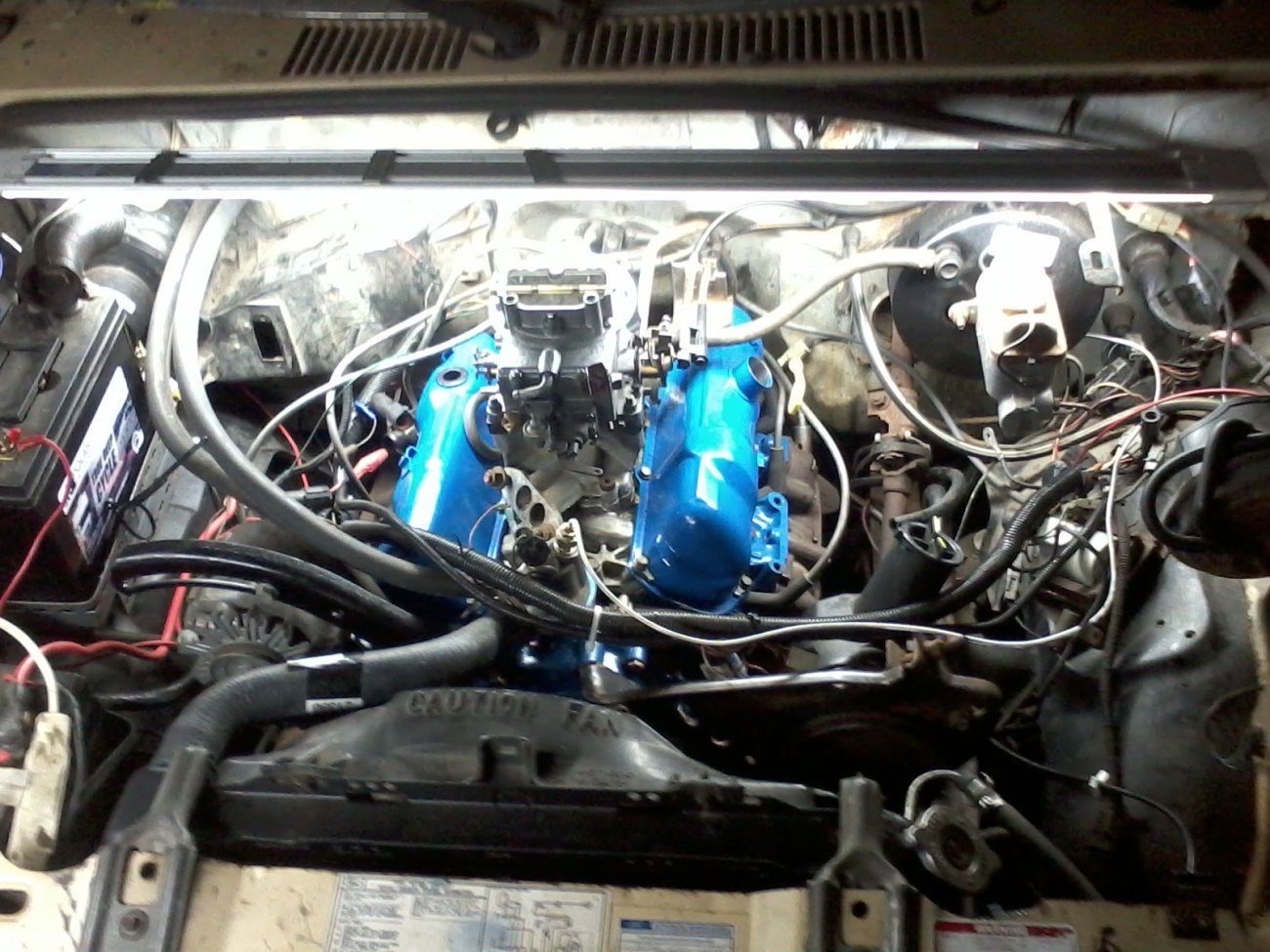

That said. The engine is in, and is ready to by fired up and broke in. (have pics to post eventually. The passenger floor board was shot, have a new pan welded into place. hope to fire up the truck very soon. need to redo the cab by placing in floor carpets and the seats. hoping that by end july the rig will be on the road. will post pics soon. :)
here is engine sitting in the bay and ready for the final tweaks before she is fired up. cheers

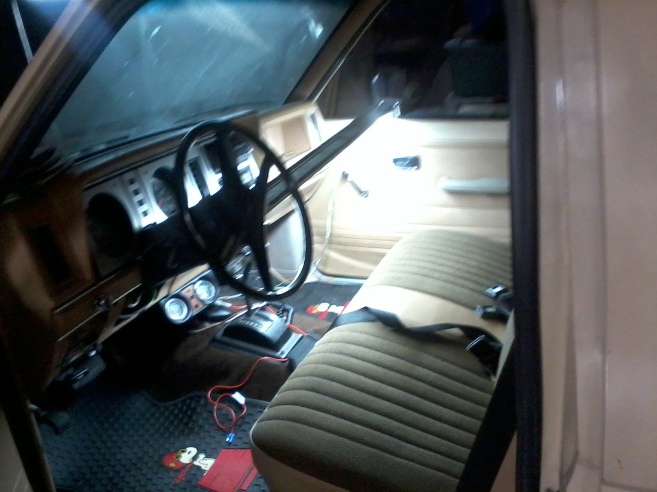

slowly chewing at this project. the drivers floor is all new. and the seat is back, new carpet and all cleaned. slowly coming along. The transmission was at the shop for new seals and a bench check over. all in and now just working on getting the engine fired up. going to try using the TFI dist with a locked out advance and no computer with this rig. see how that goes. very close to firing it now. :) cheers

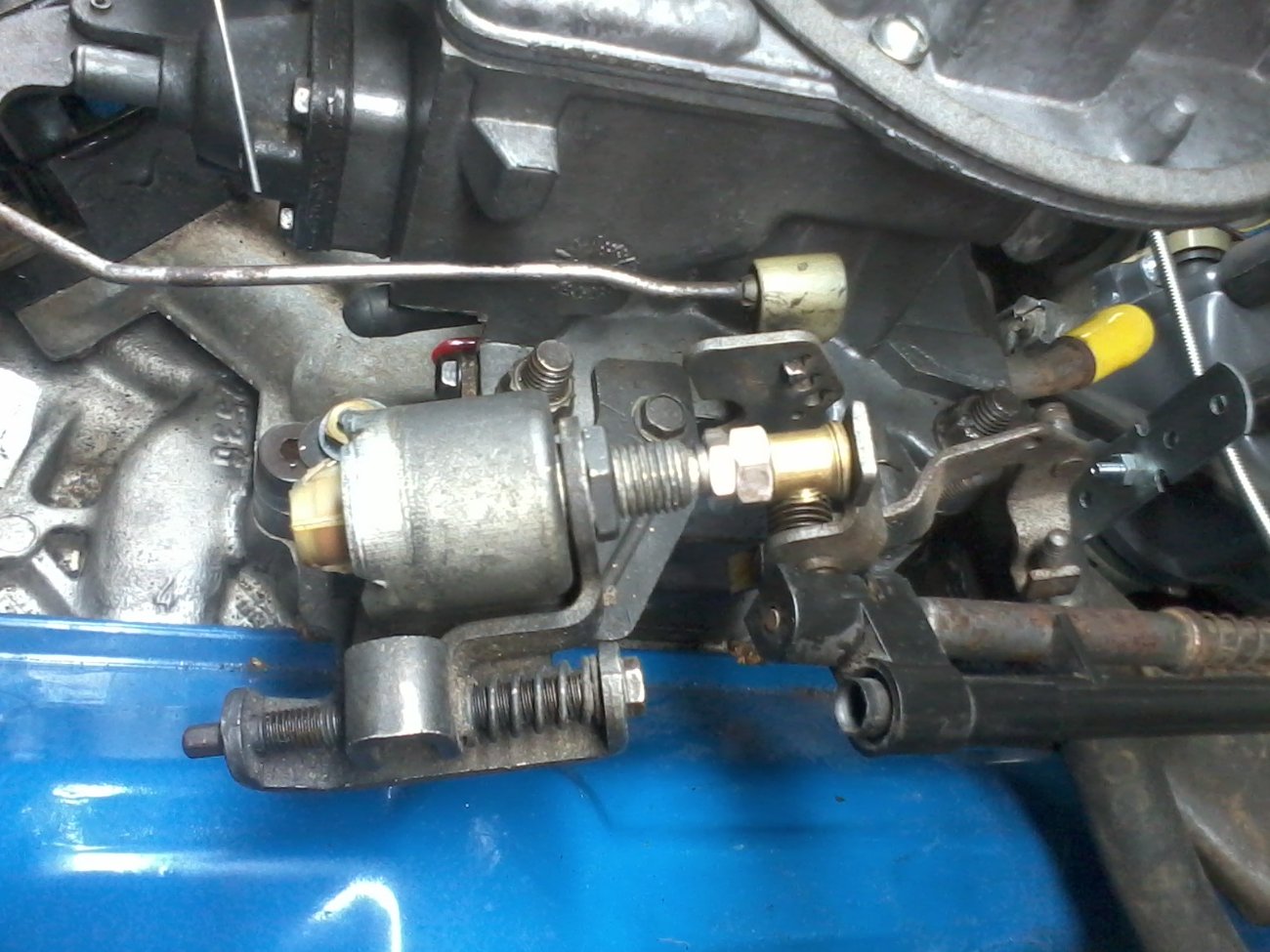

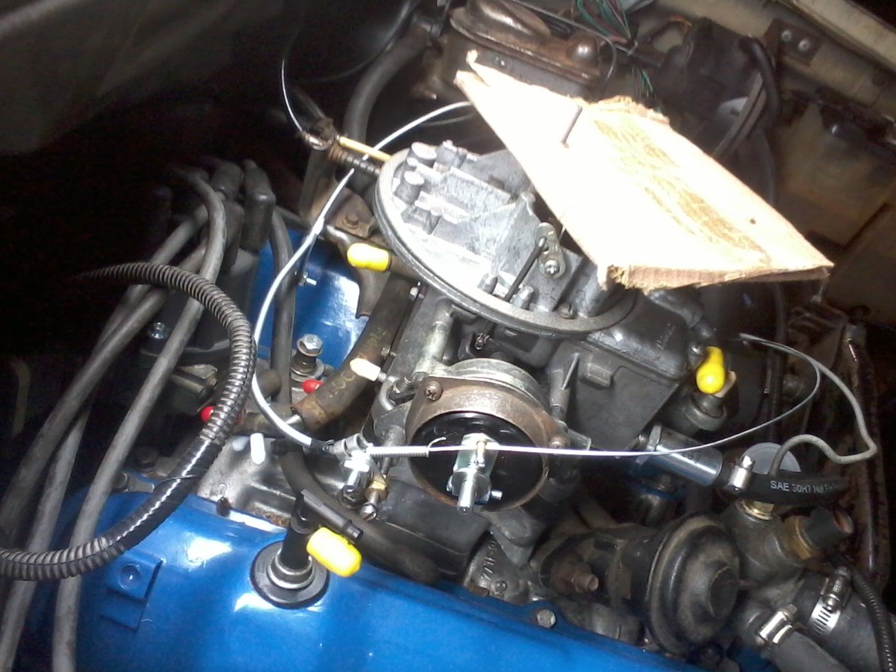

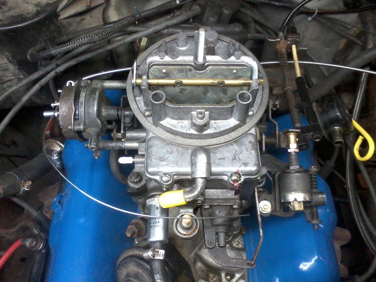

I used the original carb that was on the truck from all the (computer crap) Angie is a whizz at rebuilding carbs and cleaning them up. so what we did was strip the carb down to only needed stuff.... I added a manual choke (redneck rigged) and then added some spacer to the idle settings ... I will post pics of this (hay wire set up) looks funny but will work great for this little truck.

this is how we rigged up the carb, manual choke, and the idle setting is made up from crap i had laying around the tool room.... i guess this is why I never throw stuff out. found all the bits and bobs needed to secure the choke cable and make up a strange adaptor for the idle. cheers.
