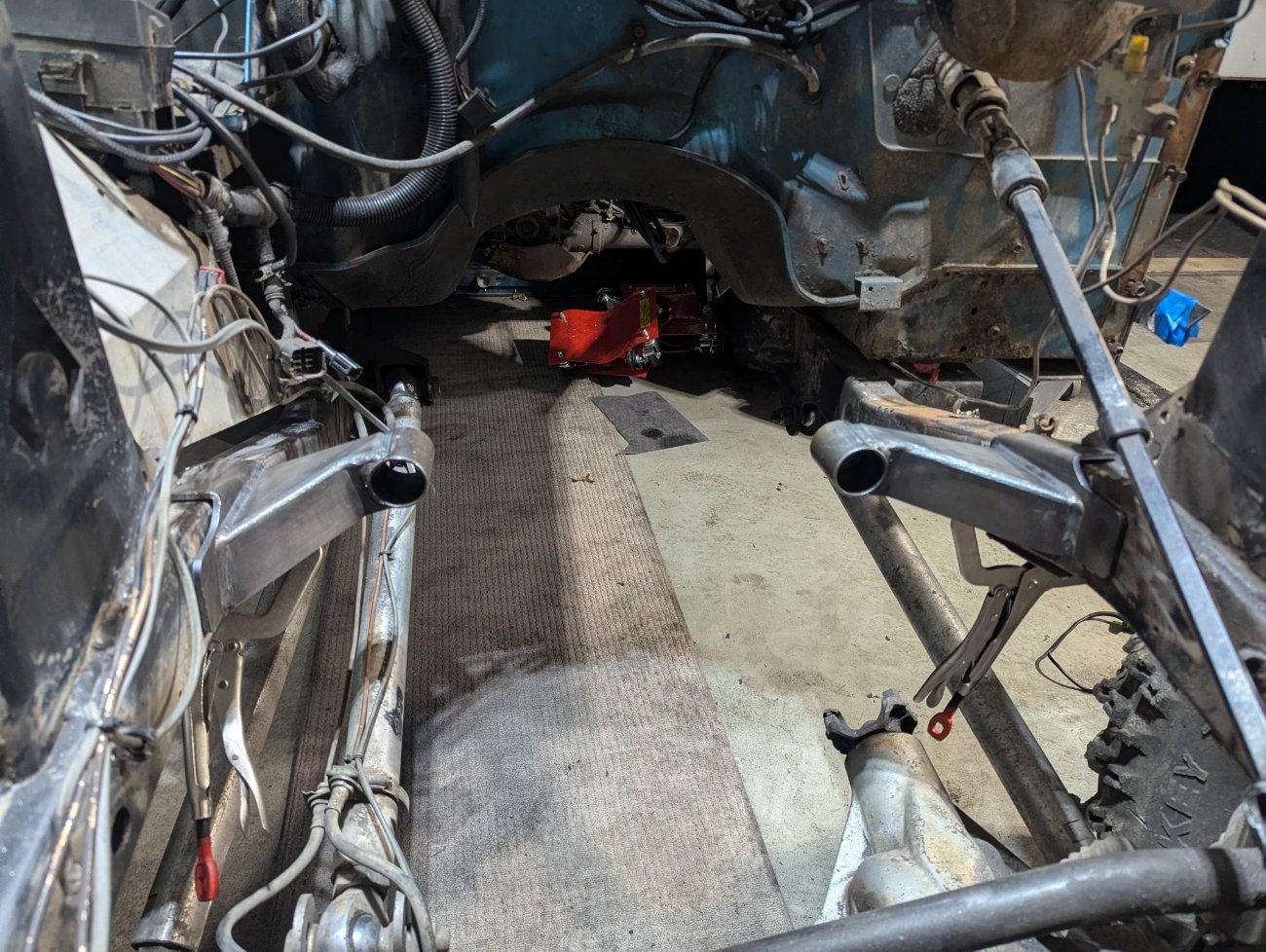

1 Ton YJ Crawler build
Goatbuilt setup. Gets things up and out of the way of my suspension links
  • 1 Ton YJ Crawler build

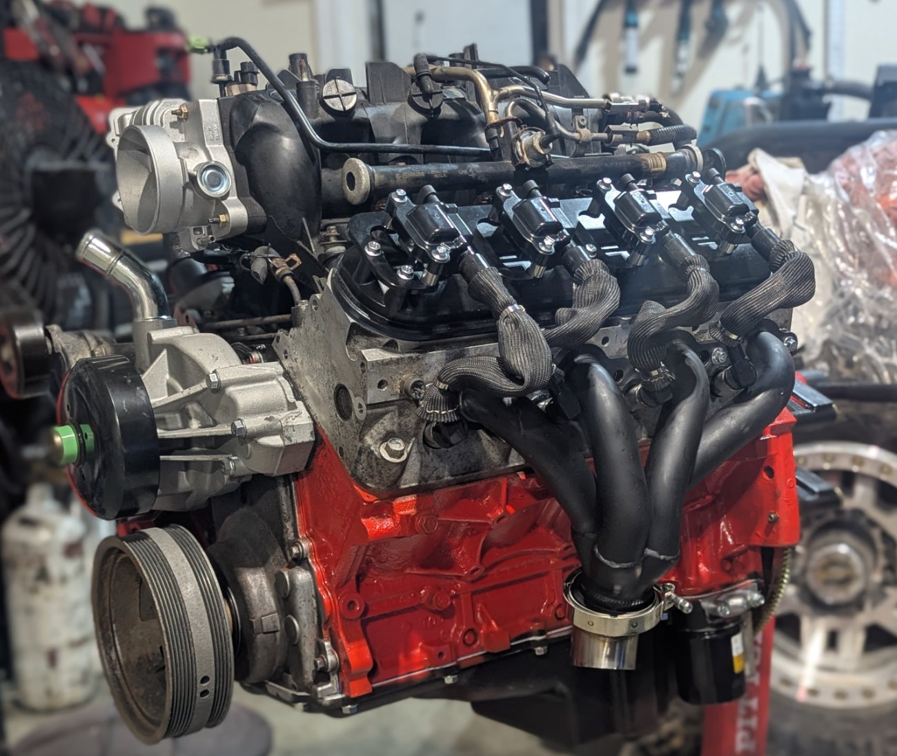

My thermostat housing finally showed up, so now the engine is as together as it's going to be for a bit. Headers are bolted on, everything below the intake is set up more or less. Will need to double check everything and make sure I caught all the sensors on the motor that needed to be replaced, but I'm reasonably happy right now with where it sits
edit - I had to move the dipstick around all over the place and trim it to clear the coil because I couldn't find the flexible dipstick I had around from my buggy. After finishing it up I of course found the other dipstick yesterday looking for my fuel line removal tools

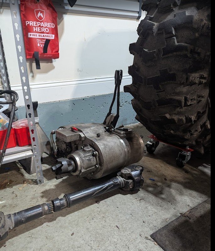

Have the old motor and tranny almost ready to come out, need to unbolt the transfer case, pull the cooler lines and shift linkage, and then I think the old driveline is ready to come out. Need to decide how to store it, no clue what the value of a 4.0 with 300k on it is other than scrap. Might just sell my hydro assist stuff and the new alternator that's on there, but dunno what I really want do to yet

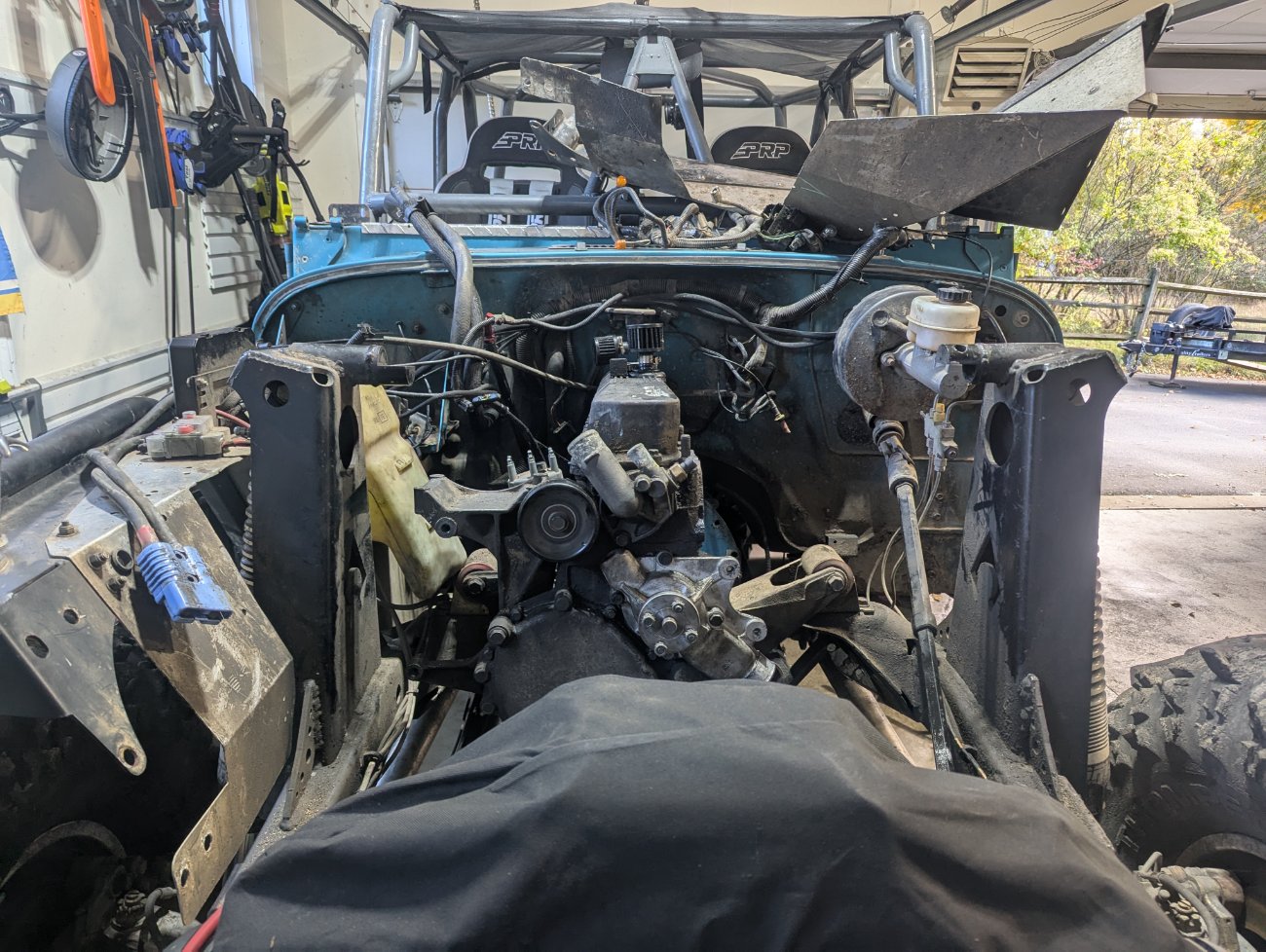

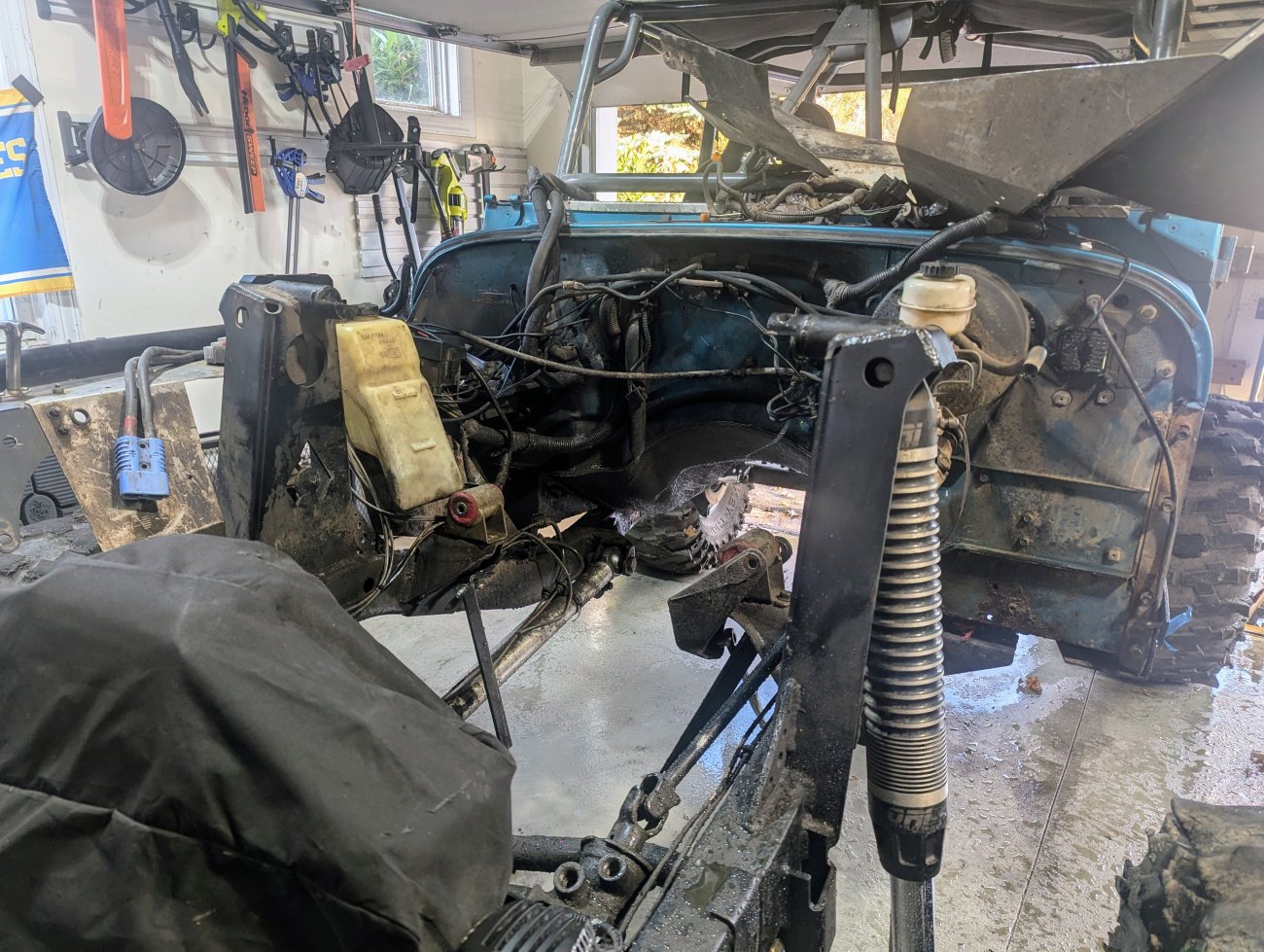

Next up is cutting out the old motor mounts and transfer case tube. Going to pressure wash the grim out of this thing too and start getting everything ready for the new motor while I look for a transmission. Trying to sell off some of the crap I have around first
Finished getting the old mounts ground out. Sparks are fun but it's such tedious work. I think I'm going to clean up the paint on the frame a bit, give it another coat of paint. Inside of the body near the drivers side mount is pretty rough, but the rust looks structural so I'm not going crazy on that

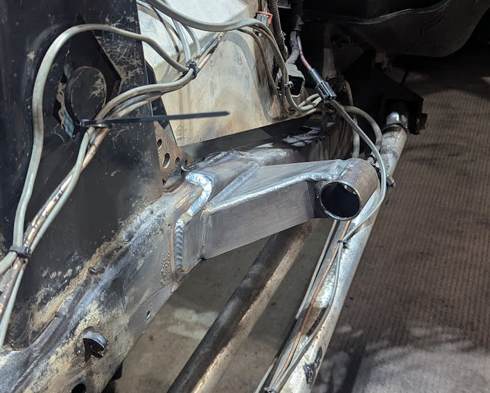

Need to find someone to weld these in. Actually broke out the corded grinder, forgot how much better it is for any serious work vs the cordless.
