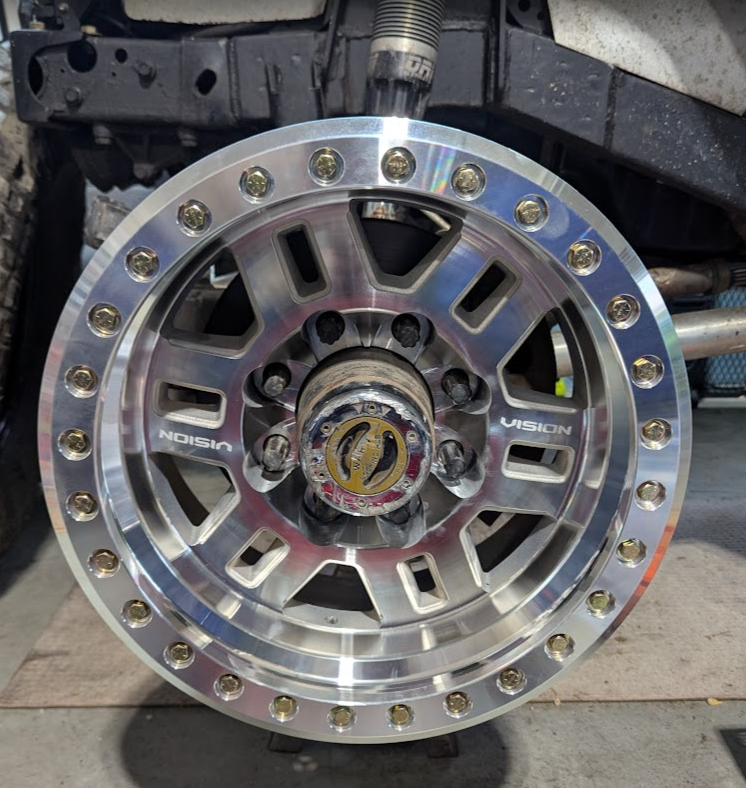

For whatever reason it's been a huge pain to find beadlocks in a 3.5" backspace in the ford pattern, ended up going with Vision Manx, which I don't have any experience with. Hoping that I like them as much as my racelines, but anything is better than my current set
Rims showed up early yesterday, need to mount the new stickies. I cannot describe my hatred for doing beadlock bolts, I'm dreading this.

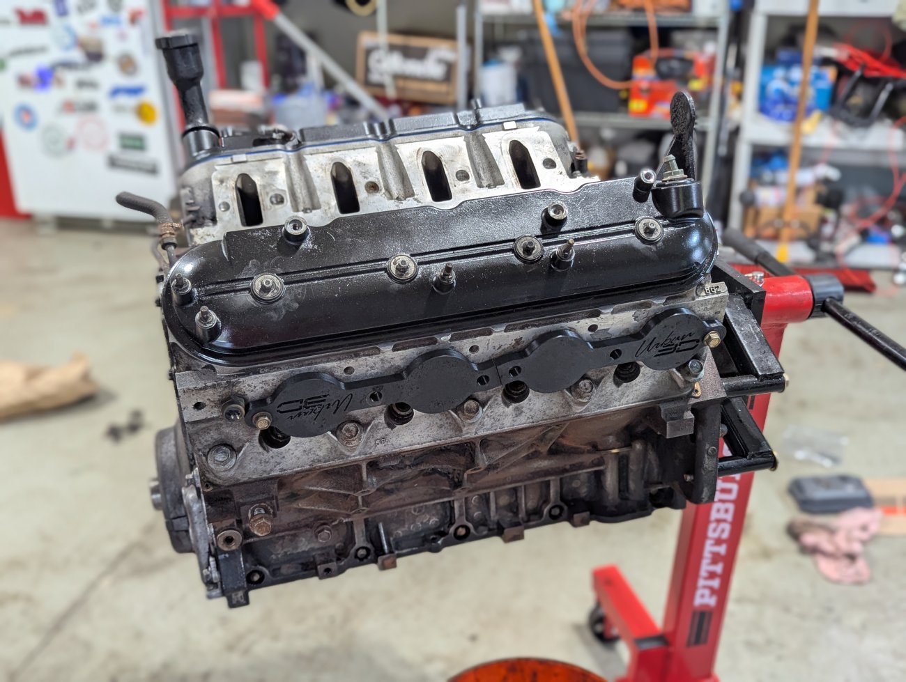

Painted the valve covers and pan, block is all cleaned up and ready for paint. Will probably paint it before I do the rear main/oil pump and timing chain

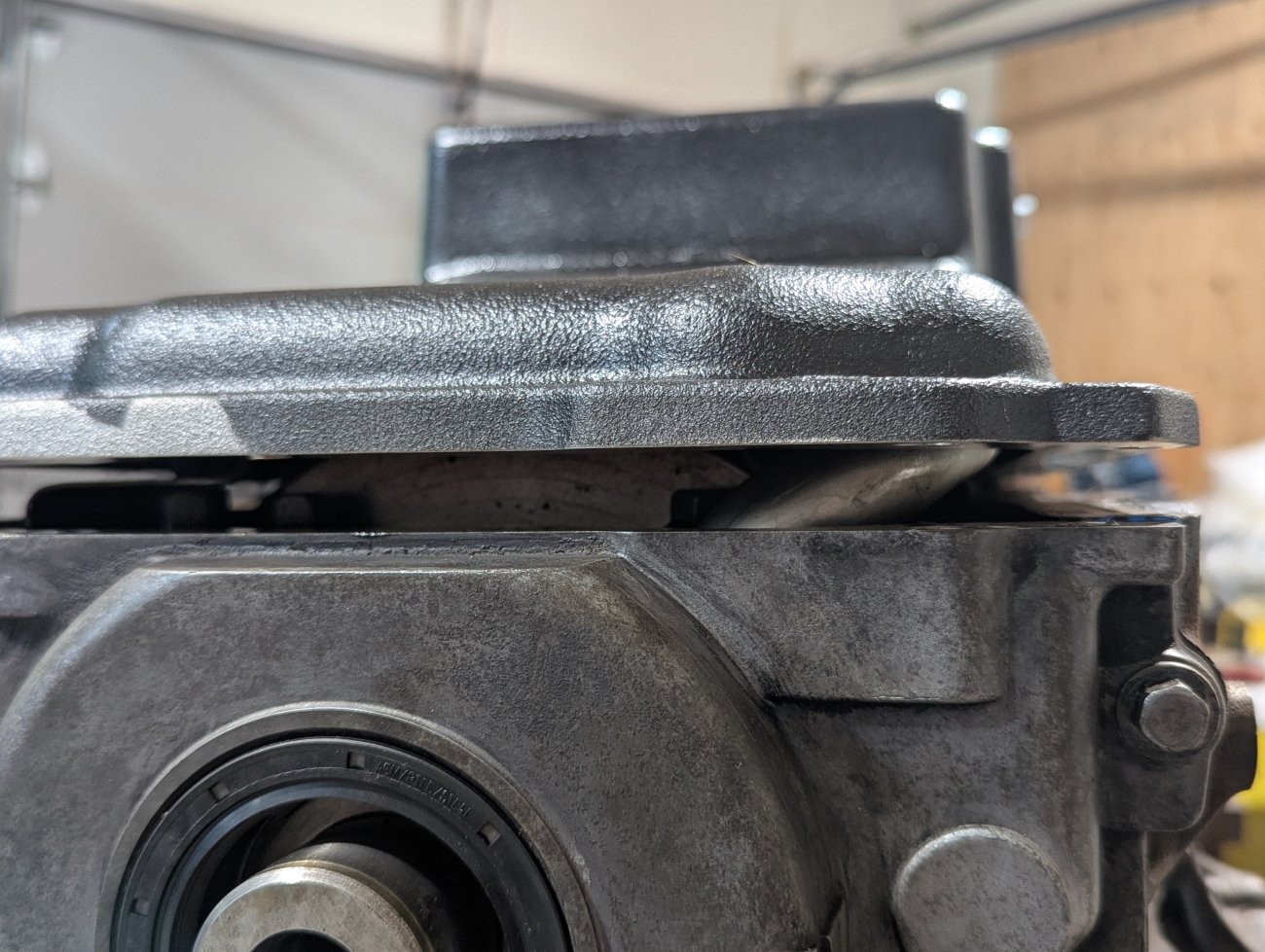

Timing chain and oil pump today. Ran into an issue where the holly pick up tube doesn't fit with the holley oil pan. After thinking for a bit I'm wondering if it's from the upgraded oil pump, but that was enough for today
Also cleaned up the throttle body and replaced the sensors. And then realized I forgot a new gasket like a dummy
  • 1 Ton YJ Crawler build
I clearanced the windage tray before this as well.

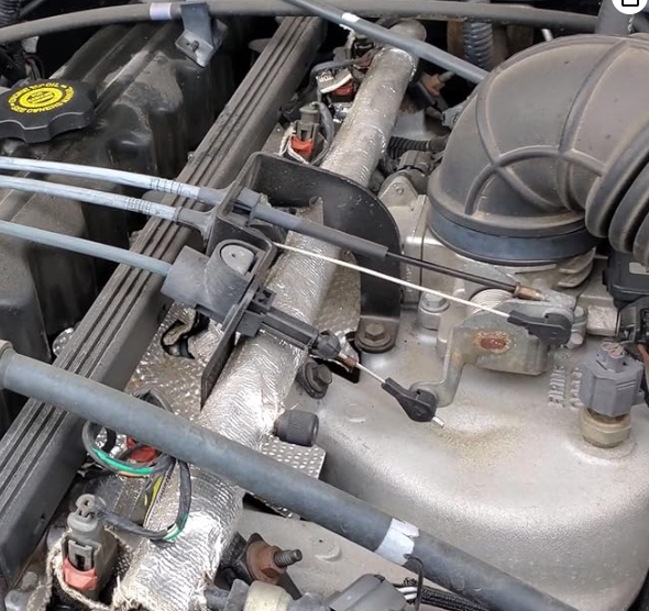

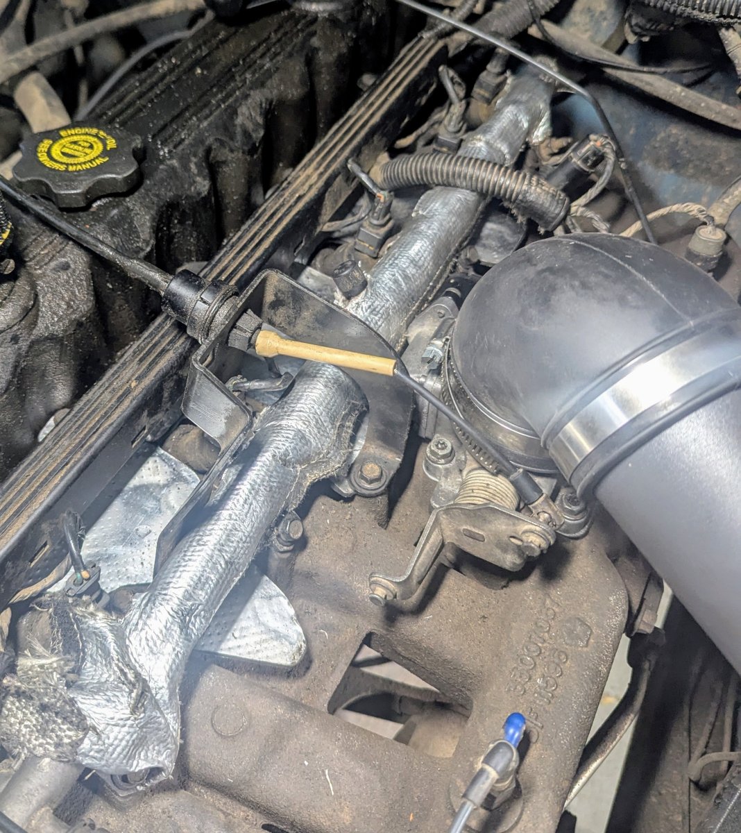

Over the weekend it was very hot out wheeling and I'm having some issues with vapor lock - the fuel rail was hot enough that you couldn't touch it. Would start right up after cooling down and it's a known problem on the 4.0s
Ordered a kit like this off of amazon

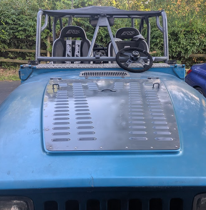

Trying to decide on a hood louver as well. Don't want to go crazy, but it's also been something I've had on every Jeep i've owned for this reason.

One of the most fun things with jeeps is that the aftermarket has everything. Picked up this heat shield from Amazon and had it in two days. Tomorrow I'm going to bleed the cooling system and choose a louver

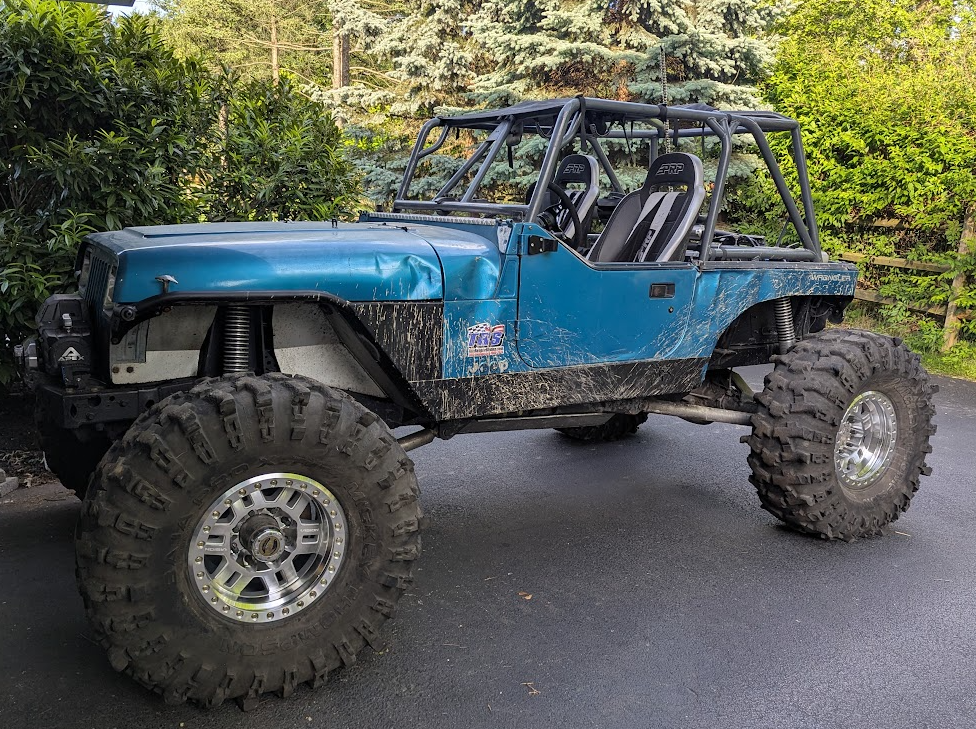

Replaced the t-stat and water pump, getting good circulation now and temps seem normal. Put a new sender unit into the temp gauge, but that's still a no go. Got a louvred hood from genright and got it installed yesterday in a miserably hot garage.
Going on a big two day run at AOAA in two weeks, and hope to be able to run the whole time actually without having to wait for the jeep to cool down all the time
I don't know much about Jeeps but I do know fuel systems... Does the rail have a return out of one end and supply on the other with a regulator on the rail? That's the BEST setup for vapor lock assuming the fuel pump is in the tank, if it's not it needs to be as close to the tank as possible and as low as possible. If external pump and only a single pump system it's best to get a low pressure pump to put first in line (the marine Carter/Sierra is a good one, or as good as you'll get). You want to get liquid fuel through the fuel rail and flushed out so it can cool off. The heat shield and louvers should help your situation though.
