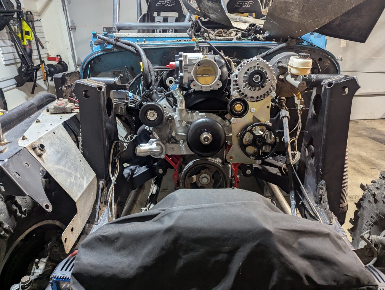

Got some parts over the past couple days to get a few more things done -
  • New intake gaskets finally got here, so I can get that bolted down. Going to have some interference issues with the hood I think, but we'll see
  • Adjustable transmission mount to try and use the previous crossmember because of how it's packaged with the frame mounts for the front suspension, hopefully work with some minor tweaks
  • Drive by wire pedal showed up, get that bolted in and all set too
Going to take the atlas to a friends shop to get a new input and a VSS sensor. Advanced adapters never replied about whether it's preferable to have it on the transmission tailshaft or the output on the transfer case, but it seems more logical to me to have it on the transfer case side.
Couple steps forward this weekend.
I screwed around with the trans mount for a few hours on sat. My driveline doesnt have a mount at the trans, the crossmember was originally at the transfer case. There are a couple bolt holes I was trying to use, but it just didnt work, and I would have ended up covering up at least one transfer case mounting hole to do it. On the YJ, the frame rails are angled in where the trans crossmember would be, it's all a huge pain and nothing lines up well. In theory, it could be done with a custom cradle for the extension on the transmission, but I think I'll be further ahead going with a tailshaft mount for the atlas, and then a crossmember there, where the frame rails are parallel too. a little worried about not having a crossmember under the trans, but think it'll be ok?

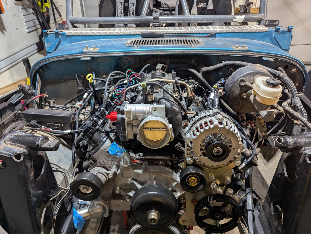

Sun I cleaned the injectors, mounted the intake to the engine, so it's closed up now. Mounted the computer in the stock location, and started wiring everything up from the back of the engine to the front. Found out Holley forgot my injector harness, so I have to call them today to try and get that sorted out. Drive by wire harness doesn't fit my throttle body either, so that'll be fun. Outside of those issues the Holley harness is well marked and easy to figure out

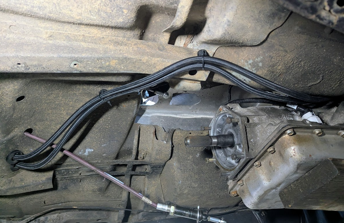

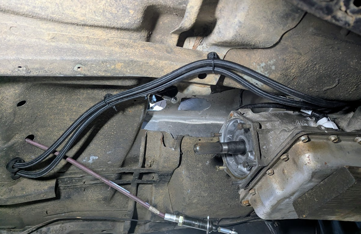

Trans cooler is hooked up, just need my VSS sensor setup to arrive from AA and then I'll be able to wrap that up

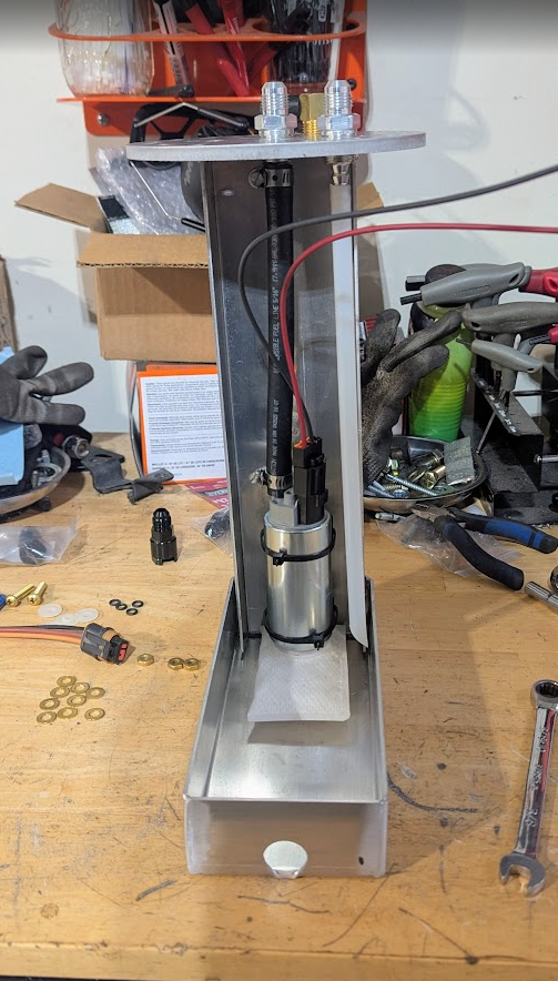

As I was wrapping that up, I thought to myself "I wish my fuel system got here so I could get that going" and then somehow Fedex delivered on a sunday? So I pulled the old pump and started building the new

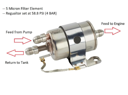

Pump is assembled, need to finish that wiring up. Got a filter/regulator to go with it. One thing that confuses me a bit is the return to the tank, I assume this style needs a second return to the tank, which isn't a problem for my fuel cell, just a little different. Never used a combo unit like this before, they usually go after the fuel rail on the return line right?
edit - Found my answer - it does just go back to the fuel cell . Should be nice and easy to mount as well. Corvette style regulator. I also have a pressure gauge to mount at the fuel rail, so I'll be able to keep tabs on it

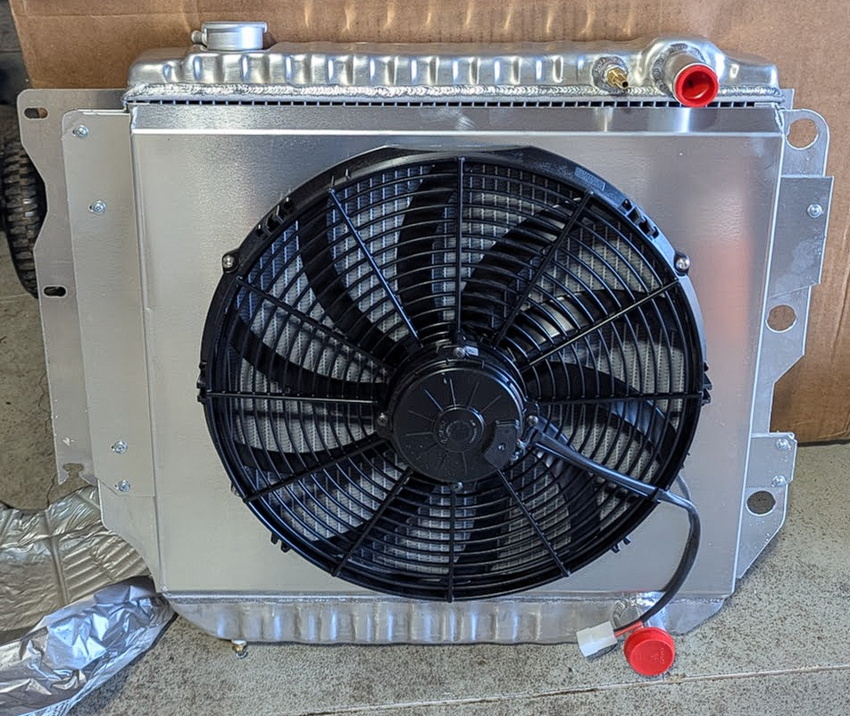

Radiator showed up yesterday, really happy with the quality of it - place I got it from does custom shrouds for the E fans

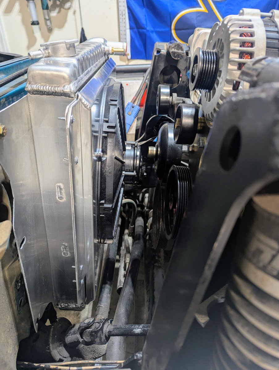

Threw the grill back on real quick after work to check fitment, went from "I have more space than I know what to do with" to "oh boy this is going to be tight" real quick

i do not like the corvette fuel filter/regulater setups. too much variation with the aftermarket units.
just use the fass regulators when i can.
i forgot how nice your rig is.
The old "corvette" regulators made by WIX were fantastic and repeatable, the new ones made/designed (the return port out of the regulator is under 1/8") by random 3 year old cambodians are ALL OVER THE PLACE, we use them on stuff at work and with a healthy pump you will get 80-100psi out of some of them... the WIX ones would be 58-60 consistently...
Just a note if you didn't know as it helps sometimes you can reverse the intake manifold so the throttle is in the back, just have to play with the PCV hose a little I think, pretty simple. Why'd you use that silly LS3 throttle? The normal 6L is about as big and in your application would be sufficient... not that it matters, make what you have work!
Holley compatibility- I didn't realize it at the time but they only want to work with specific throttle bodies. I had this nice Toshiba stock style unit from my old buggy, went to plug it in and was SOL. I figured the throttle bodies had the same connector, but nope. So annoyed too because it was another expense and I didnt really need it
