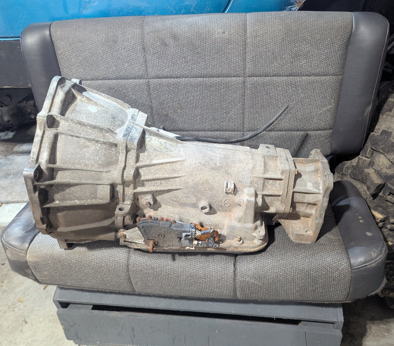

Got my transmission today. Was recently rebuilt by *the* local guy for GM transmissions.. watched and the seller dropped the price, snagged it up. Very happy with the deal

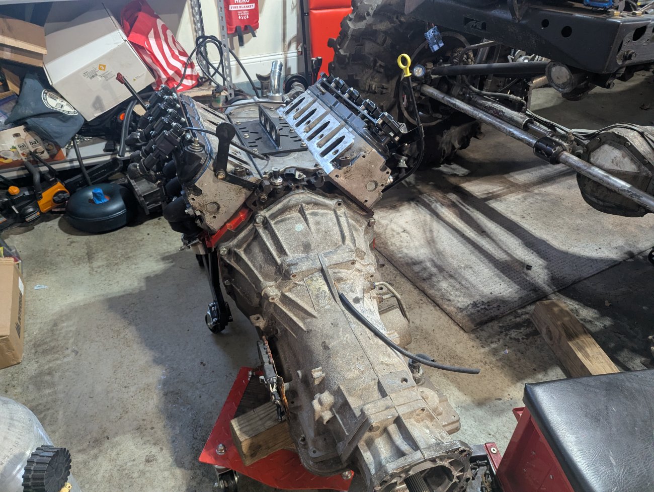

Was a bitch to get the torque converter lined up right, but got it on and got it mostly attached to the motor. Need to drill and tap an upper one and figure out the correct size for the bottom ones at the pan

looks like a 65 or 70. or just a late 60? hopefully its 65/70 goodies
Listed as a 1998 4L60, but when I started looking at it more it's a little...odd. It's right at the production cutoff for some of the changes from what I read. And it was also rebuilt by *the* local guy, so it has updated internals like a shift kit and 300m input/output shafts

there is a few kits for the vss.
another thing about the 4l80 i like was the speed sensor placement.. but they are definitely heavier. shitty over drive and first gear. and the connector can get beat up by the driveshaft ...
for a buggy the 70 is a good way to go with some parts.
only thing better is the 6l80...but its a buggy...not a cruiser.
