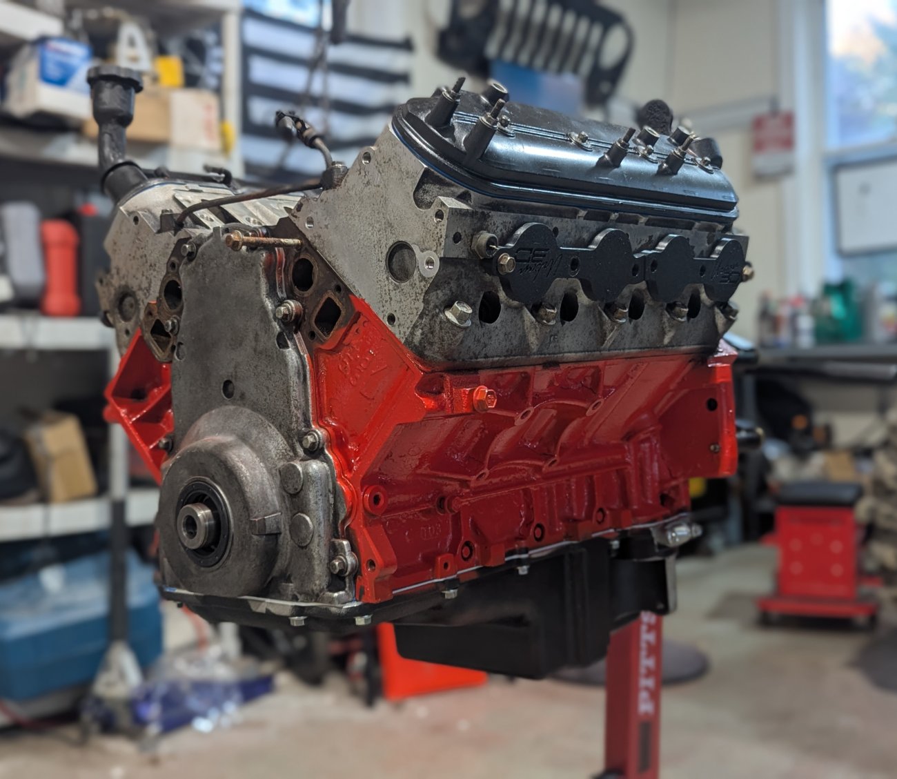

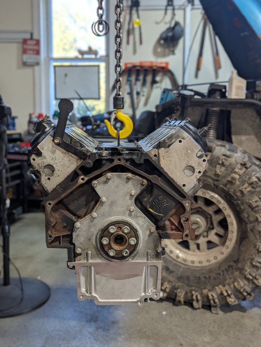

Love having a hoist. New rear main seal became a 5 minute job

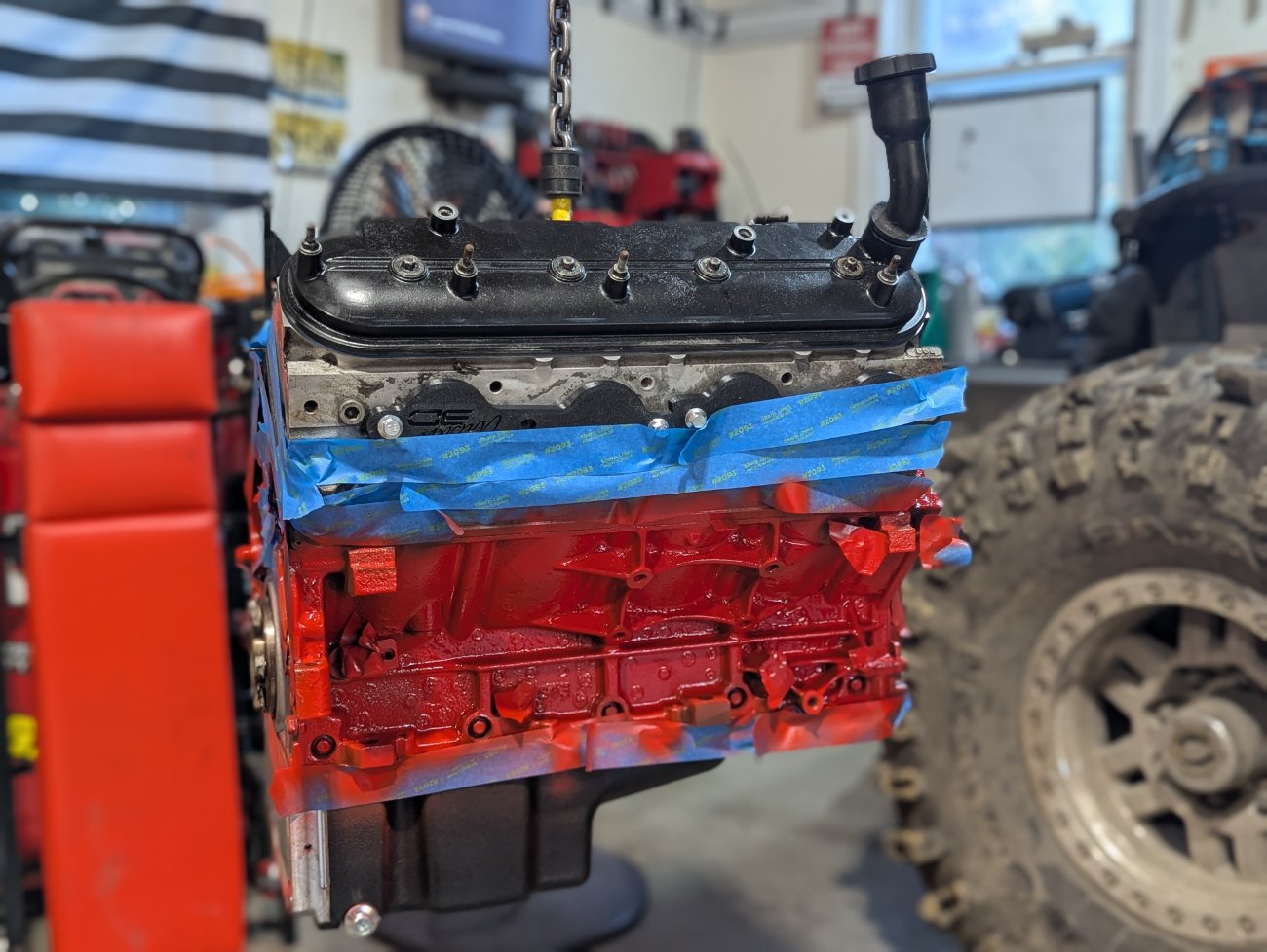

Threw some paint on the block while it was off the stand

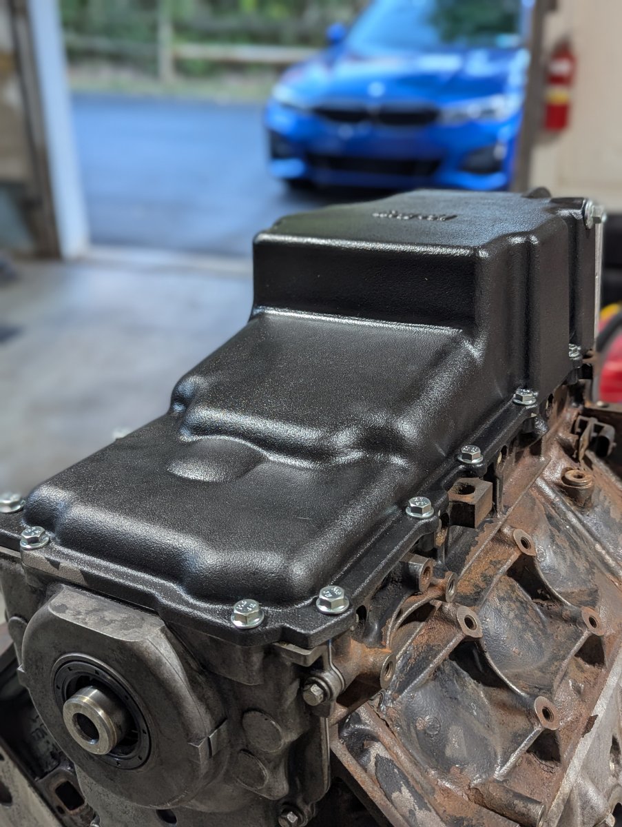

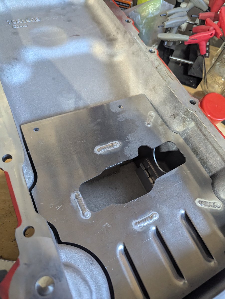

Have my fancy oil baffle coming this week, and got the Holley oil pan fitted in. I will have to drill out one hole to mount it - it always cracks me up how "every of X motor is the same" rarely pans out in practice. There's a bolt hole that wasn't used in my block with the stock pan I guess

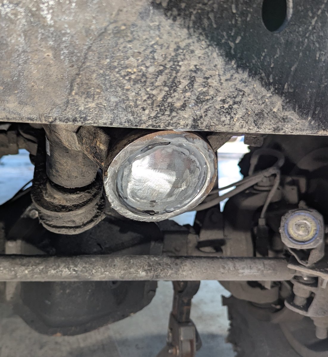

My steering box is probably done. The cap has a hairline crack from hitting a rock with it. There's a snap ring that holds it on, hoping I can find the part number for that and the cap and just replace those. I don't really want to spend the money on going full hydro, but also don't want to put any money into hydro assist. Not sure what I'm going to do yet

Oil pan is on. I cant for the life of me find the dipstick I was sure that I had from my buggy, so I guess I'll order that. Today I'll throw the harmonic balancer on, and I think next will be sensor replacement? Not sure yet.

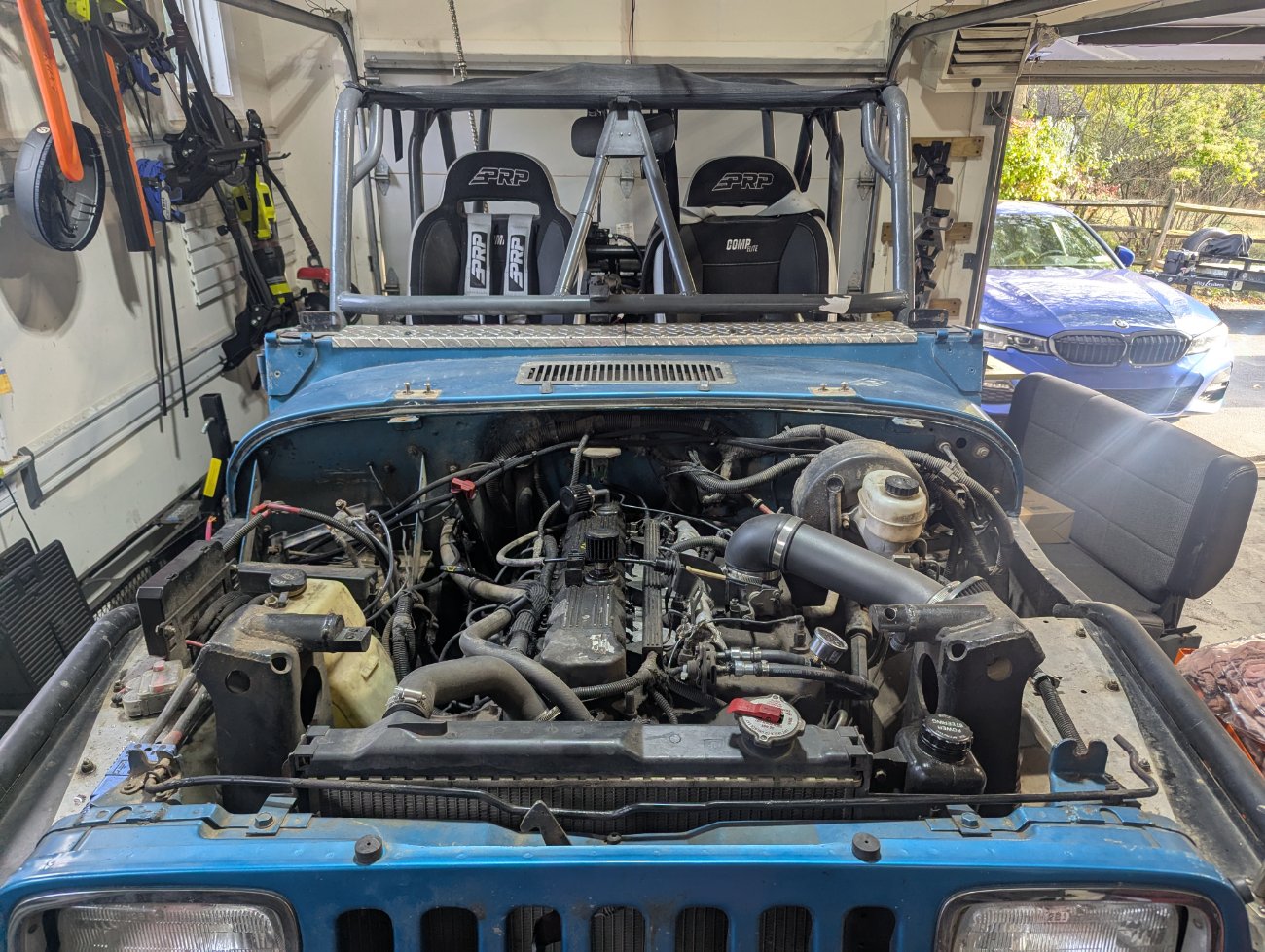

Starting to pull this thing apart. Had to get some spacers for my coils on the motor, but once I have those it'll be as together as its going to get for a while.
Pulling driveline, draining fluids first. Then I'll probably pull the Atlas and maybe take it to my buddy's shop to have him change the input for a GM and generally freshen it up.
Couple of things I haven't made decisions on yet - crossmembers and skids. I don't like my aluminum skid, but also don't want to redo everything. Also need to decide on accessory brackets for the motor, leaning towards the goatbuilt that relocates the alternator up
