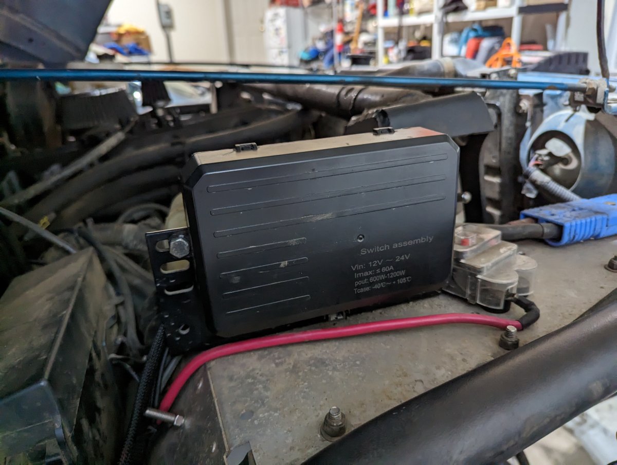

I might be the last person to find out about these amazon spod knock offs. Wiring in my whip, radio and buggy whip were a breeze with this thing.
Plug the wires in, screw it down, and you're all set
Has a handy little panel to go with it
And now everything is up and running

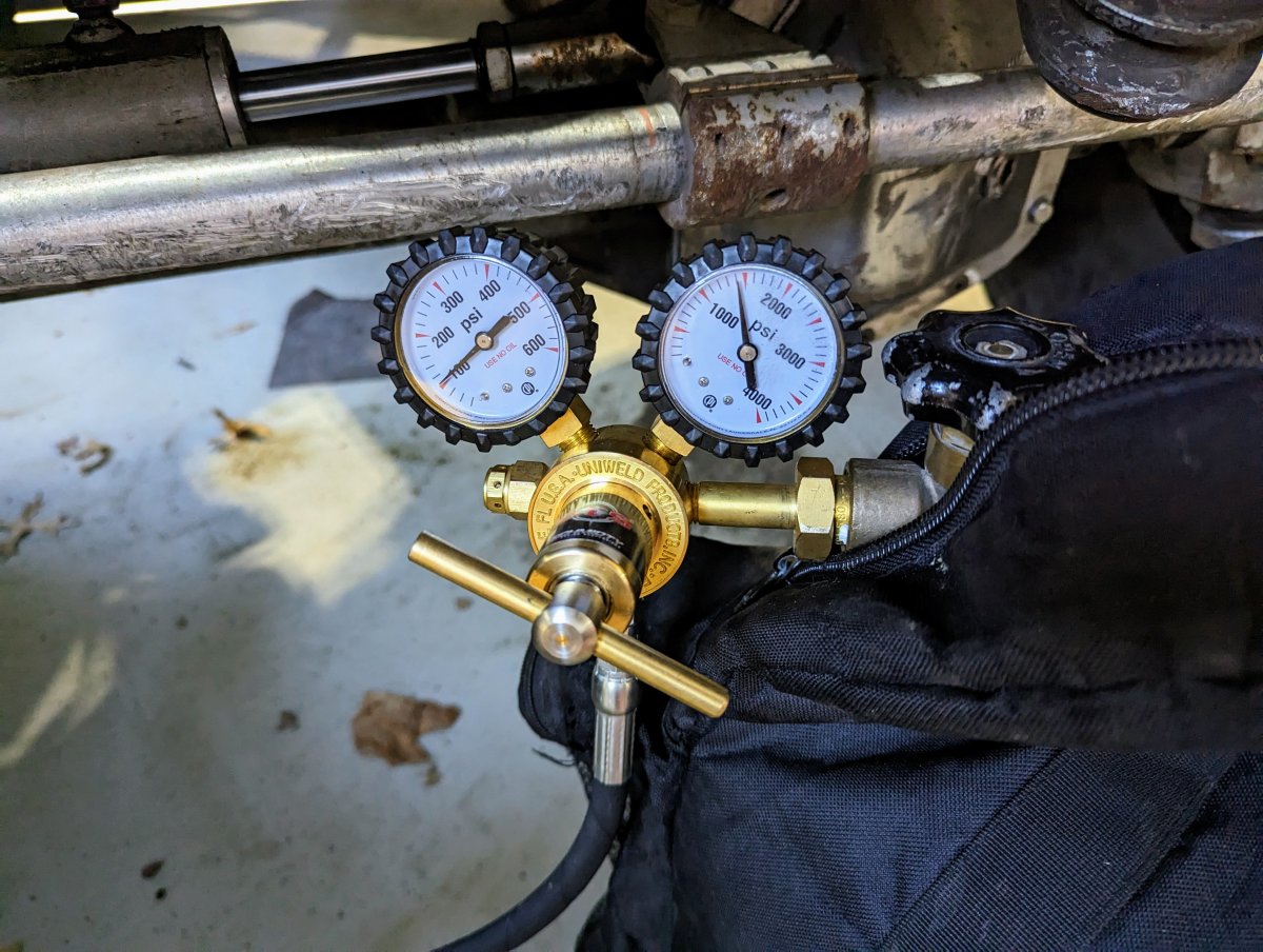

Getting the base tune on these was a little easier than I thought it would be. The lower valve controls the ride stiffness. ORI suggest setting to 100 psi as a base and then tuning from there, so that's where I'll start. One of the shocks had no air in it, so that would explain why things felt so off.
The top valve controls the ride height. I decided to bring it down a hair to keep the COG low, and then I can add to it if I need to. I'll bring the nitrogen tank with me on my first ride out in case I need to tweak anything. Will also need to open up the hole around the top valves in the rear to make it a little easier.

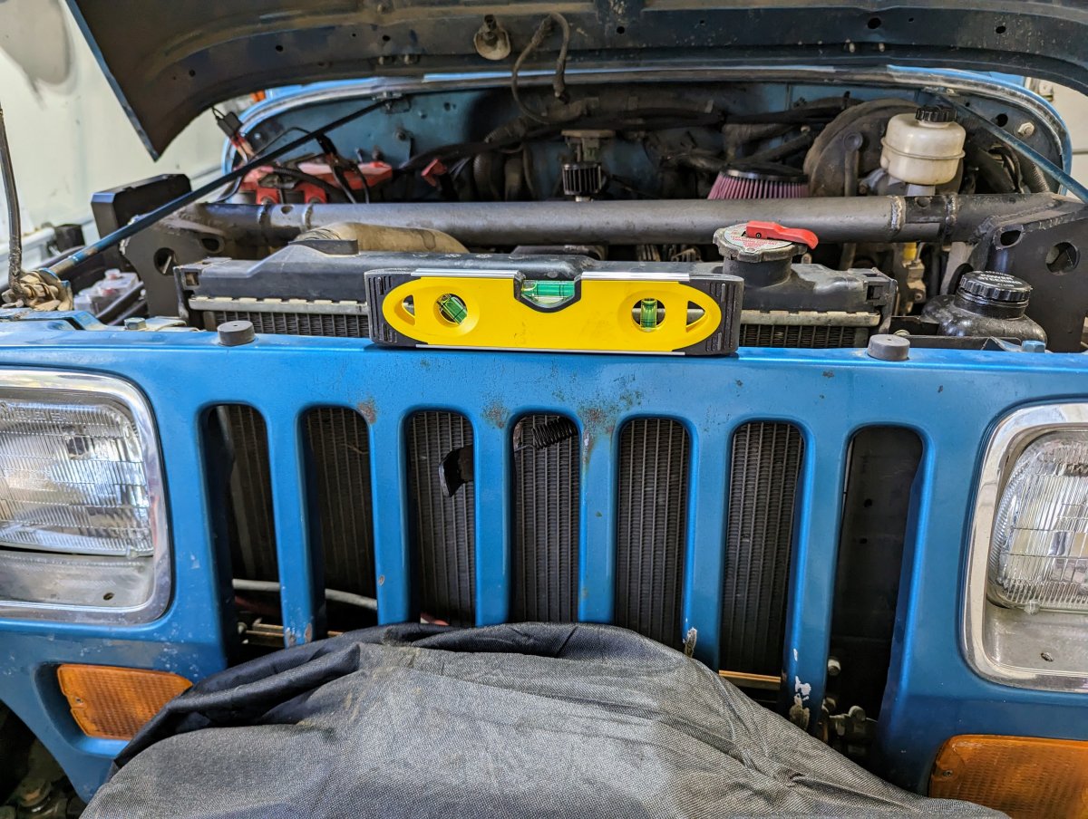

New ride height
