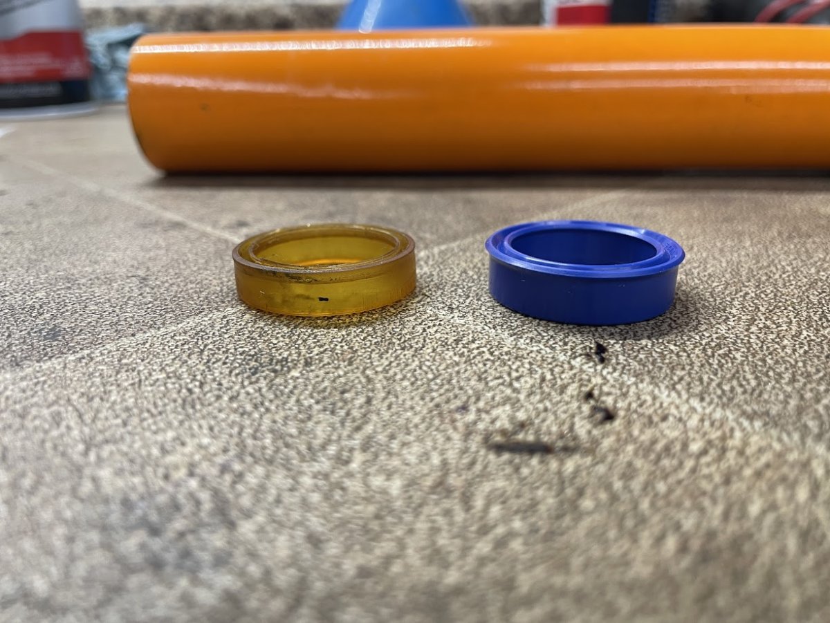

Failed seal on the left, new one on the right:
Fix your 4 ton Porta-Power ram

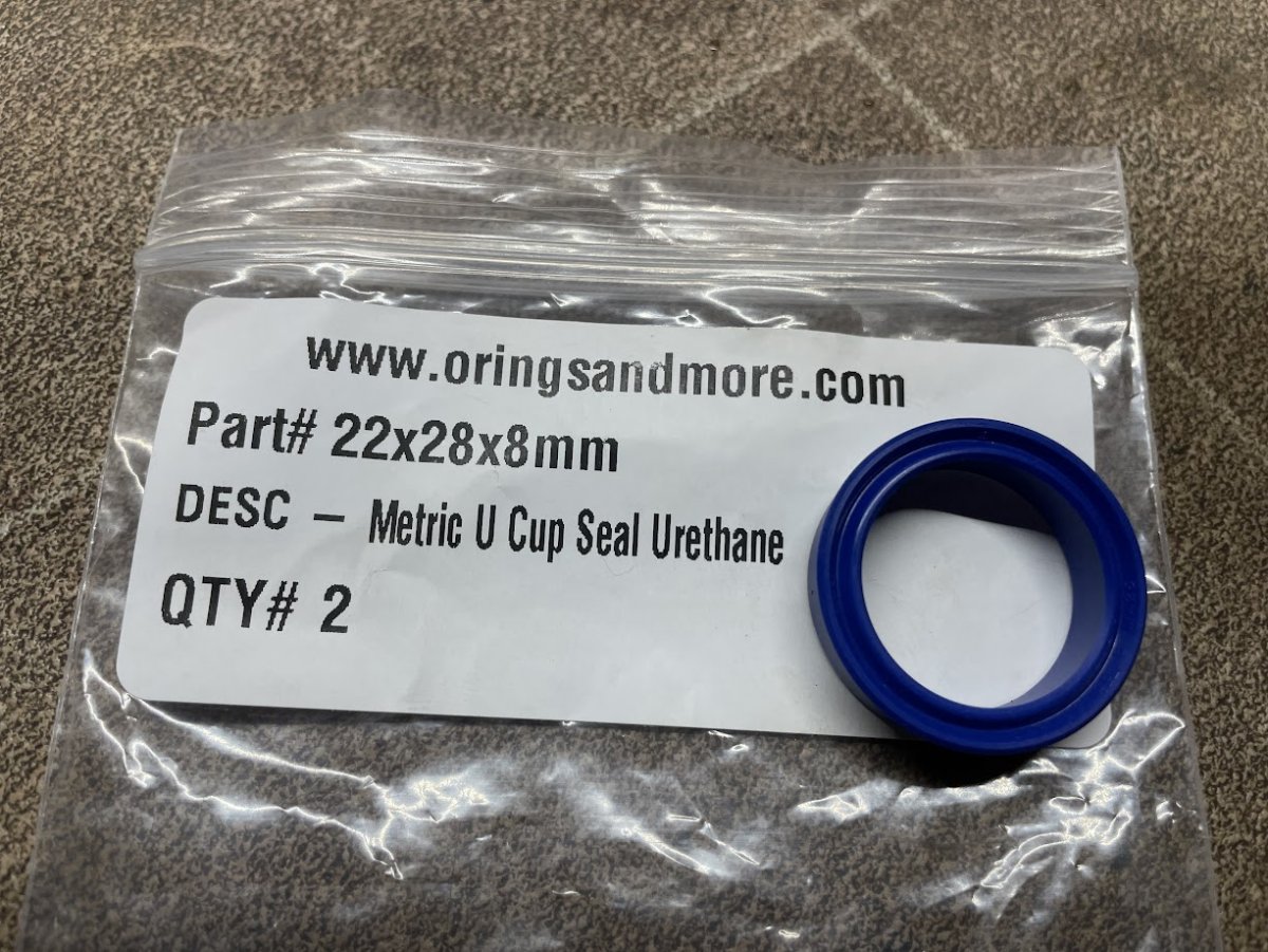

Part # and size of the new seal. I believe you can order from their website as well as the eBay store.
